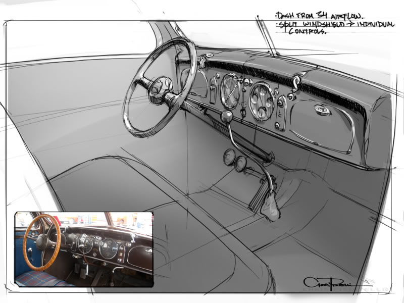

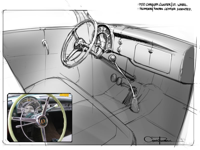

    Here are just a couple dash renderings from "dart156" that are being kicked around........................
  20. The37Kid
    Joined: Apr 30, 2004
    Posts: 32,513
    The37Kid
    If we get to vote this is my pick, I like the balanced side to side look. [​IMG]
  21. -Brent-
    Joined: Nov 20, 2006
    Posts: 7,850
    -Brent-
    I see your point on that, for sure.
    I agree, as well. Although, to me, the split windshield & controls doesn't make much sense with a roadster. I do have confidence that whatever you choose will be fitting to this car.
