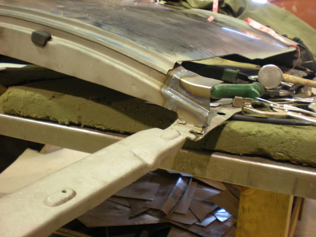

    Been final welding the cowl.
  5. Toast
    Joined: Jan 6, 2007
    Posts: 3,885
    Toast
    from Jenks, OK
    I'm still watching this! Amazing job, can't wait to see this together.

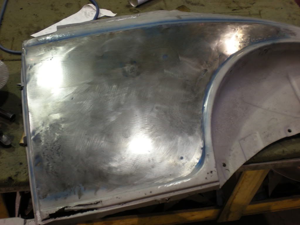

    Been smoothing out the quarters
  18. -Brent-
    Joined: Nov 20, 2006
    Posts: 7,847
    -Brent-
    Looking good. Did you make that patch piece?
