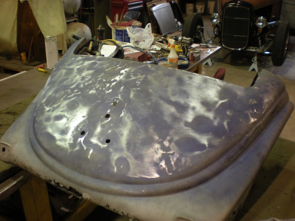

    I got the tail pan section taken apart, sandblasted, and now Im working out all the dents. The metal is really solid except for the bottom. But we are going to change that anyway.

    Man, that tail section looked like a bag of walnuts. It's a good thing it's in your hands. So I guess you find it easier to remove the section and work in on the bench instead of on the car??

    Defiantly easier to work on it off the car. With it off I removed everything that was blocking my access to the outer skin. That way I can completely fix all the issues, and then re-attach it to the car.

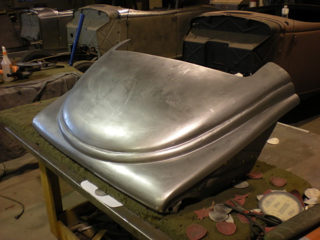

    The back outer section is all finished
  27. You forgot to leave room for bondo.
  28. WOW I am impressed with the quality of work you do.I only just found this thread.
    I used to use engineers blue or marking out ink too when I was metal finishing it works a treat doesnt it.Makes it much easier to see what your doing when filing up.
