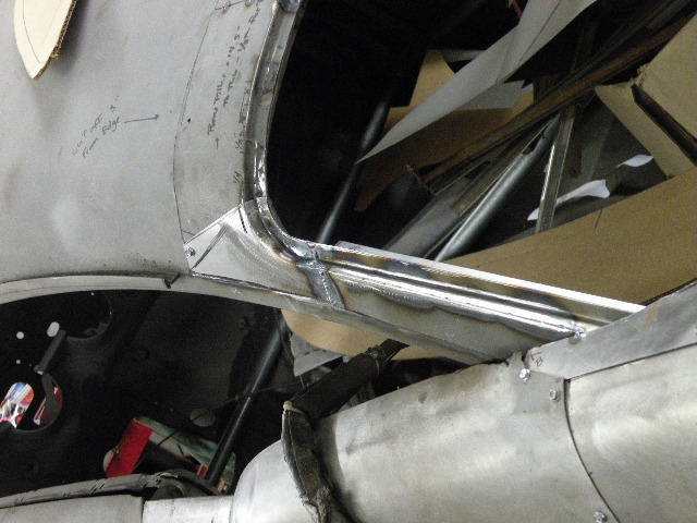

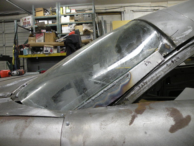

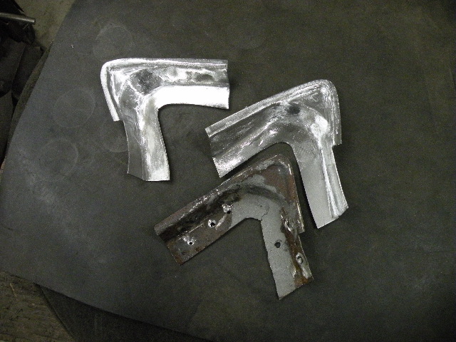

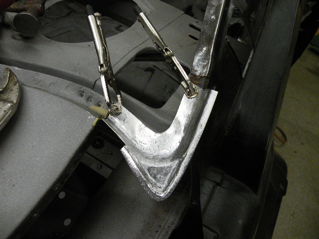

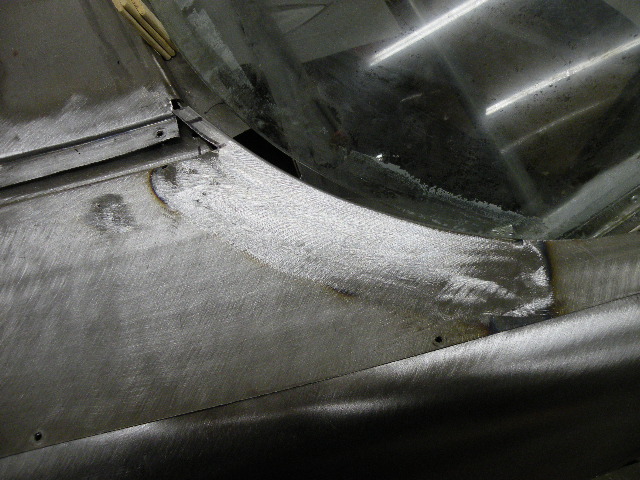

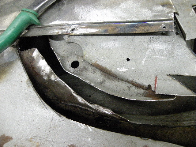

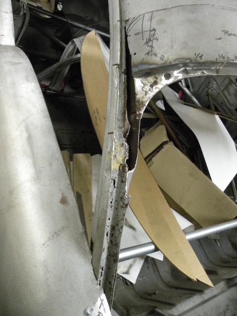

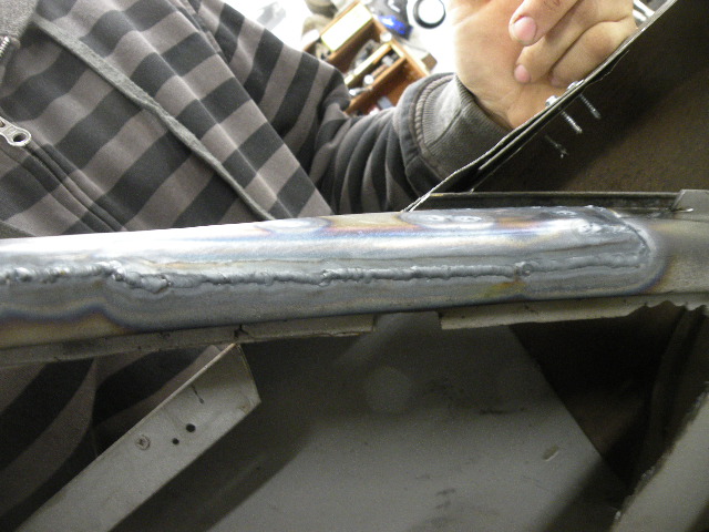

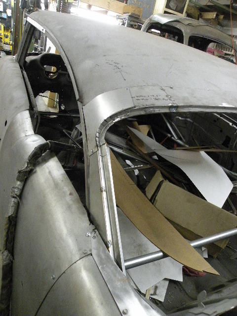

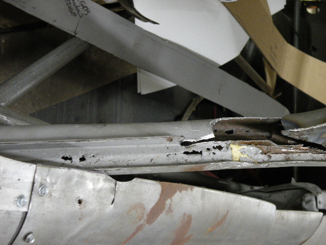

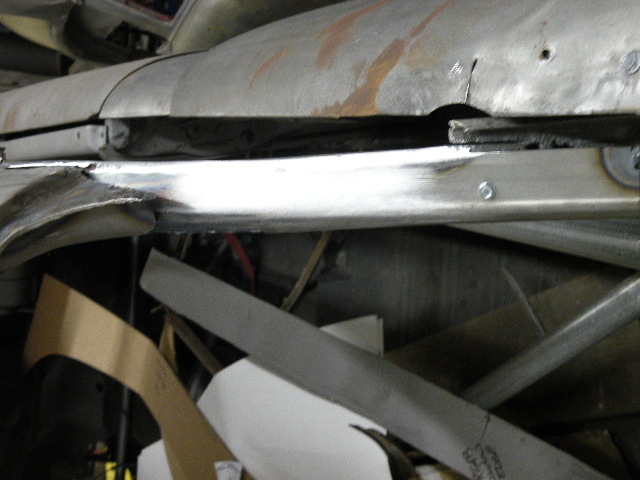

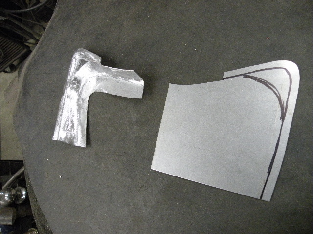

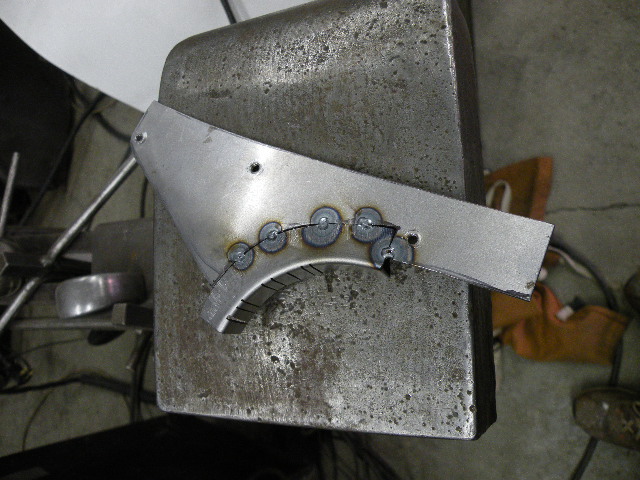

    Max is working on the rear pillar section's now. He cut away the old thin holy part.

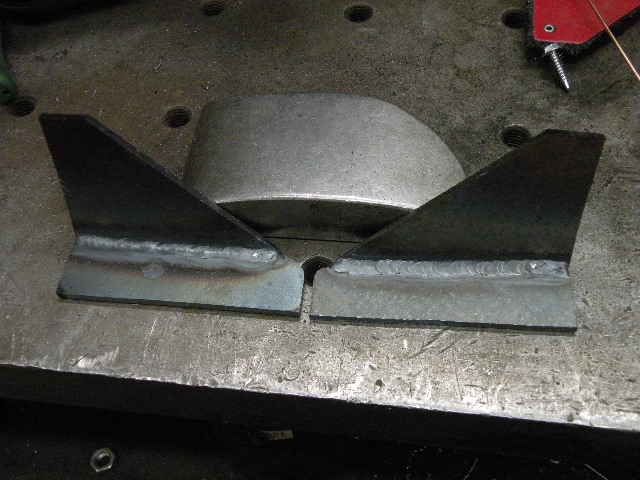

    Then formed up a 16 gage cap to add some strength to the pillar.
    Tig welded it in.
    Next he made a 16 gage tapered filler panel.
    Notice how it follows the gl*** line.
    More to come next week

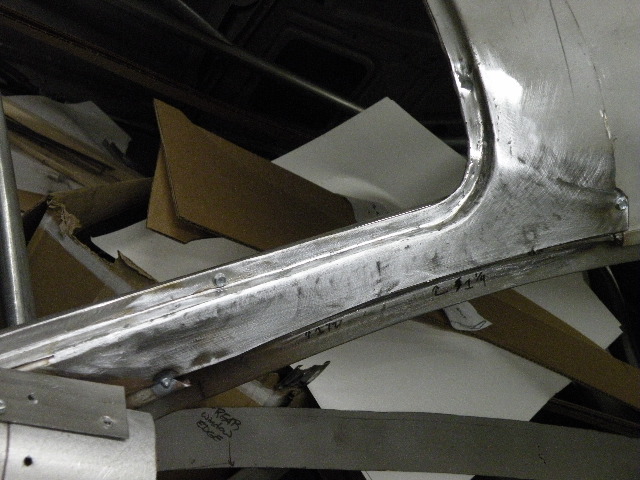

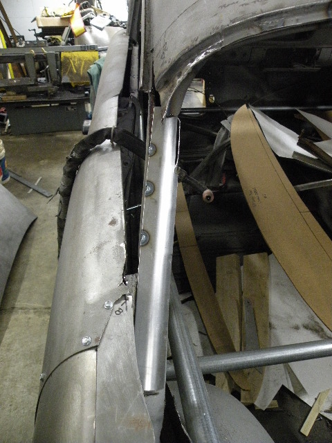

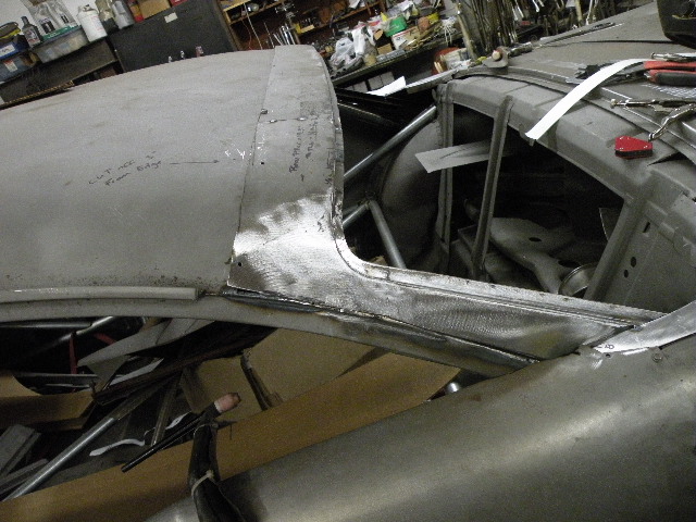

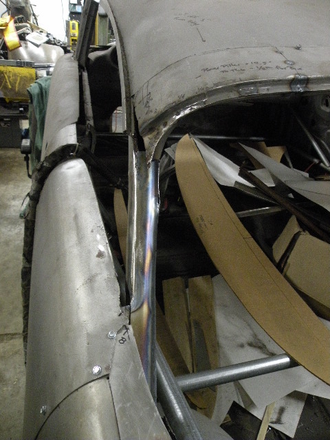

    Max has been working on the roof rear pillar some more.
    Things are cleaning up & starting to take shape.

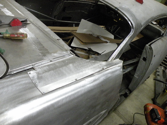

  10. carbuilder
    Joined: Nov 21, 2006
    Posts: 982
    carbuilder

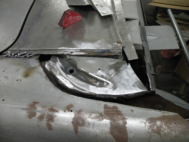

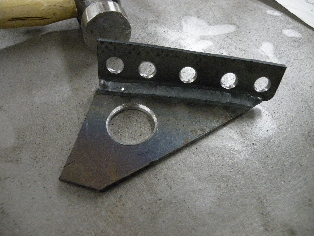

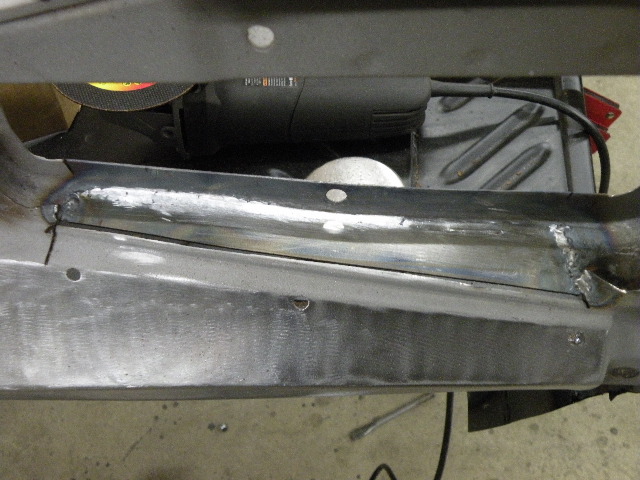

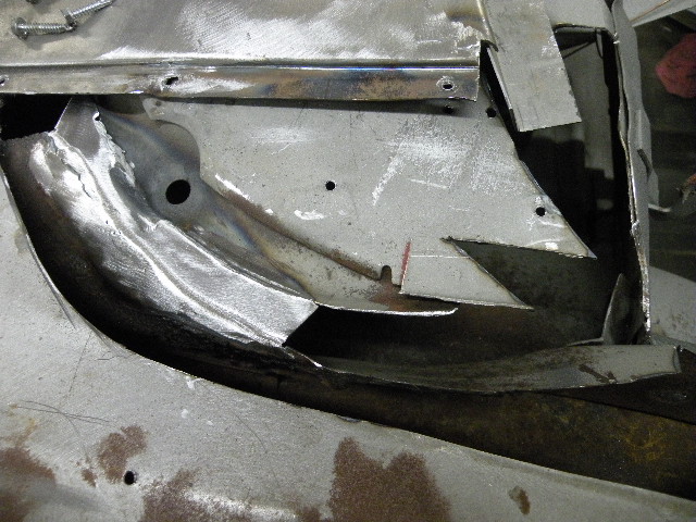

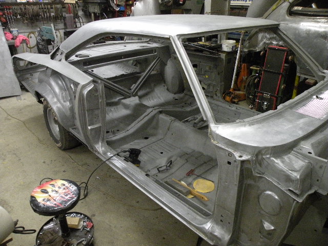

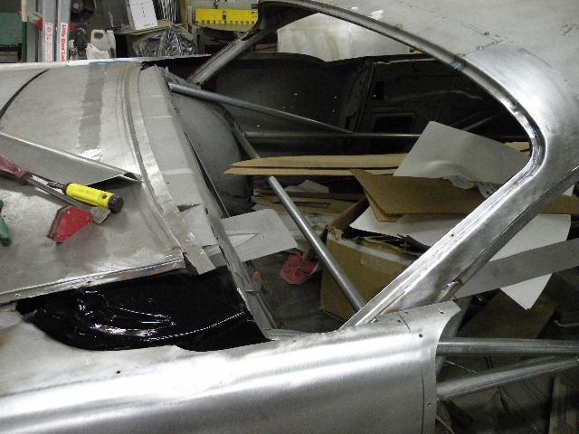

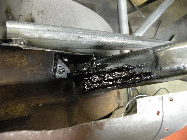

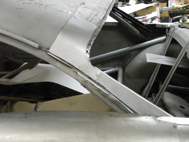

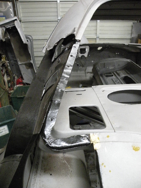

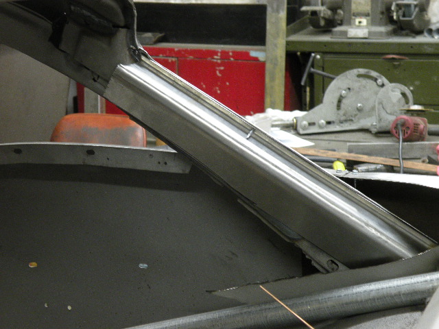

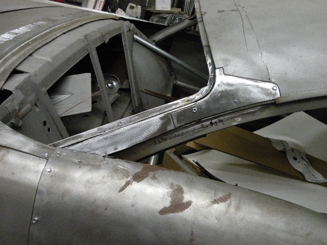

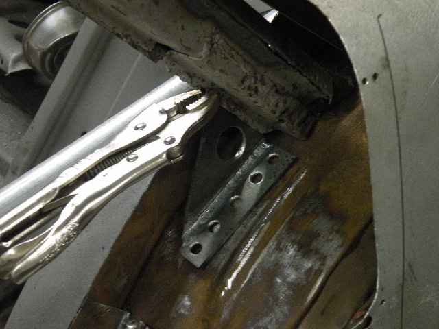

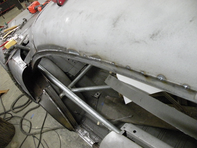

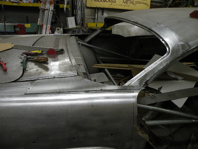

    A little progress on the Pontiac roof tie in supports
    the rear package try area has to be reworked for the rear window chanel.
    another roof support.
    Welded in the roof isn't coming off now.
    Coated with por 15
    Rear package tray section coated with por 15
    Yes thing are flowing together.
    And more to come.

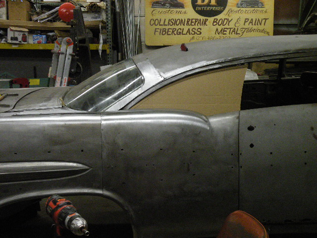

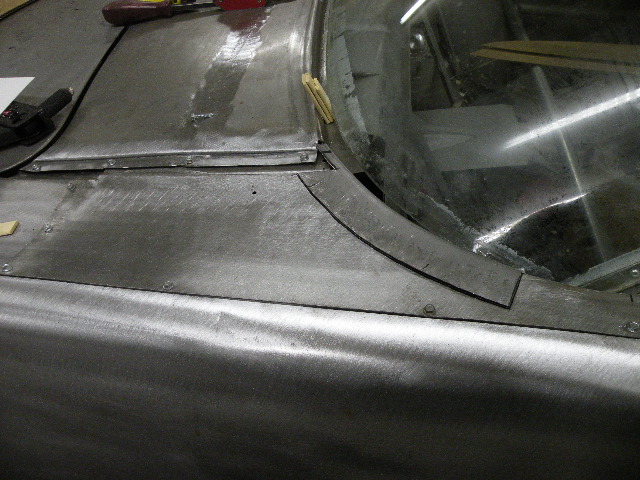

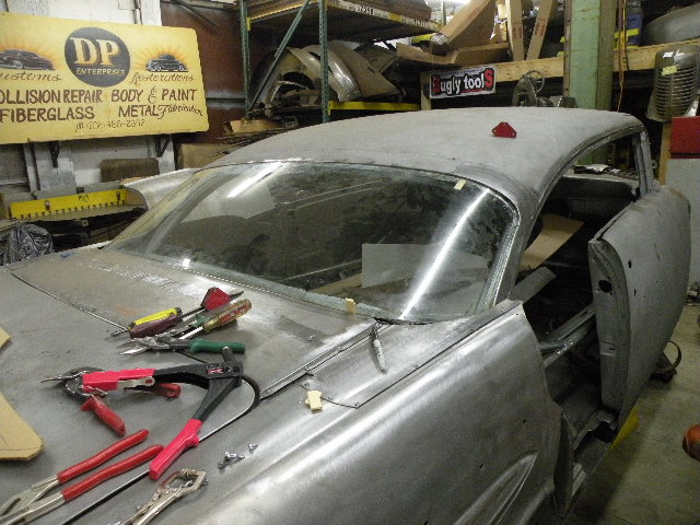

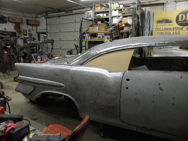

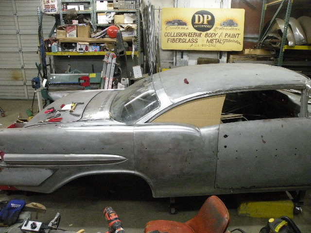

    A Little progress on the 57 custom Pontiac the pictures should give you an idea what is going on its all time consuming hand fab at the present. Doing a total roof style change & chop is a lot more complicated then a straight chop. but this thing is starting to look real good in our & the owners opinion.
    More to come.

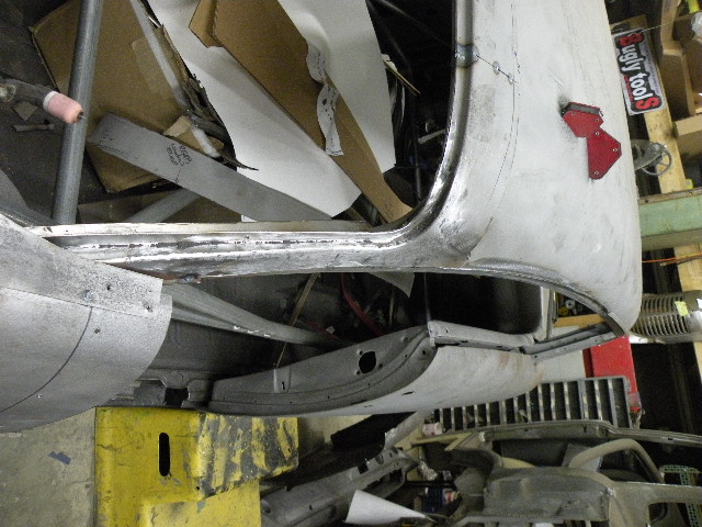

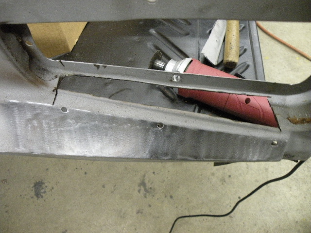

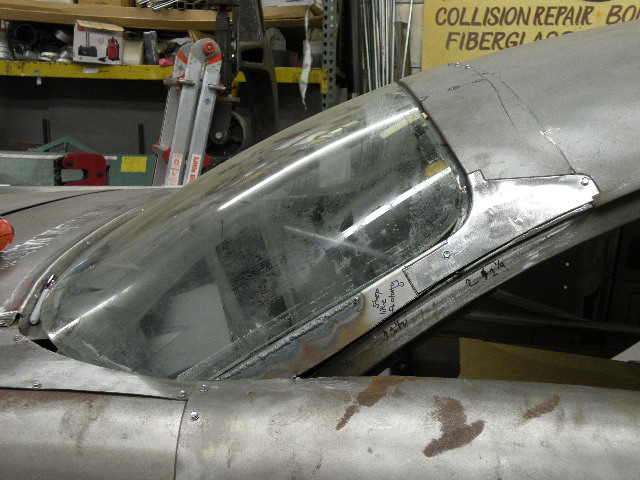

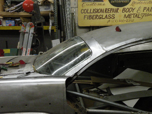

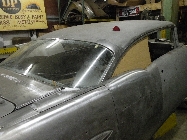

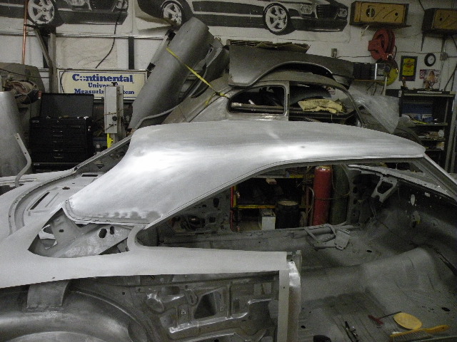

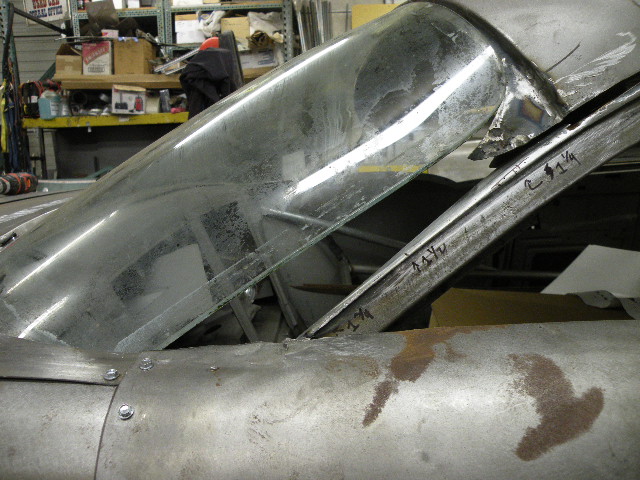

    The rear quarter was put back on temporally to check fit & looks also the drip rail gutter was removed & the seam welded.
    A rear quarter widow idea we are working on.
    O the roof flow we like how about you.
    Back on to the Coronet tomorrow for a couple of days its back from the blast shop..

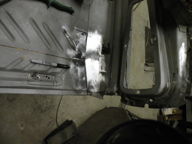

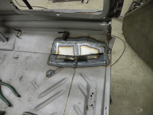

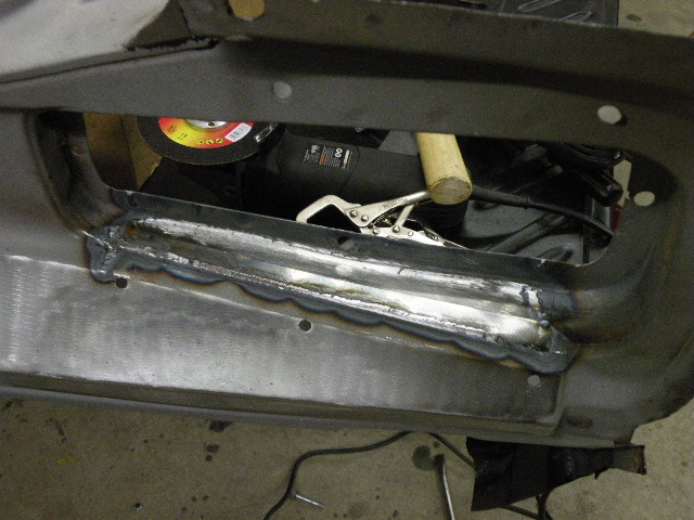

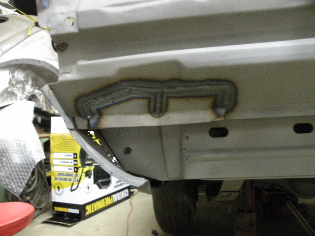

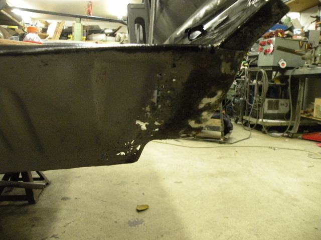

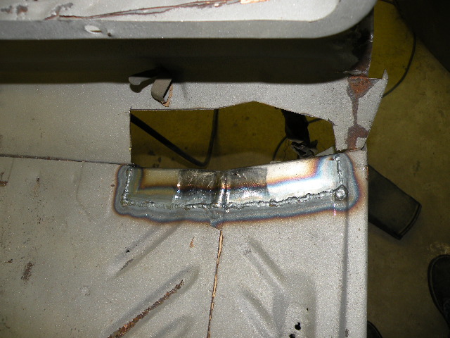

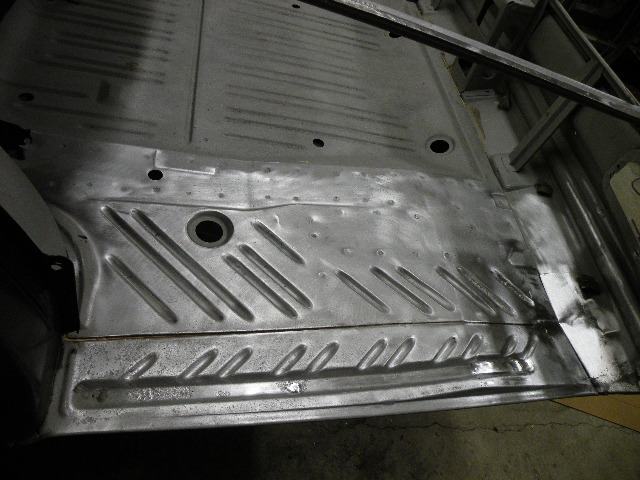

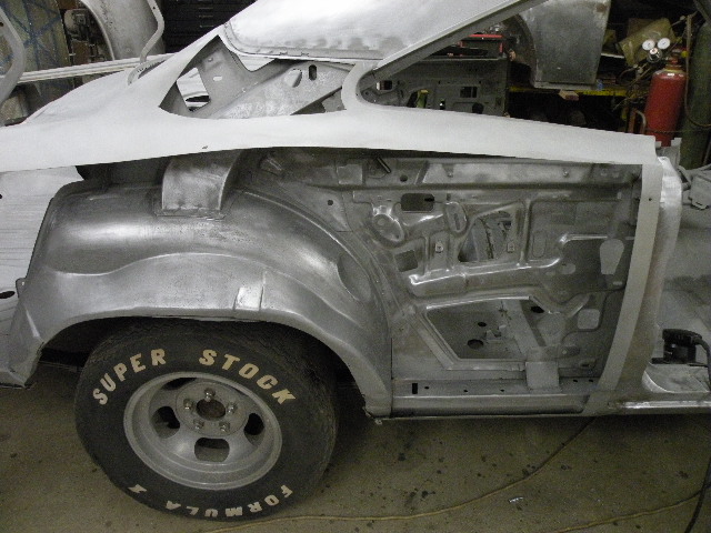

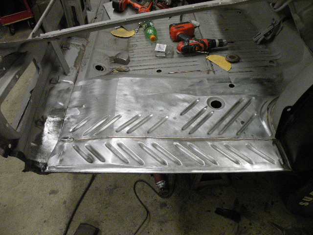

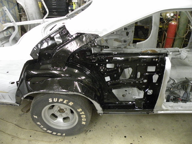

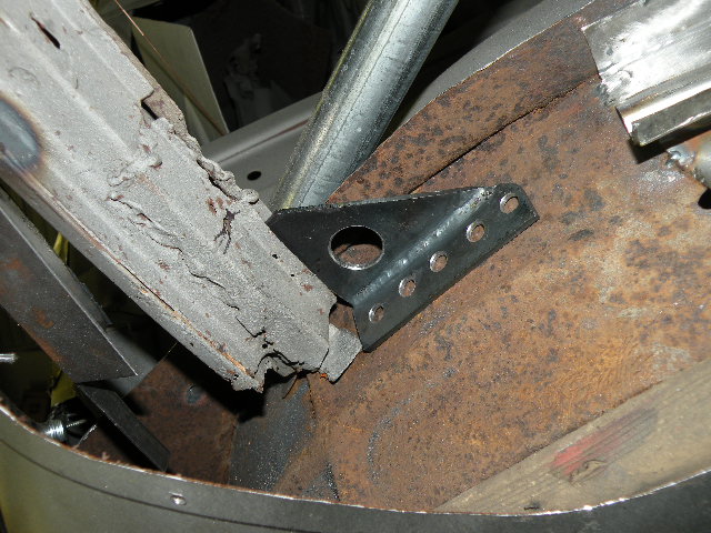

    The Coronet is back from the blast shop so the first thing we do is sand every thing with 80 grit it is less prone to start rusting & the metal etch works better.

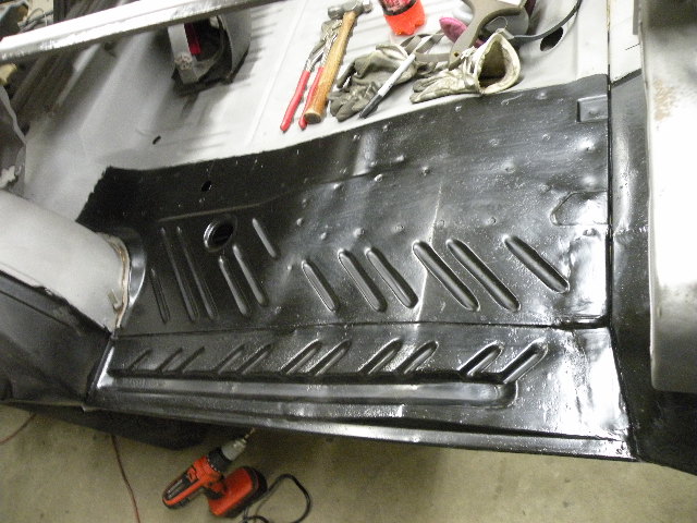

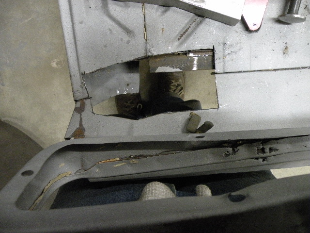

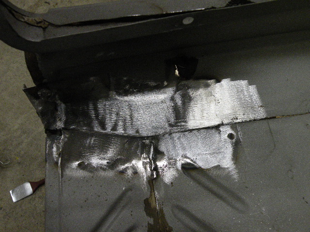

    Then we finished stripping off the old sheet metal & coated the wheel tub & inner structure where no patch panels will be be needed with Por 15.

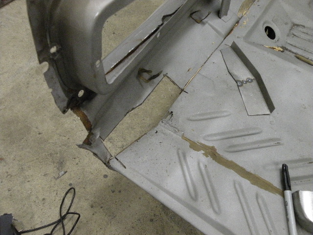

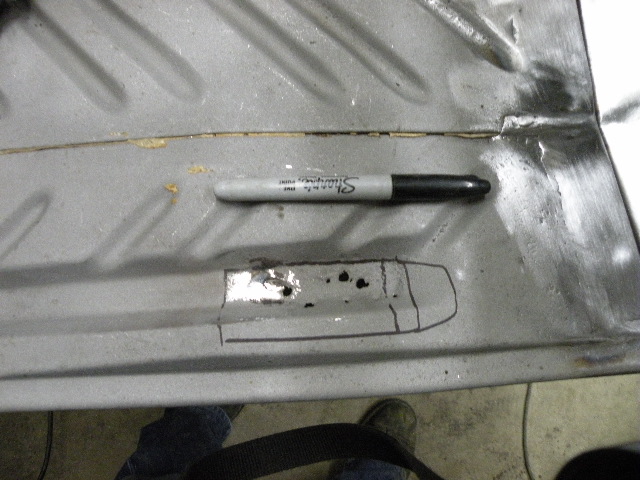

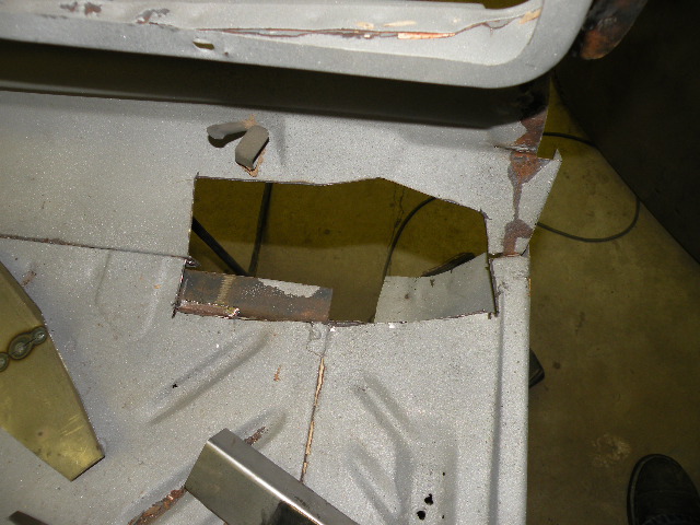

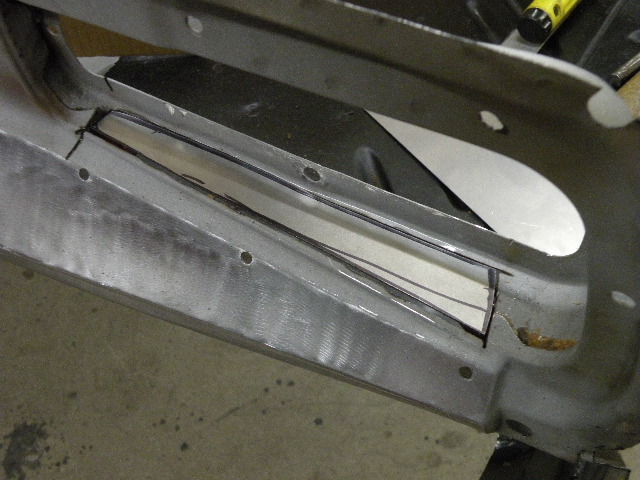

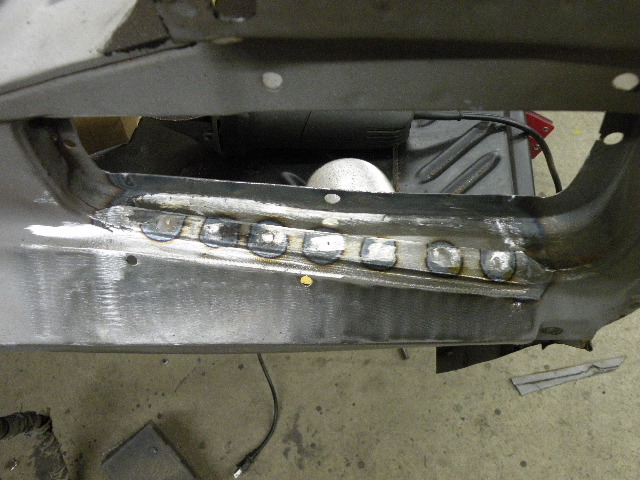

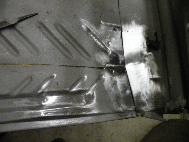

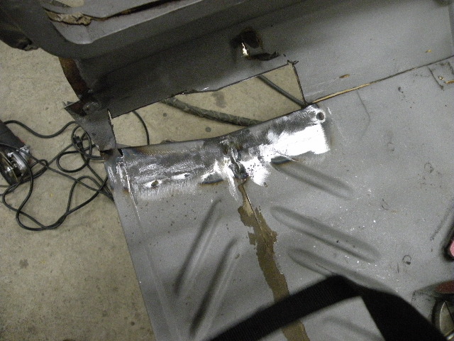

    The trunk floor needs so care in a few spots so Max started making patch panels
    Then welded them in.
    The trunk floor drop needs some attention also.
    thats it for today but more to come.

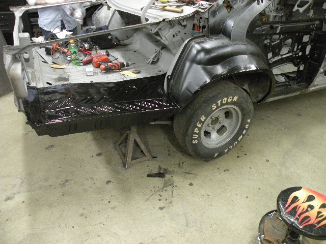

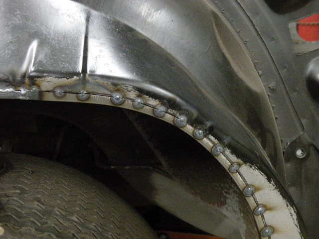

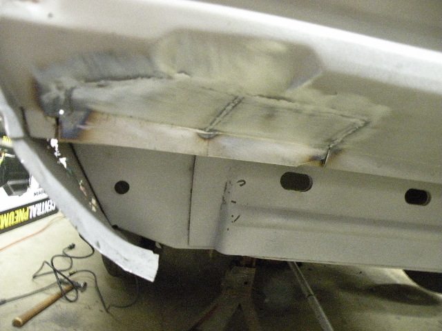

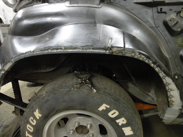

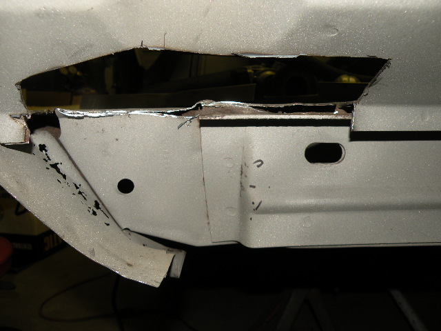

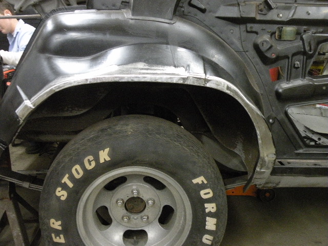

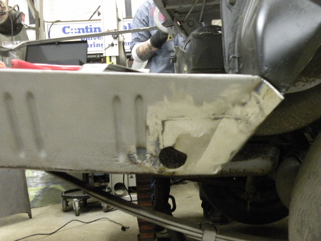

    Max did some more repairs on the Coronet today. The right wheel tub needed some patch work in the arches.
    Off to the right is Theresa our new helper she is a certified welder
    Getting prepared for Por 15.
    Por 15 coated.
    Rear patch being made for the left side Theresa is working on that side.

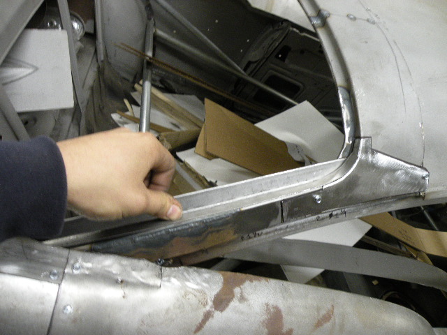

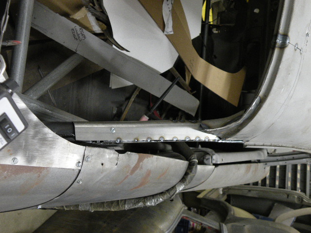

    Max was doing some more on the left rear window pillar.
    Theresa or as I call her Miss T, hang on guys she is going to be real good at this metal forming stuff, very good welder already.
    Of till next week then more on both plus more projects coming in.
