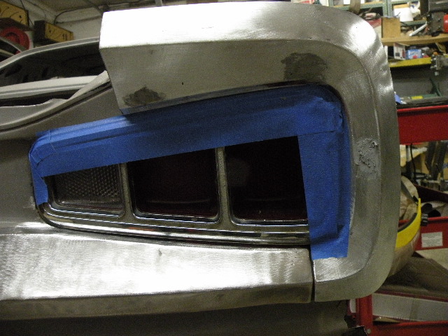

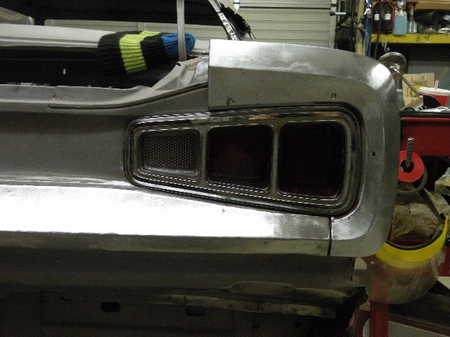

    Max was working on the left rear pillar.
    We are playing with the rear corner radius,
    The first is the Dodge pillar.
    The next 4 are different radius we are considering.
    Any thoughts.

    bent metal
    My vote, your right, no radius at all doesn't look right. Number three looks like too much. One, two and four all look about the same. I don't think you could wrong with one, two, or four. Each looks good.:)

    Out of the four radius shots I like #1 and #4 the best, but they are all nice.....Jim

    No.4 for me.

    I would go with #4, less is more in this instance. I think it flows the best with the lines that are now on the car. But what the hell do I know ? :D

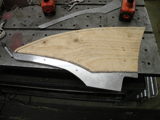

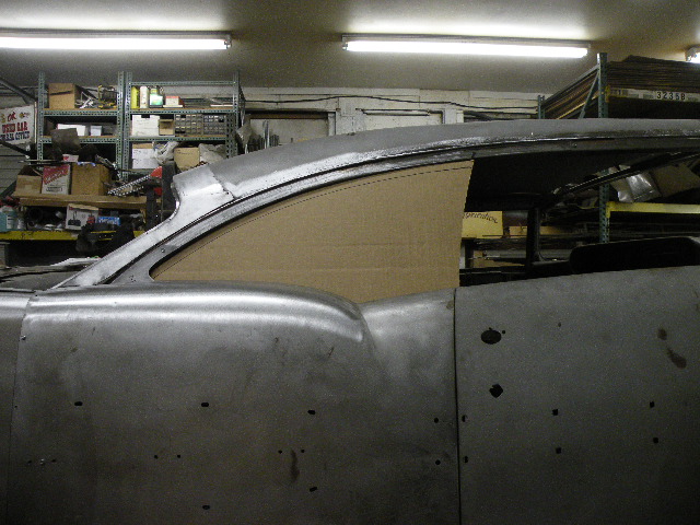

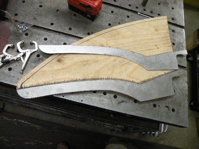

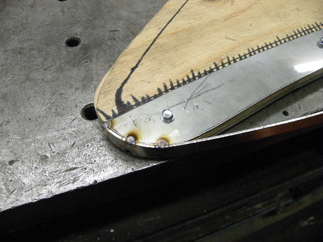

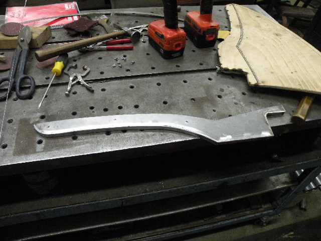

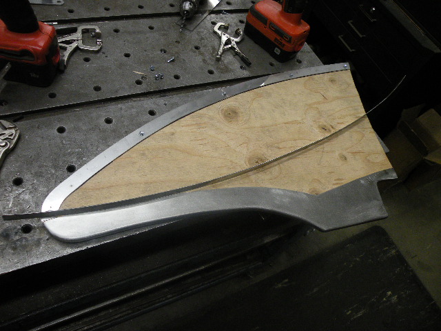

    Max started working on the rear quarter gl*** frame it is 100 thousands thick 304 stainless. The frame & chanel system will be built before the quarter is finished, we need to make sure every thing works & fits together before doing the final install on the quarter.

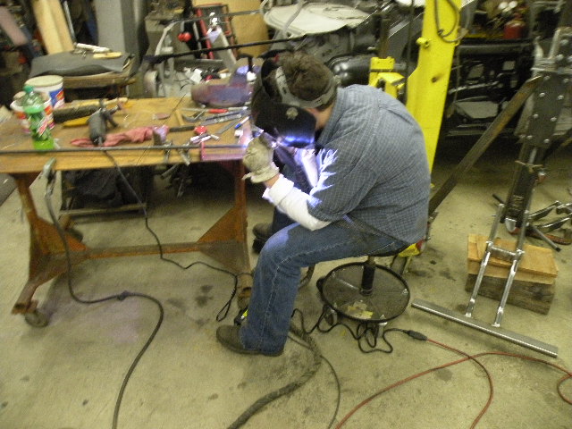

    Miss T doing some tig welding on some machines we are building & need to finish up.
    Once they are out of here then I will be finishing up the building expansion so we will have room for other projects waiting to come in.

    Nice frame for the gl***, I guess you mechanism will attach to that for moving up and down??, or will it be stationary....Jim

    Due to over whelming demand namely the owners choice which we here in the shop agreed with it's # 4 for the rear corner radius. The rear windows will be fully functional.

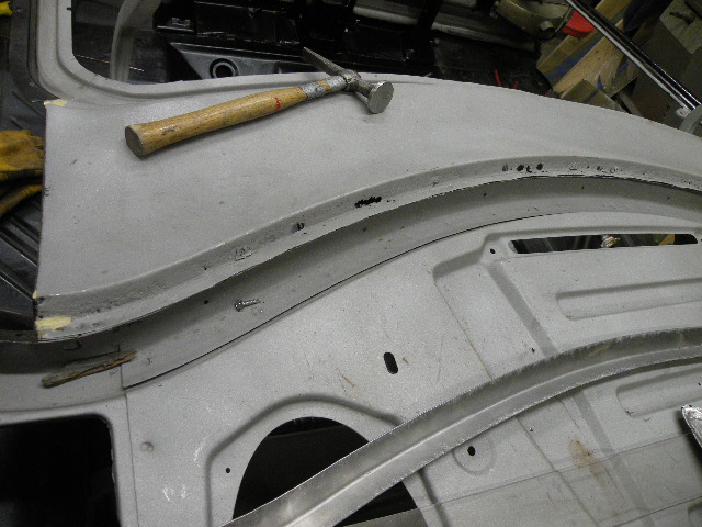

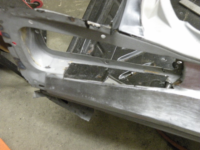

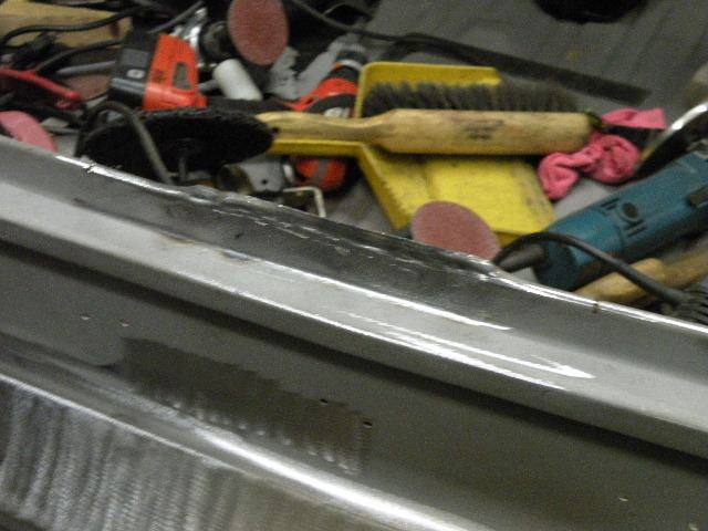

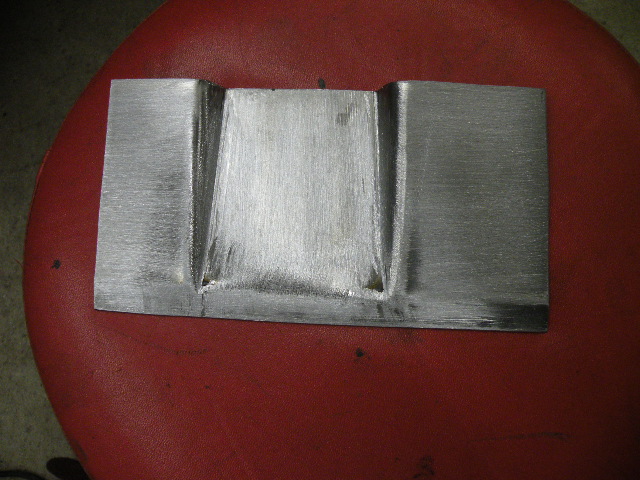

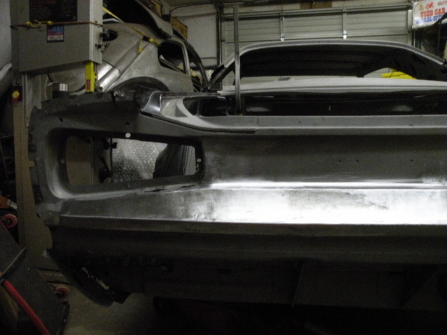

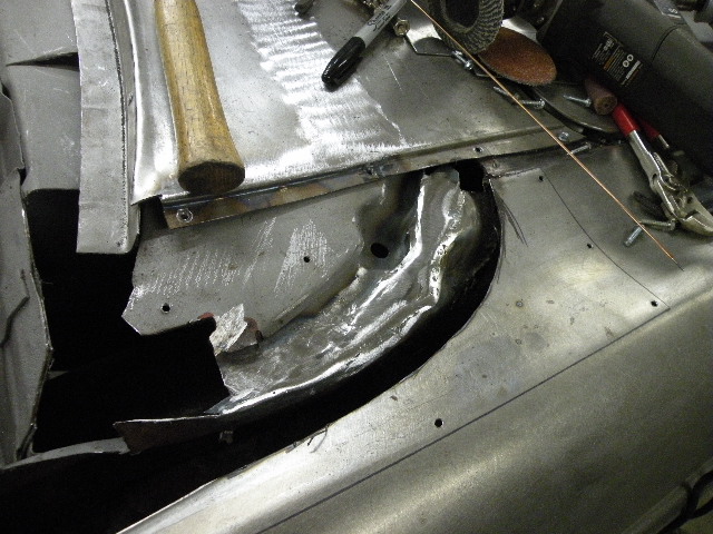

    Max spent the last couple of days working on the Coronet & Teresa helped & learned on Friday. Now its your turn look at the pictures & see if you can see what he did some is obvious & some is suttle.
    So what do we see.
  17. carbuilder
    Joined: Nov 21, 2006
    Posts: 982
    carbuilder

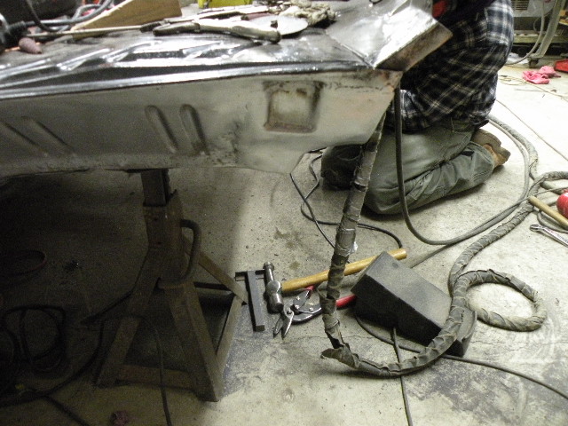

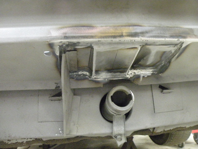

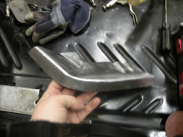

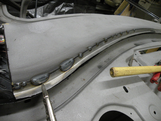

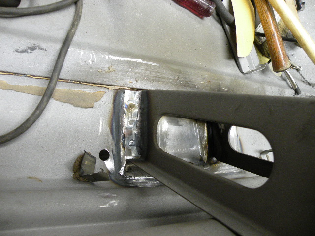

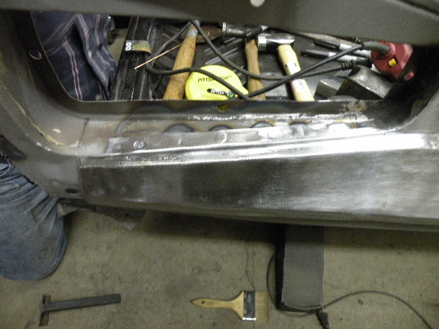

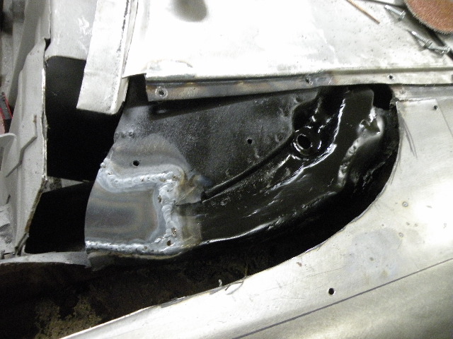

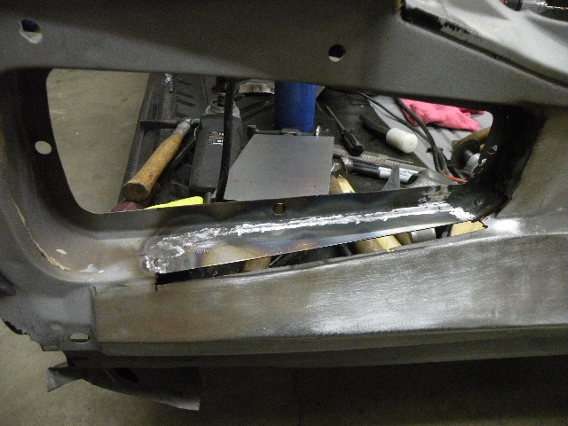

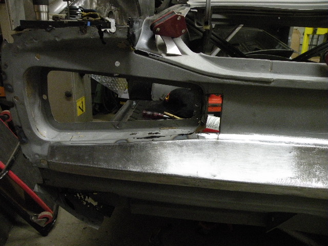

    Max finished the repair on the rear quarter extension.
    The trunk latch area need some attention.
    Miss T finished the left drop off rear.

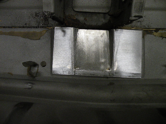

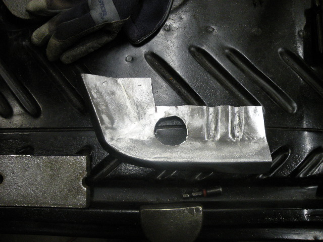

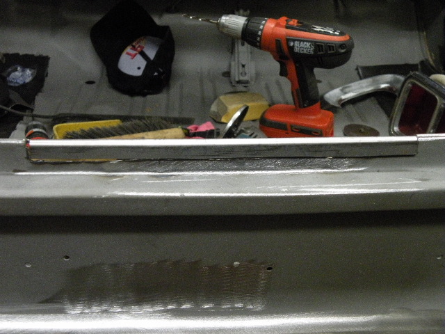

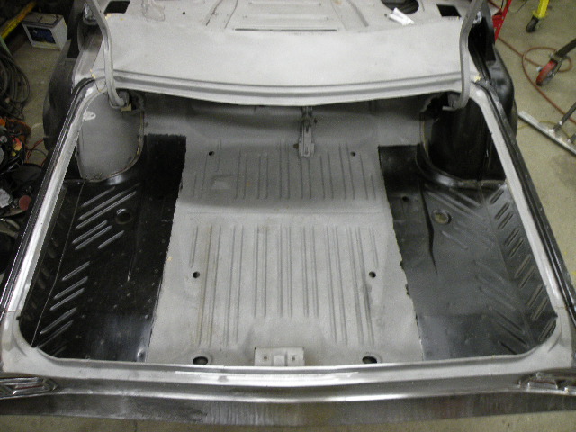

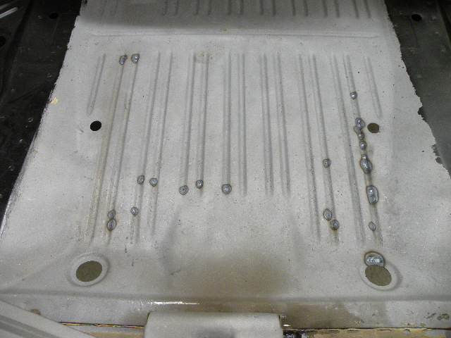

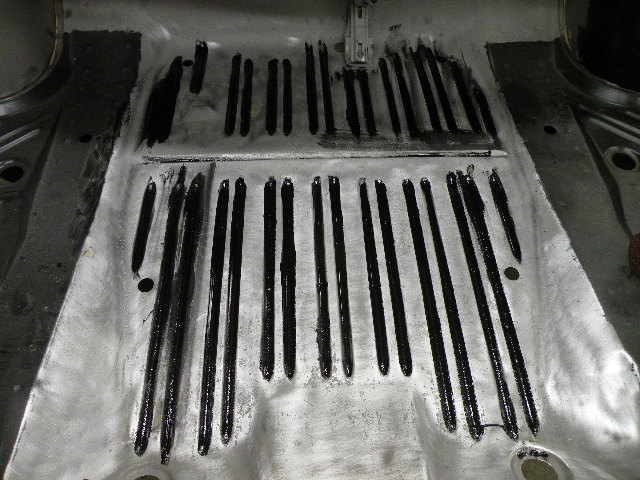

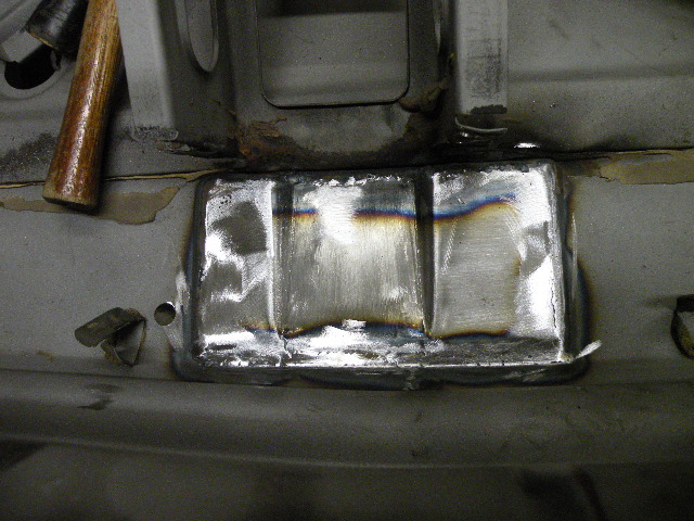

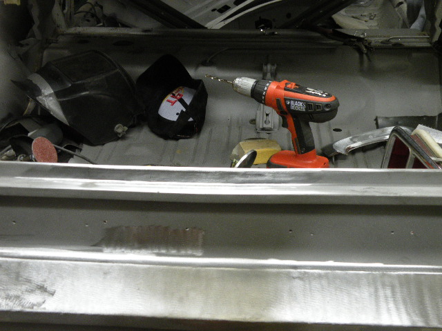

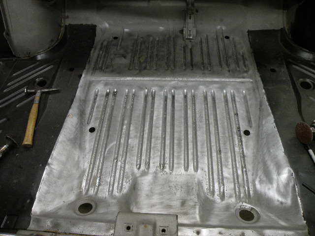

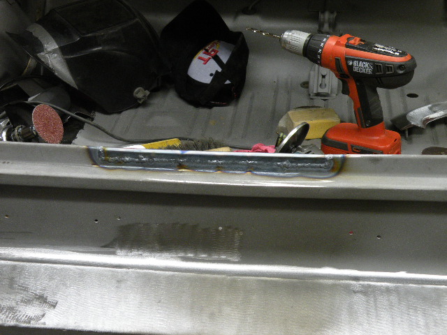

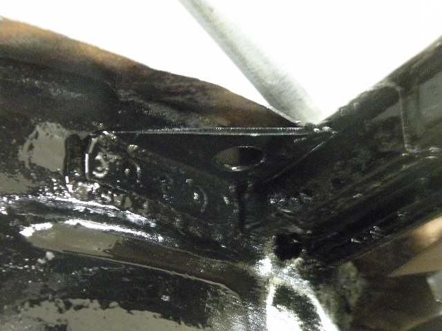

    The trunk floor had some pinholes needing repair.
    Tig welded up.
    Welds ground.
    The ribs were coated with Por 15 then once it started tacking up the rest of the floor was coated that way there is 2 good coats on the repaired areas.

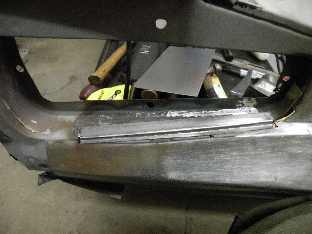

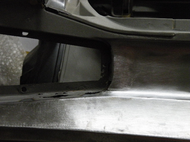

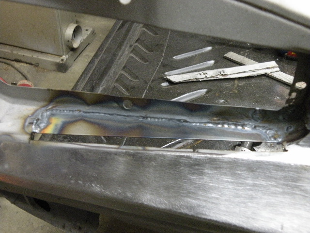

    The rear window chanel needs some attention.
    Patch section made & checked for fit.
    rotted stuff cut out
    Underneath cleaned & coated with por 15.
    Replacement panel trimmed & ready to weld in.
    Tack welded in.
    Thats it for today.

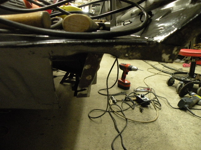

    Miss T was working on the Coronet Drop offs.

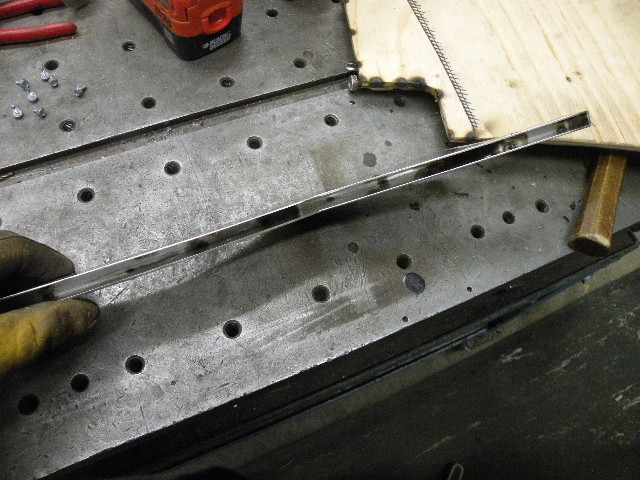

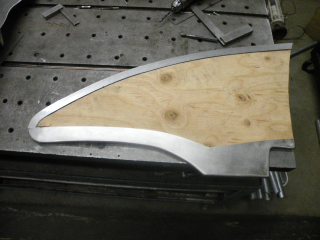

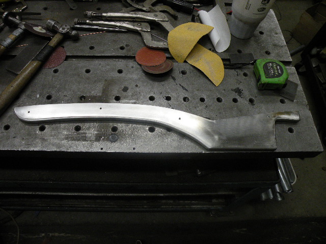

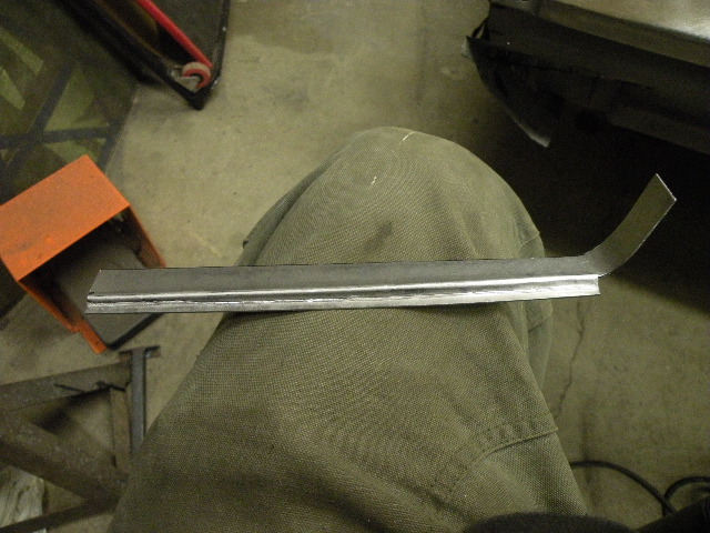

    Max finished welding & grinding the rear quarter gl*** stainless lower molding.
    Now he is working on making the upper stainless trim.
    Thats it for today.

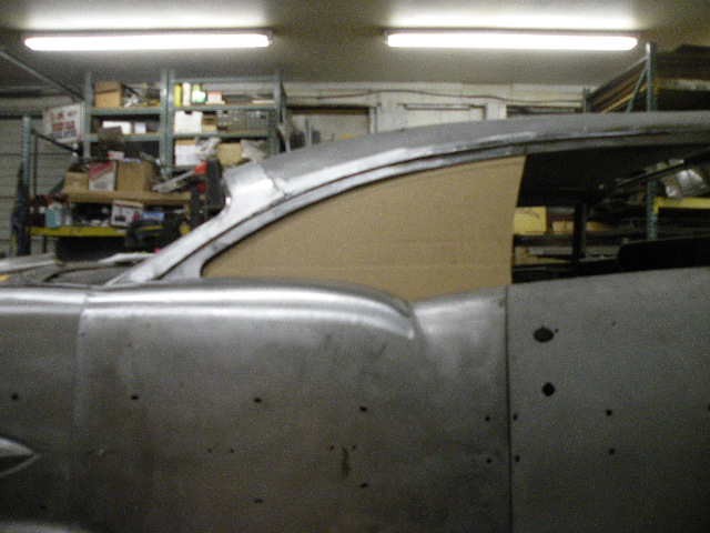

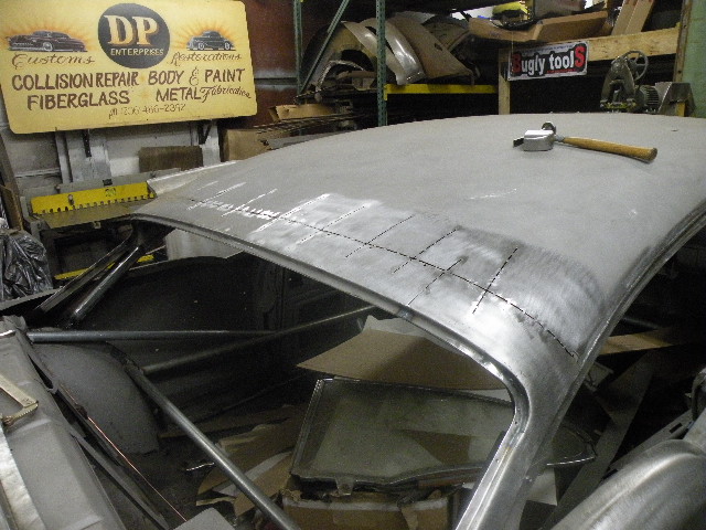

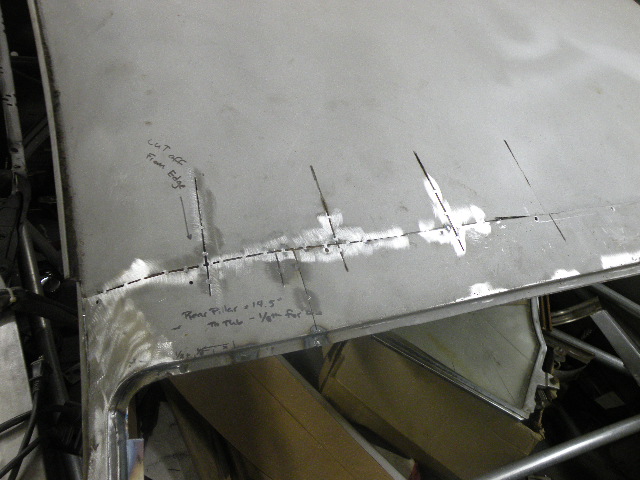

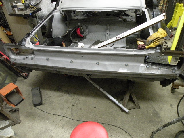

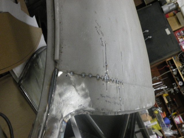

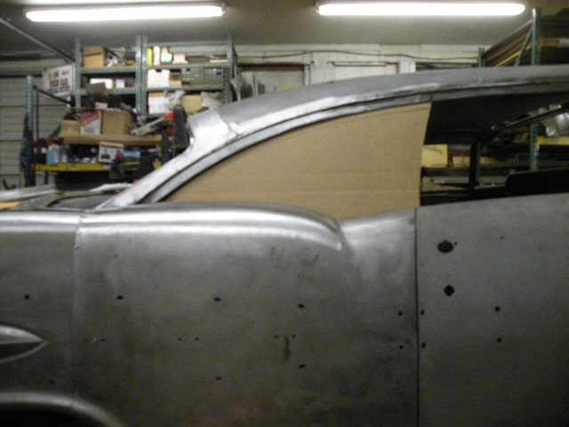

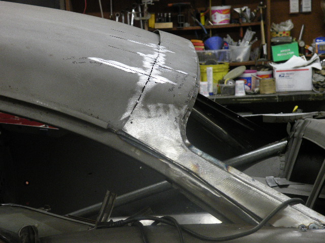

    Max did some finish tacking & blending of the roof rear section.
    I do believe it is starting to flow quite well now.

    Joined: Jan 19, 2004
    Posts: 710
    Sinister
    from Oregon
    That flows really well. Very nice work.
  30. oldman2
    Joined: Sep 9, 2010
    Posts: 2,373
    oldman2
    That roof looks good from all angles, very nice. Pic #7 really shows how well the rear side gl*** will look in the car, nice job.....Jim
