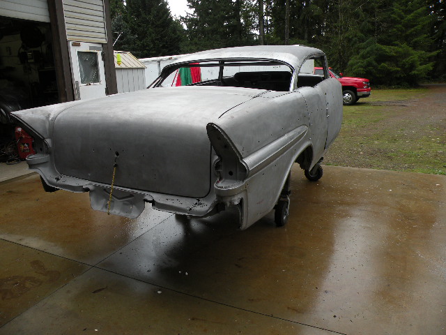

    The last pic above says it all ! Perfect flow on that top !

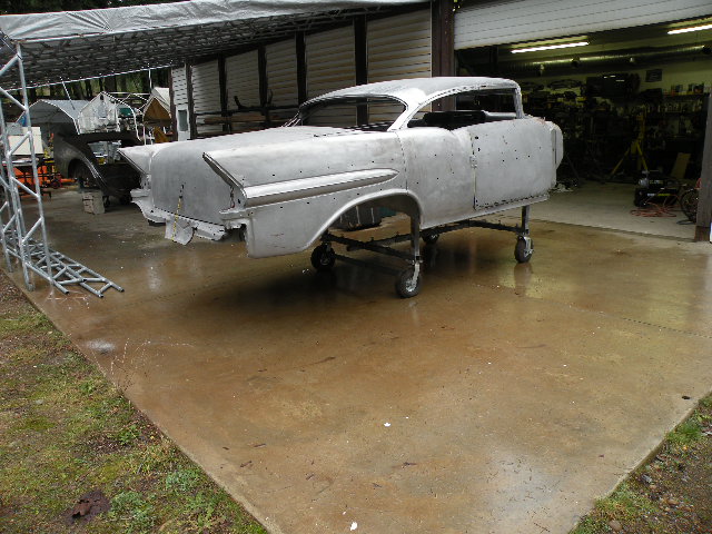

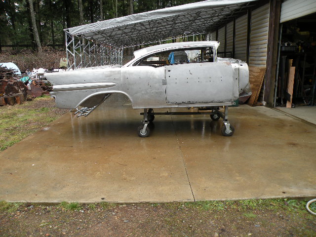

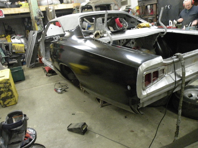

    Max was working on tacking the front windshield section getting ready for transport.
    This is our version of a high tec door latch system, just don't get in a hurry to get in or out.:D
    He tacked the rear quarters on for transport.
    A few more thing next week then of to storage for awhile.

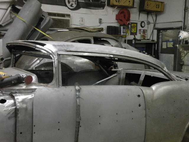

  4. carbuilder
    Joined: Nov 21, 2006
    Posts: 982
    carbuilder

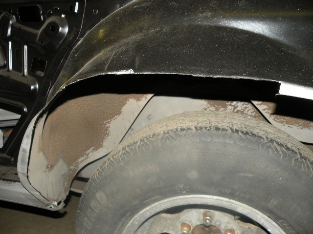

    Teresa has been working on the Coronet.
    Considering Teresa has only been doing sheet metal work for about 2 months now she is starting to understand how to do things.

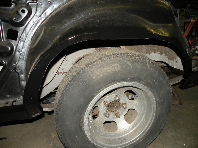

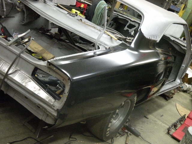

  11. carbuilder
    Posts: 982
    carbuilder

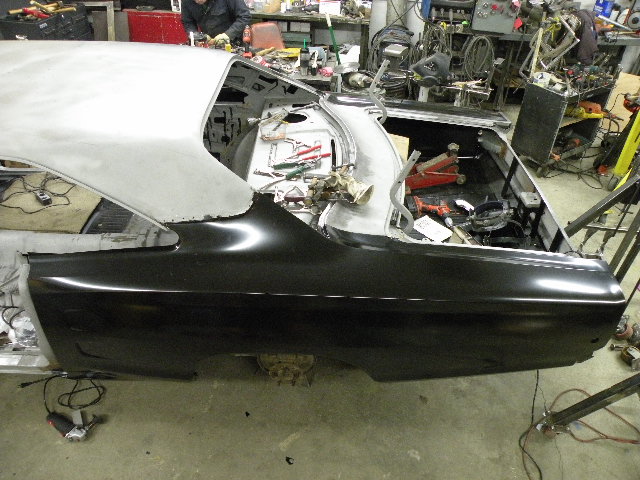

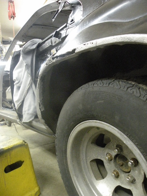

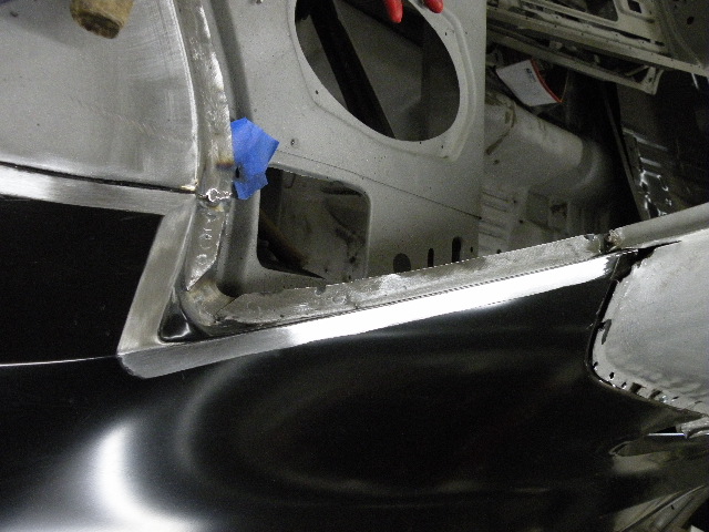

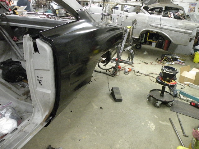

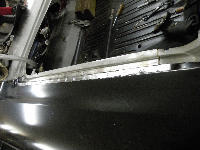

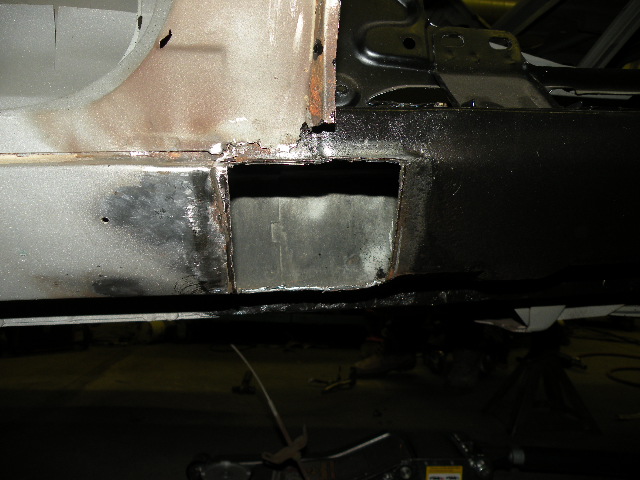

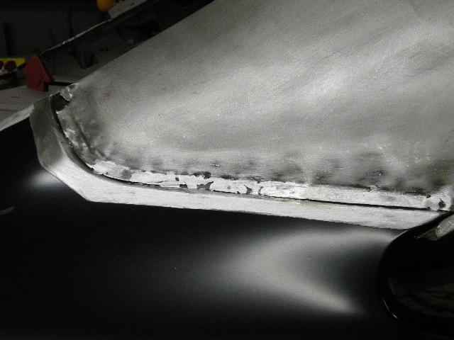

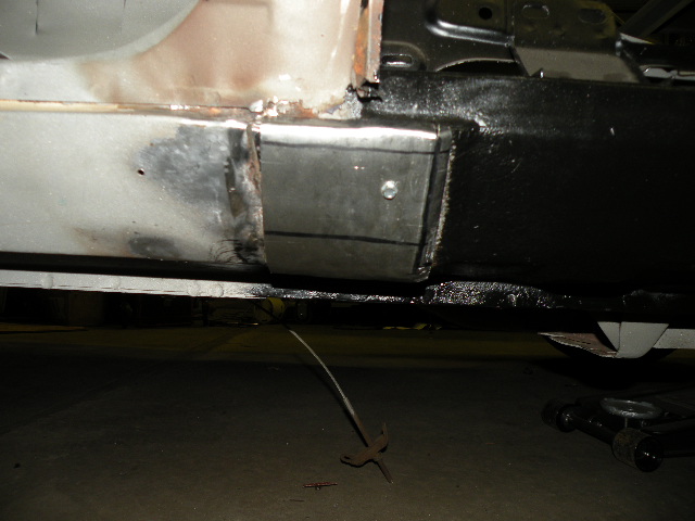

    Miss T was working on finishing up the lower left quarter inner areas so they can start the fit of the quarter.
    Max is finishing up the right quarter.

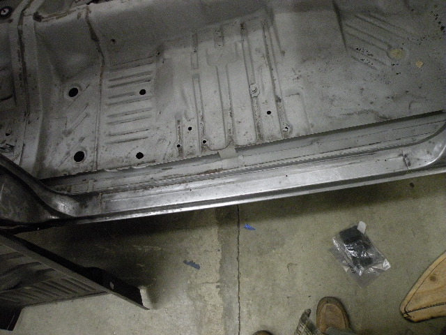

  15. carbuilder
    Posts: 982
    carbuilder

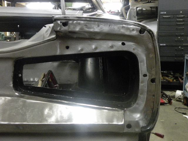

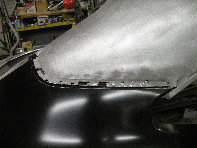

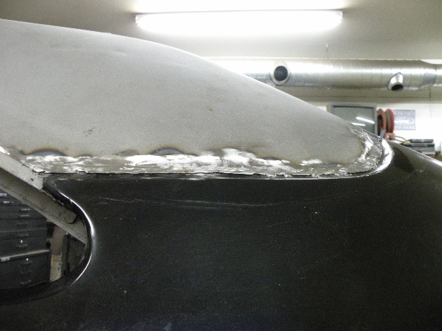

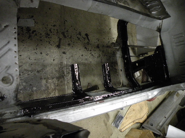

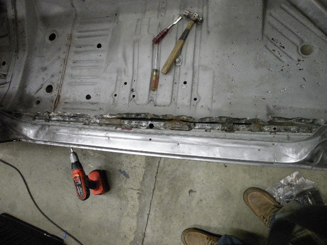

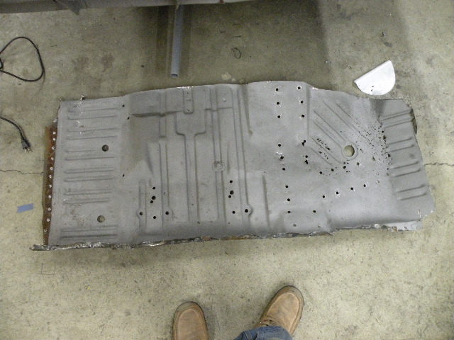

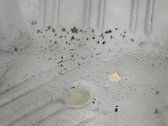

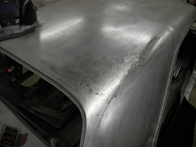

    Max did a small dent repair on the right side roof nothing fancy just goo old hammer, dolly & shrink disc stuff.

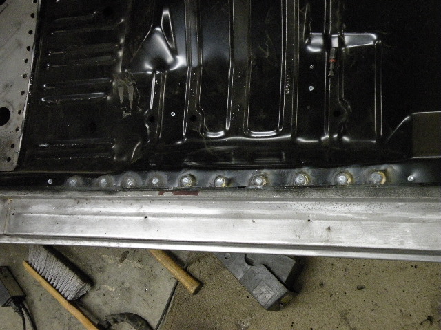

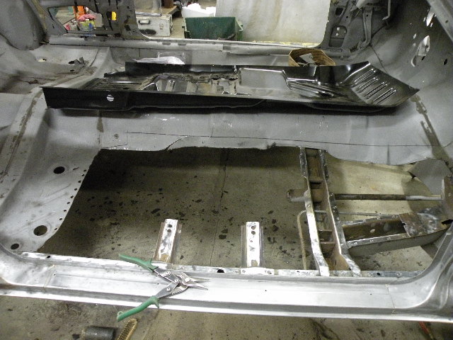

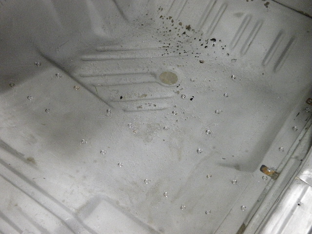

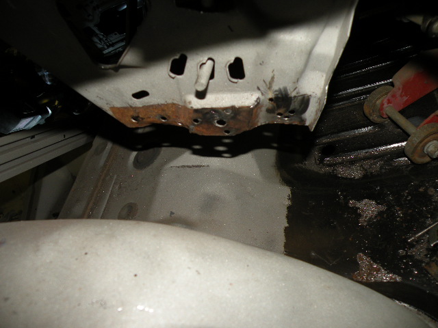

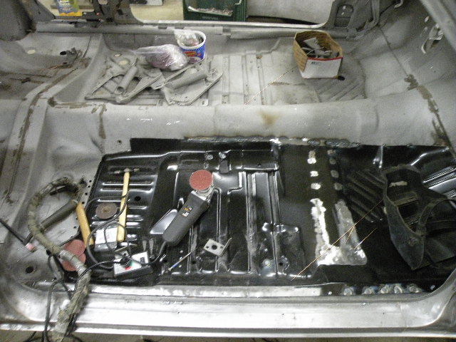

    Then he started removing the right floor where all the rust mites have been. Lots of spot weld drilling & cutting.
    More tomorrow.
  16. carbuilder
    Posts: 982
    carbuilder

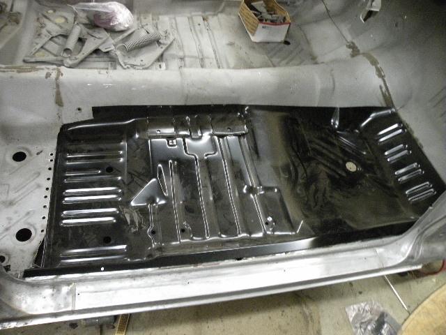

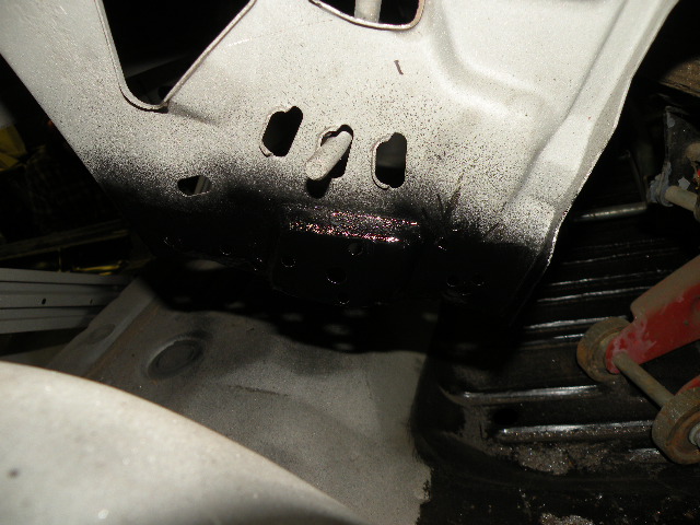

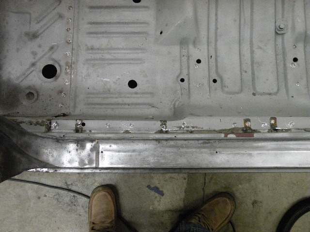

    Max was working on the right floor section today, he put in the new section to mark for final t*******.
    All the spot weld areas where ground smooth & cleaned.
    All the to be welded sections & inner structures were painted with Por 15.
    New panel put in for final fit.
    Start welding in.
    More tomorrow.

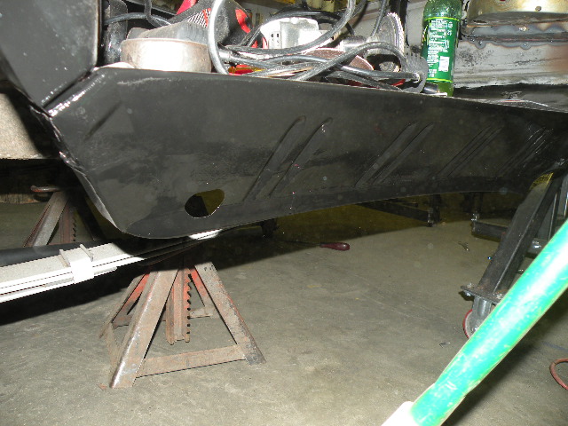

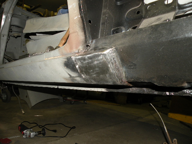

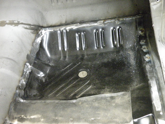

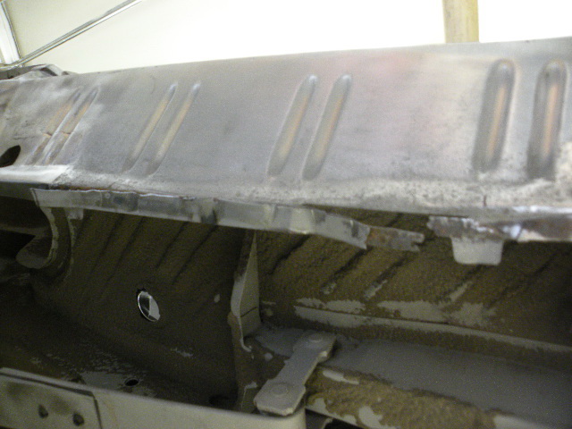

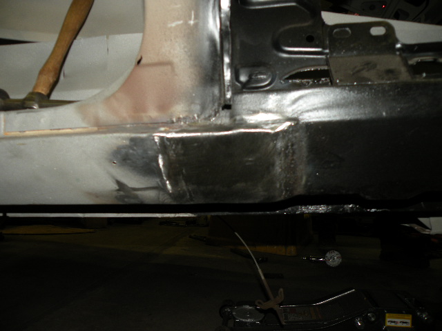

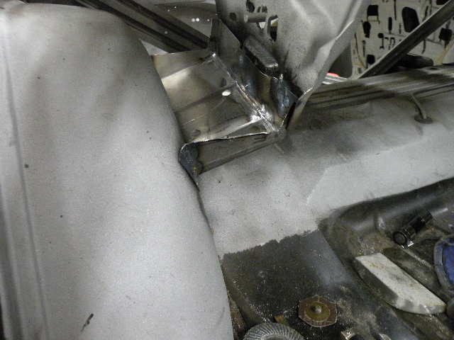

    Max worked on the floor pan right side welding & grinding.

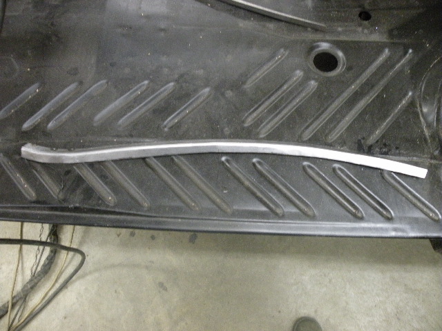

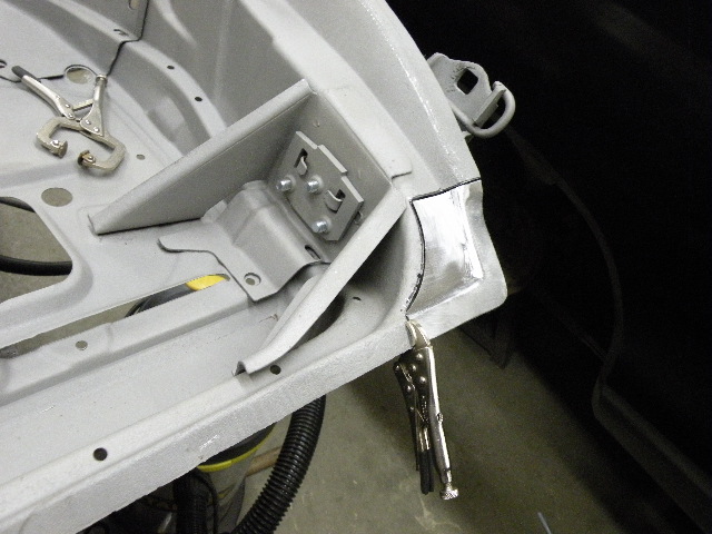

    Miss T made a rear filler panel support bracket.
    More later.

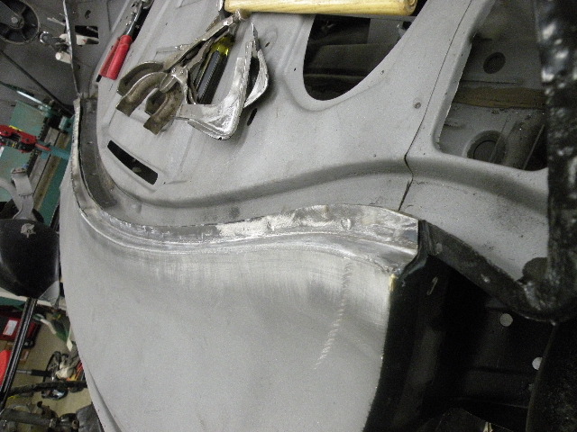

  19. carbuilder
    Posts: 982
    carbuilder

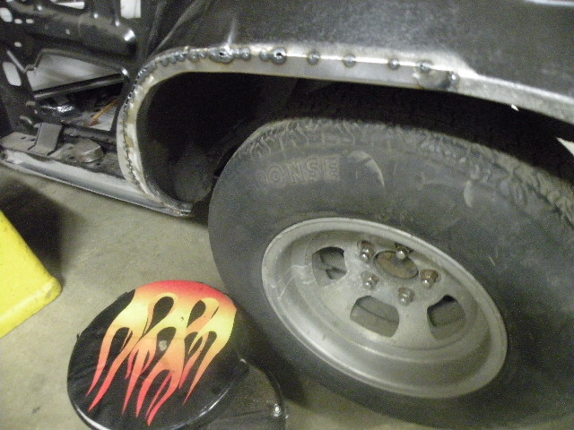

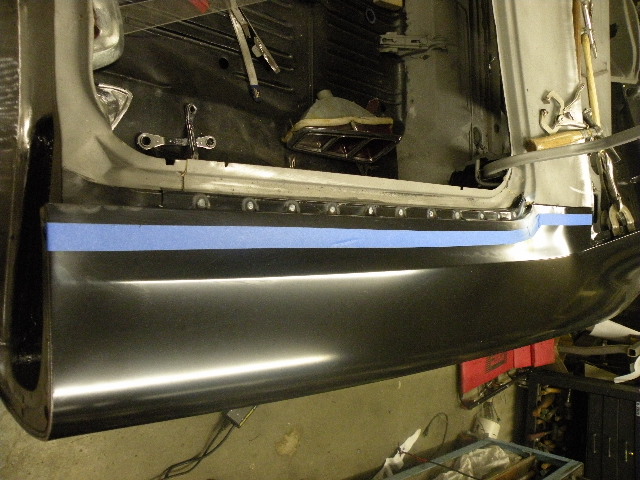

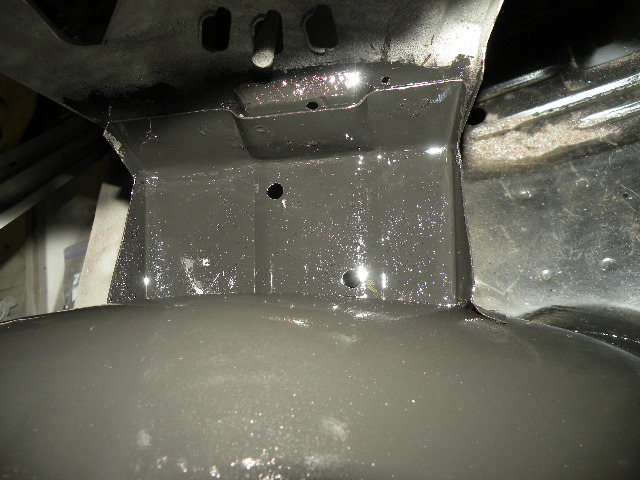

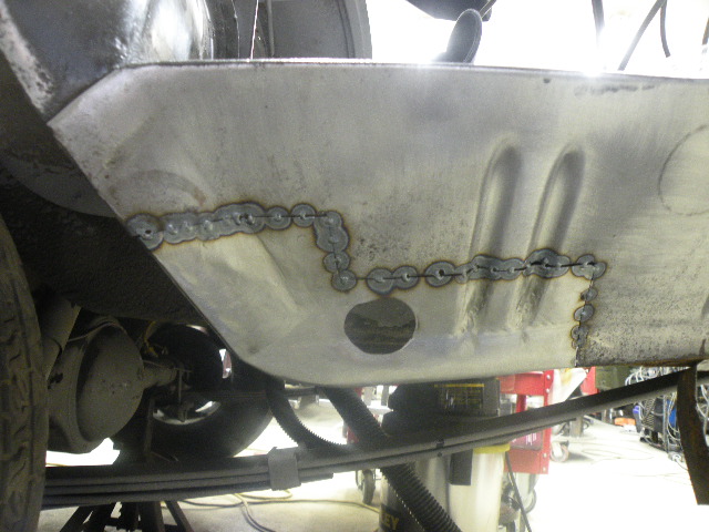

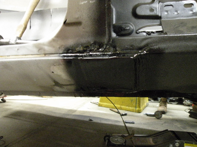

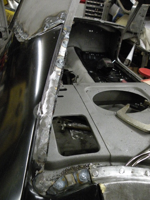

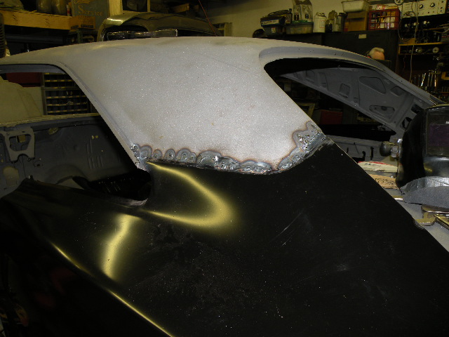

    max finished welding the right floor pan & ground the rest of the welds then coated the bare metal with por 15.

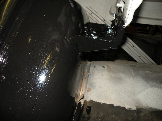

    Miss T finished the inner support bracket then coated it & the wheel tub with Por 15.

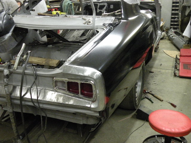

    Next she installed the left quarter panel getting it ready to weld.
    Start tig welding.
    More after the first of the year.

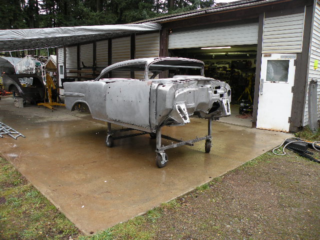

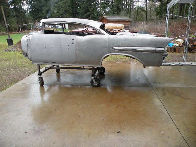

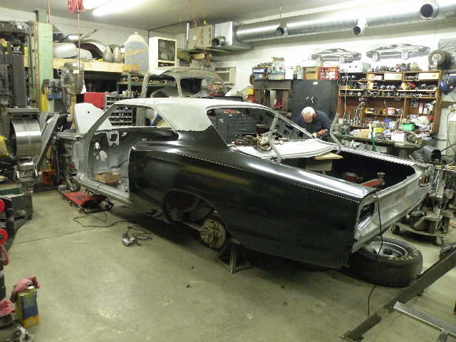

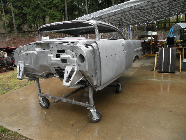

    I loaded the Pontiac on the trailer & took it to the owners garage. It will be back between mid April to first of May once the owners business picks back up. So I took a few last pictures before loading.
    I really like the flow of the 57 Dodge 2 dr post roof on the what use to be 57 4 dr sedan it makes quite the change. I have another project coming in tomorrow unless the weather is garbage. Max & Miss T will be back Jan 3 so I will be back to posting what is going on in the shop then.

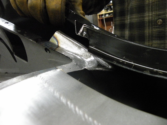

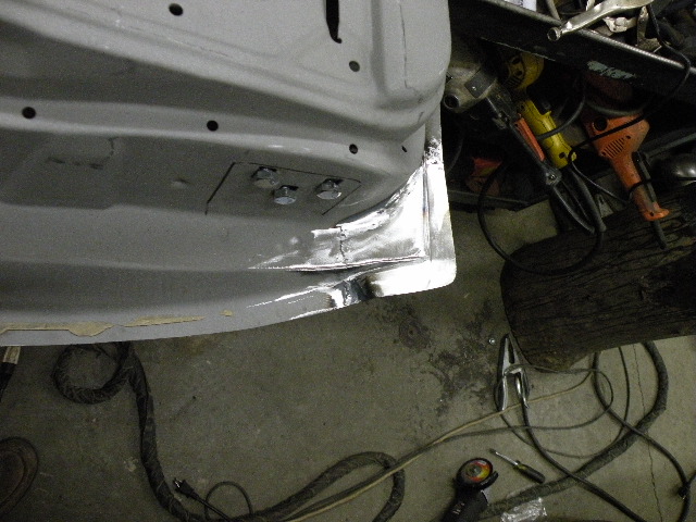

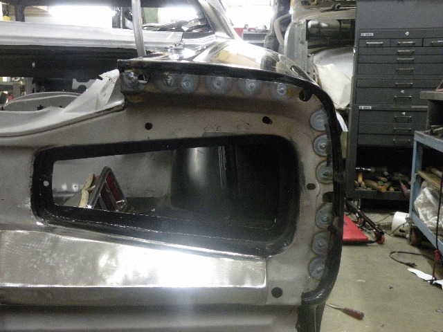

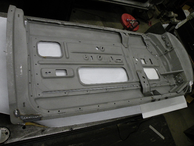

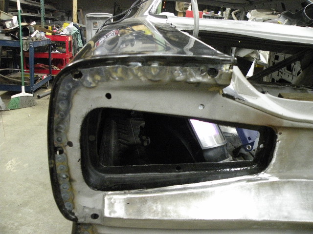

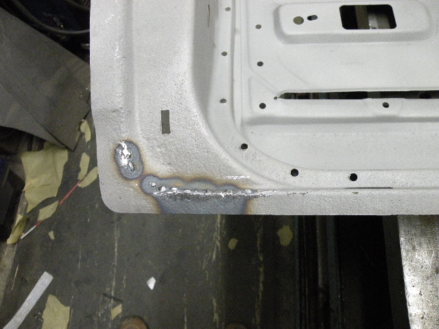

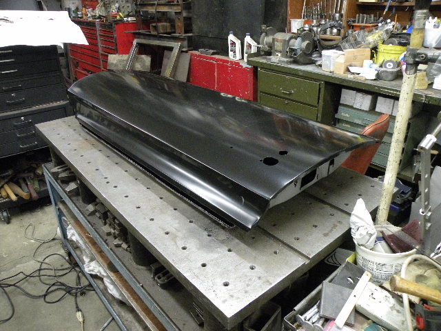

    Max & Miss T are back working on the Coronet. Max re bushed & pinned the right door hinges then made a patch for a bottom corner of the door.
    Miss T did some welding on the left quarter.
    More to come tomorrow.

    carbuilder

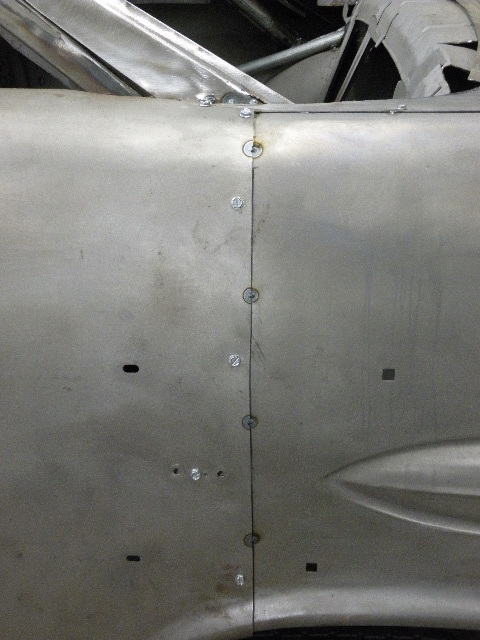

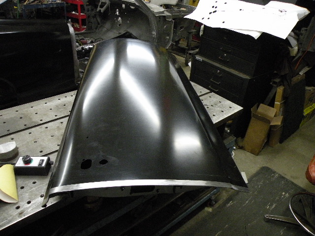

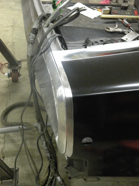

    Max did some finish work on the right door to install the new skin.
    Miss T did some work on the left quarter.
