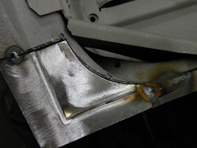

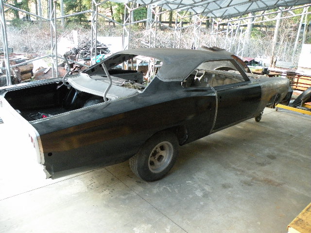

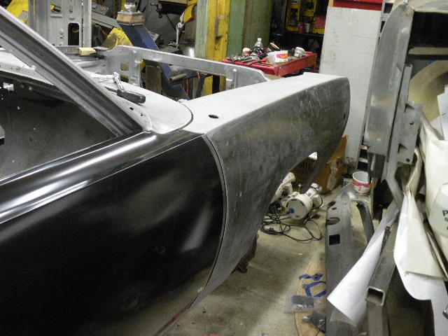

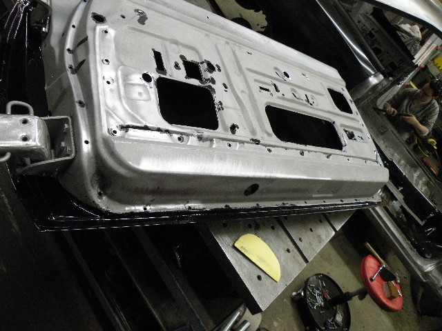

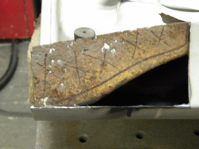

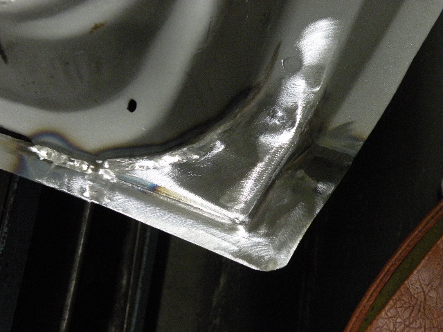

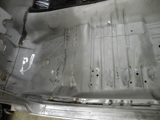

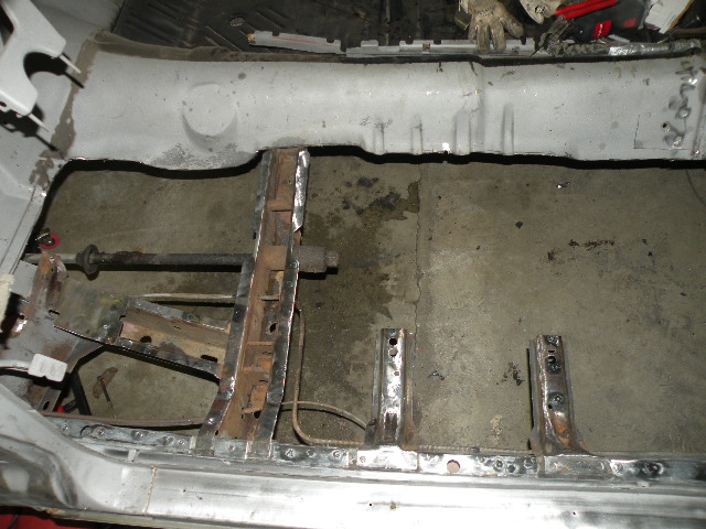

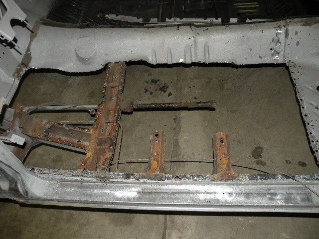

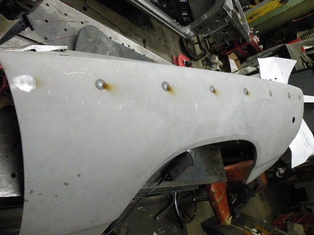

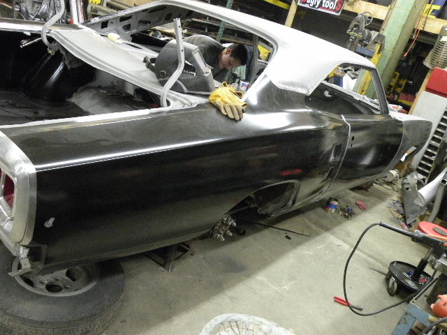

    Miss T has been working on the coronet left floor.

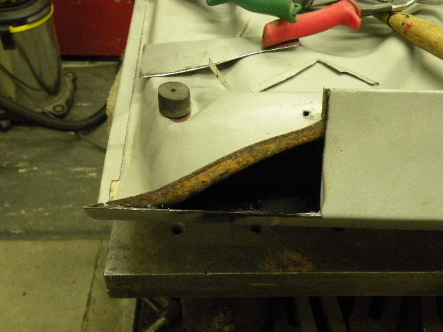

    Max was working on finishing the right door.

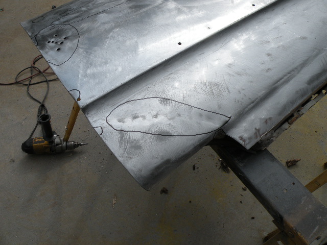

    He also was working on the right fender filling the old trim holes plus the was a good sized dent foot ball size about 1 inch deep below the 3rd & 4 hole back from the front
    Holes ground down.
    Some hammer dolly & shrink disk work.
    Nice straight & clean & every thing fitting well.
    Some repair on the left door.
    That all for tonight more tomorrow.

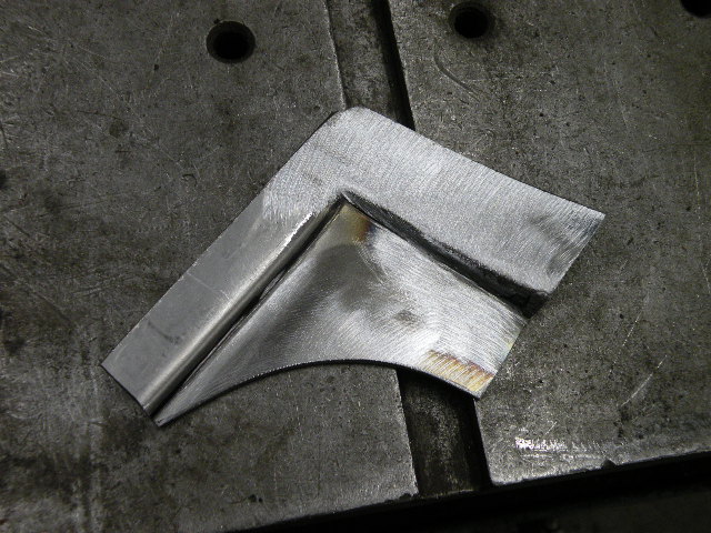

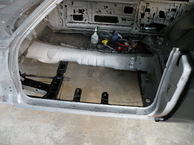

    Max worked on the left door.
    We rolled it out side to do a little shop clean up & re org panels are fitting well. We also brought in another project.

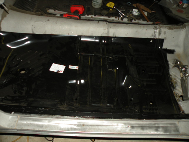

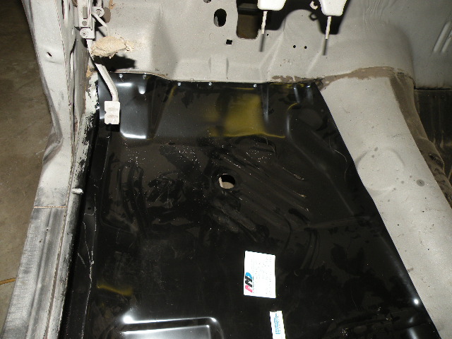

    Miss T started installing the new left floor pan.
    More on the way.

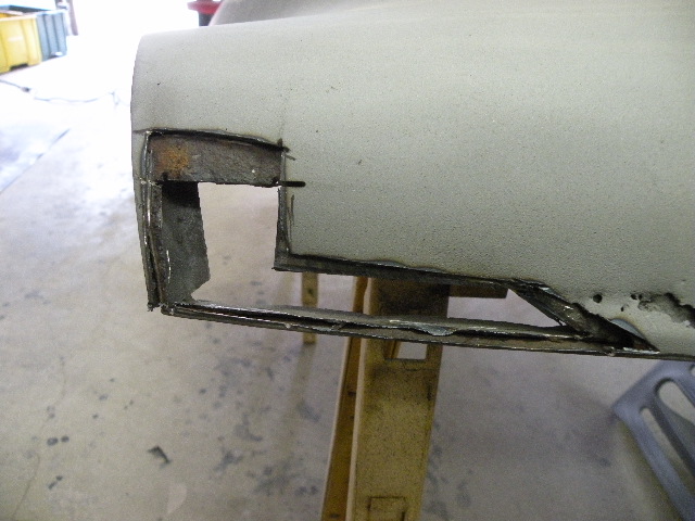

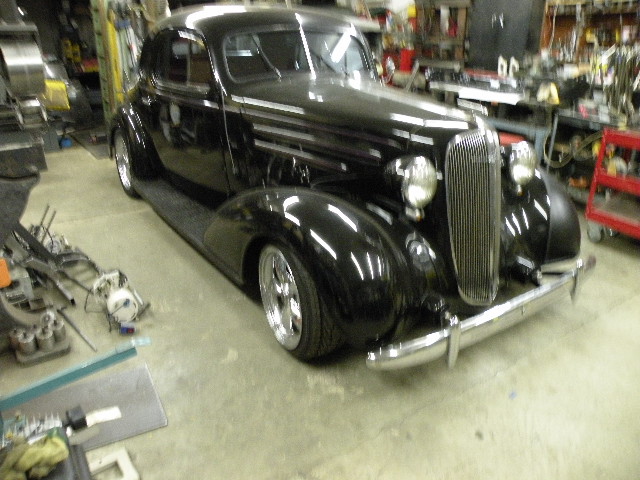

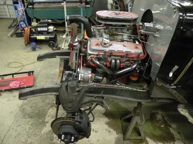

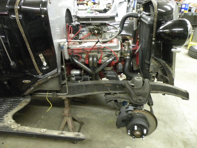

    The 36 Chev we had is back for some up grading of a few things First we are replacing the mustang II car suspension with a Heidts power rack suspension & second we will be rebuilding the left front fender to match the right plus a few other small things. Which I will mention later as the build progresses. So here is what we are starting with.
    The old cobbed in out of a car front suspension.
    More later on this project, the last of the Coronet build & a few other things to come.

    Nice car, I can see why you want to remove that front end! What year mustang is that from, nothing like the 74-78 version?.....Jim

    Jim I do not know what year it is out of all I know is it steers like **** & the women that owns the car has a hard time driving it. Originally she wanted just to add a power rack till I explained how bad it cobbed in & just adding a power unit would not fix all the problems, her & husband had a discussion & decided just fix it wright as they plan on driving it for several years. They have a couple of other rigs but this is the one getting the attention now with the other later.

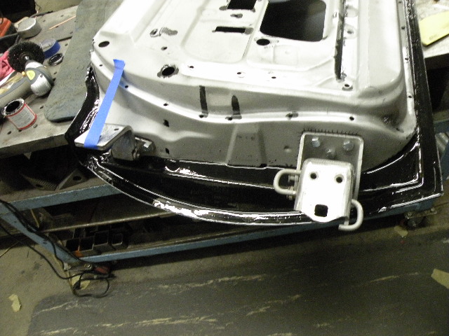

    Max was installing the door skin on the left door.
    Miss T was welding in the left floor pan. This project is getting close to being done just a few more things. Then on to other projects.

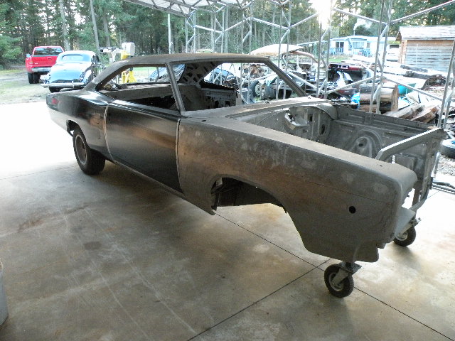

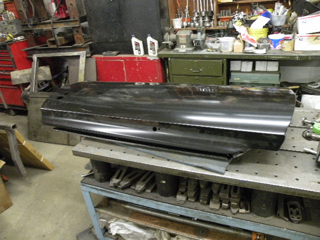

    Max was working on the trunk lid of the Coronet.
    More to come.

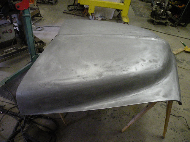

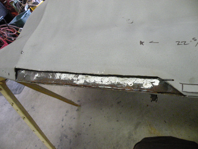

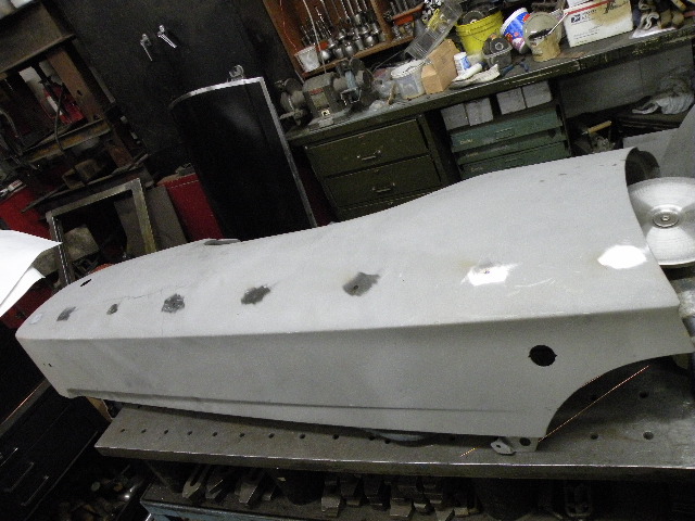

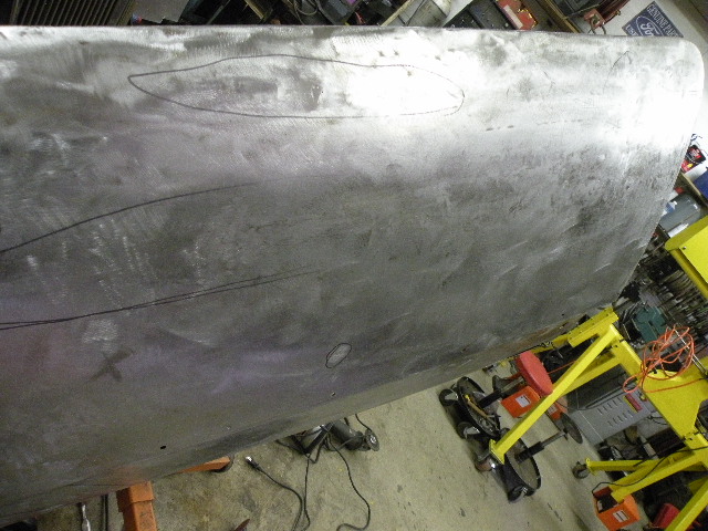

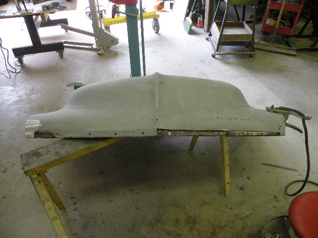

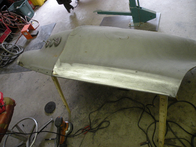

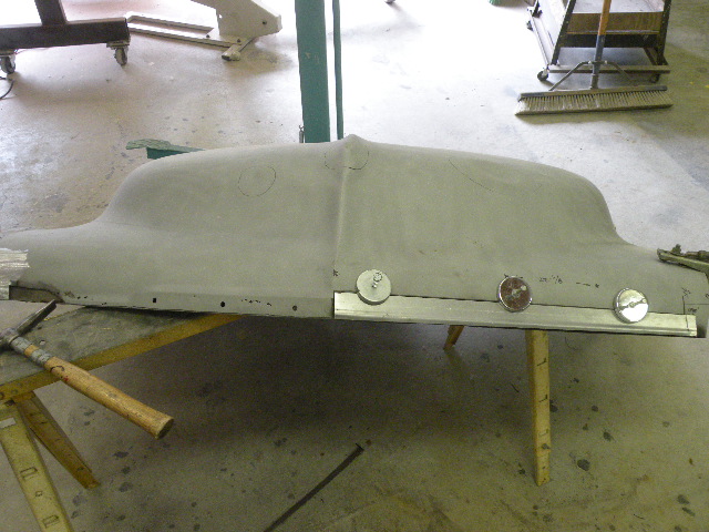

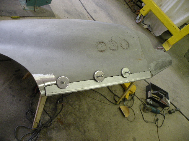

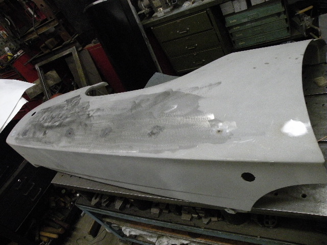

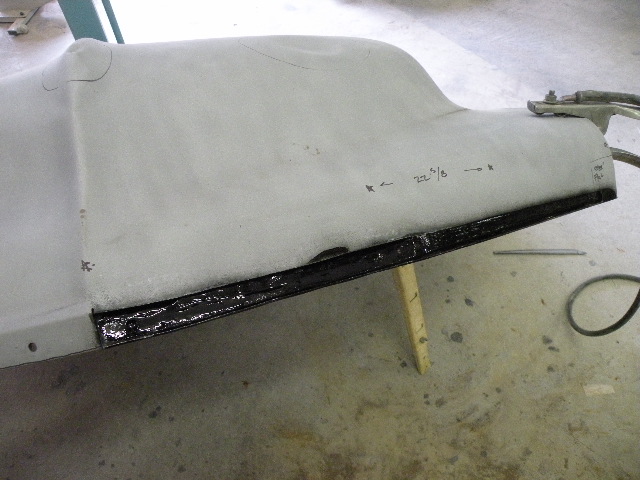

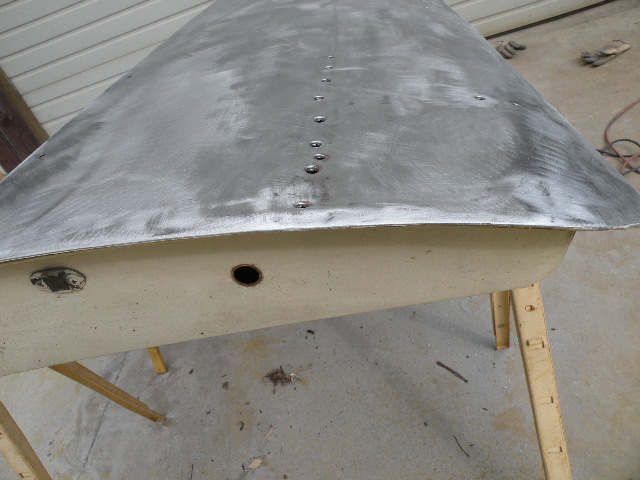

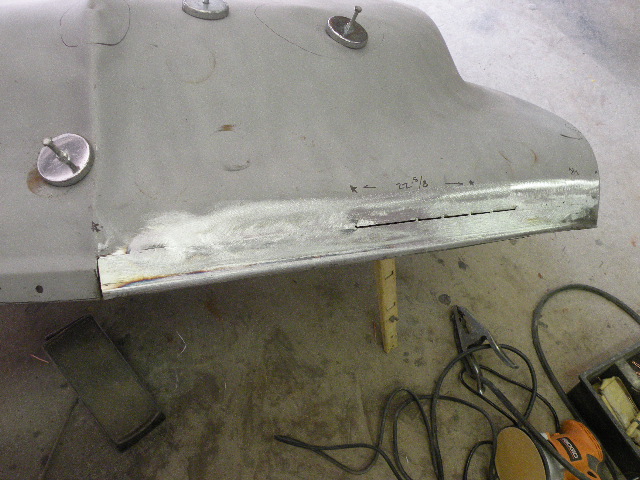

    Attempting to get back to work health issues with back & neck 3 hernated discs. But here is a 53 Stud pu hood being done with a custom front edge touch suttle but clean.
  24. carbuilder
    Joined: Nov 21, 2006
    Posts: 982
    carbuilder

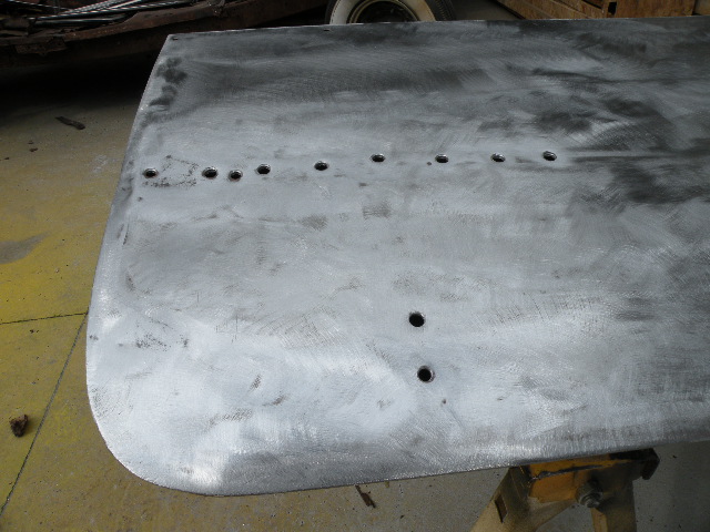

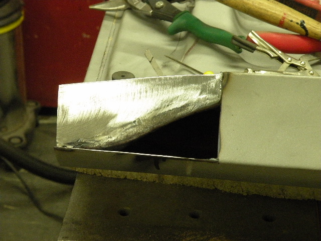

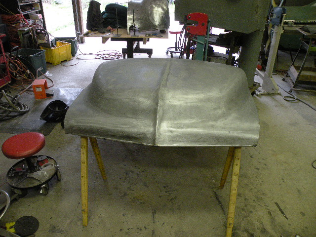

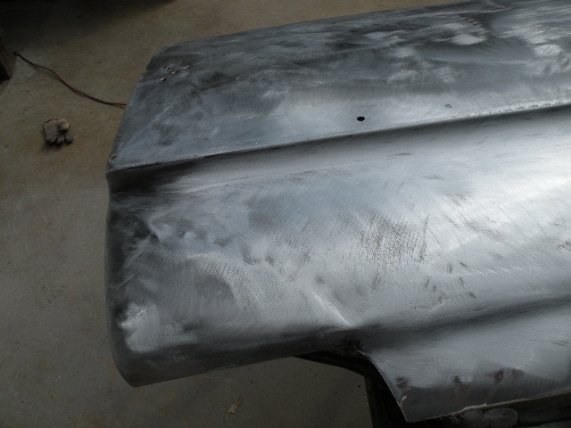

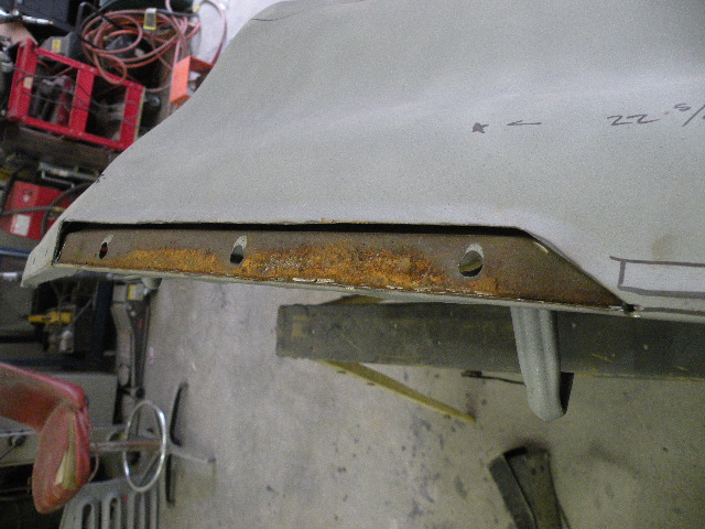

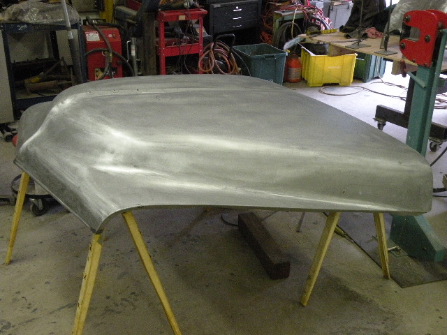

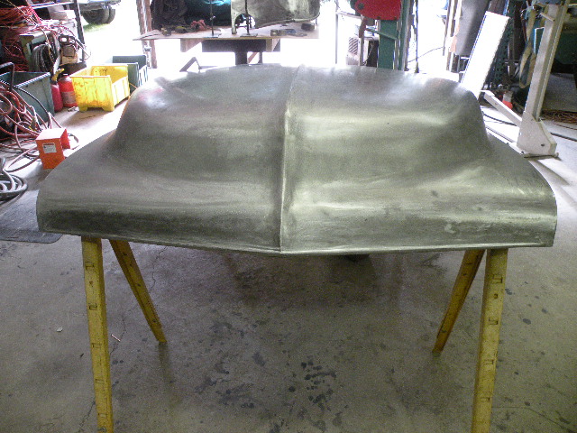

    here is the last of the Stude PU hood its almost done a couple more small dings to fix & ready for the customer to PU.

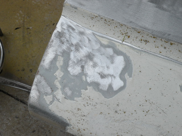

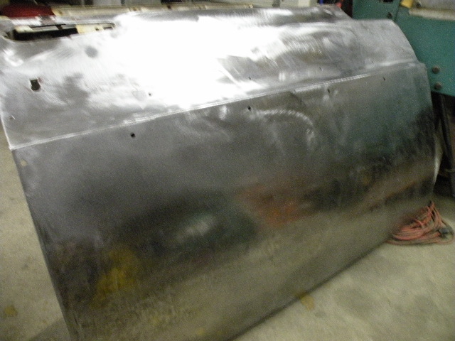

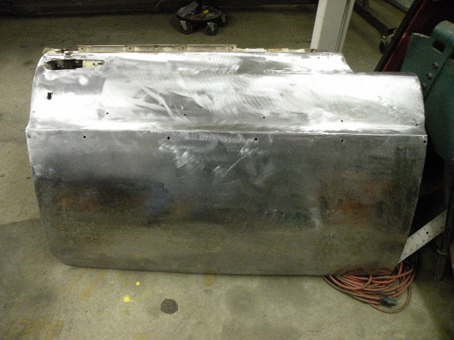

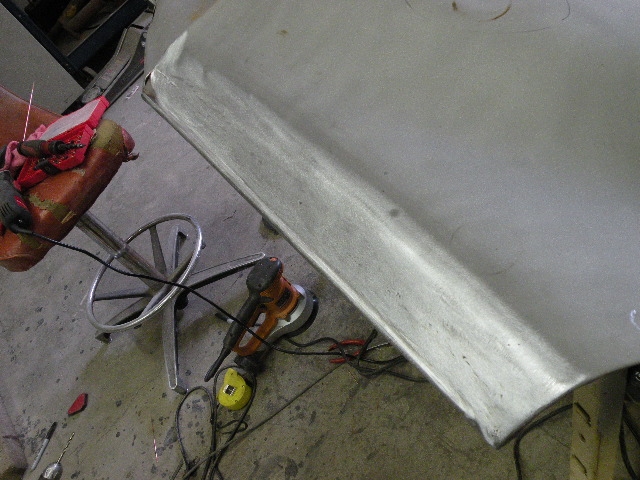

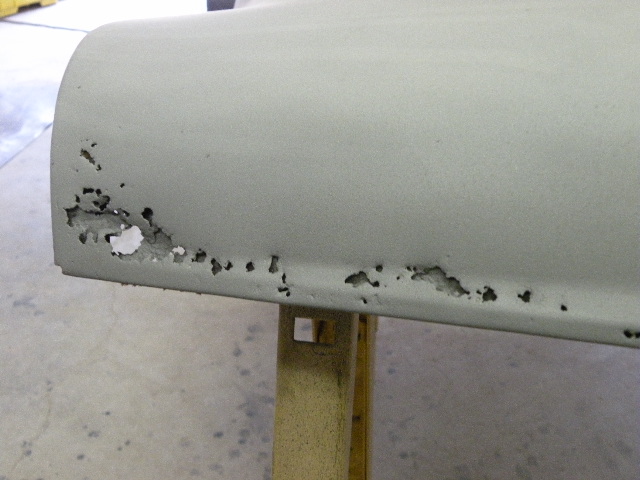

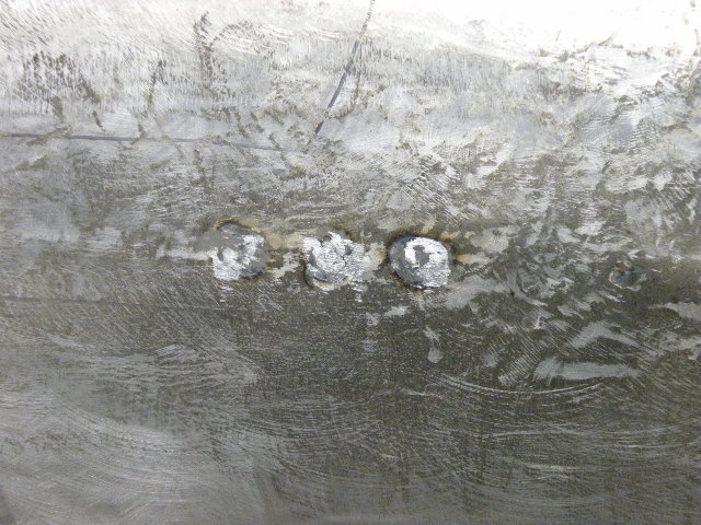

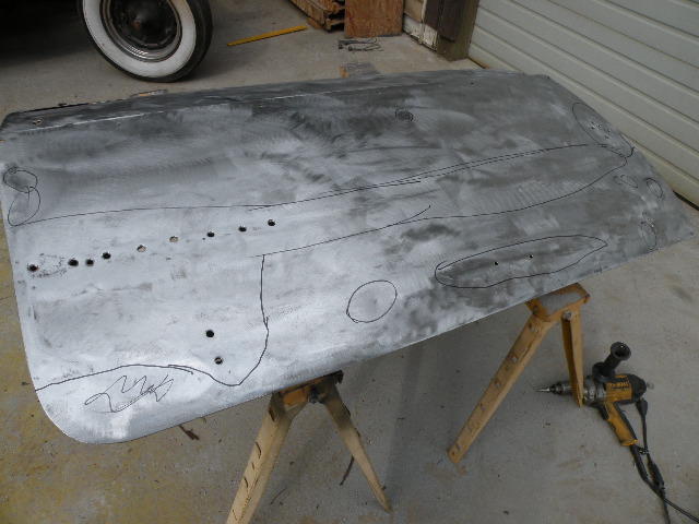

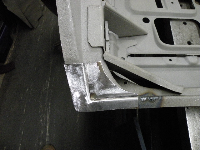

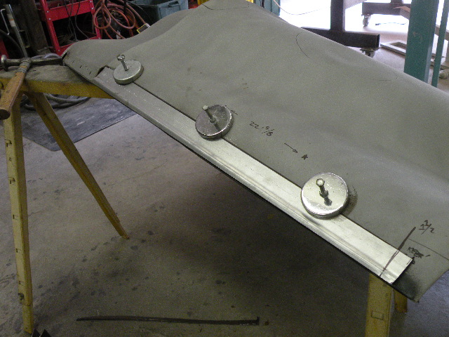

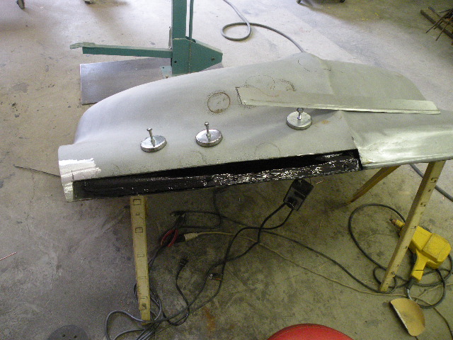

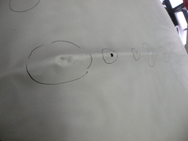

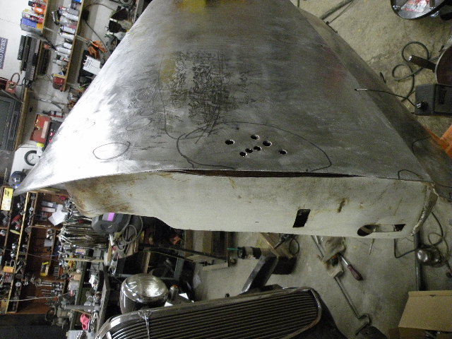

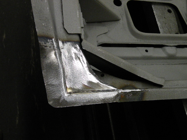

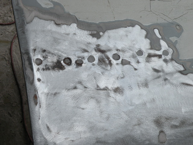

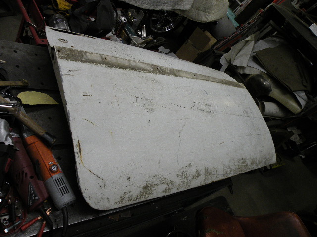

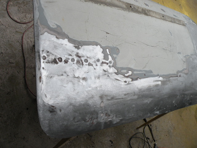

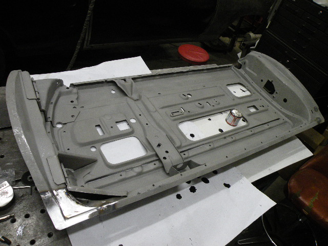

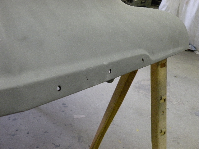

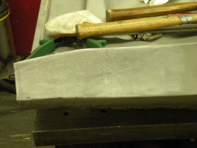

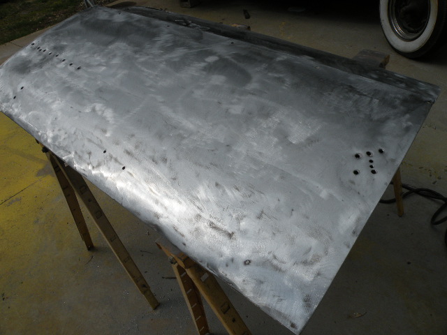

    Back awhile ago I fixed a 56 Chrysler convert door the mud was up to 3/4 of an inch thick in places & 3 paint jobs.
  30. carbuilder
    Posts: 982
    carbuilder

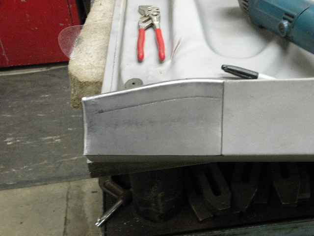

    More on the Chrysler door.
    Tt was all hammer, dolly, slap & shrink disc. The bondo worm holes were drilled out & plugs were tig welded in. All it needs is a couple of heavy coats of epoxy primer & a good block out no mud now.
