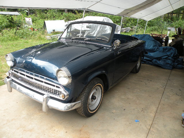

    Playing with some ideas I know its not real H.A.M.B. friendley looking but would you like me to post the build.
    Lots of fabwork to be done.

    Looks like the makings of a neat little car

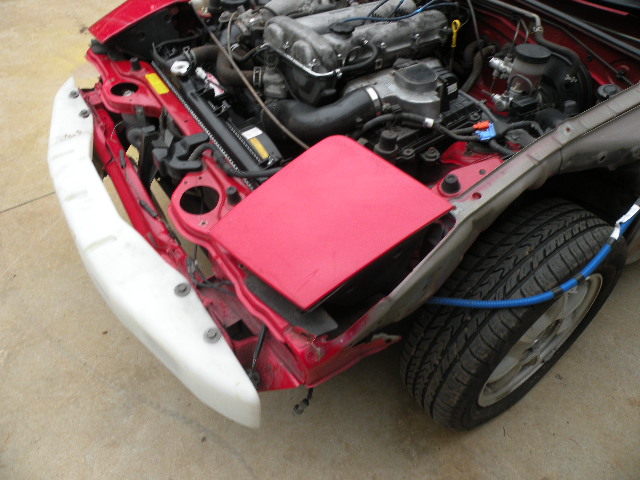

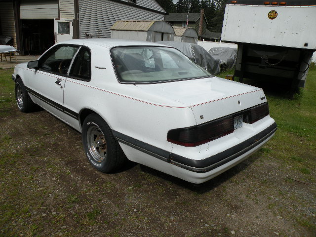

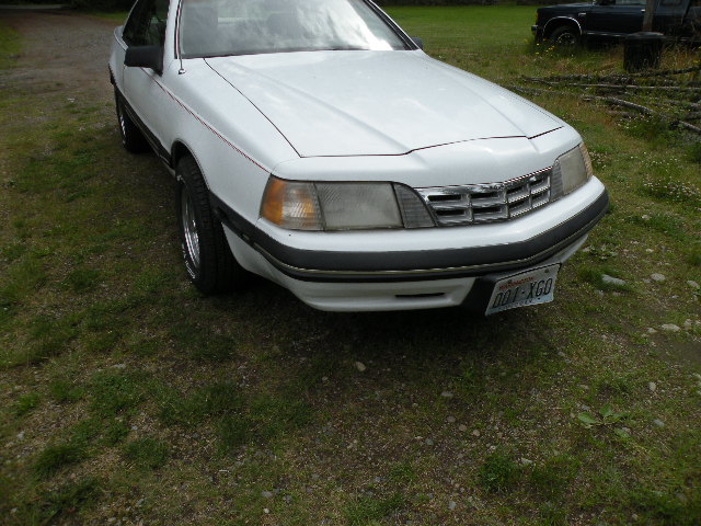

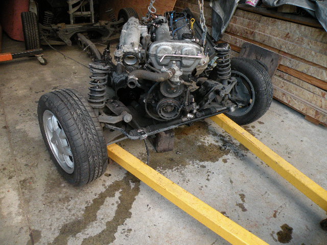

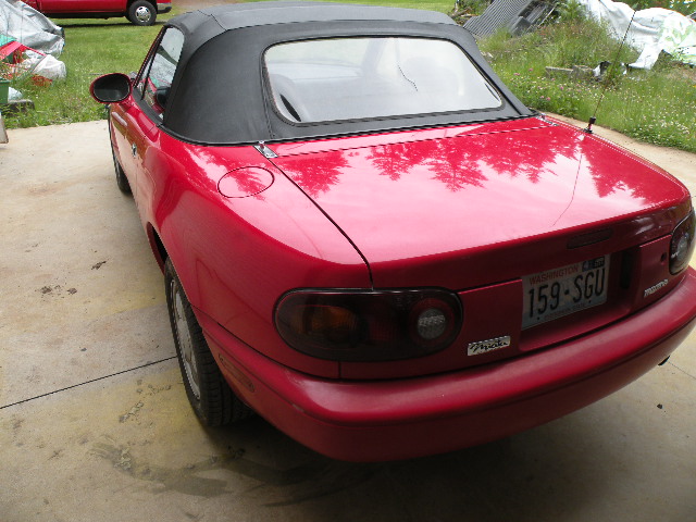

    I am thinking the Miata front suspension now it is about 3 inches wider then the Hillman so I would flair out the wheel well lips to a 70s style race car flair & flat lip. Miata rear suspension with a 7.8 Ford Cougar Thunderbird center section this gives great handling & power disc breaks all 4 corners, with a 289 or 302 Ford motor, Trans still thinking 5 sp or aod. The Miata motors are great but under powered for what I want. The hillman is way under powered 48 hp when new & hillman parts in general are a pain to find. So I figure the Miata suspension will give it great handling & the Ford V8 will give it plenty of go. I want to be able to drive it any where so the more modern running gear will do that. So should I keep posting or not on this.

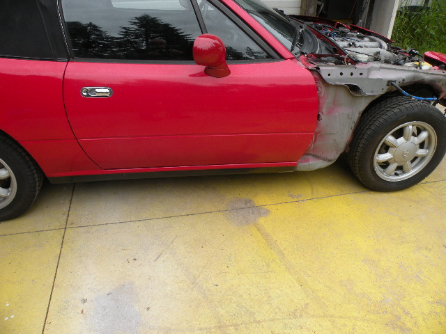

  11. carbuilder
    Joined: Nov 21, 2006
    Posts: 982
    carbuilder

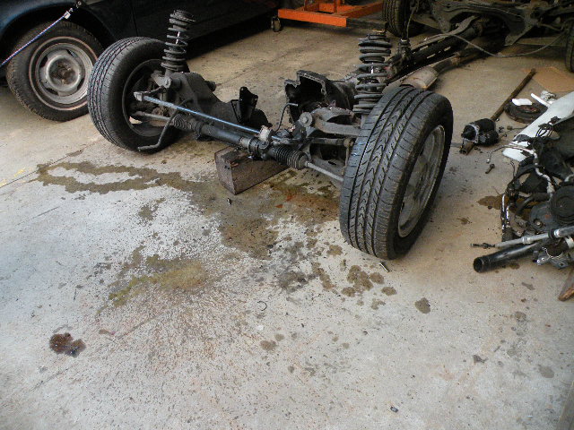

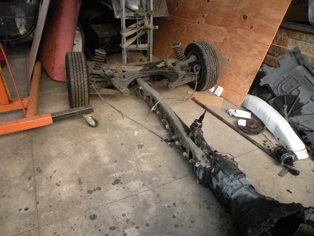

    Getting the new suspension for the 59 Hillman.
    I need to break the rest of the rear apart then power wash both ends.

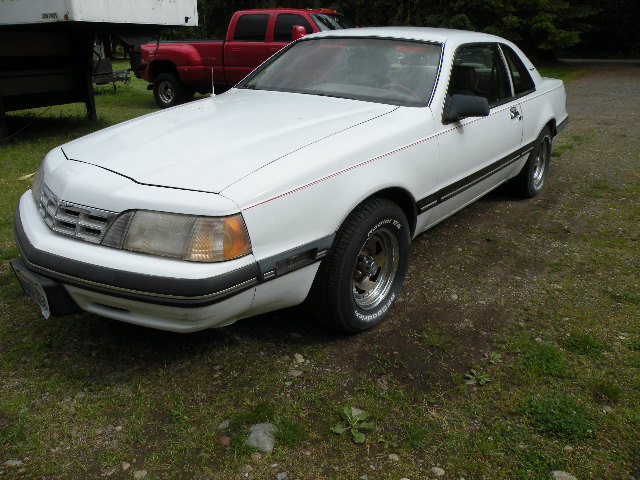

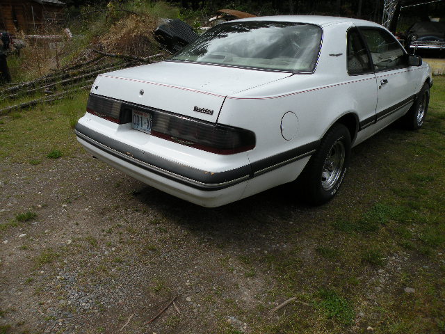

    Well I won't be using the Tbird rear center I just came across a Cadillac CTS-V center section with 10k on it, it will handle 550 hp so my motor running 300 or less will not brake it. The Caddy center was cheaper then buying a ford 8.8 center then doing a rebuild. I am trying to pick the most reliable way to go only want to build it once. More to come.

    I was researching the T-Bird rearend and found the Lincoln MK8 has the same rear but aluminum and not cast iron like the T-bird... the Lincoln MK8 also comes with a sweet Teskid Aluminum block 4.6 Liter v8 just put a Mustang cobra forged crank and its capable of handling 500 hp easy...

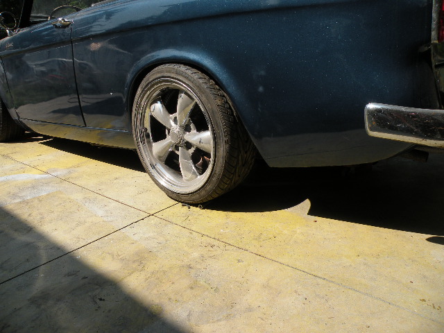

  23. carbuilder
    Posts: 982
    carbuilder

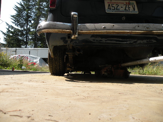

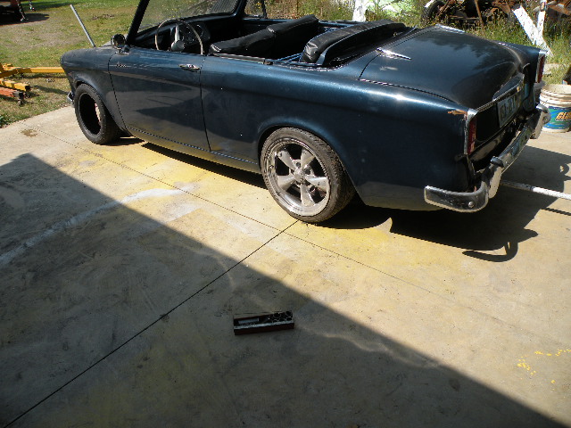

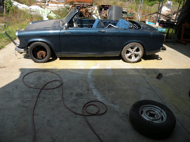

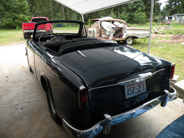

    I borrowed a pair of tires form a friend trying to get the stance I want & wheel opening. Dont pay attention to the wheel just the tire Dia & stance.
    The wheel opening's will be reworked some in fresh metal but I like the tire size & look. With a 302 V8 modern suspension it should work pretty well. Any thoughts.
  24. oldman2
    Joined: Sep 9, 2010
    Posts: 2,373
    oldman2
    Looks pretty good, if everything allows for that stance....Jim

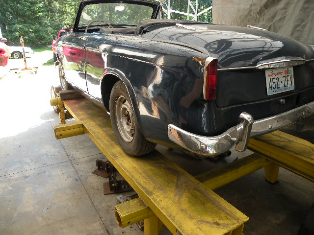

  26. carbuilder
    Posts: 982
    carbuilder
    Cadzook yes the shop is open for customer work.

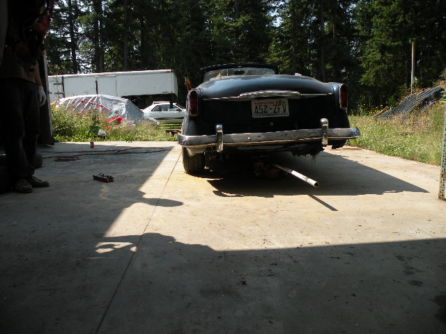

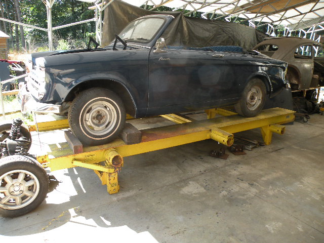

    I dug the ch***is table out from under all the crud, moved it into place, took the wheels off to have lower work hight then leveled it up. Hope full tomorrow I can pull the motor, trans & pull the interior.
    Now let the fun begin.

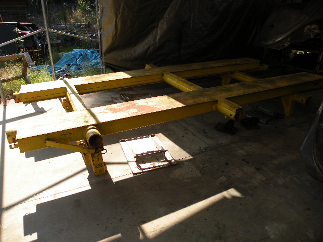

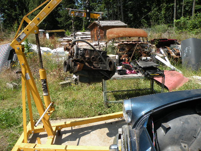

  27. carbuilder
    Posts: 982
    carbuilder
    The motor & trans are out & it is up on the table.
    next the interior comes out then the front & rear suspension.

  29. carbuilder
    Posts: 982
    carbuilder
    Removing the interior is next then remove the suspension front & rear. I sold off some extra parts & duplicate equipment so the wheels and tires should be shipped Monday. I am trying to set my self up for most Saturdays for my project days but the rest of July is shot. Yearly family gathering at the sisters cabin my vacation for the year(2 days) 4days in Torrance Cal on Power Hammer training & Goodguys Puyallup, I am a vendor there promoting my work & the sheetmetal tools & equipment I sell. My health is on the slow mend (back & neck herenated disc issues) But yes progress will continue & thanks for the encouragement.
