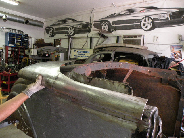

    beautiful craftsmanship!
    i've been wanting to try a shrinking disc... as is, i've always used a torch/water or torch/air... but that's a bit too much at times. plus my gas bills are getting to be a bit much :)

    metal bender may be this will convince you.

    Oh to be able to make metal behave like that. At 66 it's a little late to make a profession of it but I still get a kick out of taking a piece of metal ,hammer, shot bag,stretcher/shrinker, and couple of dollys and turn out a fair patch panel now and then.
    Your skill is simply amazing sir and I salute you (while being extremely envious).

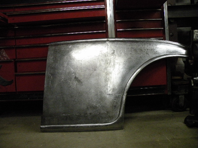

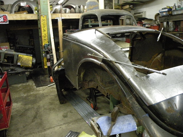

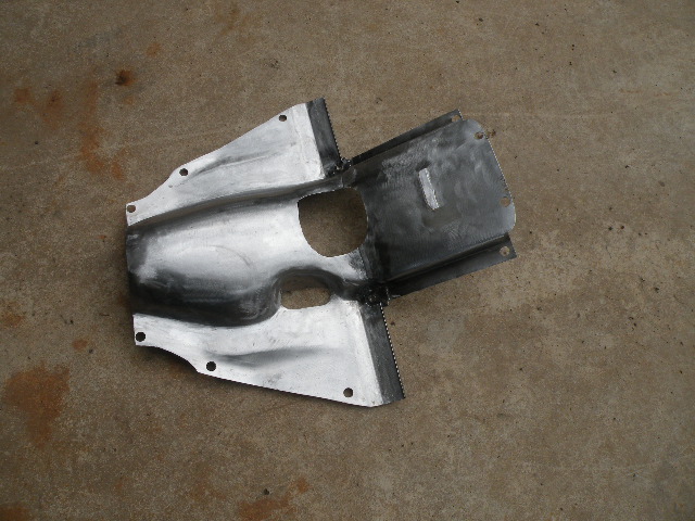

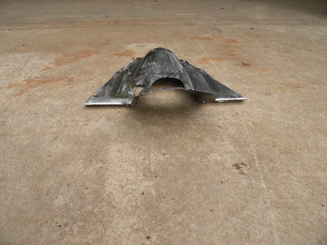

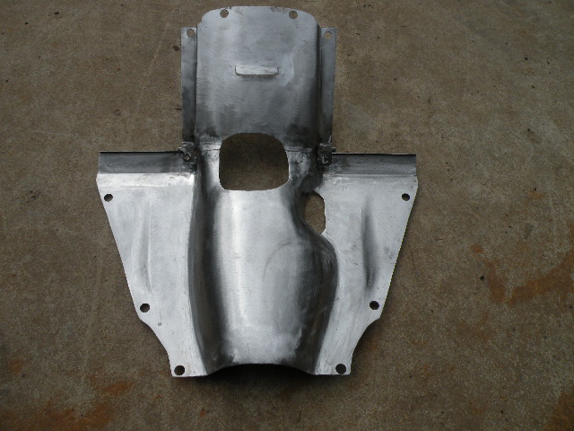

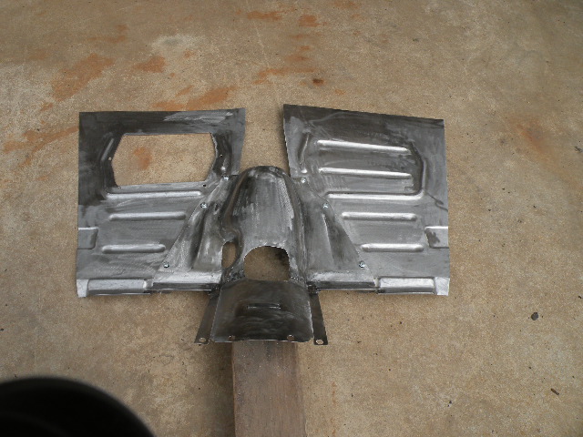

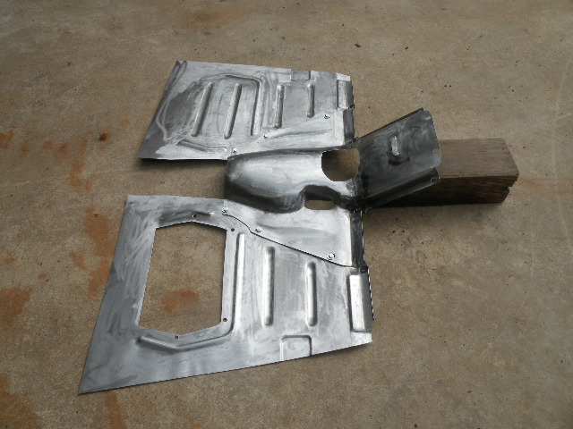

    The trans cover is done.
    Bolted to the floor pan replacement panels.
    More to come next on the body.

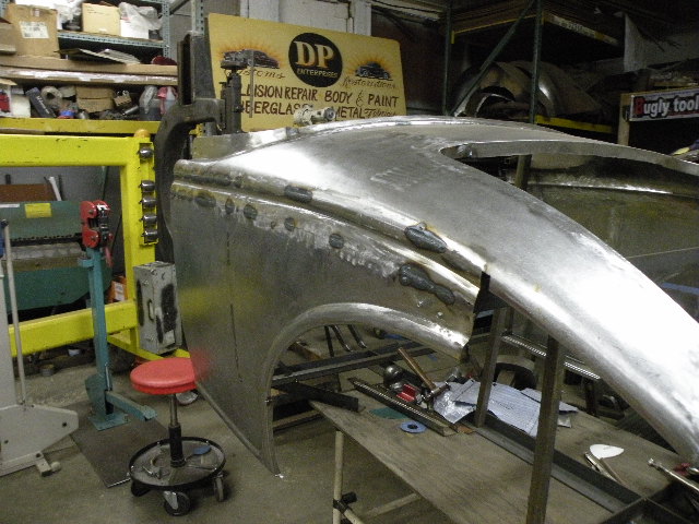

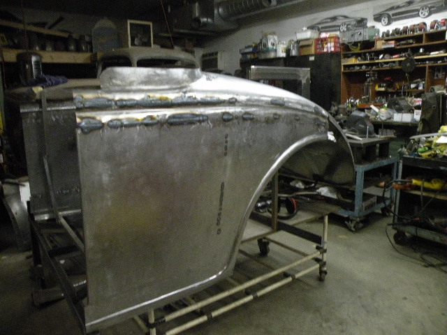

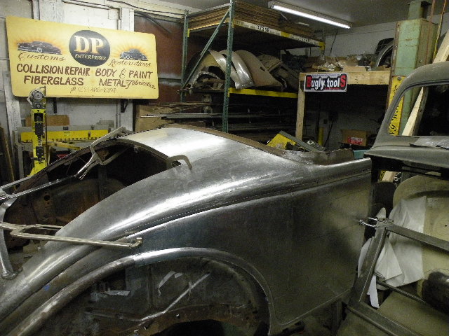

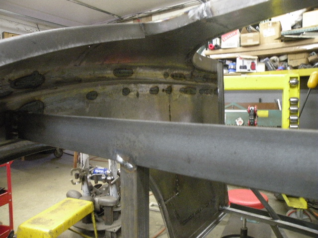

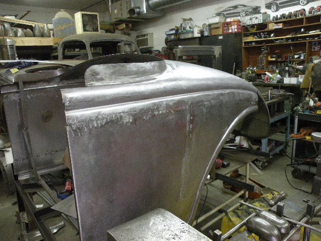

    I managed to get a little time in on the left quarter welding, grinding, hammer dolly & slap work.
    Slow but progress. Starting to think motor & trans combo plus rear suspension type, single spring or parallel leafs.

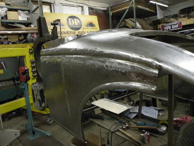

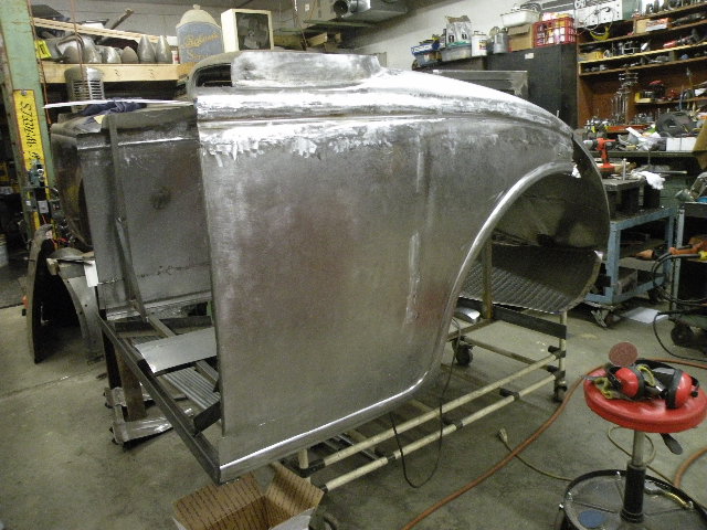

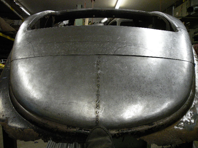

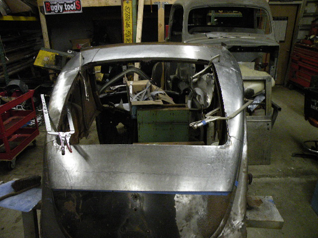

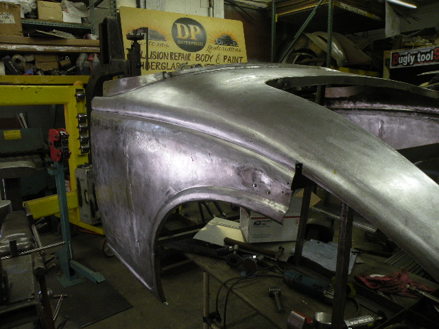

    I was able to put in some time on the Roadster body weld, hammer, slap & dolly work.
    More finessing then DA 80 grit.
    It still need's some more work to get what I want but getting closer.

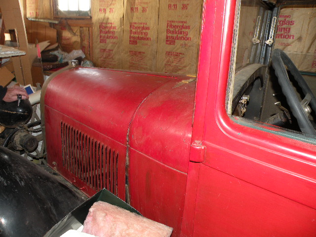

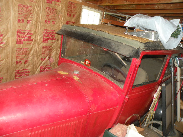

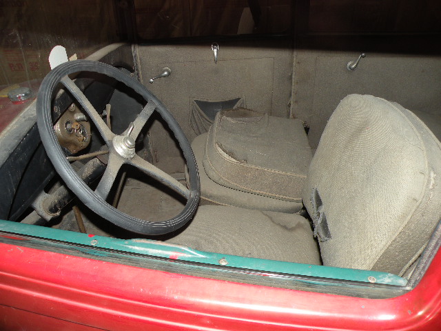

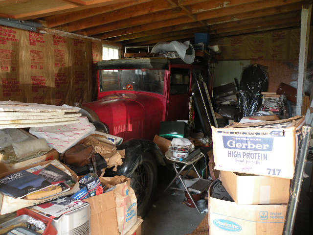

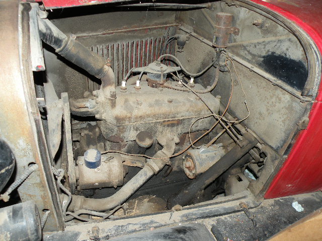

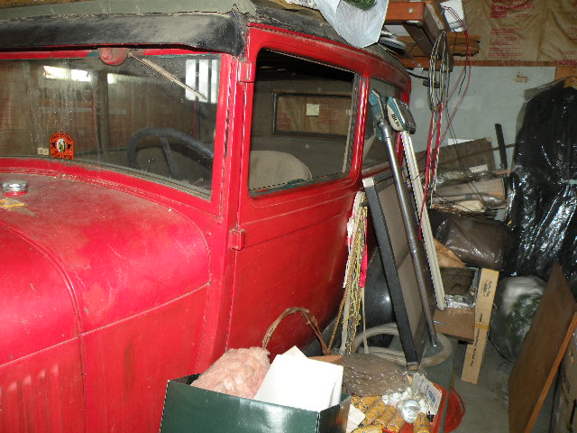

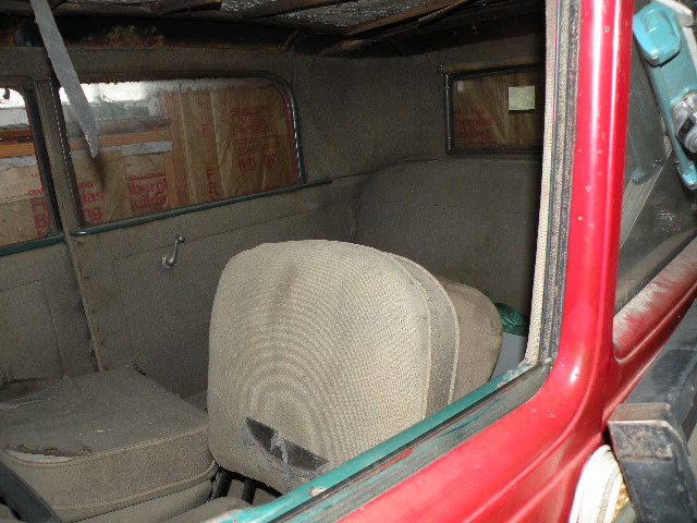

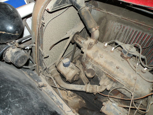

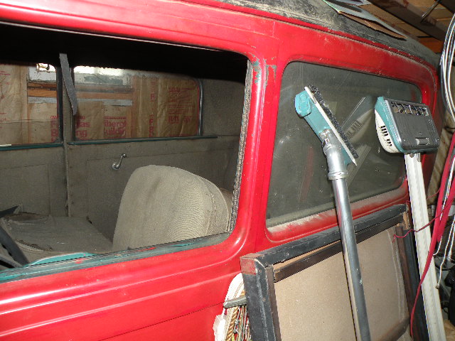

    Look what I found today.
    1929 model A 2dr sedan has been in dry storage since 1948 has not been driven since 1956. It looks almost rust free and original. Very straight on the left side can't tell for sure but the right looks as good. Trying to work a deal. Same owner since 1948.
  15. 36 ROKIT
    Joined: Oct 3, 2008
    Posts: 1,568
    36 ROKIT
    Now THAT survivor is a true barn find; looks as though the mice have spared it, too!
    Good luck with the purchase.

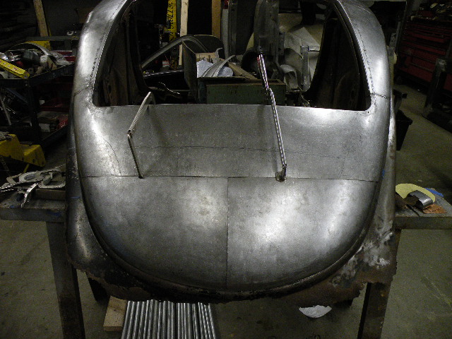

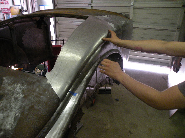

    Nice work Danny ! How are you going to form the transition of the bead over the fender where it widens to meet the tail pan?
  20. carbuilder
    Joined: Nov 21, 2006
    Posts: 982
    carbuilder

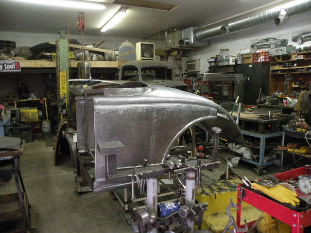

    Tbauer I was working on the dies for the next 14 inches of the accent section today, then I have to make the contour gage to match. After I get those panels made & tacked in then I will make the last section die's & contour to the rear center of the car. After they are done & the remaining upper panel sections I will work on the wheel well tubs & door jamb areas all being roadster correct look & fit. My ultimate goal is to build a steel buck to build & assemble bodys to I am hoping to build 8 to 10 custom versions of the 36 Roadster from scratch & maybe a couple of 3 window versions over the next few years. Some guys addiction are 32's mine is 36's

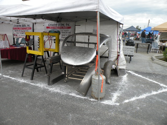

    Well the body as is, is headed for the Monroe swap meet this weekend for display stop by if you are there.
