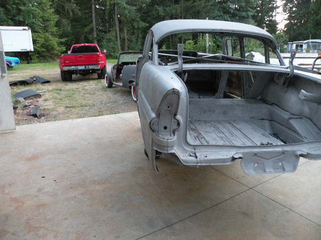

    Tom H yes it was a 2dr ht some one cut the roof off, the floors were gone, fire wall hacked up & a badly grafted on 68 Pontiac front suspension. It was a good donor for this project.

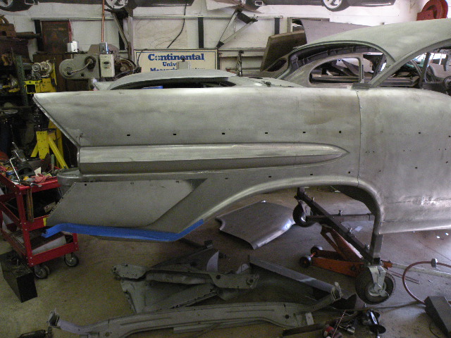

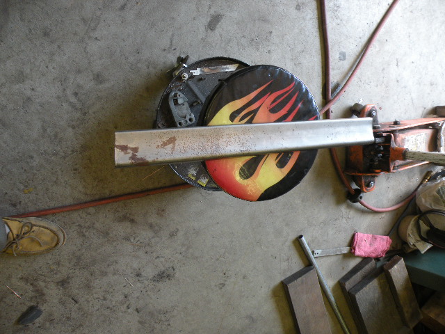

    The owner stooped by for a hair cut today he made the first 2.
    O it's ******* now.
    Uncle Red do you have any of the handy mans helper a couple of rolls should do.:D

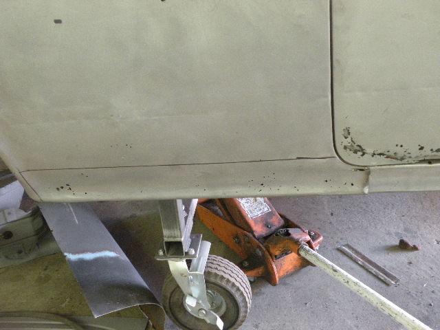

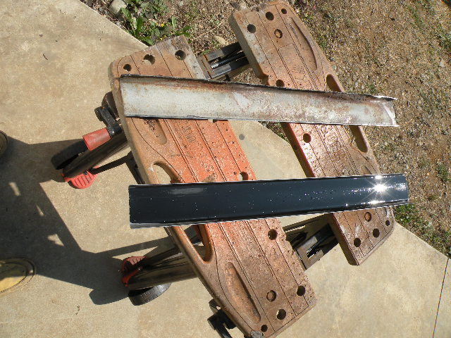

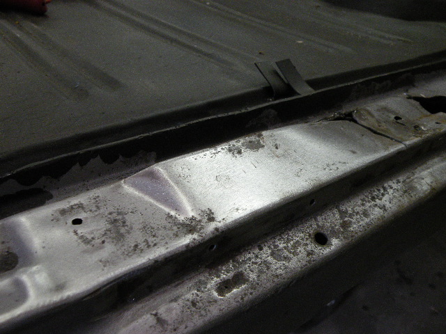

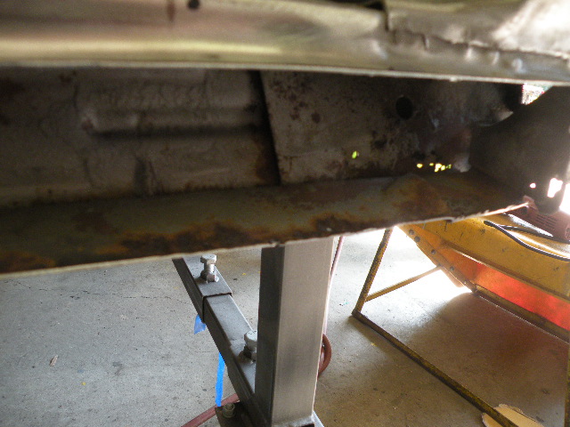

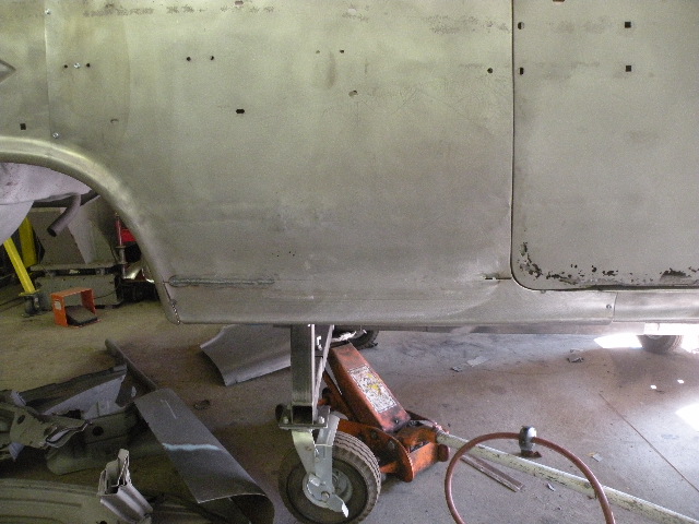

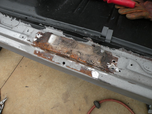

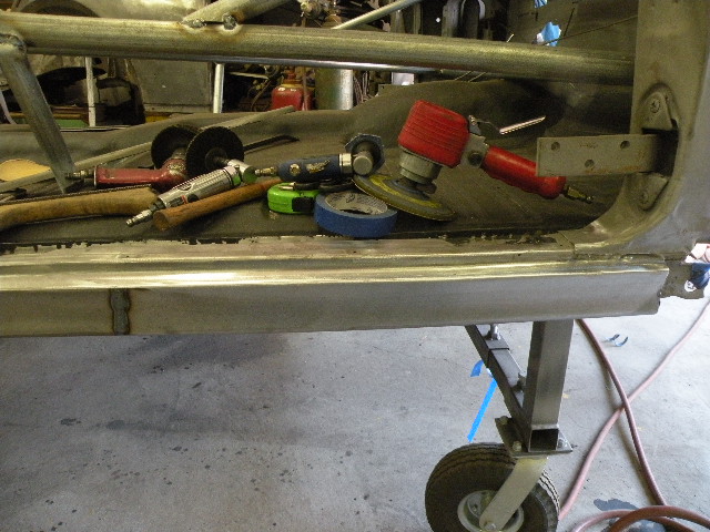

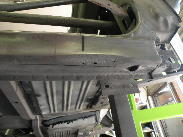

    The lower rocker on the right side had some rust thru & a crushed seam.
    Cut the damage out.

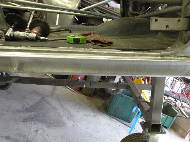

    New panel made
    Inside coated with por 15

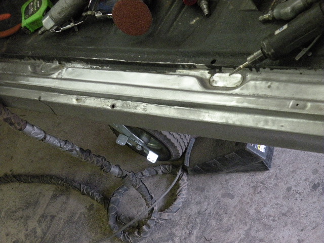

    The rear c pillar area need to be cleaned up.
    The b pillar center post mount area in on the rocker sill needed rework.
    New filler section filled & smoothed.

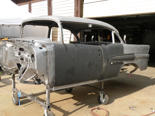

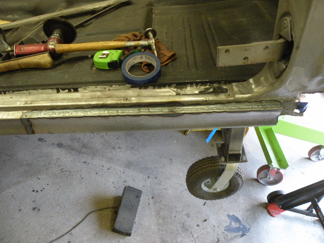

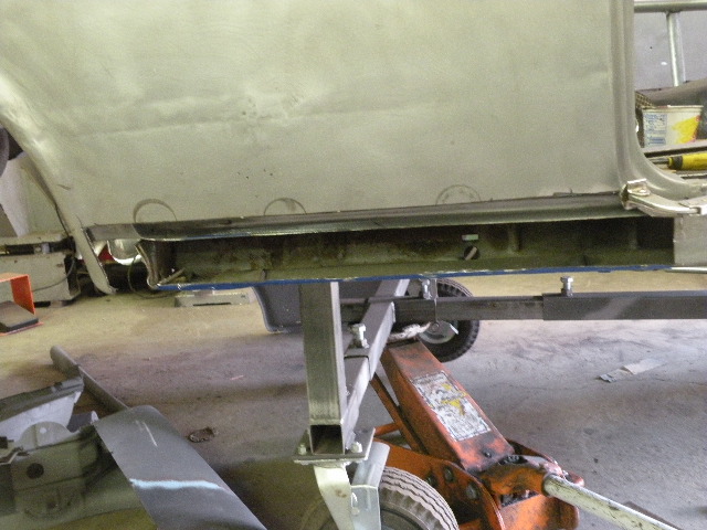

    Finished welding the rocker sill.
    Next phase of the major changes starts next week.

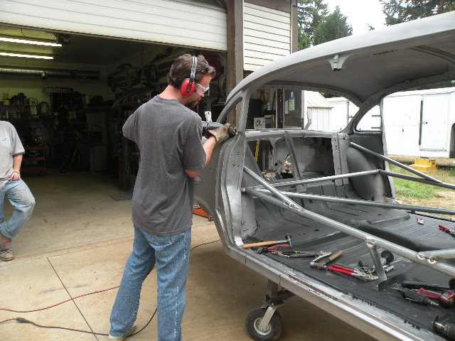

    I appreciate all the work it takes to stop and take pictures, write a caption and post. I've tried and it takes lot of time. So thanks Do you have a post on your welding and metal finishing technique ?
    Ted
  16. carbuilder
    Joined: Nov 21, 2006
    Posts: 982
    carbuilder
    Ted I don't have a post it is pretty much the way most quality builders do it today. Almost 99% is tig welded better heat control less warpage to straighten then with a wire feed. All panels are **** welded unless it is a factory seam lap weld. We grind the welds down with hard disc to start then finish with a 36 grit rollock on the angle grinder smooth. Hammer dolly & shrink disc when and as necessary.

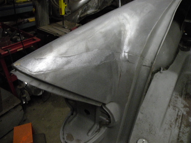

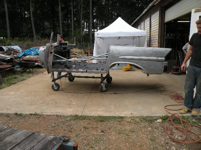

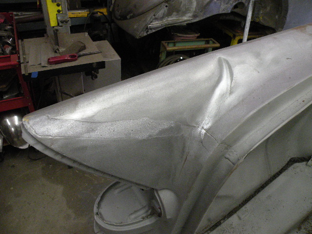

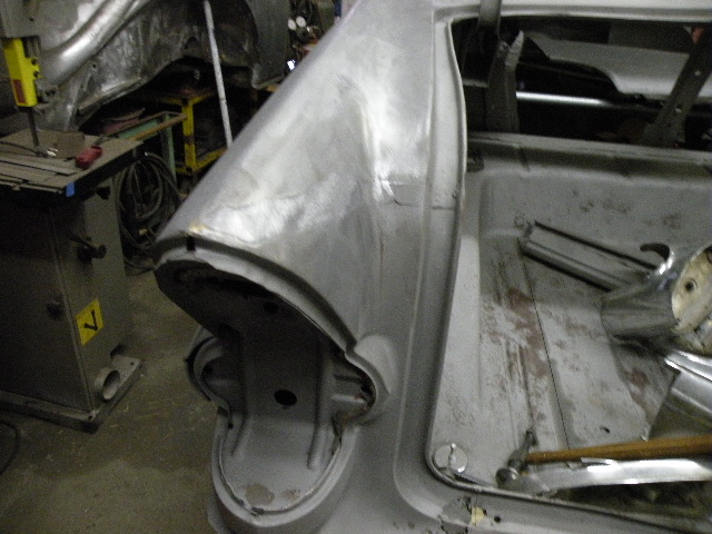

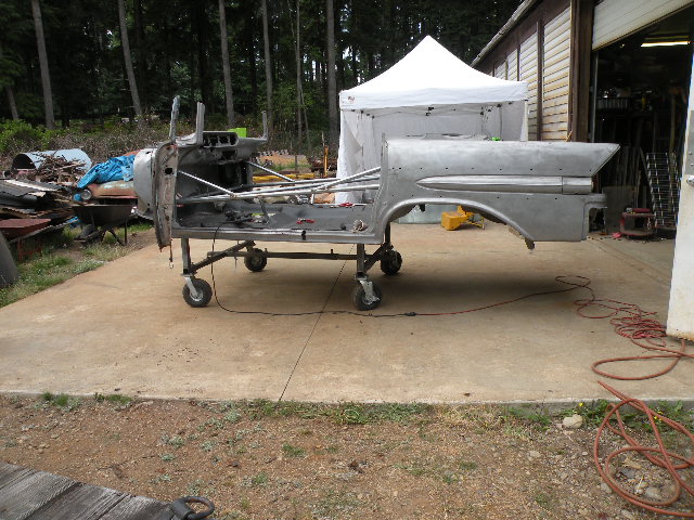

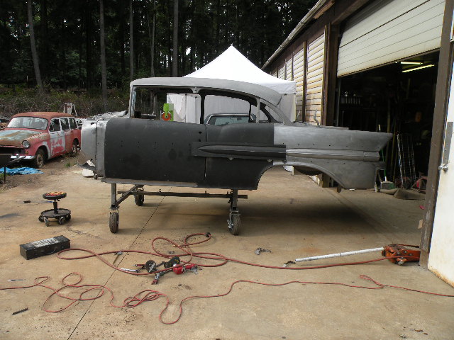

    The left rear fin had a kink & pushed over about 1/2 inch from a previous incident.
    Using the friction jack to push the fin over & the spitznagel gun to pull the kink out plus a little shrink disc on the outer edge to shrink it was realigned to straight.
    Big change coming soon are you interested.

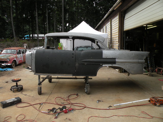

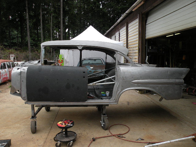

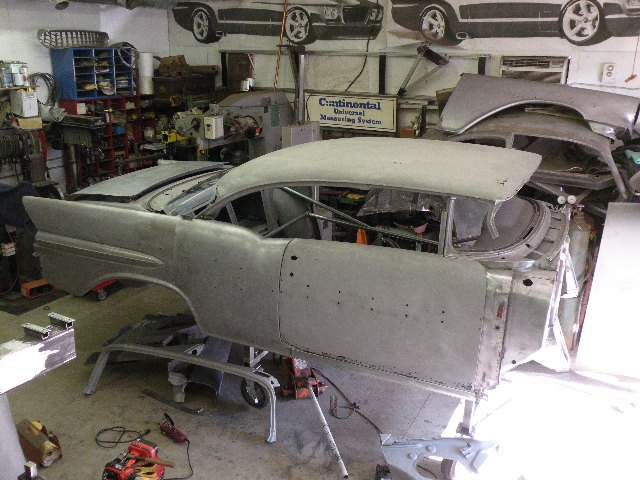

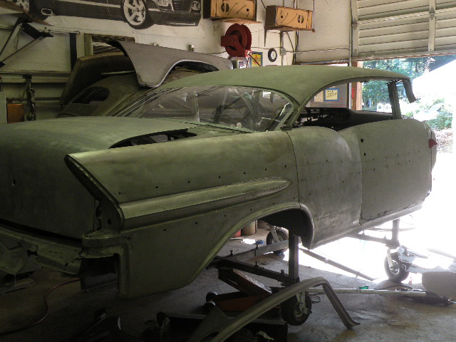

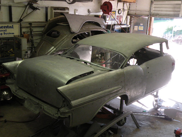

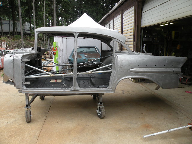

    Well I am letting the cat out of the bag the next phase is a new top & rear gl*** grafted from a 57 Dodge 2 dr post with a chop. Remember I said it was going to be different it will not be a cookie cutter car.
    Now do I have your attention hope so because its just going to get better, or you snooze you loose
  21. That IS interesting! I am anxious to see how you handle all of the gl***. It is nice to see a project driven by imagination.

    Like where you are going with this, roof line will look great, will front gl*** be dropped into the cowl?

    The roof line looks very sleek. Can't wait for more.

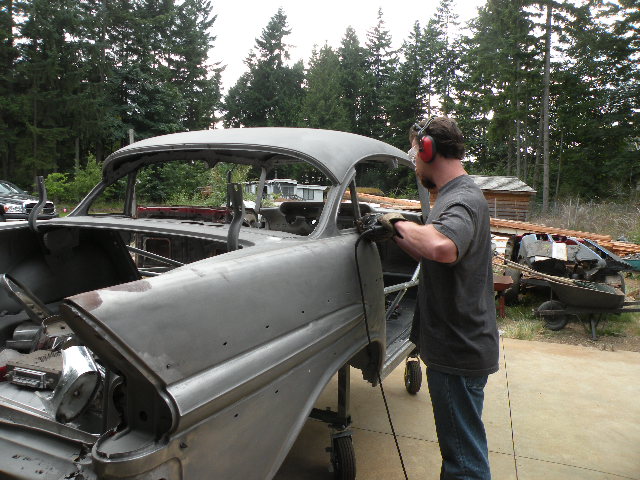

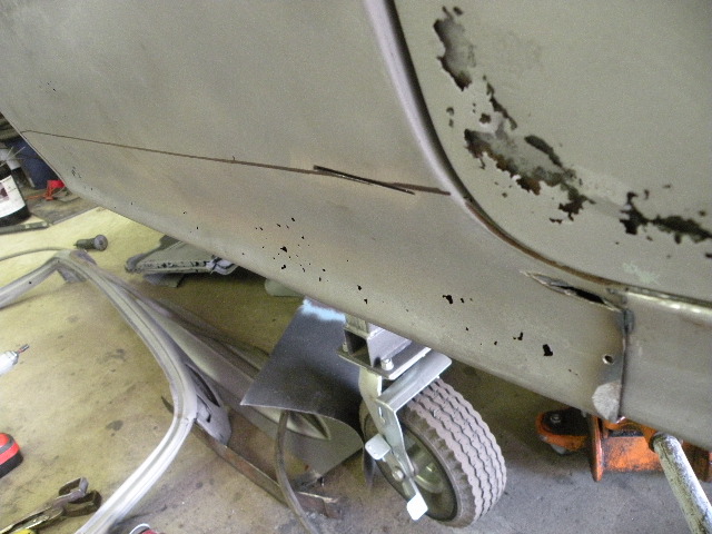

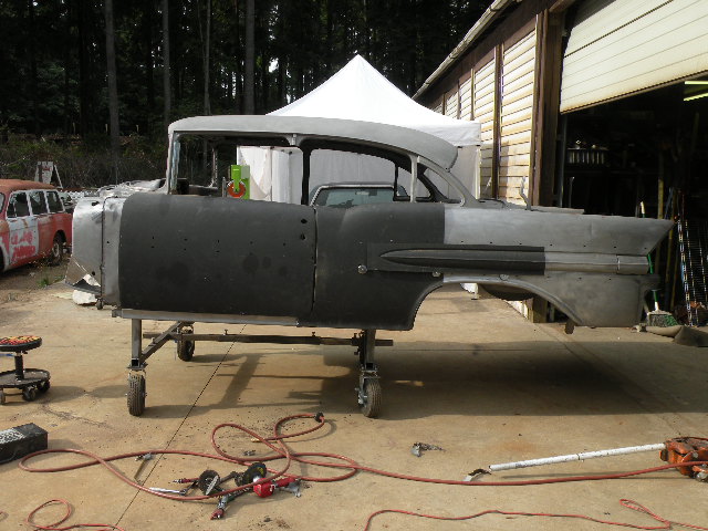

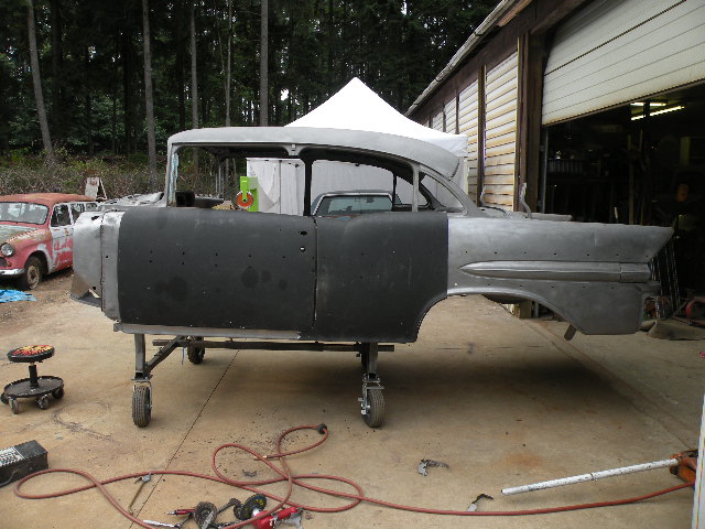

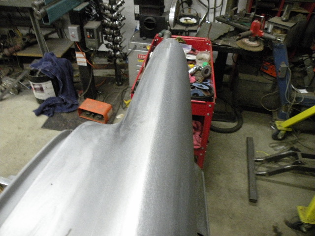

    Nothing big today Max had to make a section where the rust mites had attacked the new quarter section. We need to get the quarters & doors squared away before we can do the roof. Its all about the correct procedure & the details to make this a top notch car & thats what the customer wants.
    If you notice we are not using old ****py rusty metal to weld to its all clean that is just one thing that helps make the job easer & cleaner. I see way to many projects being built with out a though derust.
