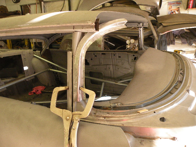

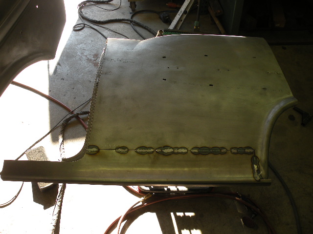

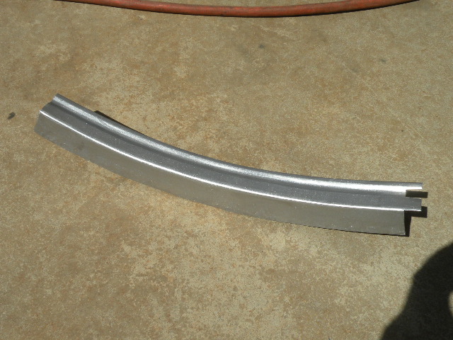

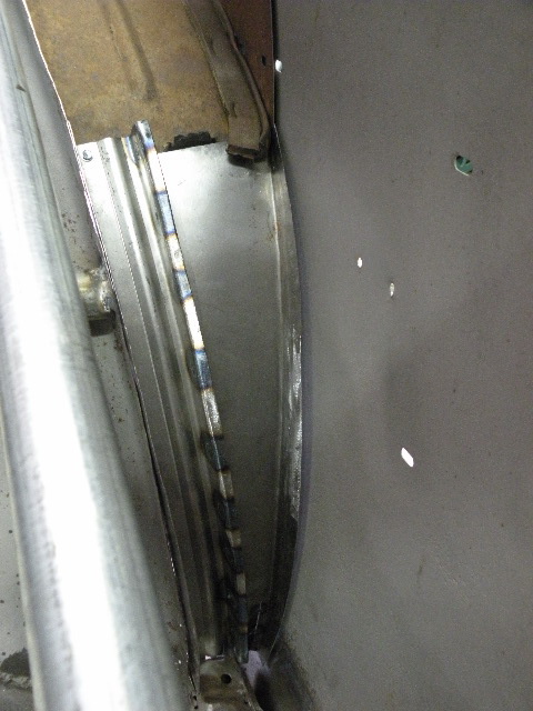

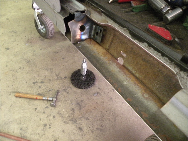

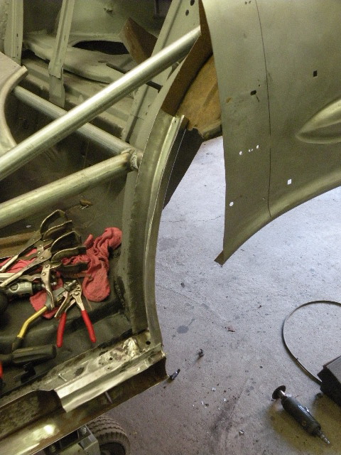

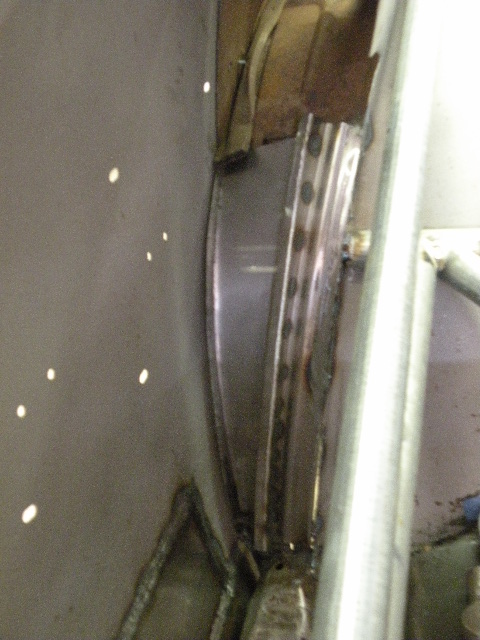

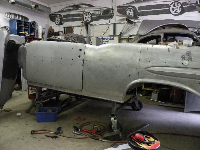

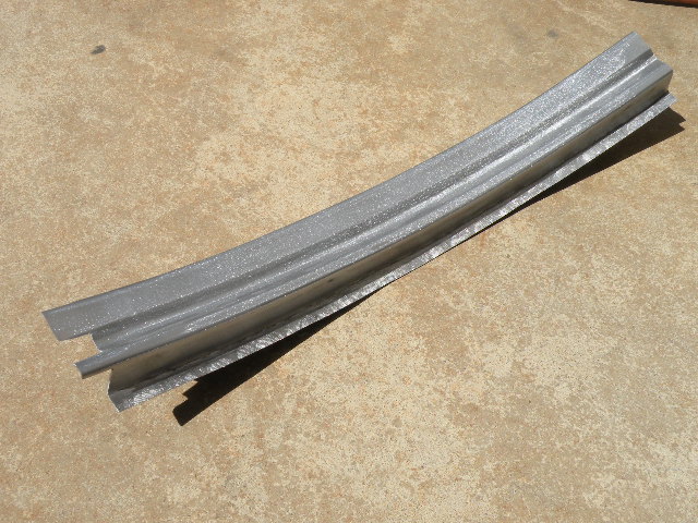

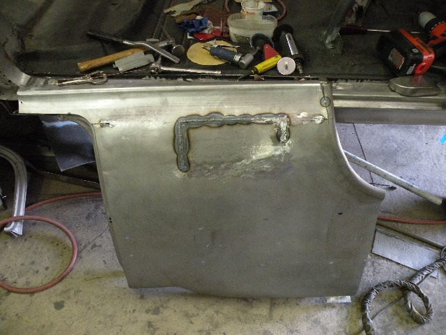

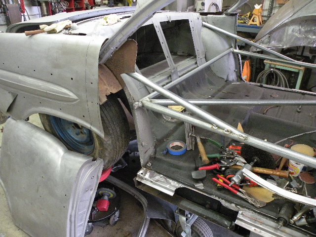

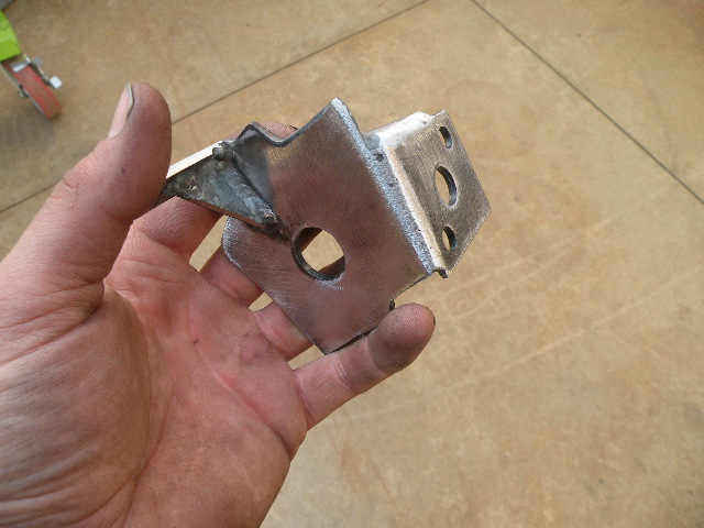

    Max had to finish the right front quarter section by making another small patch.
    Thinking about ride height.

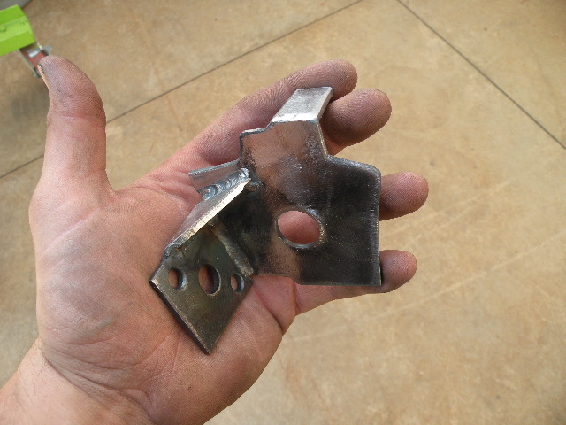

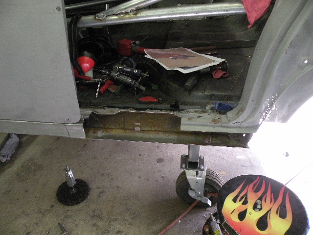

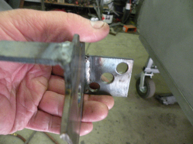

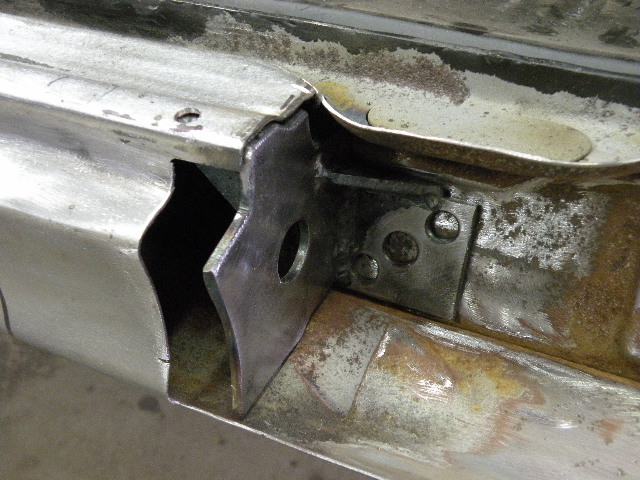

    Pillar support being made to go in the rocker.
    And more later.

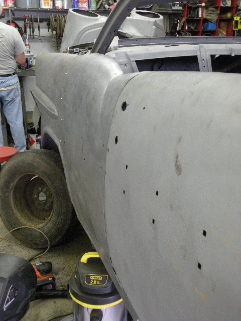

  3. carbuilder
    Joined: Nov 21, 2006
    Posts: 982

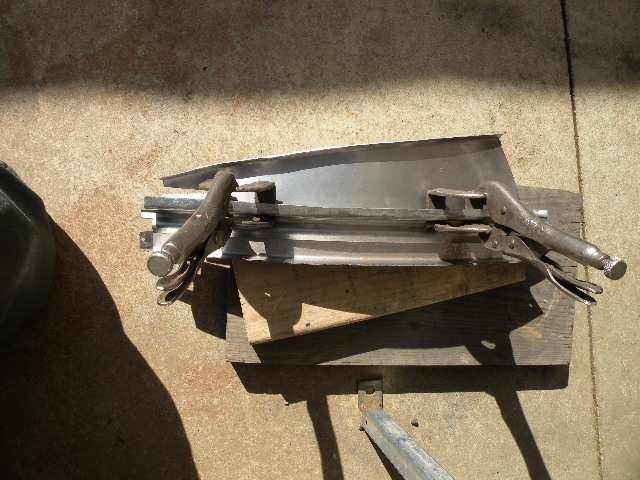

    carbuilder

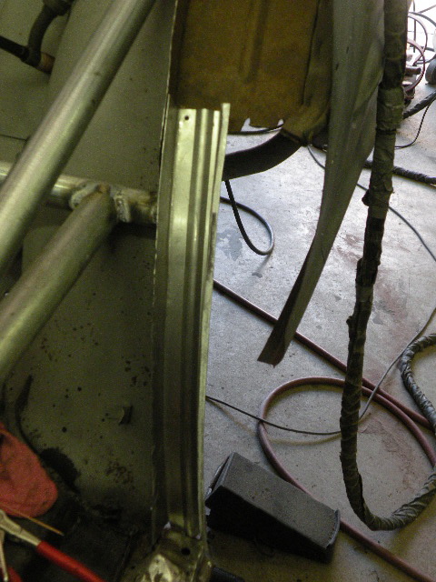

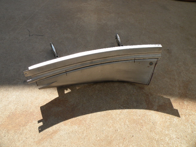

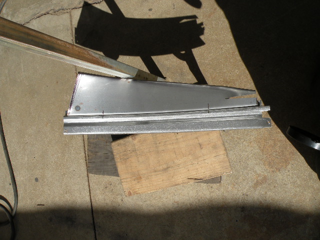

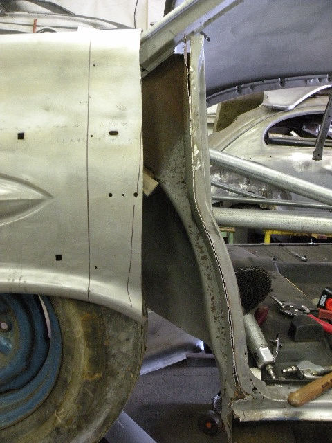

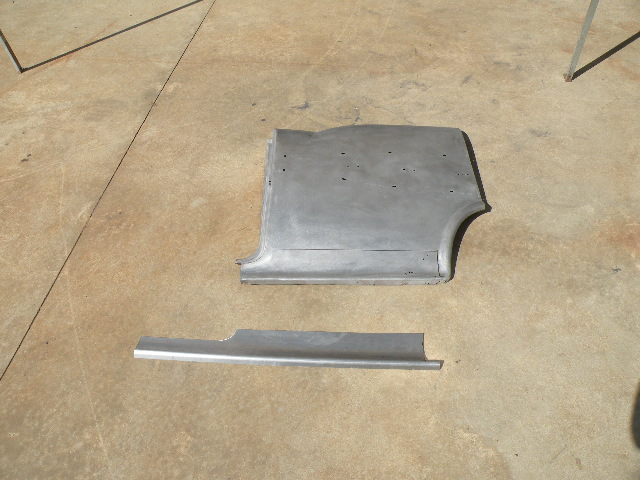

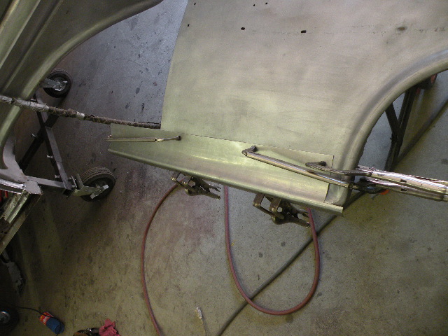

    A little fab work has to be done to make it so the rear Quarter windows will roll down before the new quarter filler can be installed.
    Just a little fabrication.

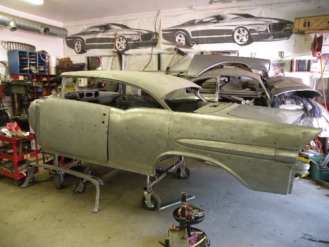

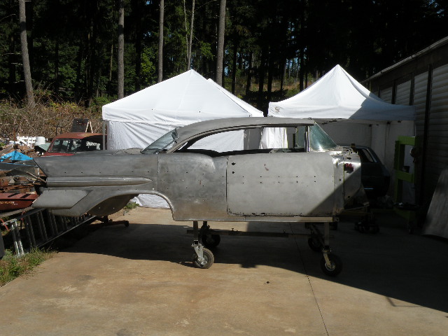

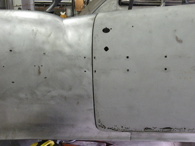

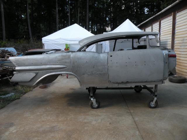

    A little more progress on the 2dr ht part of the conversion.
    A little roll out & the owner really likes the new Dodge top.
    Keep a watching more to come.

    Coming along nicely...Jim

    Very nice work. It looks like it was ment to be that way

  17. carbuilder
    Posts: 982
    carbuilder

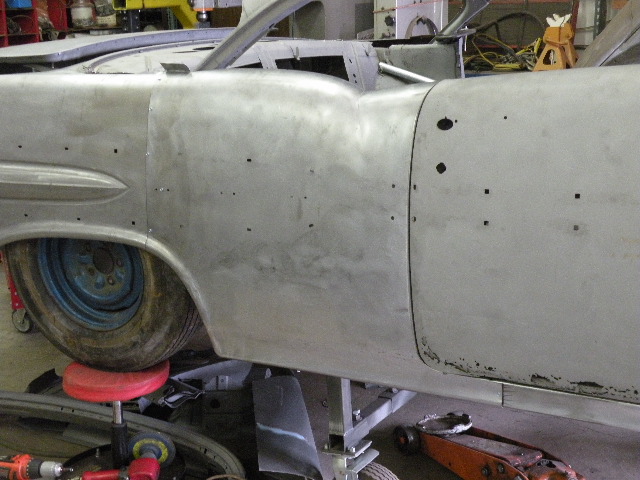

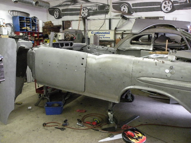

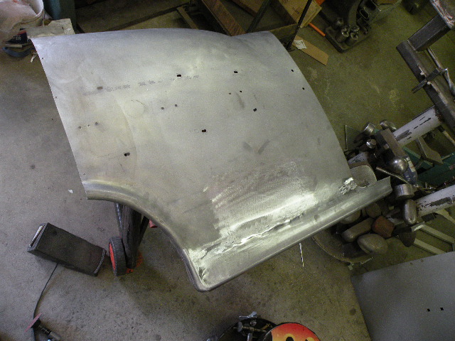

    A little more progress on the right side.
    Progress is good & keeps the customer happy.

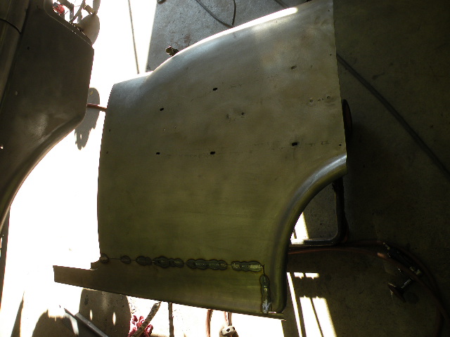

    A little more work on the left rear quarter.
    Regretfully for the next few weeks we will not be working on the Pontiac as much the owners ck book is getting a little thin it will progress but at a slower pace so keep watching, more thing & projects to come.

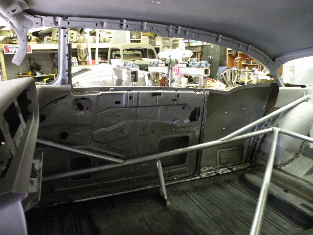

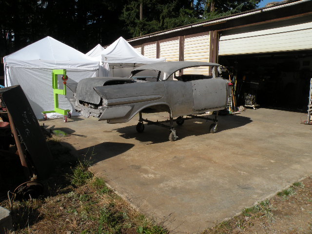

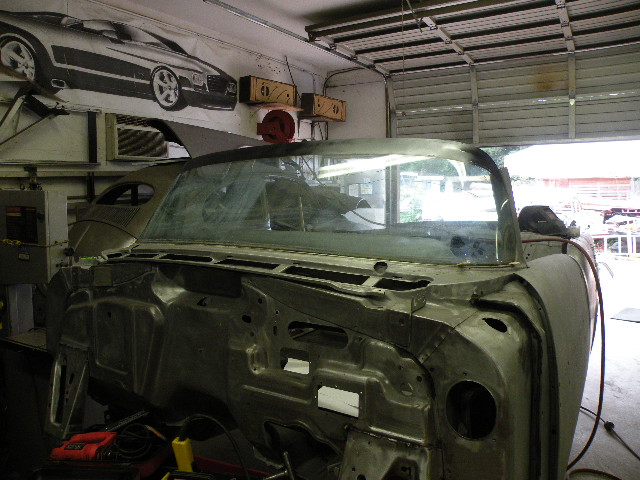

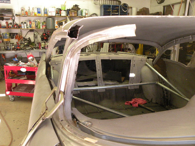

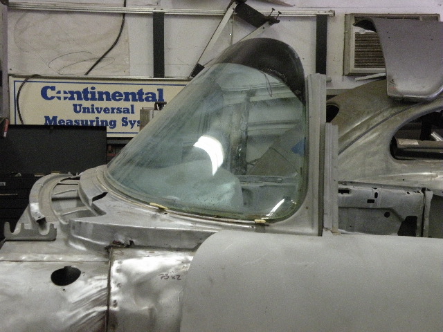

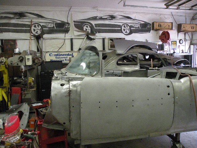

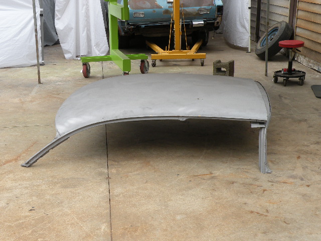

    We are playing with the roof hair cut & the overall flow of the roof lines.
    The old windshield was cracked so it is getting cut for looks & template.

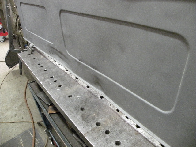

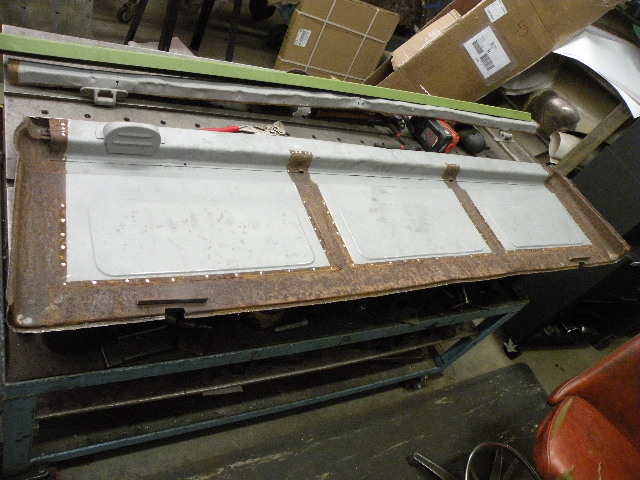

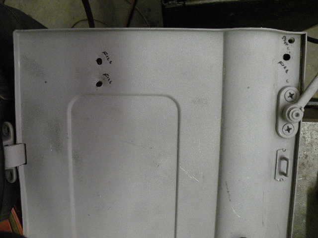

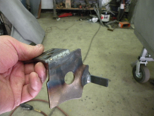

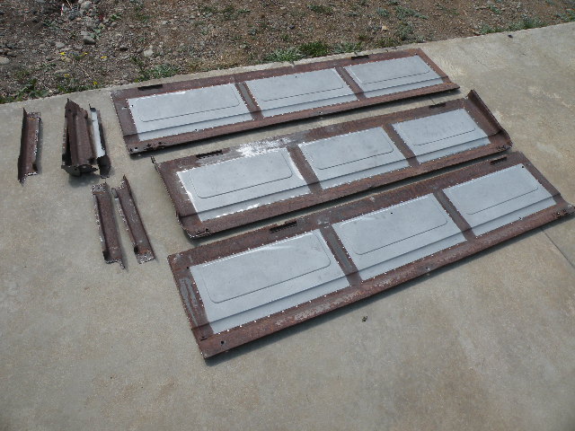

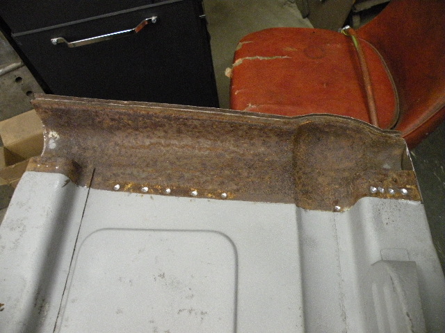

    We do a lot of projects that are not necessarily H.A.M.B. friendly but the work we do all has good content for reference work on other projects that are H.A.M.B. friendly so I will mix it in some time unless Ryan or the other moderators or member's do not want the how to metal content. To me metal work is metal work it's all about the learning experiance content. So here we are repairing a pair of box sides & tail gate.
    First the center braces were removed.

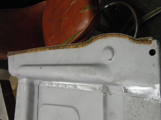

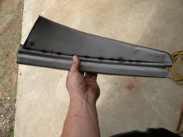

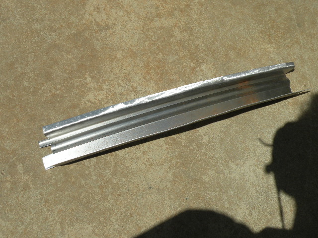

    Next the outer rolled over lip was turned up.
    Then that panel was removed.
    Bottom section the lip turned & the section removed.
    Same process to the top.

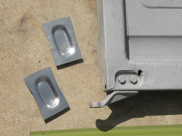

    Several holes will need to be filled.

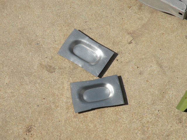

    New bolt retention recess's had to be made.
    After all 3 panels are dis***embled they will go to the blast shop for clean up.

    carbuilder

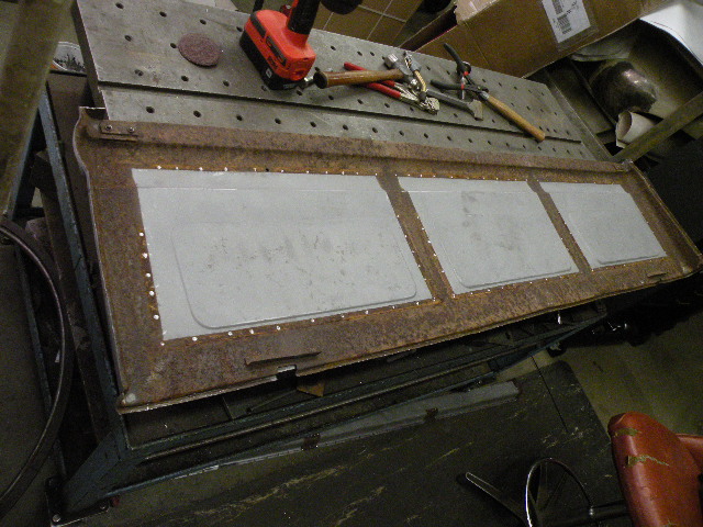

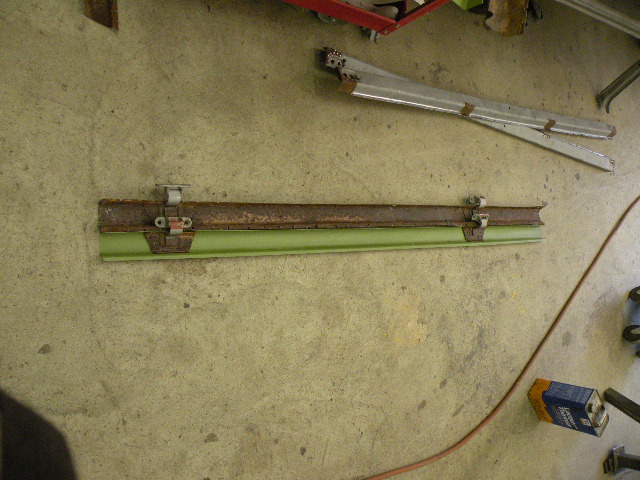

    The usable parts were taken to the blast shop.
    The Hinges will be removed from the old chanel & go into the Mol***es dip tank over the weekend.
    More soon

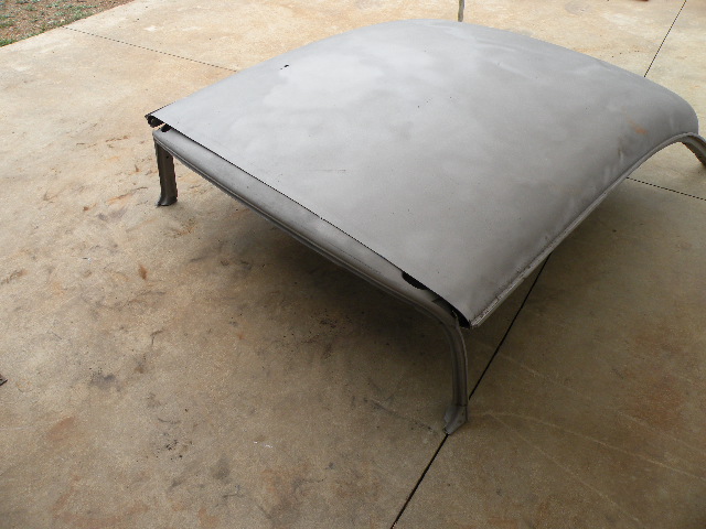

    We are really starting to like the new top profile as we work on the chop amount & roof line flow. It makes a big difference being able to roll it out side to take a look once & awhile.
    More stuff to come.

    Wow! Quite the transformation, great work as always
