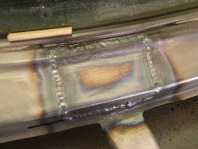

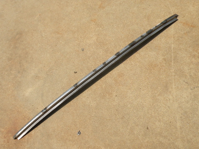

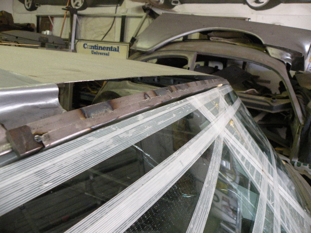

    Max cut the roof overhang off closer to the length needed & put some time in on fabing the windshield chanel. It is a z chanel formed using the shrinker, stretcher, hammer & dolly.

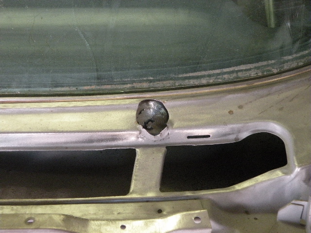

    The upper windshield header is being totally hand fabed due to the roof change so the top is being built double strength to help in the roof support.

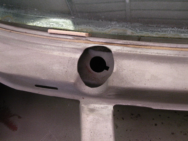

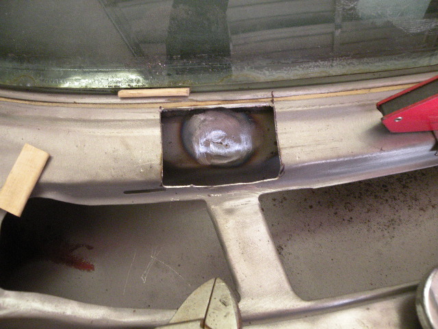

    The windshield wiper holes are being filled & while we are waiting for the new windshield rubber they are being filled.

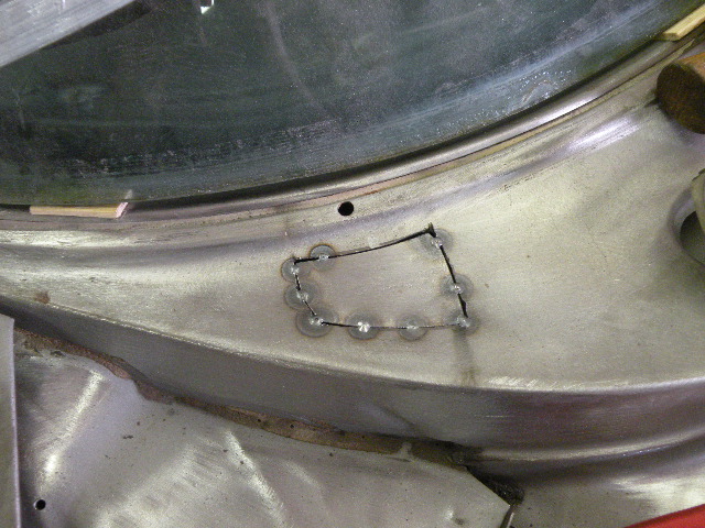

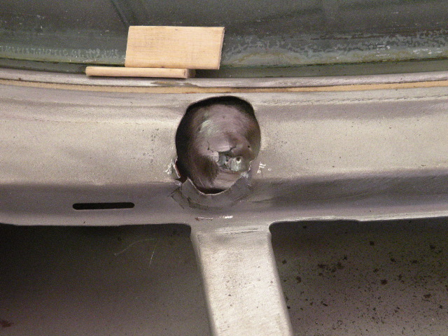

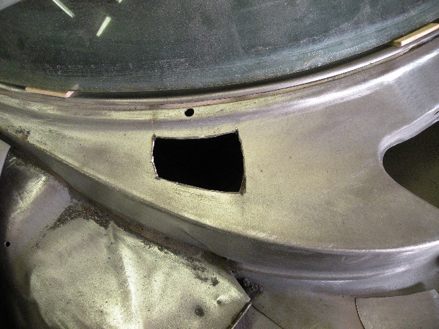

    Max finished up the right windshield wiper hole.
    The filled the left side.
    Then the antenna hole.

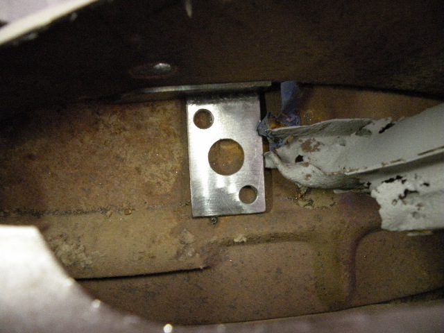

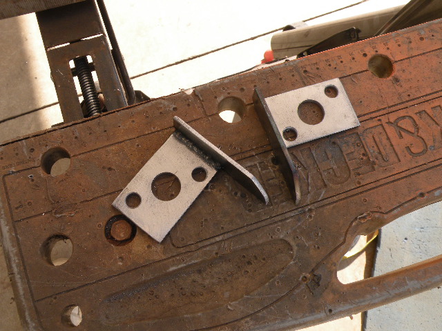

    The rear roof pillar will need some mounting brackets where the will attach to the wheel well tubs.
    More to come.

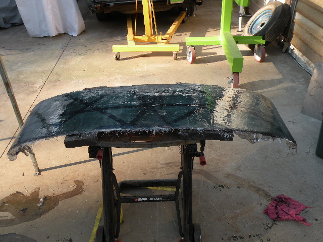

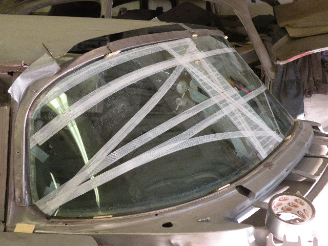

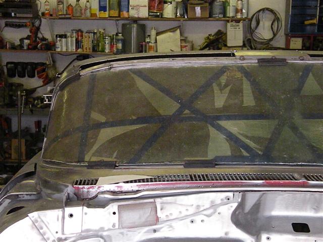

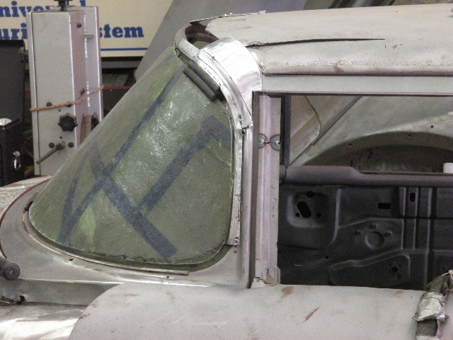

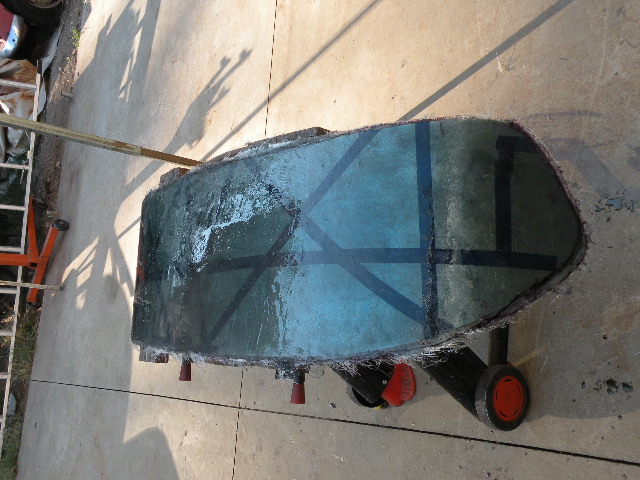

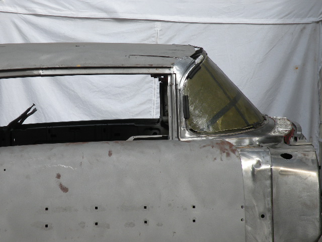

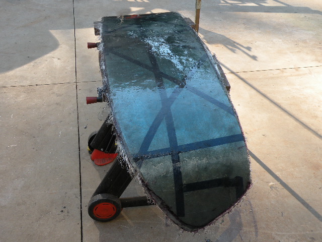

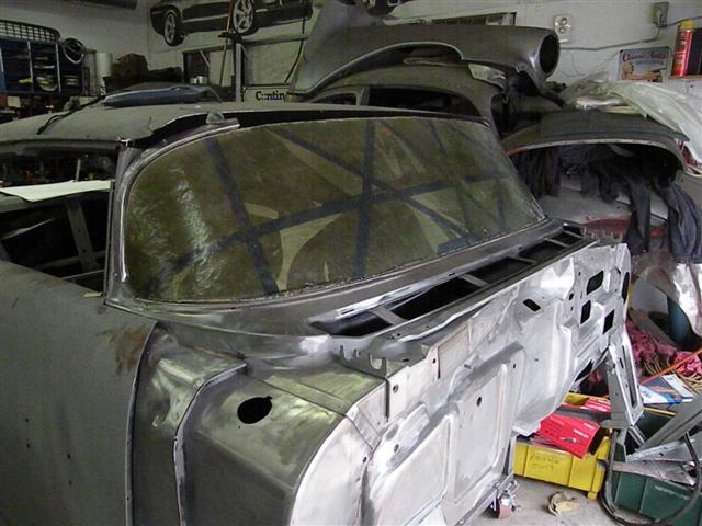

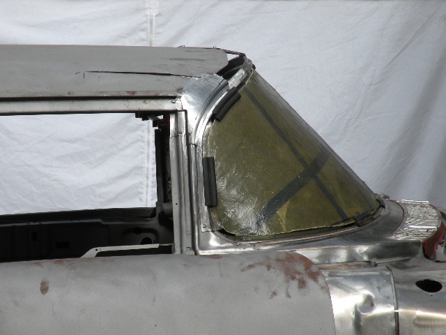

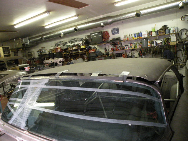

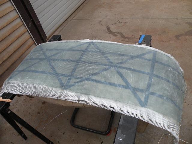

    Trying to work with a broken windshield is a pain in the rear, we needed a windshield for fitting purposes to make all the Chanel's & I did not want the owner to have to fork out $350. for a new one, cut it then be using it with all the fitting, welding & grinding going on, so we made a template windshield to play with. We work with steel all day every day but making a steel or aluminum template would of taken some time with all the compound curves in the gl***. We decided to just whip one up in gl*** as in fibergl***. Its cheaper over all then making it in metal due to the hrs.
    So here is what we did. First we blocked the old broken but chopped windshield to shape. Next we covered it with house hold tin foil, wax paper will work also & taped it tight. Next we put down 2 layers of fibergl*** matt then a layer of fibergl*** cloth.
    Next we will add some wood for a back bone & strength. Then we will have a strong template to do all of our build stuff with & a great template to size for when we cut the final windshield.

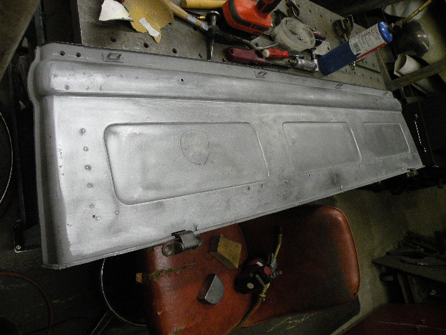

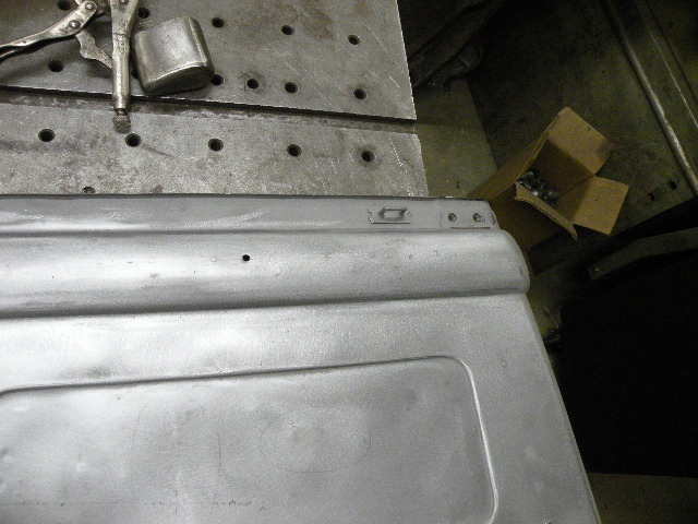

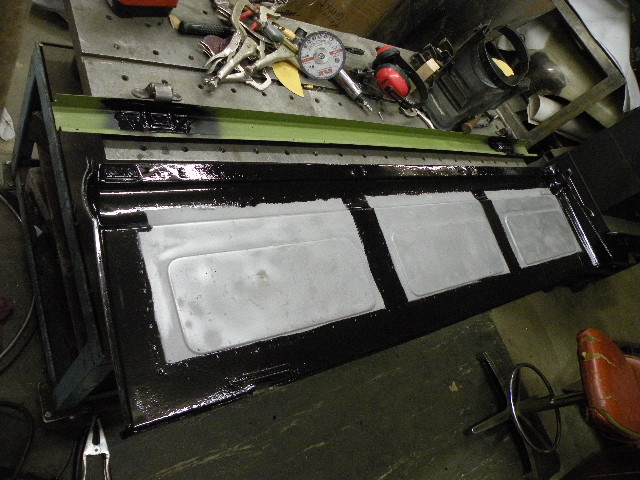

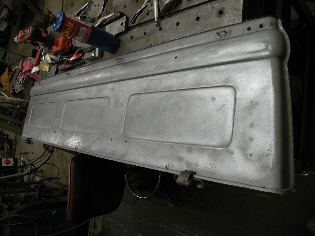

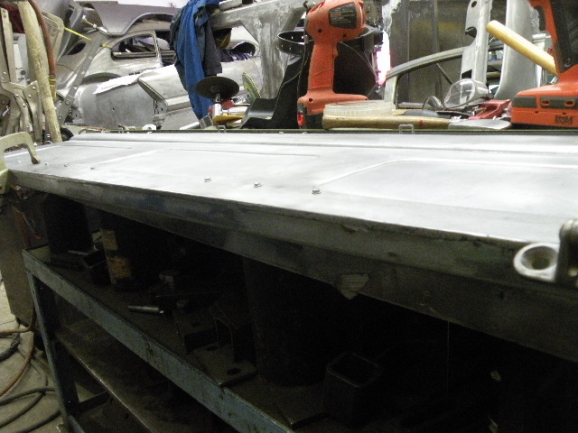

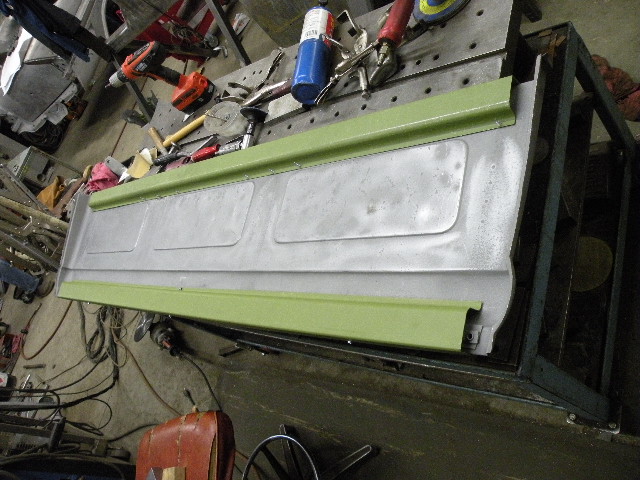

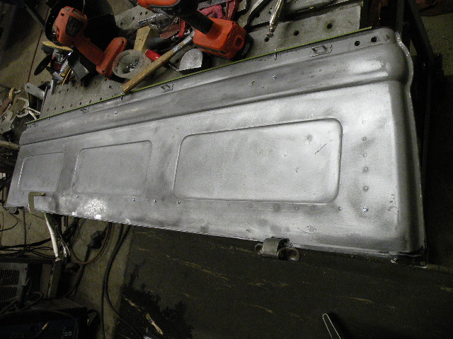

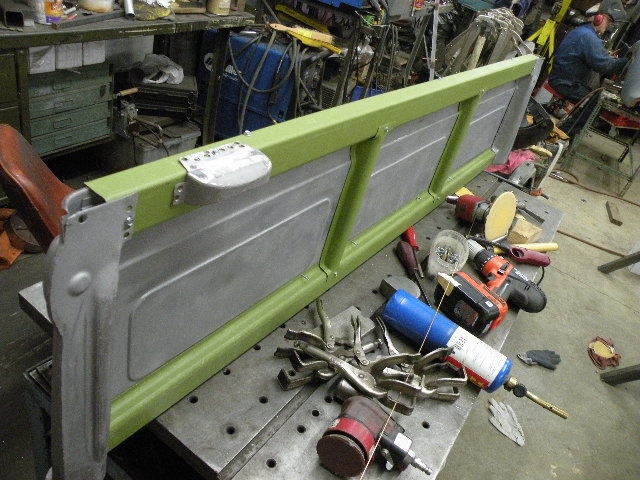

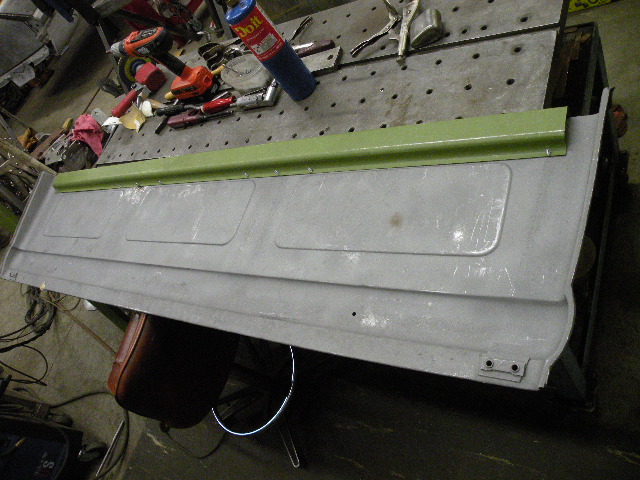

    Max is back on the box side & tail gate this week, its sorta hard to see where all the small dents & dings were but quite a bit of time was spent today hammer, dolly & shrink disc them out.

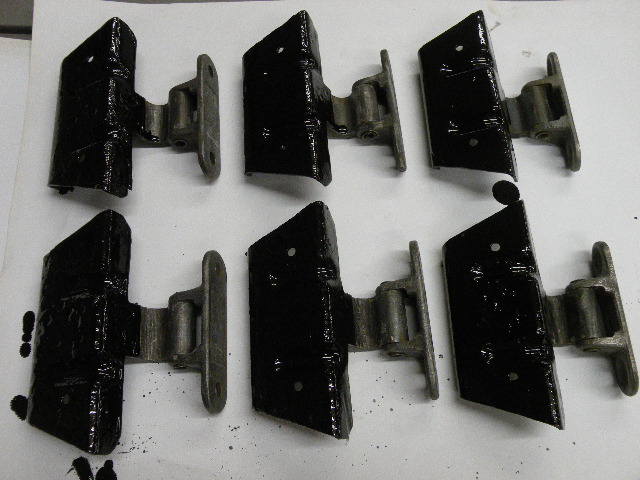

    The hinges were soaked in the mol***es tank over the weekend then painted on the inner areas with por15.

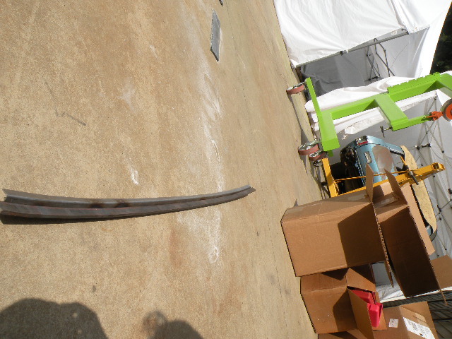

    New stiffeners being checked for fit & straightness. It had quite the bow in it before.
    DSCN8331.JPG \
    More to come.

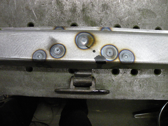

    Max did all the final fitting.
    The inner sections were por 15 coated.
    Hinges fit & welded to the outer rib.
    Finale ***embly & weld brace supports on.
    Start to roll over flange.
    There will be more.

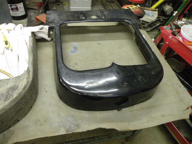

    Ron I knew what they are off of I just did not mention it as some on here get piss when its not a traditional rod, where I am trying to show how we do things in the shop & quality. Its a double cab.

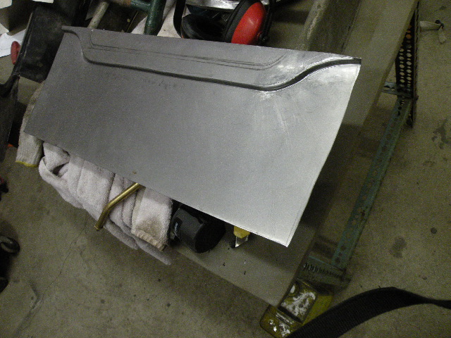

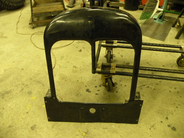

    I have to build a couple of Ames grill a 1916 & a 1922. There are only 18 Ames body ed cars known to exist of the original approximately 17,000 built between 1915 & 1923.
    Here is the 1916 grill I need to reproduce the owner needs another grill to put his second 1916 together.

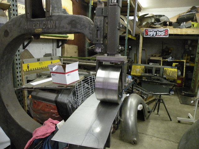

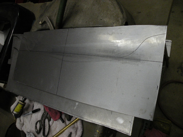

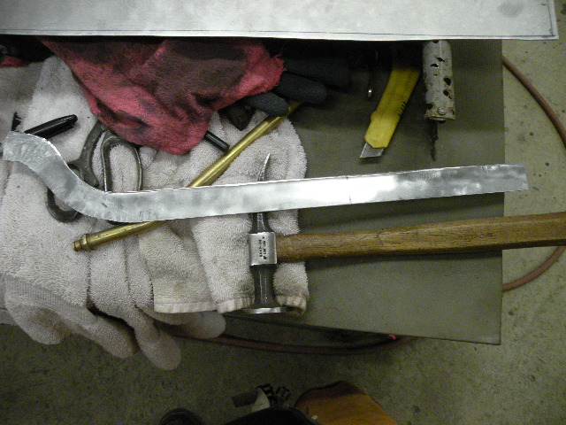

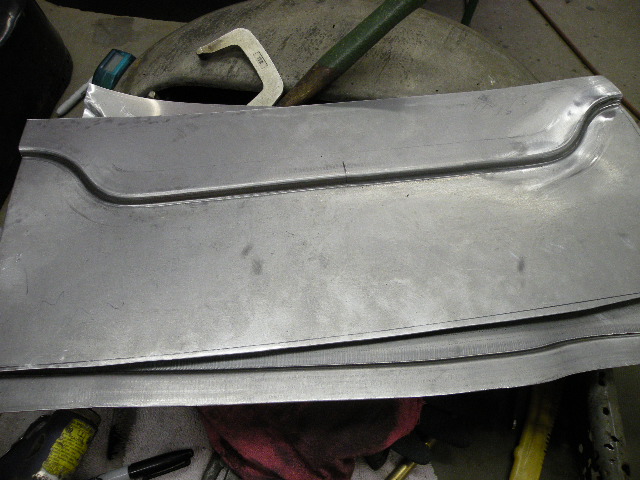

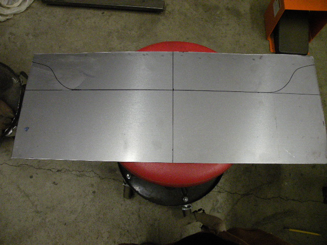

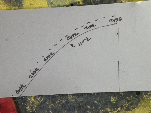

    First I made a contour gage of the lower accent section.
    I laid out the guide line on some 18 gage ak steel.
    Next I pre stretched the area to be beaded or joggled.
    The pre stretched section.

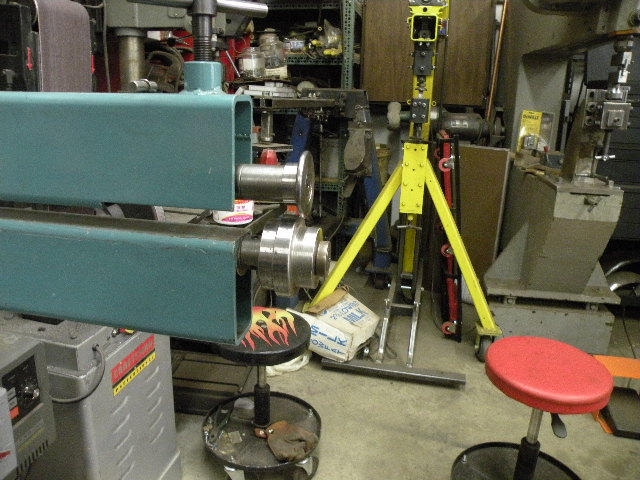

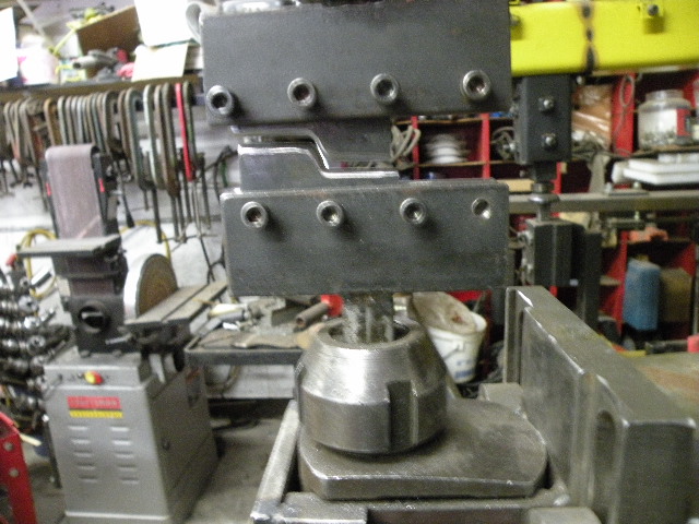

    Then I set up the bead roller to start the guide line.
    Due to the depth & sharpness of the contours I needed to make some dies for the pullmax to finish the final depth of the bead or as our friends across the pond call it joggle.
    The panel has more warpage the I like so that fix is next.
    More to come.

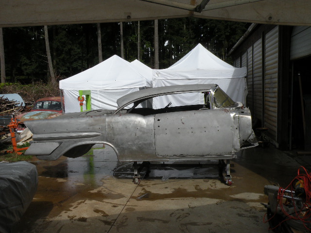

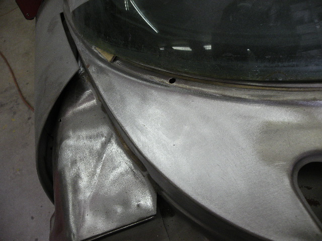

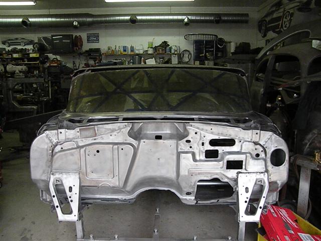

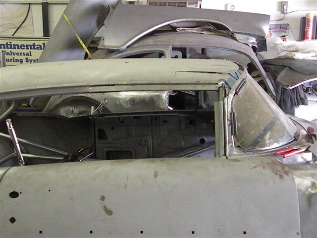

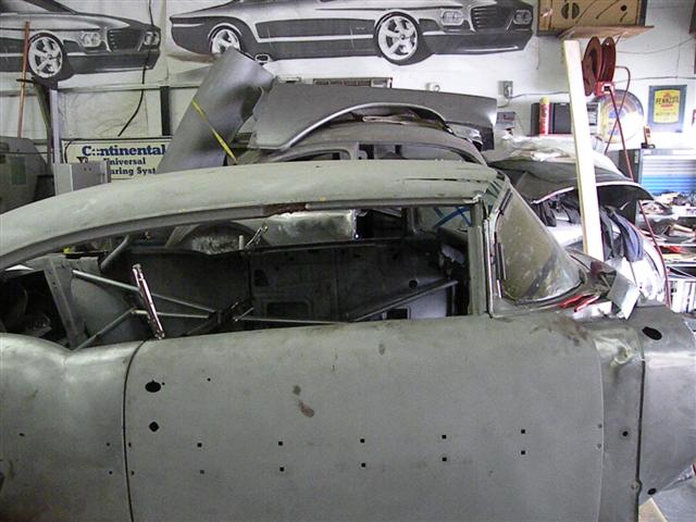

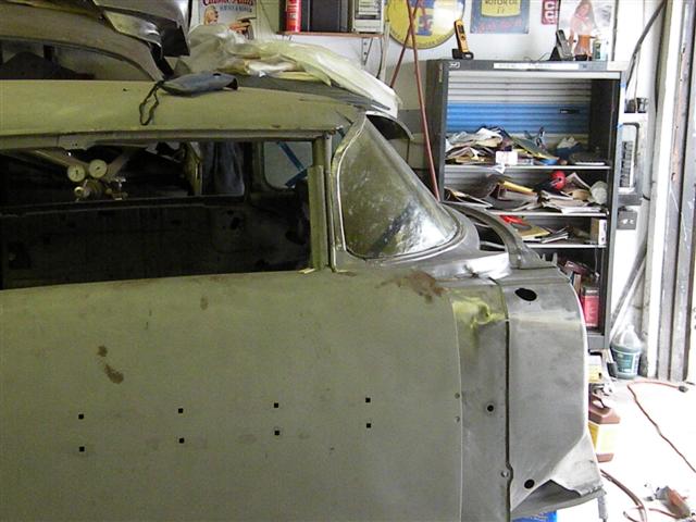

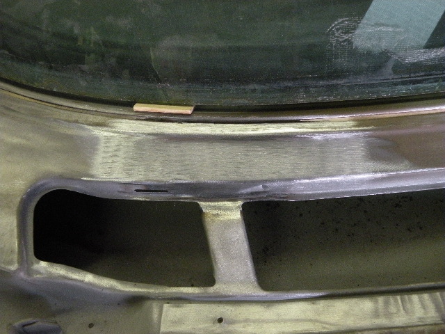

    Some more progress on the custom 57 Pontiac was 4dr.

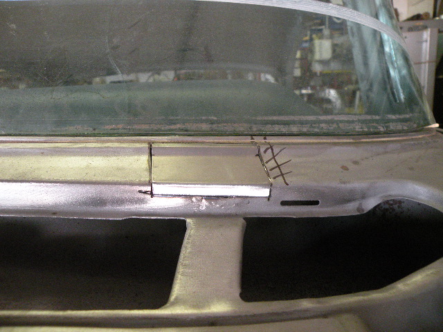

    We are using the fibergl*** template for fit.
    Sections of the old rubber were used for alignment spacers.
    A filler piece was made to fill in the old 2 dr Dodge door post upper closer area.

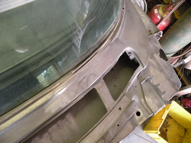

    The front outer header panel is starting to get worked out to make the now chopped Dodge roof graft & flow into the lines we are looking for in this custom project.
    Things are starting to flow together.
    The rear gl*** was fiber gl***ed so we will have a rear gl*** template now.
    Well do we still have any ones attention. I think its starting to flow together with more to come.

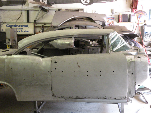

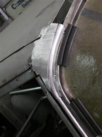

    The front is coming together nicely the grafted roof lines are starting to flow.
    Rolled out side one more time to check the look & overall flow of the top we like it.
    Pattern for the top corner for the driver side.
    one of the pieces for the corner.
    New piece formed & fit.
