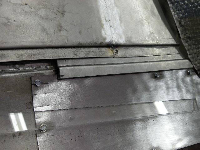

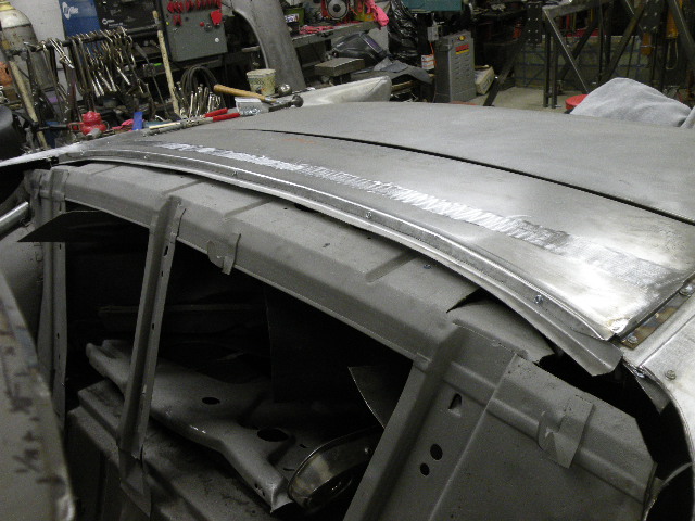

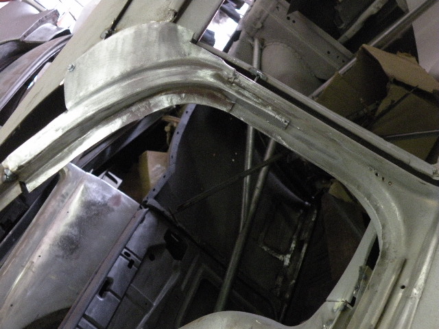

    Max did some detail finish work on the top corner. The multi pieces are now one flowing part.
    We defanately do not want a cookie cutter custom we are trying to do something that will make a statment & make people stand back & look. The owner is building a custom ch***is to go along with the project so stay tuned.

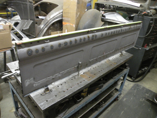

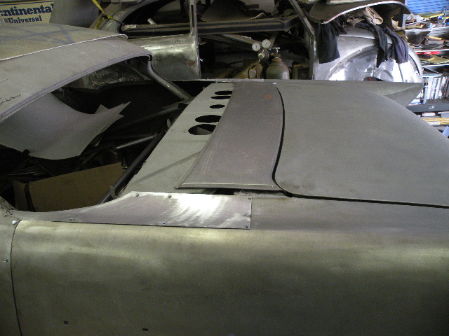

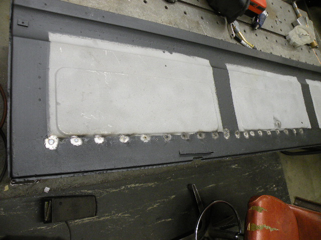

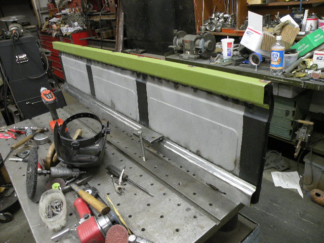

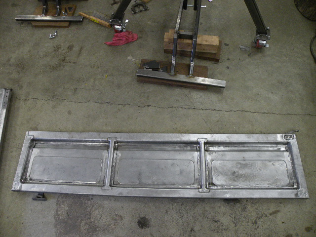

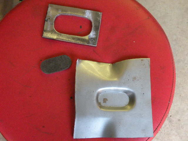

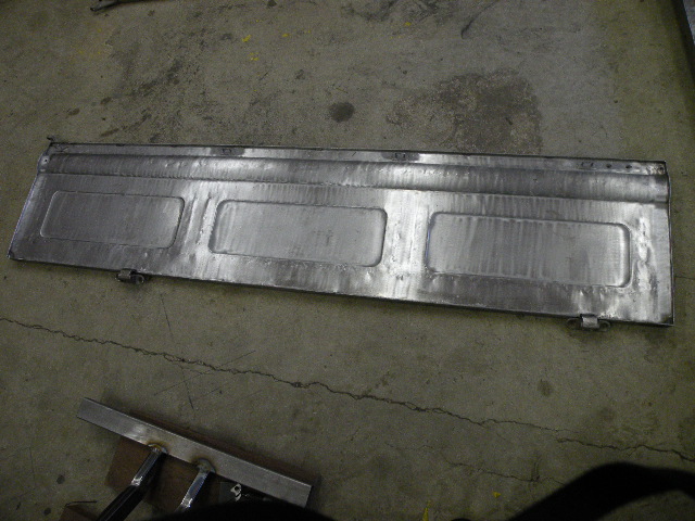

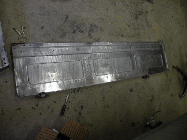

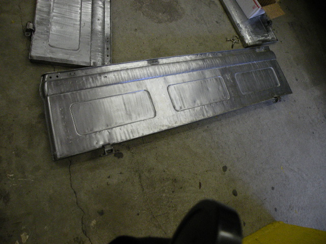

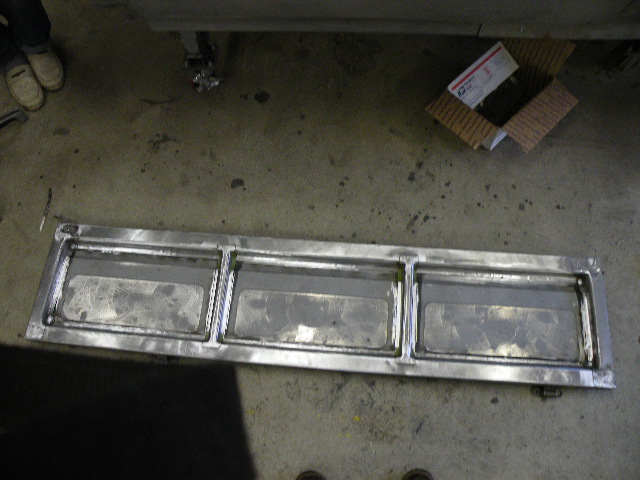

    Finished up the box sides & tail gate.

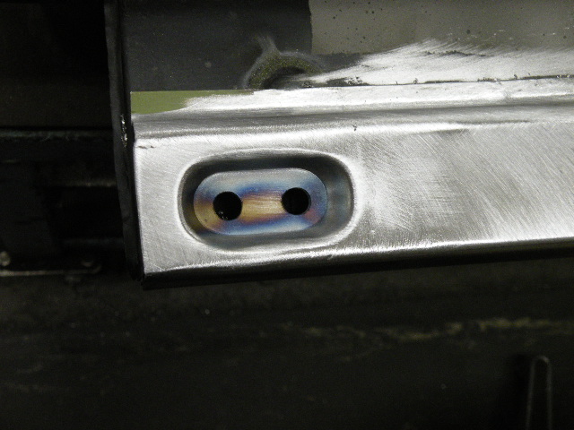

    in the upper part are the dies used to make the recess pockets.
    Tomorrow back on the Pontiac for a week & 1/2.

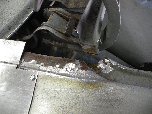

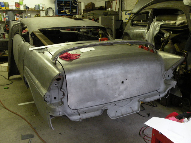

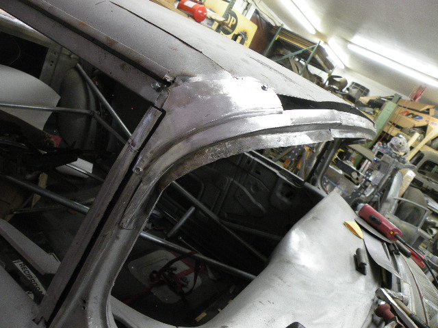

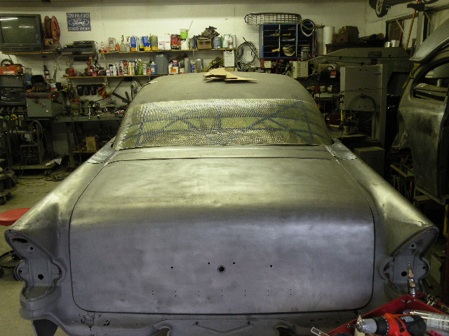

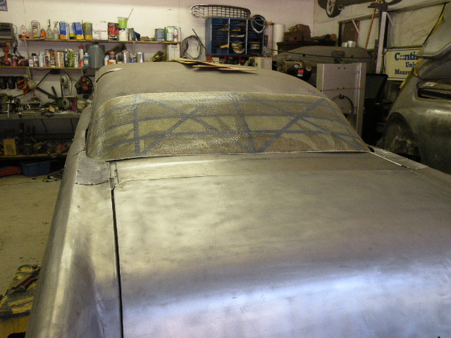

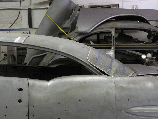

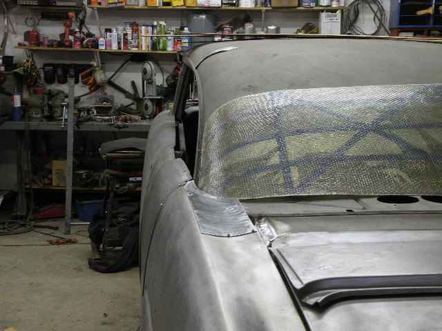

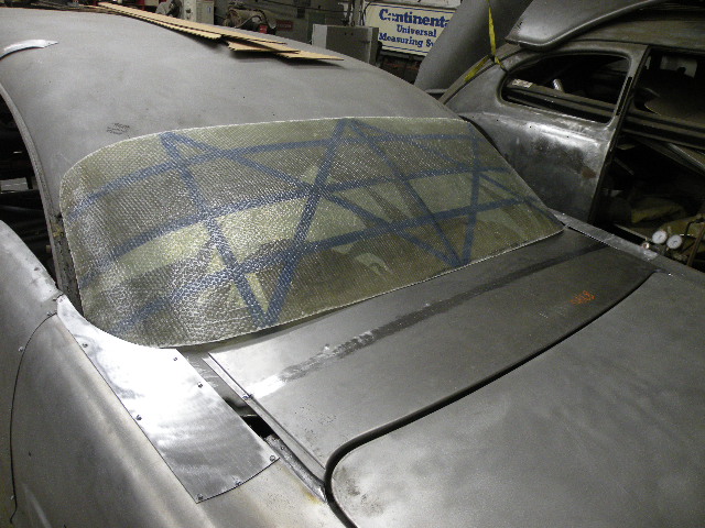

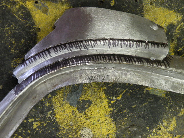

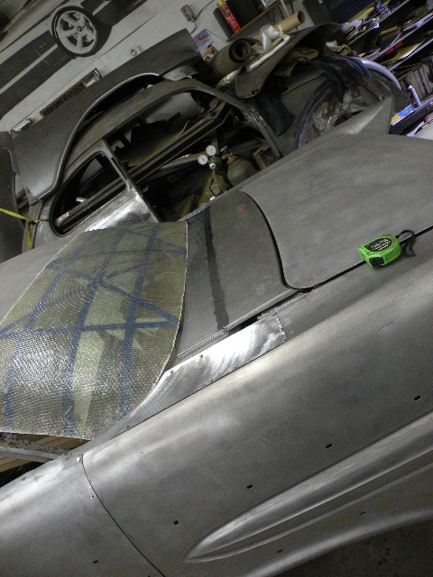

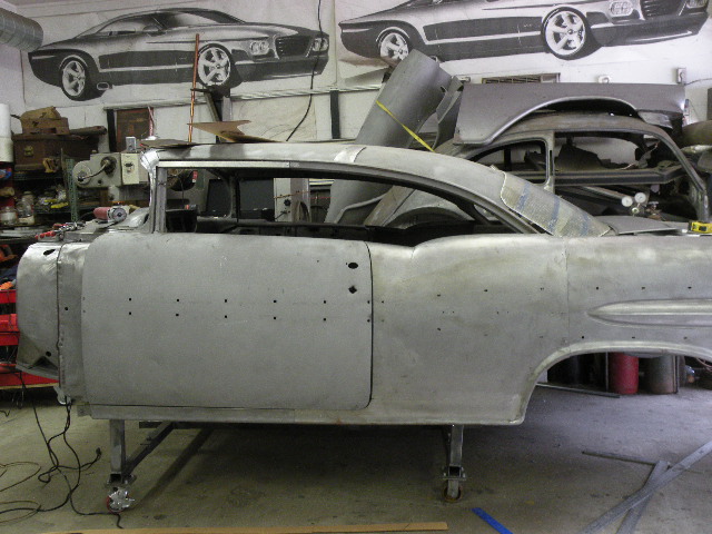

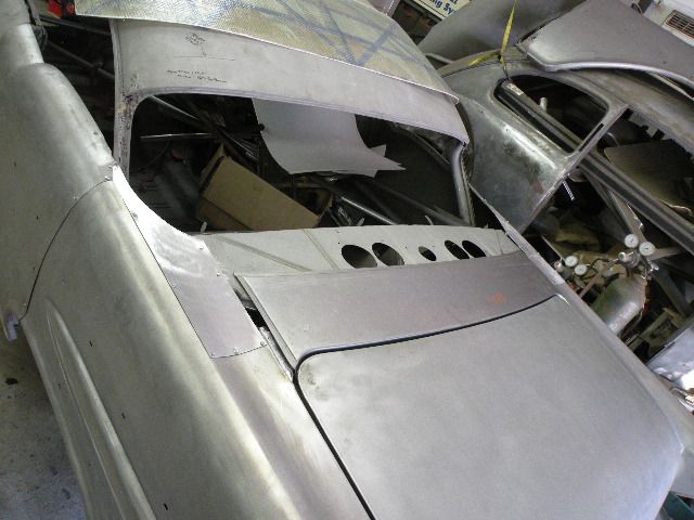

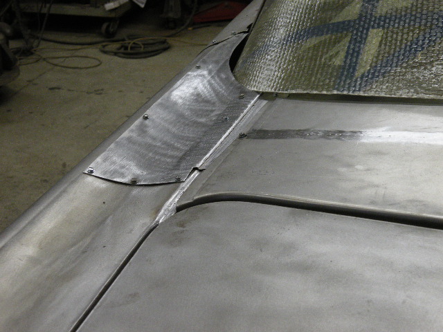

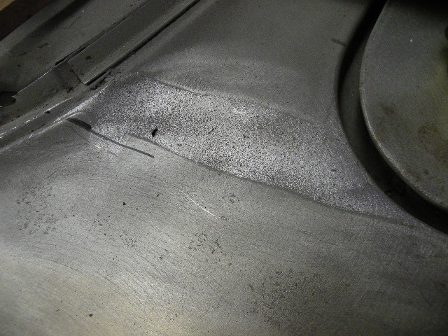

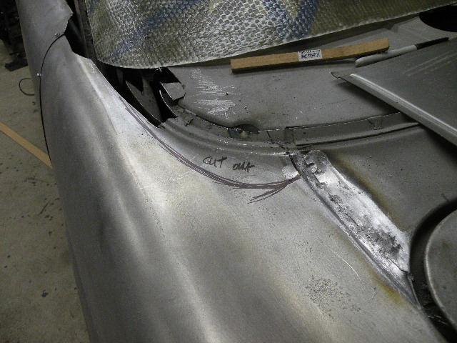

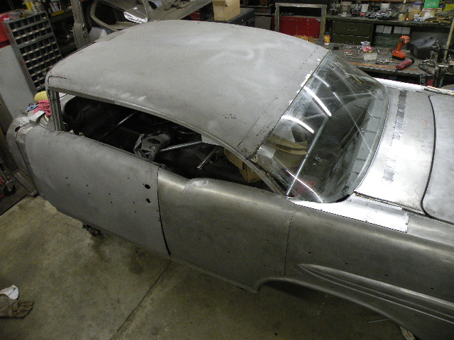

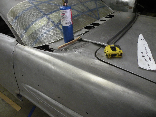

    Well max is back on the 57 for a few days to keep the project & schedule flowing along. He finished up the right front roof corner its lightly tacked in now.

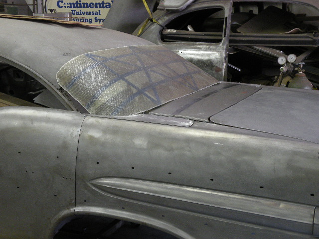

    Next he trimmed the rear fibergl*** window pattern to size. so we can ck the flow of the lines we like the look & so dose the owner.
    Its been a ton of hrs to get it to this stage but we are trying to build a out of the box custom & make a statement about lines & panels flowing together. Not some just thrown together hodge podge of parts.
    Next the factory lead seams were melted out as we are making new rear window to trunk & quarter filler panels.
    A section need's to be removed.
    New quarter filler panel section made.
    Things are starting to look like something & more to come.

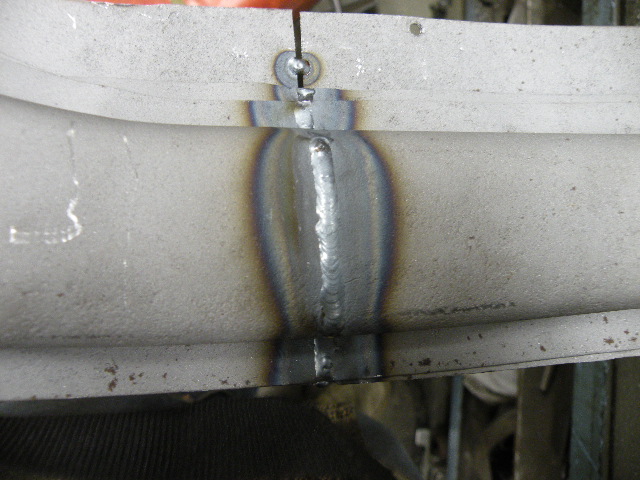

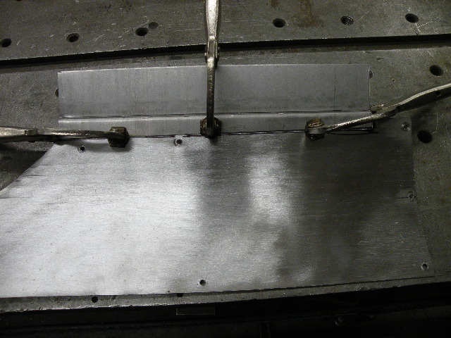

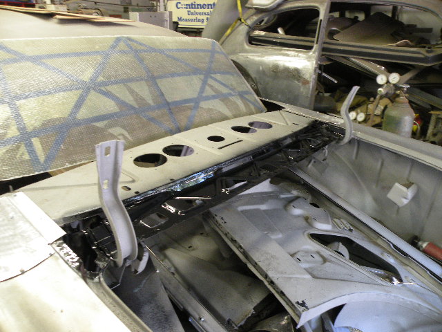

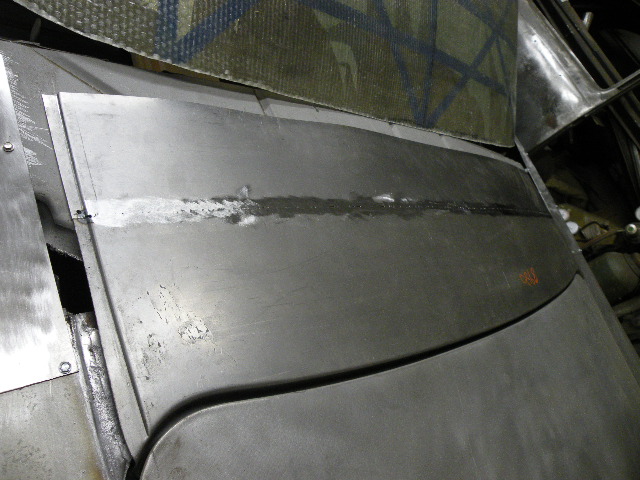

    The rear trunk to rear gl*** filler needs to be replace.

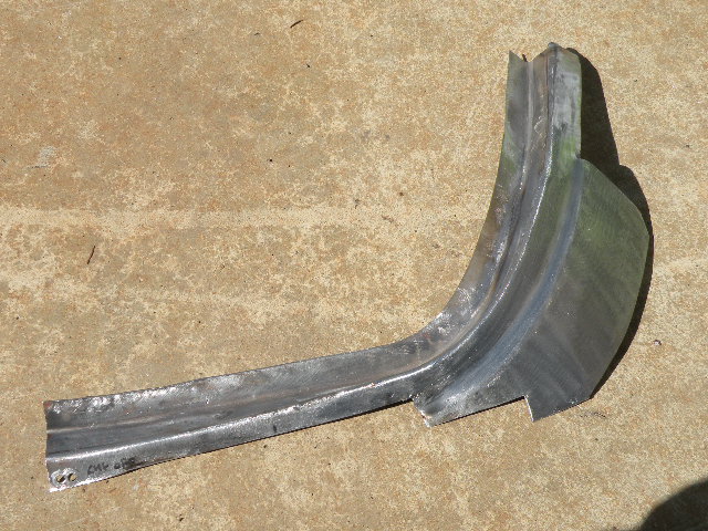

    The new filler panel is a re pop 57 Chev convertible it is wider then a sedan panel.
    An extension had to be made to fill the extra needed. yes we could of made the whole panel from scratch but the tooling to make the gutter area would of cost more then the panel & adding the filler.
    Tack welded together.
    Checking for fit.
    Fully welded.
    Checking for fit with the rear window template.
    Once all the old gutter is removed the trunk lines will be correct.
    More come soon.

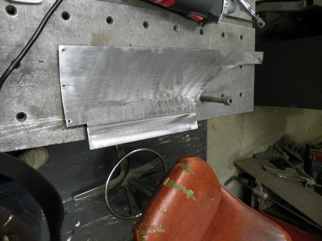

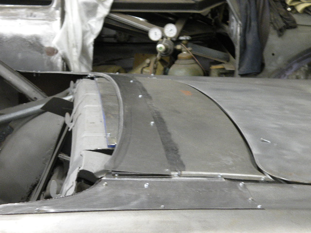

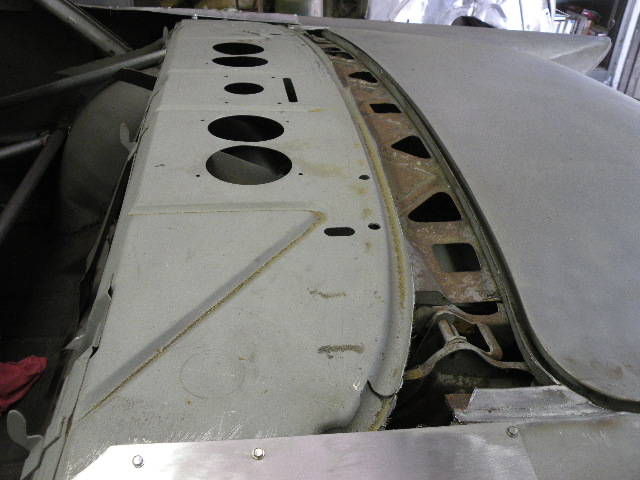

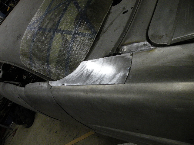

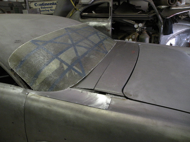

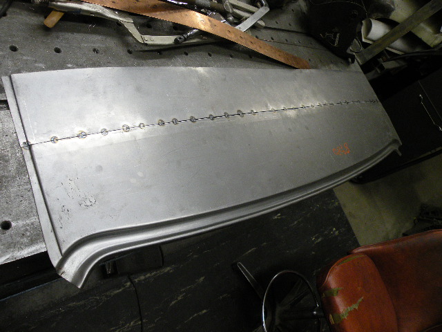

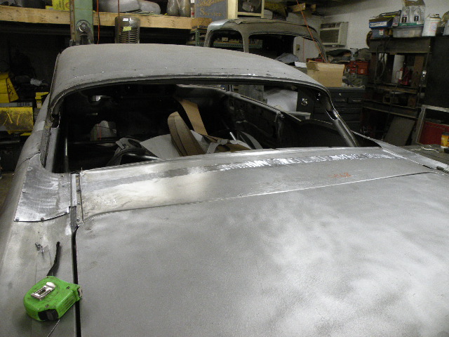

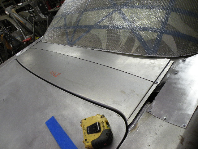

    max had to make some filler panels where the rear gl*** wraps & meets the new reworked filler panel.
    New panel made before welding.

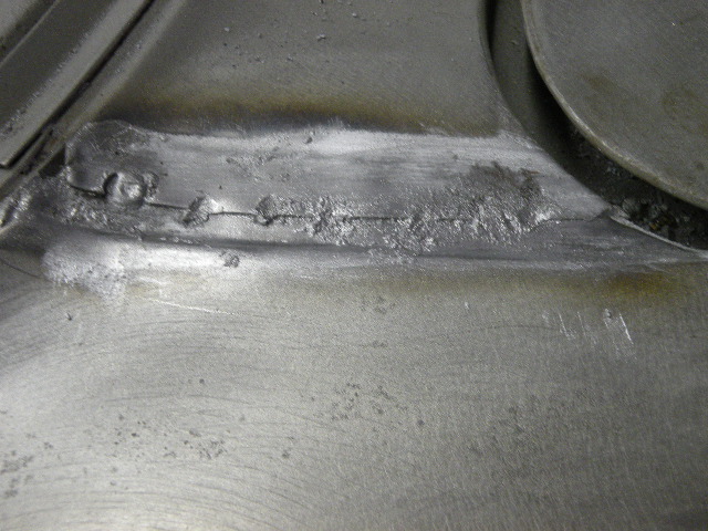

    One side welded & ground.
    Both sides fit in place with a factory type seam.
    Rear shot things are starting to flow well.
    More to come next week.

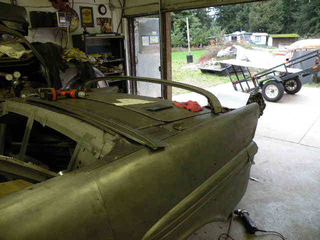

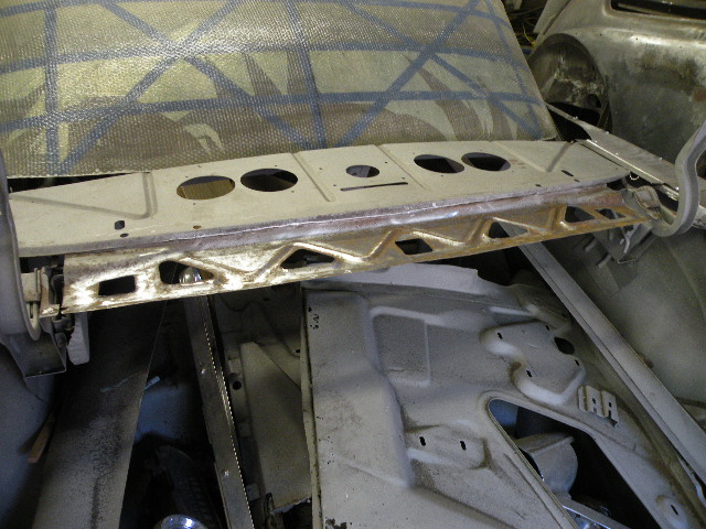

    Max removed the old rear filler panel.
    Next he started de rusting the inner structure.
    After finish de rusting it was coated with por15.
    Then the new panel was rechecked for fit.
    More later.

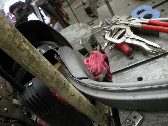

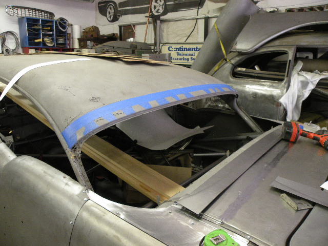

    Its time to start the front of the rear gl*** area max marked the first cut line. DSCN8575.JPG
    Then cut it off & to the left is part of the lower window chanel section.
    The rear piece needs a little attention.
    We could use it for a down force racing spoiler.
    Nah it will be fit to its new location.
    More will come.

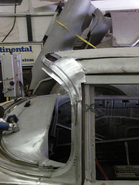

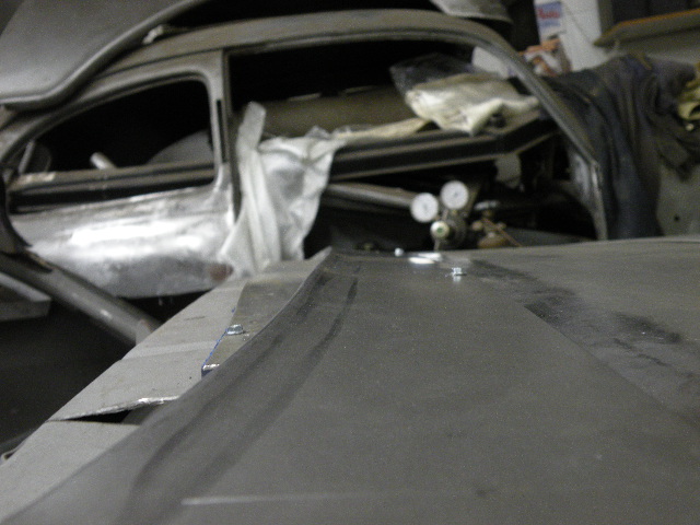

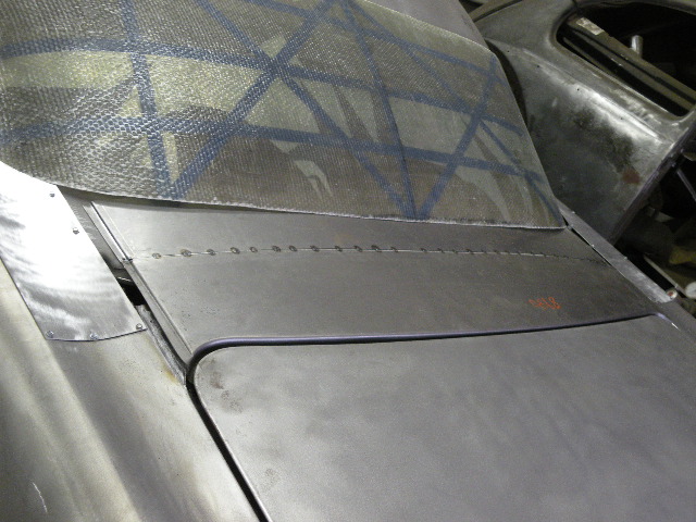

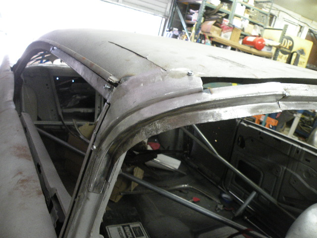

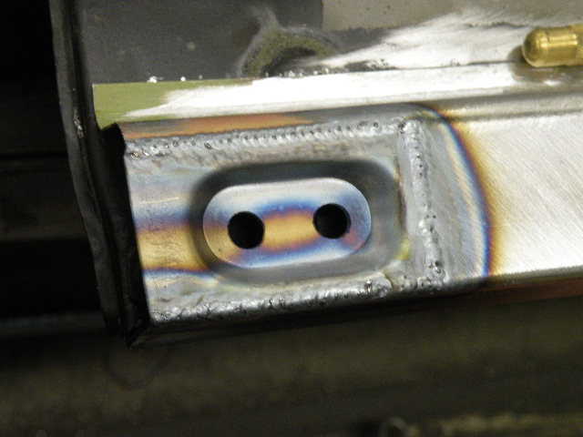

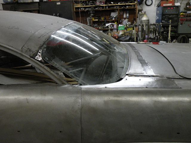

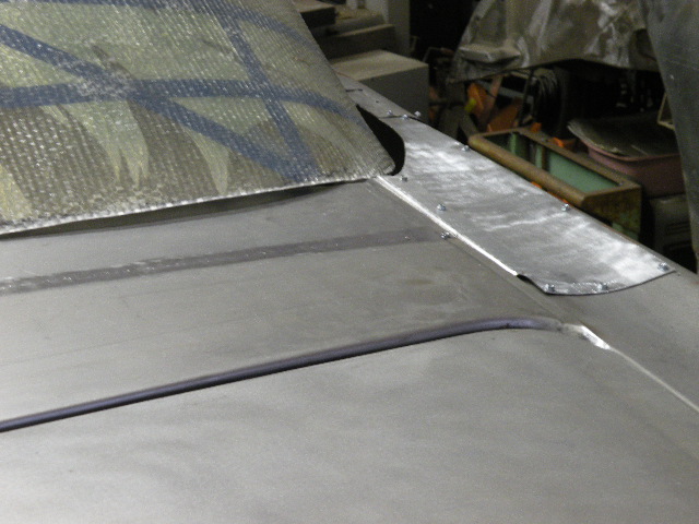

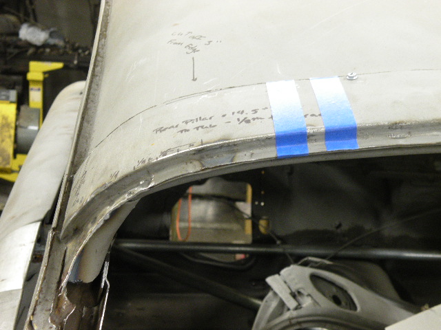

    Max finished welding the rear extension then turned a slight roll edge so the rear panel & gl*** lines will flow better, its about paying attention to the details to make all the major changes work.
    He then had to fab a lower lip to hold every thing in place.
    A check with the gl***.
    The upper section has to be shortened to fit the gl*** & roof.
    Cut & welded.
    Thats it for today, we are starting on another project 67 Dodge muscle car along with our 2 day a week schedule on the Pontiac so I can add that to the mix or not it's just lots of panel replacement work so speak up I realize its not H.A.M.B friendly but it is quality sheet metal work.

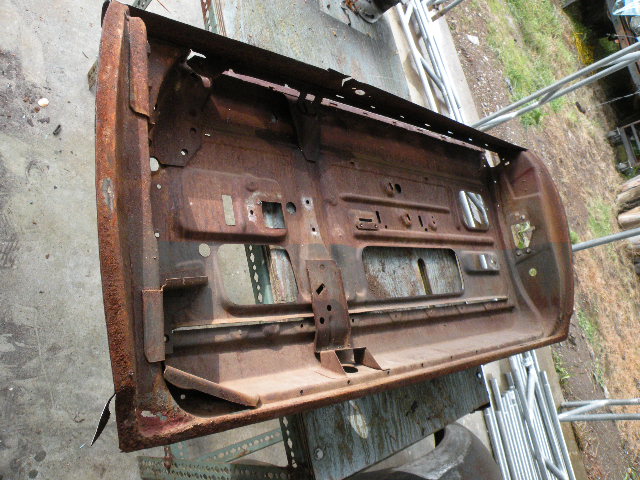

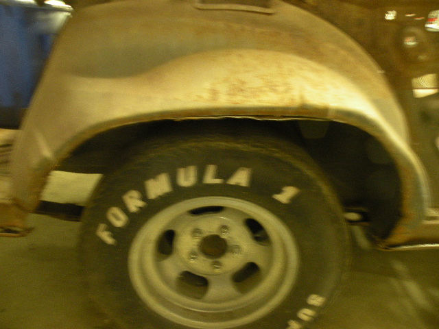

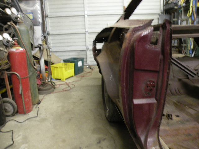

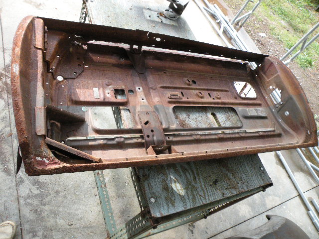

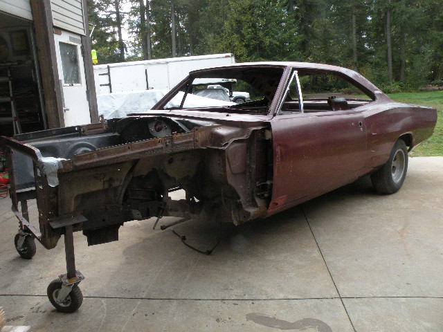

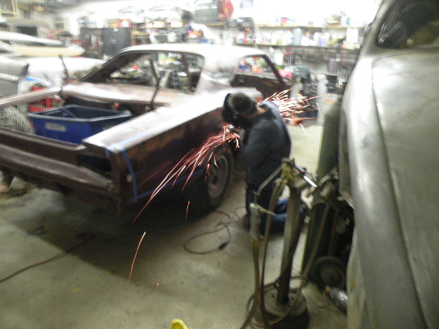

    I know this is not a H.A.M.B. friendly car but it needs some help & showing what we do gives others an idea how we do a quality job & to us sheet metal is sheet metal our cut off is about 1976. I would love to just work on 20's thru 50's but in today's economy we have to be a little more open to keep working so we are able to afford our own projects. If Ryan doesn't want this one posted all he has to do is pm me. This is a 68 Coronet & this is the way it came in.

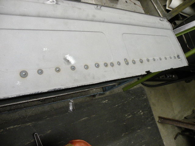

    We just did the final strip down getting ready for the blast shop, removed the doors & then removed the beat up & rusted thru skins on both doors.
    We have left the outer skin top's on till the new ones get here to make sure we do not cut to much off, More tomorrow.

    I know the G***er's are on a come back, but I think his front tires are a little small, just kidding. Looks like it needs a lot of TLC....Jim

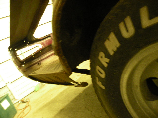

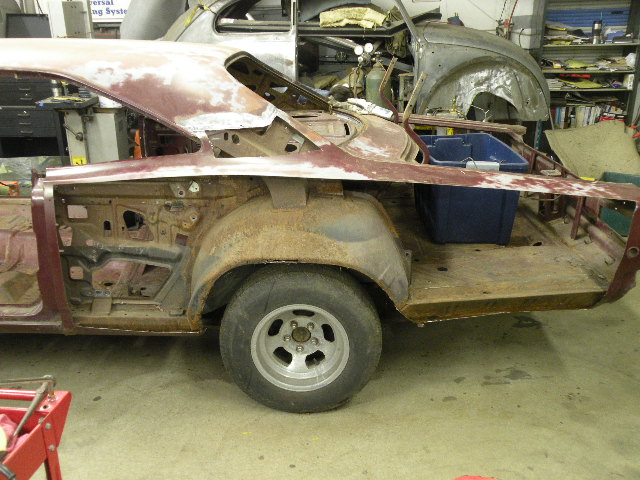

    We cut the Quarters off of the Coronet getting it ready for the blast shop.
