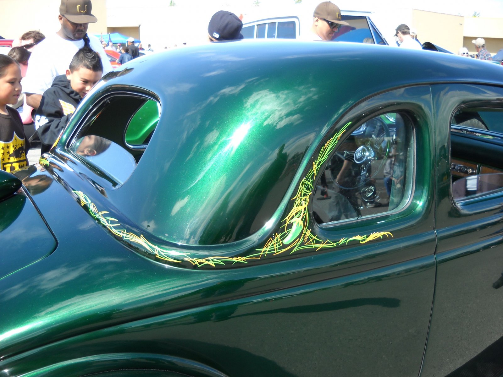

    DSCN2534.jpg Dean, Just a comment if you don't mind regarding your planned chop. The world is replete with 36/37 coupe chops, and many are horrible examples of not well thought-out implications of the result to the size and shape of the quarter window. With some chops the quarter window became the size of a port hole and others disappeared entirely, leaving a overly large sail panel in it's place. I succeeded in maintaining a appropriately proportioned quarter window by using "Marcel's technique. In mine's case the rear of the turret drops down to it's original position, maintaining the drip rail line and extra material was added to the upper quarter window just behind the "B" pillar. I then laid back the "A" pillars 6 & a half degrees to make up the short roof difference. "Kipp" has done a fantastic chop on his '36, creating a nicely proportioned quarter window while moving the roof forward and extending the trunk panel to make up the difference.. His thread posts give extensive detail of how he accomplished his chop. Others add a strip from drip rail to drip rail right at the crown of the roof. I think that is how Kenneth in Sweden does 3 windows. There are many ways of doing things and seeing your abilities on your Model A, I'm sure you'll come up with a great looking chop on your 37. I mention these things to redirect your thoughts to just one of the many issues that occur of a chop. I'll try to upload a pic of my quarter window if I can.
    I'm still waiting to see a pic of the completed dash you had a great start on sectioning.
    Best Regards and good luck with all your endeavors, KB.

    Thanks for your input KB, you are right with many of the ways these chops become "botched", Kipp did a superb job on his beautiful 36. I've planned to move the roof forward and down, relocate the B pillar and add a filler to the trunk area. I am planning on 3" and want to retain the roundness of the factory profile.
