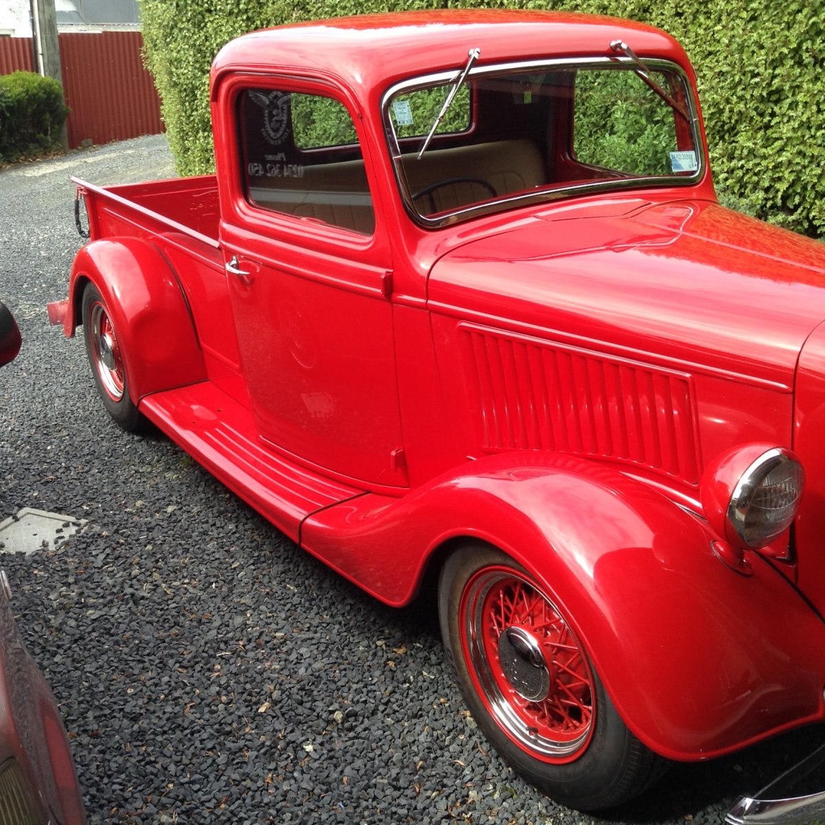

    Here is a pick of my 36 , stance I think is just nice. 4 inch drop axle disc set up and stock wish bone, steers nice. I did take a leaf out of front stock spring to make it softer.
