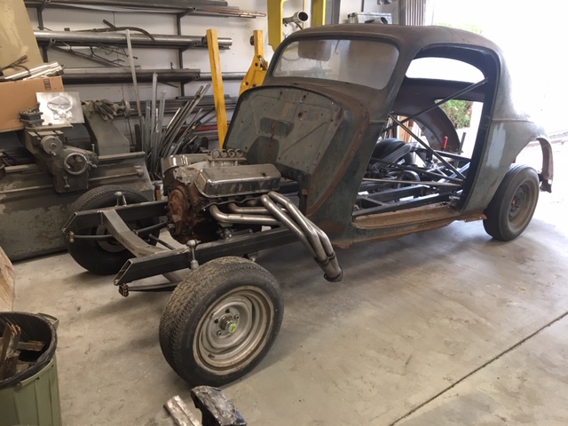

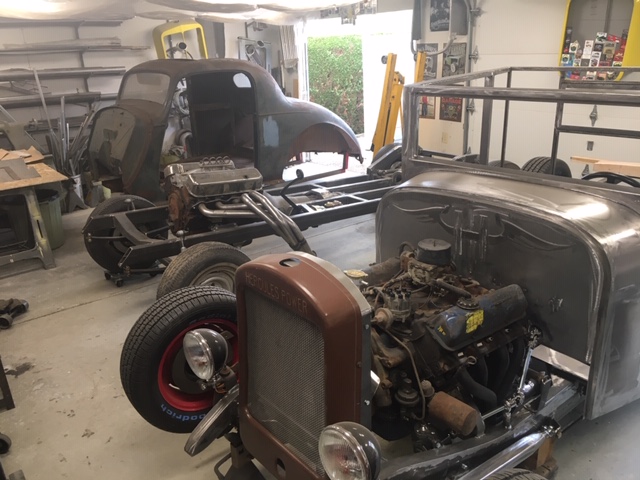

    Got the engine mounted, had to make a jog in the crossmember to get around the steering box, first try was a fail - the pitman arm hit the crossmember, so I had to rework it. Decided to mock up the power adder for inspiration - 871 BDS, 10% underdrive to keep things sorta sane.... I don't have the 750 blower carbs yet so those are just a couple of stand-ins so I could perch the scoop on top. It could just fit under the hood with some low profile air cleaners, but where's the fun in that?? At least it's a roller now...

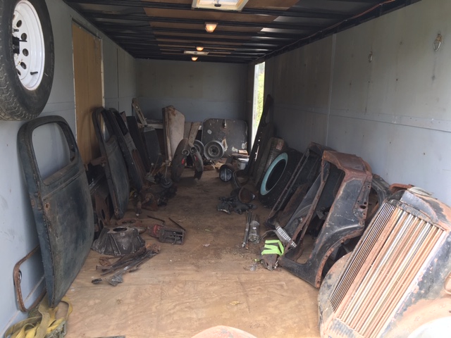

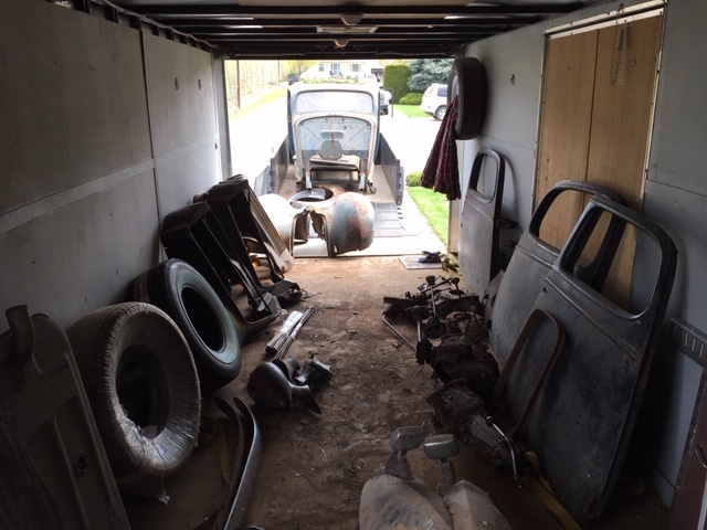

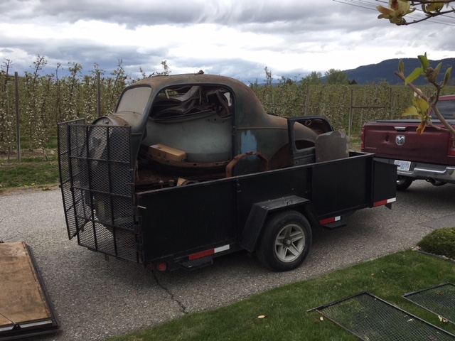

    Finally got the body home, along with a pile of parts, 7 fenders, 3 grille shells, 3 doors, 2 hoods and a whole lot of smaller parts, also a couple 40 Packard trunk lids that I should be able to cobble together to re-create the missing coupe trunk lid. Squeezed it all into my little trailer for now 'till the other coupe is out of the shop in a couple weeks, then it will get mounted on the ch***is at last. IMG_3754.JPG IMG_3751.JPG IMG_3752.JPG IMG_3757.JPG IMG_3762.JPG IMG_3778.JPG

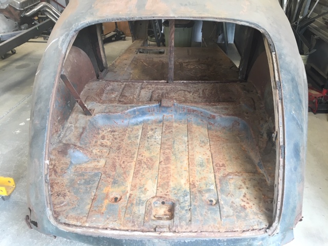

    Got the body into a dry shop for the first time in years. First thing to do will be to cut out the floors, along with the wood subrails, so it can sit on its new frame for the first time. IMG_3820.JPG IMG_3825.JPG IMG_3826.JPG

    Got the floor out, lotsa fun removing the wood sills and other lumber, cut the wheelwells since it will get mini tubs, likely just widening the stock tubs. Added some tube bracing before cutting to keep everything squareish. The rear will sit a bit higher with the 30" tall M&H cheater slicks if Coker Tire ever gets them produced, waiting for delivery since Aug 2022! I also have a rear tailpan from a sedan that is better than the mangled one on this body. IMG_3900.JPG IMG_3902.JPG IMG_3901.JPG IMG_3870.JPG

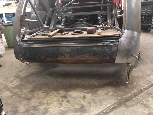

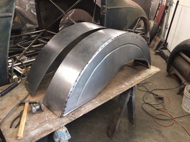

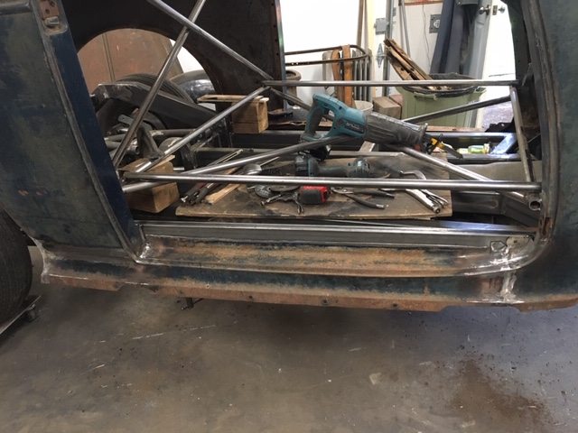

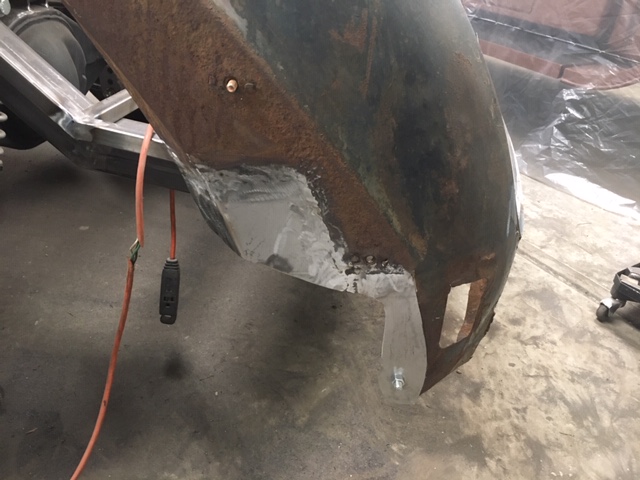

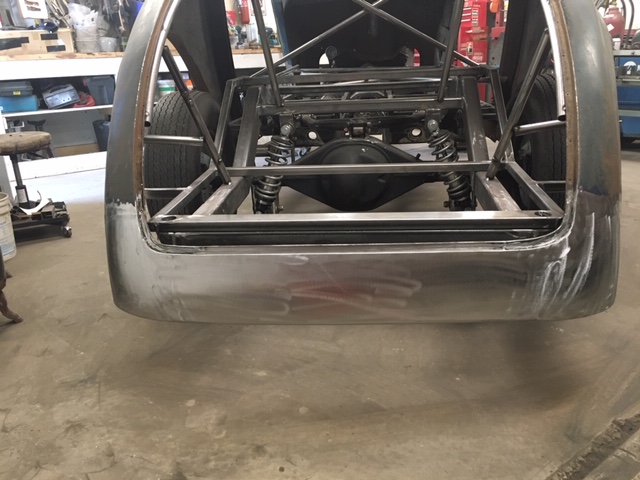

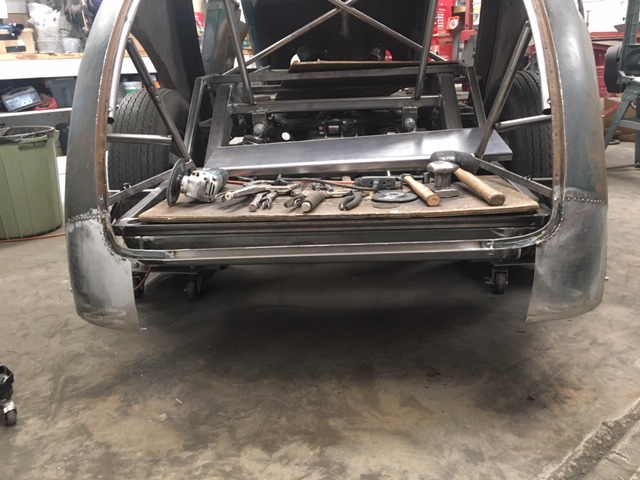

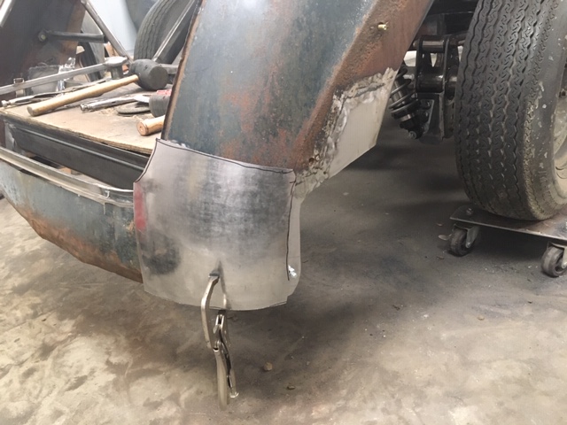

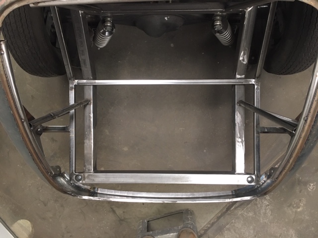

    After finishing another hotrod project, its time to get back on the Packard. Removed and straightened the rocker panels, fixed some rot, and welded them back on, eliminating the factory seams at the front and where they meet the quarter panel. Building a new floor structure and body mounts from 1x2 and 1x1 tubing, working my way to the rear. Squared up the rear of the body and braced it then cut out what was left of the trunk floor. I was going to use the other tailpan I have to replace the messed up one on this body, but its pretty crispy and by the time I straighten it and fix the rot, I might as well have made a new one - so that's what's going to happen. Also got a roof skin from a 96 Grande Marquis today to fill the top. IMG_4386.JPG IMG_4389.JPG IMG_4407.JPG IMG_4408.JPG IMG_4409.JPG IMG_4410.JPG IMG_4406.JPG IMG_4241.JPG

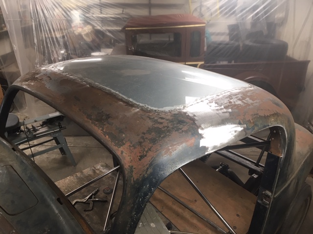

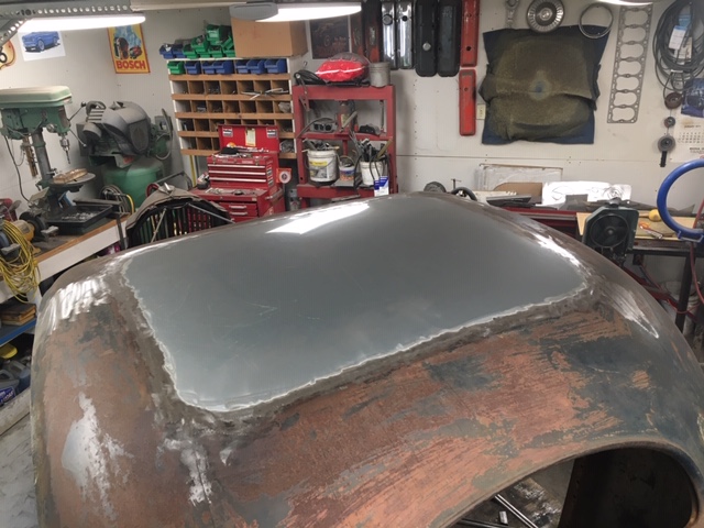

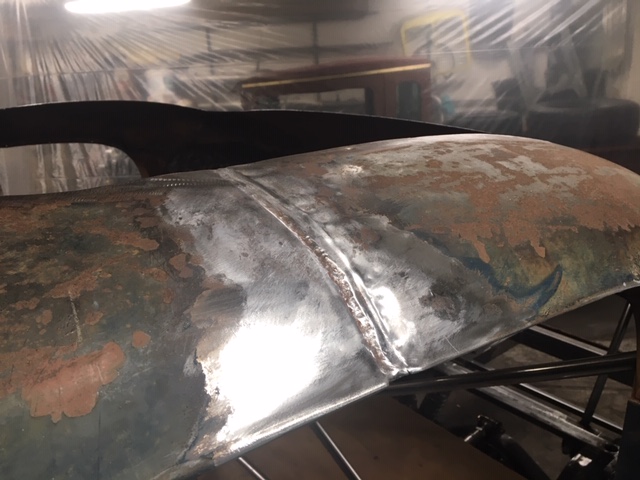

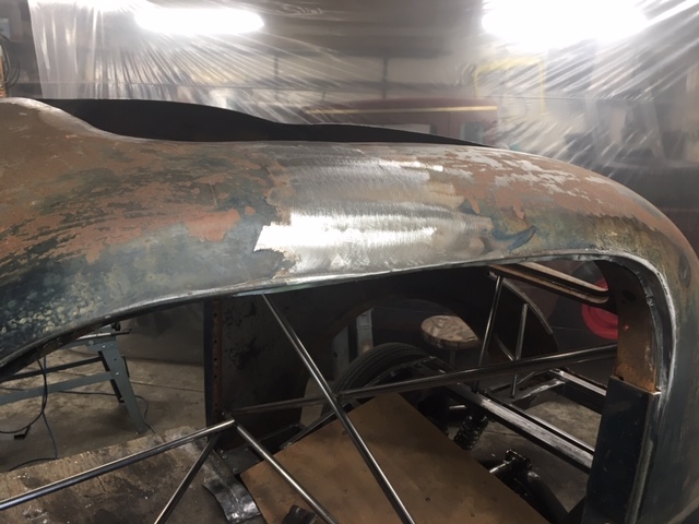

    Working on putting the roof skin on today, first melting off the old rotten lead from the seams. I didn't like the big ditch revealed on both sides where they made a lap joint, bashed it in and leaded it, so I cut it out on both sides, put in some new metal. Trimmed an fitted the filler piece and got it tacked in place. Lots more hammering and welding to do, but it fits the shape of the roof pretty nicely. IMG_4417.JPG IMG_4419.JPG IMG_4420.JPG IMG_4422.JPG

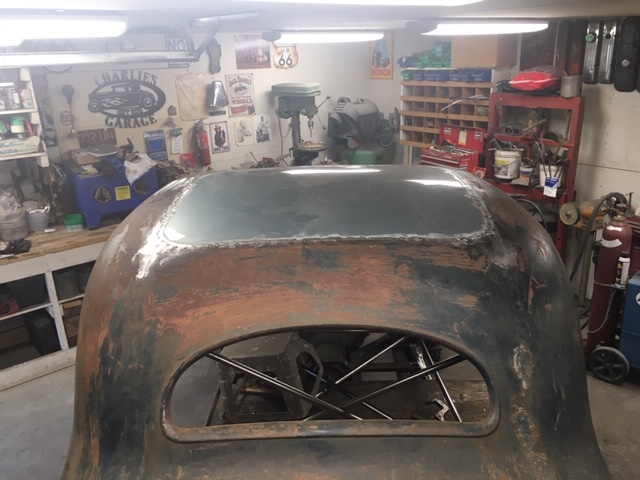

    Finished the top insert, just a bit more hammer and dolly work to do. Got to work fixing the rot at the rear of the body and making a new tailpan from scratch. Once the floor is in, the temporary supports around the trunk opening get removed and a new 1" square tube frame will get put in - it originally had all wood framing around the trunk and on the trunk lid. Another challenge will be to make a trunk lid 'cause this body is missing it, and they are next to impossible to find.... IMG_4481.JPG IMG_4475.JPG IMG_4477.JPG IMG_4479.JPG IMG_4484.JPG IMG_4493.JPG IMG_4499.JPG

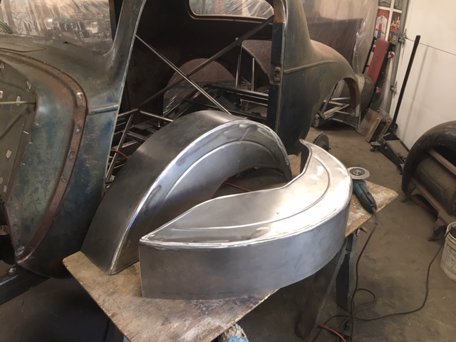

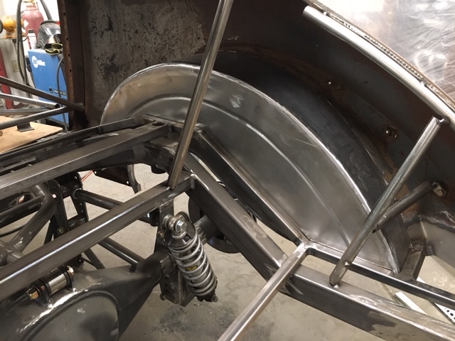

    Started making the wheel tubs, rolled a small lip on the edges so when the pieces are welded together, its not a sharp 90 edge, got the first one fitted and tacked in place. IMG_4500.JPG IMG_4501.JPG IMG_4503.JPG IMG_4504.JPG IMG_4505.JPG

    Put the other tub in and welded them both in, also moved the trunk bracing up out of the way to allow me to start putting in the floor pieces. IMG_4508.JPG IMG_4507.JPG IMG_4509.JPG

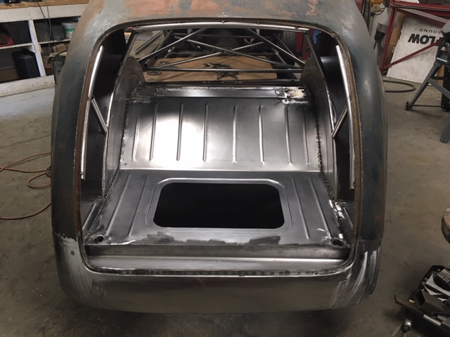

    Filling in the blanks.... floor pieces going in starting at the rear, made an access hole to get at the tank, sender, etc. IMG_4519.JPG
