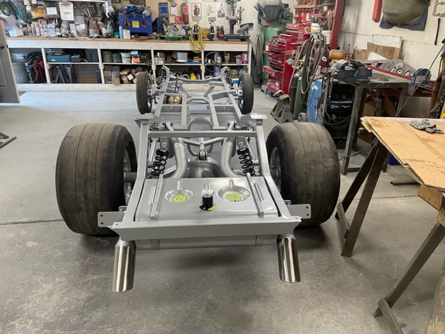

  18. zzrodney
    Joined: Dec 12, 2021
    Posts: 77
    zzrodney
    Got the exhaust all fabbed and mounted. Shortened and mounted the steering column IMG_0138.jpg IMG_0139.jpg

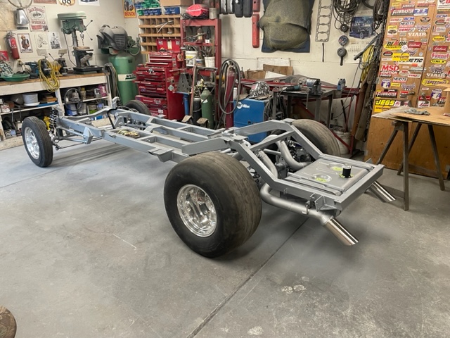

  21. SS327
    Joined: Sep 11, 2017
    Posts: 3,951
    SS327
    They look great on that car!

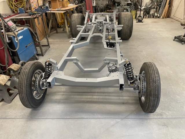

  26. zzrodney
    Posts: 77
    zzrodney
    Teardown time, major fab is done. Re***embled the cage to add tie ins to the front shock mounts and tabs for removeable door bars.

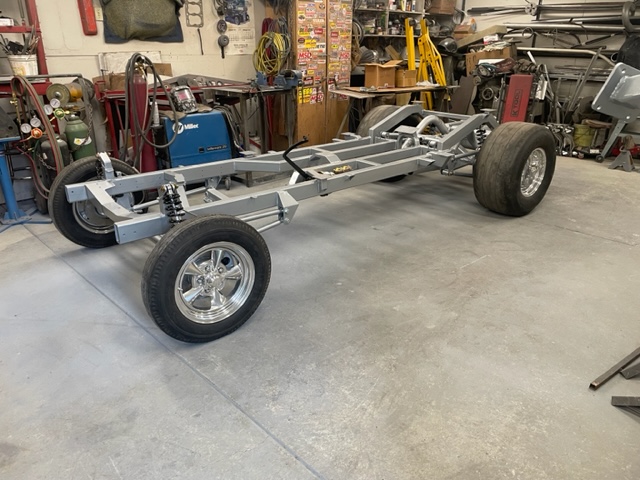

  28. zzrodney
    Posts: 77
    zzrodney
    Frame & suspension painted, it's a roller now IMG_0277.jpg IMG_0278.jpg IMG_0279.jpg IMG_0280.jpg
