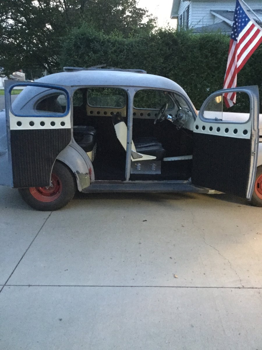

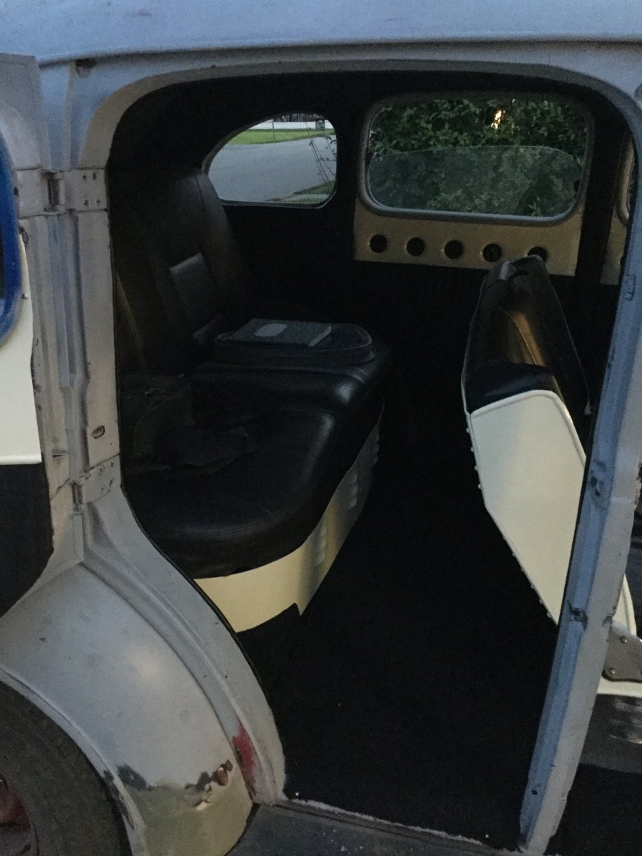

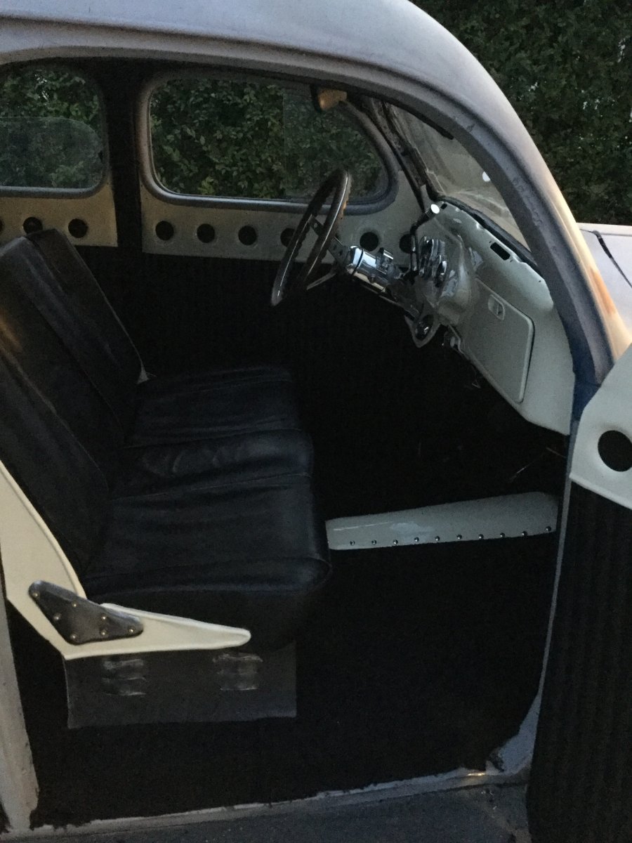

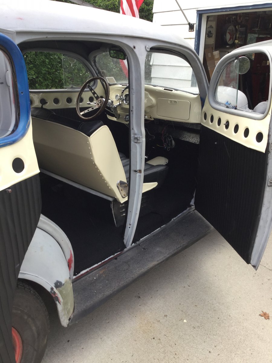

    Well I have been working in the garage all week so here is an update. I will be pulling the dash for final finish and paint tomorrow and installing the carpet if there's time. Enough talk here are the pics of the door panels and interior upholstery.
    It's hard to see in the pics but the door panels are a one inch seam roll a poor mans tuck and roll. I am very happy with the paint and finish of the interior.
    I also painted and installed the inner fenders that I made a while ago they really make the engine compartment pop. It was difficult to get a good angle for a pic. But the louvers look amazing in paint.

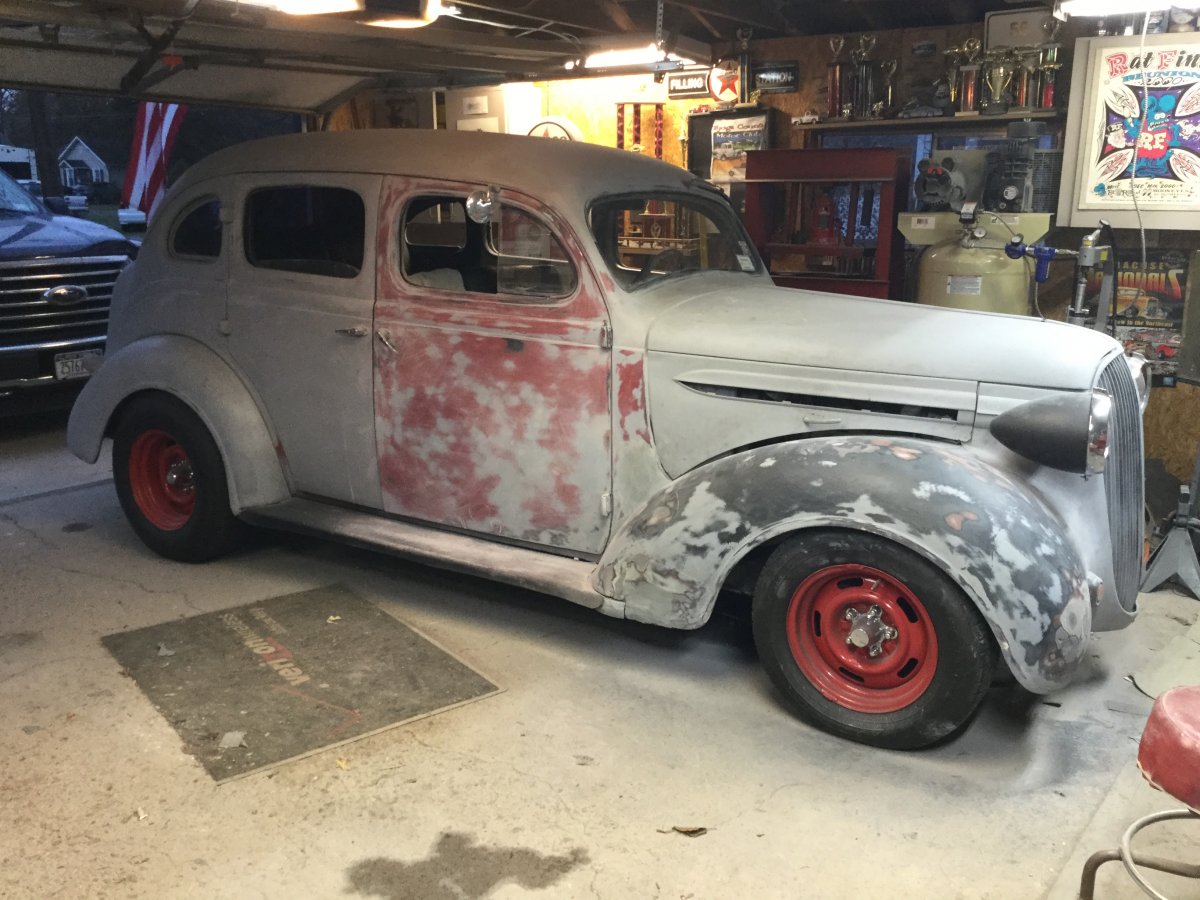

    Just an update no pics yet. I bought a ton of 120 and 220 sandpaper and the preparation for paint has begun this will luckily include metal work so I don't lose my mind sanding. Ha Ha the progress on this project has been very steady an a lot of fun. Now that I can drive it and the interior is in I can see the finish line. I will post some pics when there is something worth posting. Have a Happy Thanksgiving! Hobo Jim

    Thanks to Moose! I now have a rendering to work towards I am looking at a darker green and the same cream as the interior. The paint scheme is what I think I will be going with. The first pic is the sanding progress boy are my fingers sore from all the hand sanding. 5F493EC3-4822-48C7-993B-E54F6A7A0CB6.jpeg

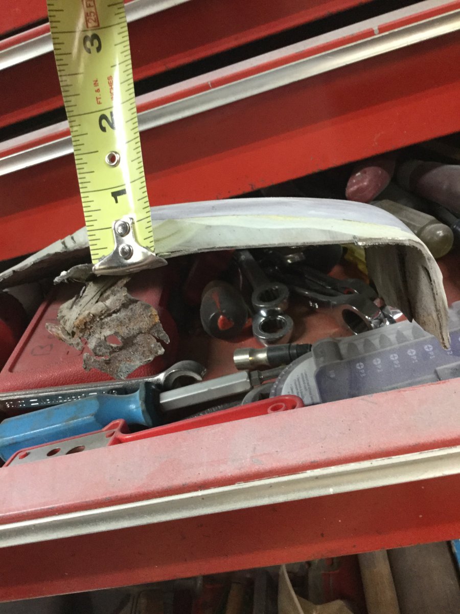

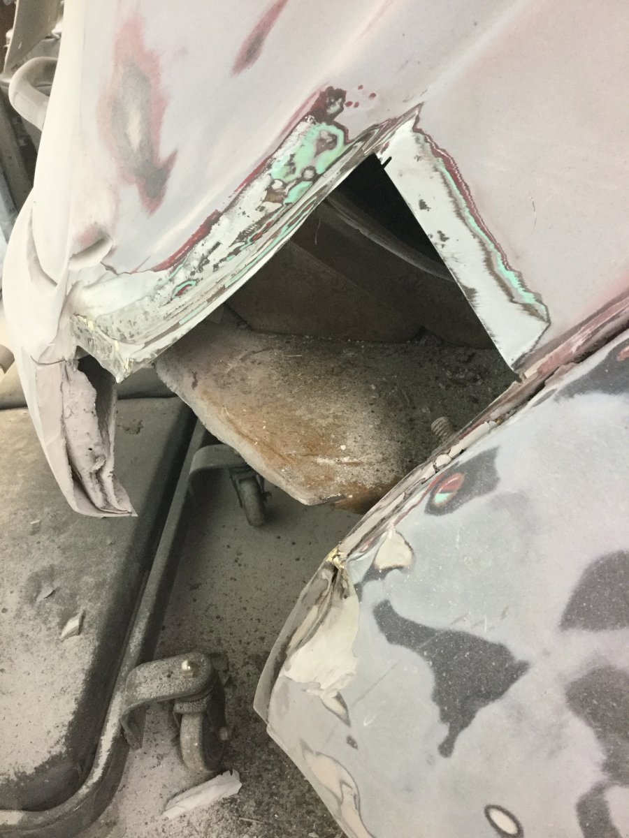

    I was out in the garage sanding and adding some SKIM coat of filler when I started working on the trouble some rear valance. I knew this had issues when I bought the car and today was the day to find out how serious those issue were. After some exploratory hole drilling and grinding I decided the best solution would be to cut it out and make a new valance. This is what I found after 80 years of use and repair.
    Yes that’s a 1/2 an inch of bondo.
    On this corner you can see where I was grinding to see how thick the bondo was. When I didn’t hit metal I knew it was time to start cutting
    This a pic of the cleaned up hole that I will be making new steel for on the left you can see how thick the bondo is over the steel. I started roughing out the new patch panel this afternoon boy is 18 gauge much nicer to work with than the 16gauge I have been working with! Stay tuned as I will be replacing the entire valance with new metal. Hobo Jim
    After getting tired of wearing a dust mask and grinding through all that bondo I found a hammer and chisel work much faster and cleaner for removing bondo that thick!
