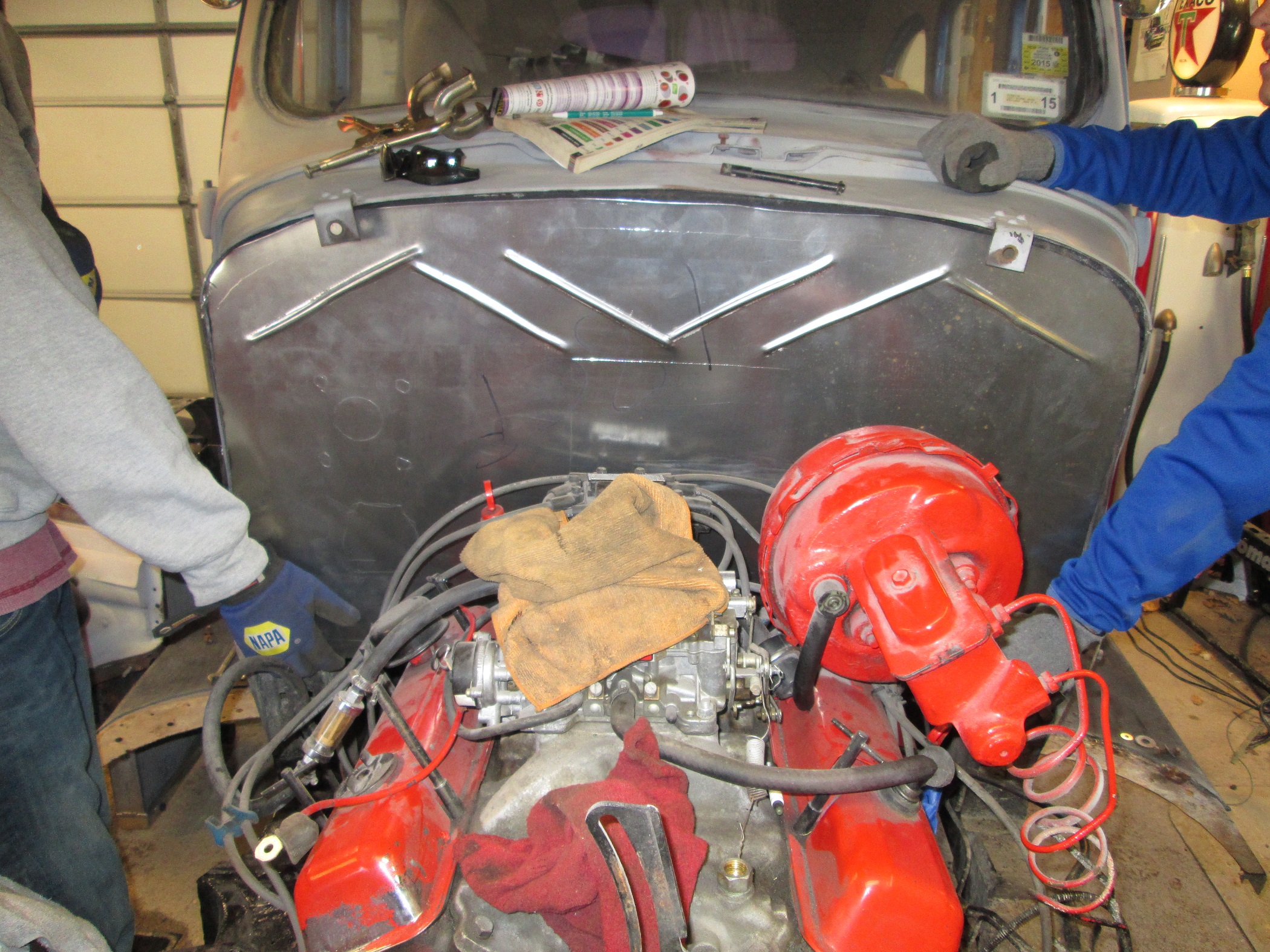

    Thank you!! I still have to figure out the bracing and the final mounting hopefully this weekend I will finalize the layout.

    Fire wall bracing is installed now the fire wall is rock solid.
    I used two inch angle iron to tie in the top to the bottom of the body sides then I ran two U channels across the opening for the upper and lower studs for the brake booster to bolt into.
    In keeping with my goal of making as many parts as possible for this build the new fire wall is installed and ready for finishing and primmer.

    OK so as with an project it just keeps getting deeper than what was originally planned I welded in the motor mounts in an earlier post but I just couldn't stop thinking about the strength of the welds because of the difficulty I had in getting into a good position. I didn't want to find out that my welds were not strong enough when I was going down the highway this will also give me an opportunity to thoroughly clean the front end and engine before painting.

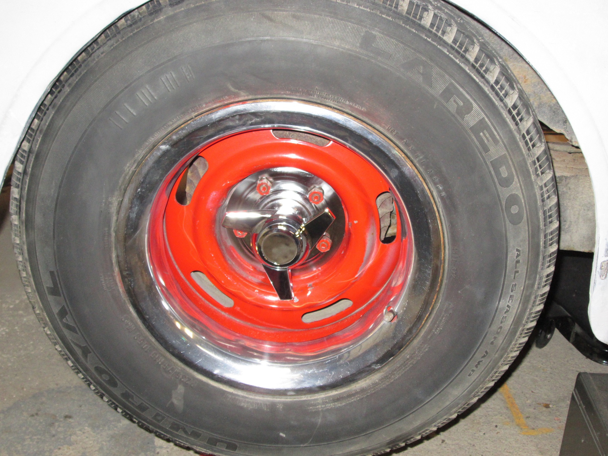

    I really like the tri bar spinner look of the 60's MOPAR hub caps so I decided to make my own version not sure if I am going to go with beauty ring or not after the wheels are painted ,but I do like the hub cap tri bar combination. Jim

    The Motor is back in I fabricated new brackets for the motor mounts a little bit of over engineering but it eases my mind, also changed the oil pan gasket motor looks good for a 77 SBC. I also was able to really clean up the cross member and front suspension. Jim
