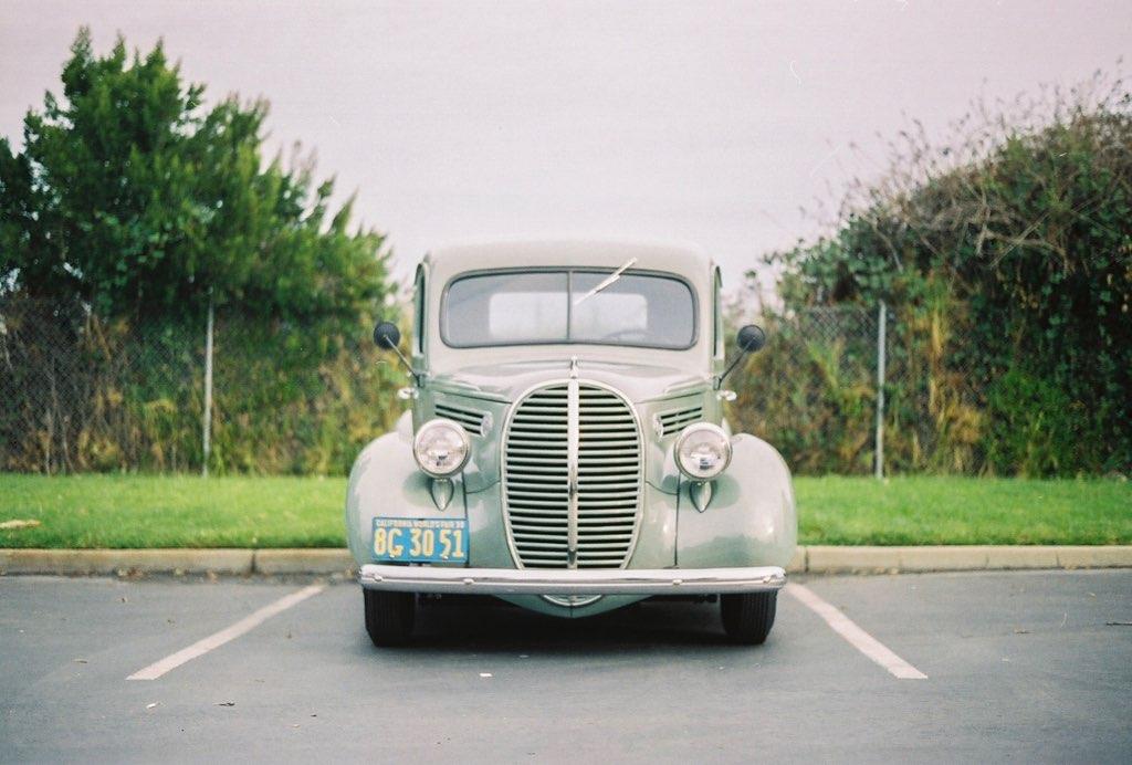

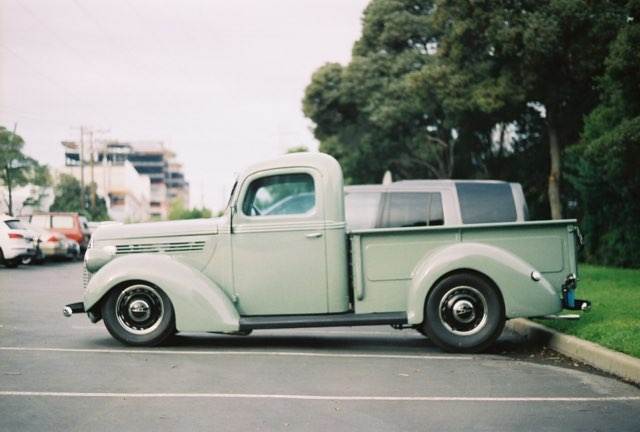

    I finally got the truck back on the road after installing a 9 inch rear, hooking up a tandem master cylinder, and fixing some small stuff. The low profile stainless half round ended up being pretty decent grille trim. Everything seems to be working pretty well, so I'll be driving down to the Mooneyes Christmas party on Friday.

    Man that's sick. Job well done. What size tires are you running?

    Thank you very much. They're 550- and 700-16s

    I was looking into 7.50-16s for rear but man yours really fill fender nicely.

    Thanks again. I was on the fence for a while about that, but 700s seem to be just right for these fenders.

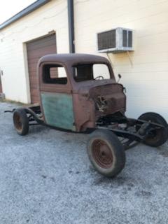

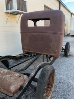

    This is 3691_1559443897920.jpeg 3694_1559443903958.jpeg my new 38 project going for a late 50s hot rod build will be a flat bed with no fenders. I am trying to decide on on an engine and trans. I am looking at a 283 4bbl with a powerglide out of a 57 Chevy but i want a manual trans.

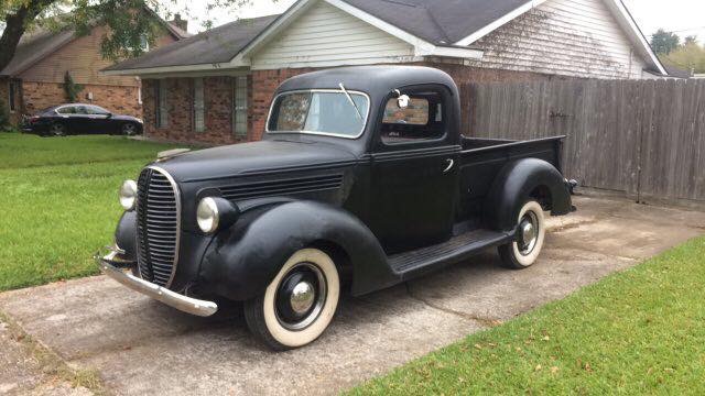

    I'm in, bought a 39 pickup today . This is my second one, last one was back between 73 and 82. I remember I used to tell every one at school back in78 that my truck year (39) was exactly half of 78 then I thought it was cool that it turned 40 . Now I have one that's 80. Dang I wish it was 39 again. Just messin around with it today brought back some good ole memories. This truck has never had anything much done other than a repaint that is probably 20 plus years old. Probably will do a repaint in future but for now In gonna drive it and enjoy that familiar old truck smell, sound and ride.

    Congratulations! Have fun and post some pics.

    Truck has 29A , several sites list this as a 100 hp 42 Merc engine, one site said 42 Ford/Merc. Has a noisy lifter ( I ***ume) . Will pull intake and see what's going on.Loaned my compression tester to someone so I haven't checked compression . No smoke , engine supposedly hasn't run for 2 or 5 years, not sure which. All lights work , headlight switch on steering wheel works both high and low beam . Trans whines , needs fluid change but doubt that will help whine Just old gears I suppose.

    Got the same motor in my 39 picup. 42 Merc ,,mine started life as a 2 ton fir-engine tanker . I still have the whole in the side of the cab were the fuel fill was . Baby looks clean as a whistle ! NICE !

    Heck ya! Truck looks clean. Enjoy.

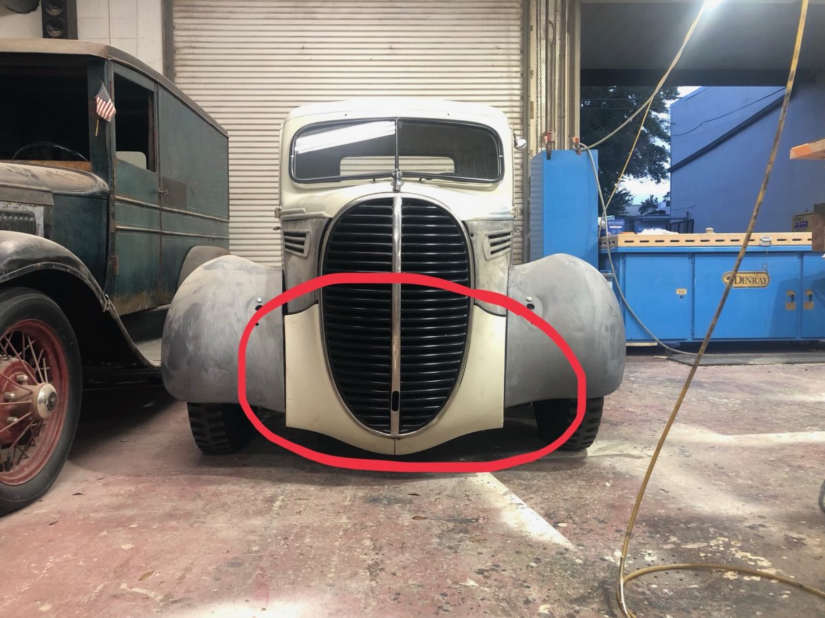

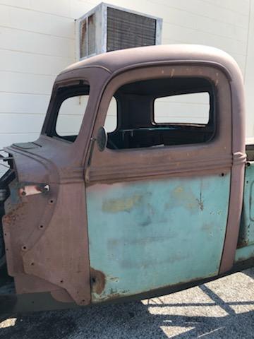

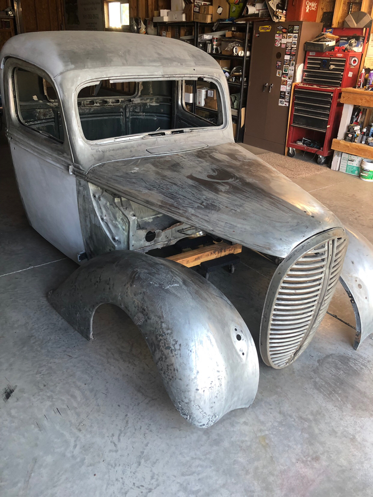

    Just picked up my winter project over the weekend
  25. hotrob32
    Joined: Oct 2, 2009
    Posts: 315
    hotrob32
    from Bend

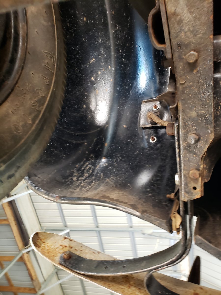

    That is my project above. Does the fender or the grill apron supposed to have the slot for the bumper bracket ? Mine has no bumper slot and all parts have been stripped to bare metal. Im having a hard time lining things up

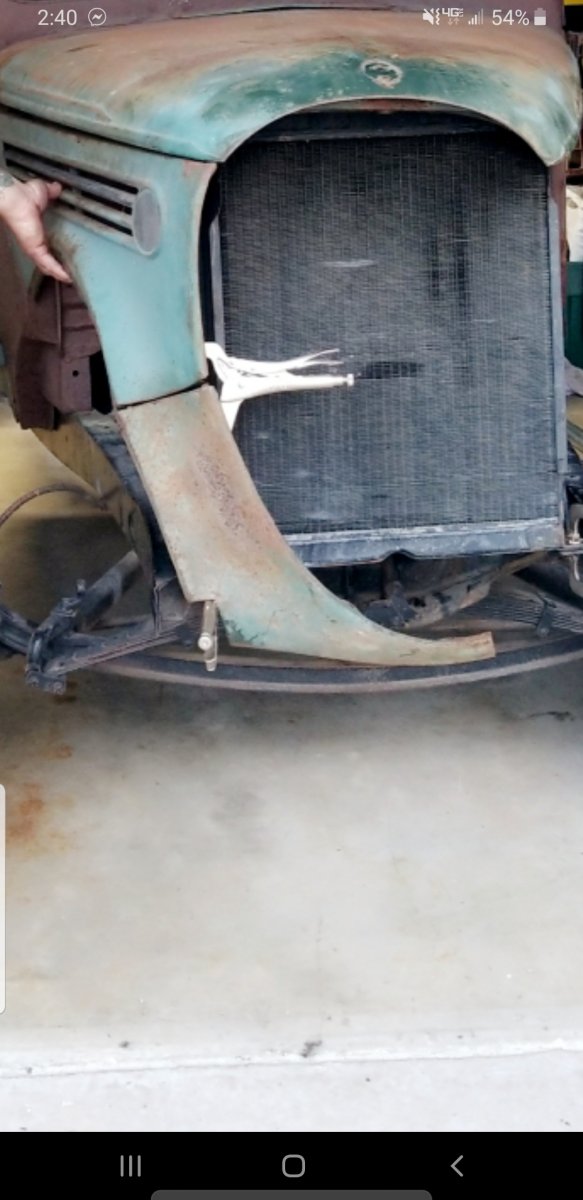

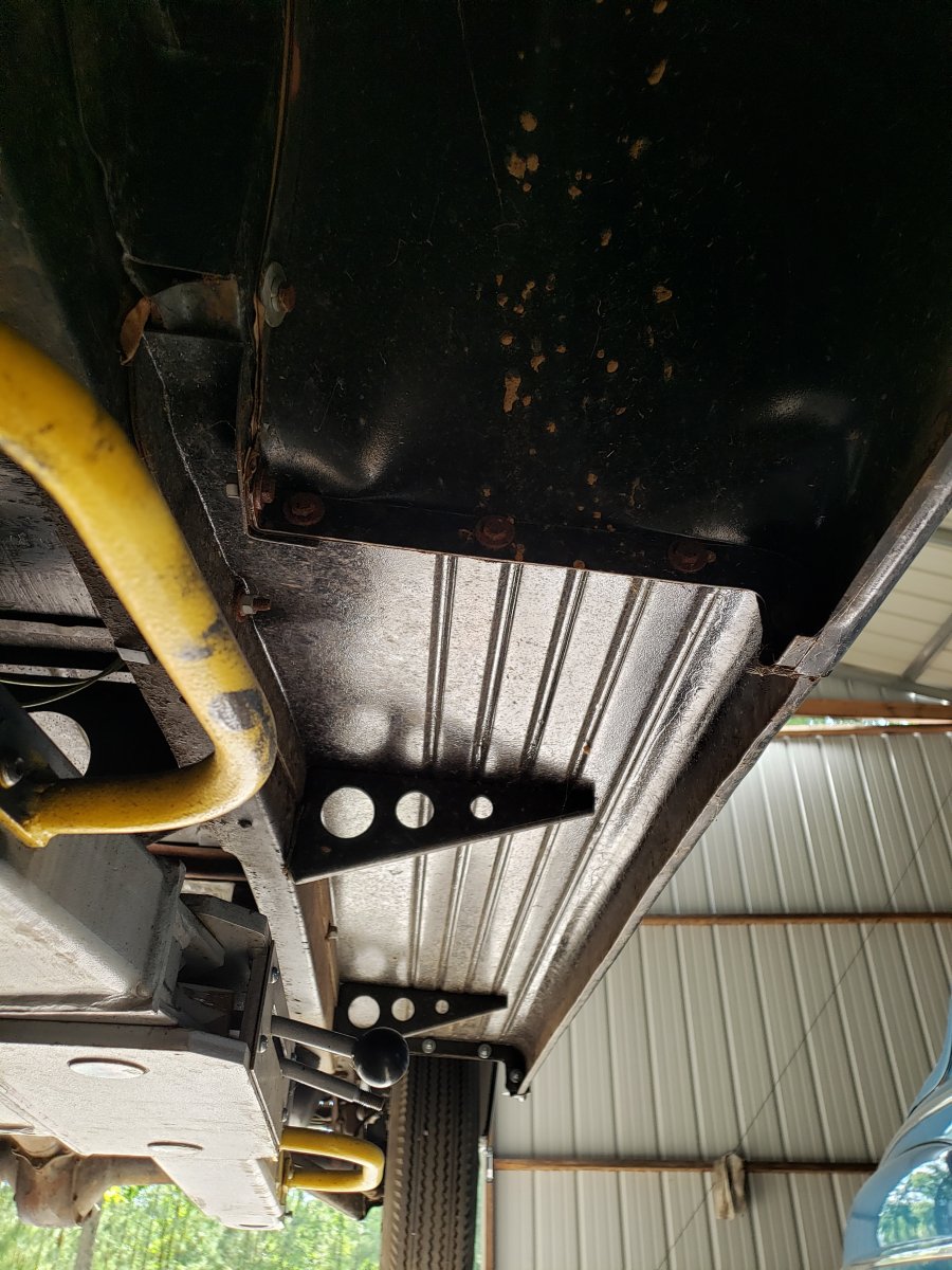

    I'm not close to mine. I zoomed in to some of my pics. See if this helps any. Screenshot_20190929-222737_Gallery.jpg

    So it seems that there are differences in 1/2 ton and the larger trucks as far as the lower panels and how far they come down in the front and the bumper bracket opening
    exterminator likes this.
  29. hotrob32
    Joined: Oct 2, 2009
    Posts: 315
    hotrob32
    from Bend
    Bingo, that's exactly how it fits. All my parts were already stripped so I guessed they were from the same truck. Looks like I will be searching for the lower apron parts from a 1/2 ton
