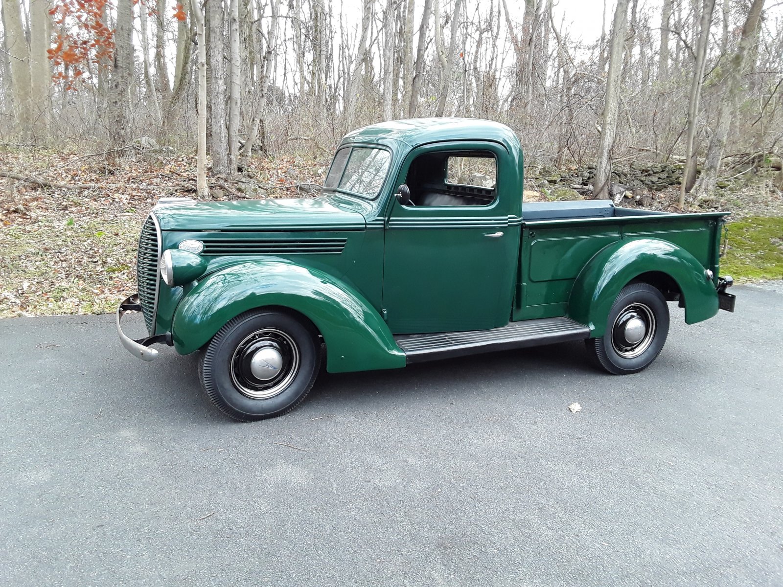

  7. Just got this one road worthy. Got it in May but a lot of small issues slowed me down. 20211203_123932.jpg 20211203_124334.jpg

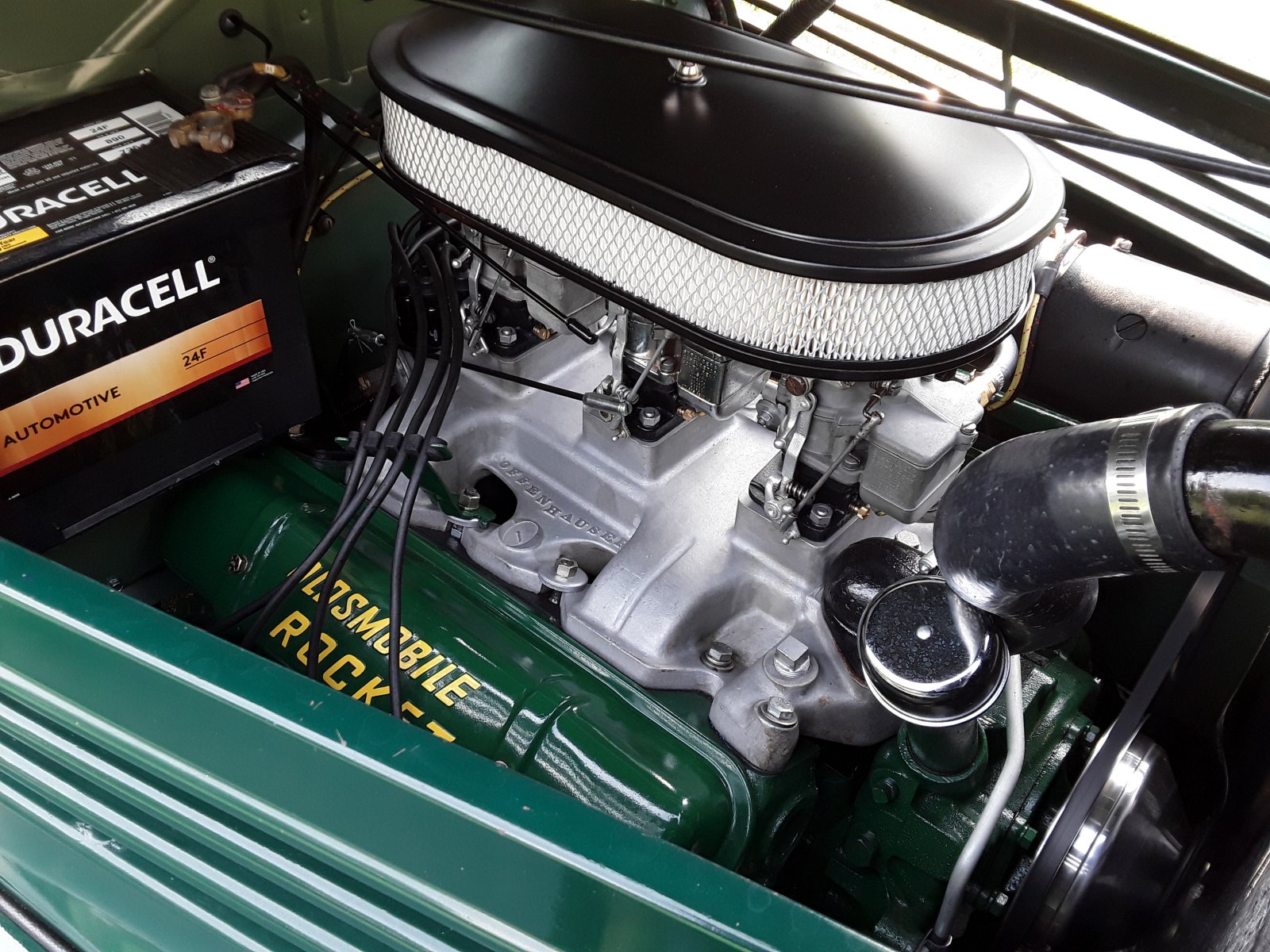

  16. Major change for my 39 this summer. Pulled the tired flathead and installed an Olds 324. Fairly easy swap, starter crossover, adapter to keep the 39 gear box and Hurst mounts with spacers. Only needed to remove an inch from the bottom of the firewall to clear the back of the Olds bell housing. I did upgrade to Zepher gears so now it's much more fun to drive.
    20230527_131829.jpg 20230530_165020.jpg 20211203_124334.jpg 20230725_090035.jpg

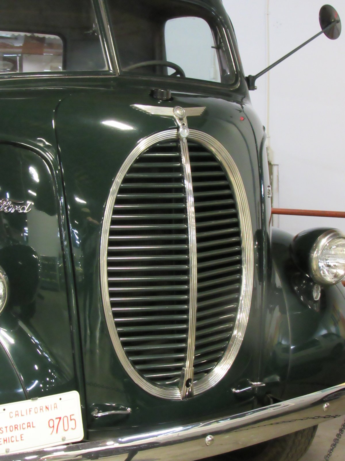

    How about a 1940 barrel nose COE tow truck

    Need more photos, please.

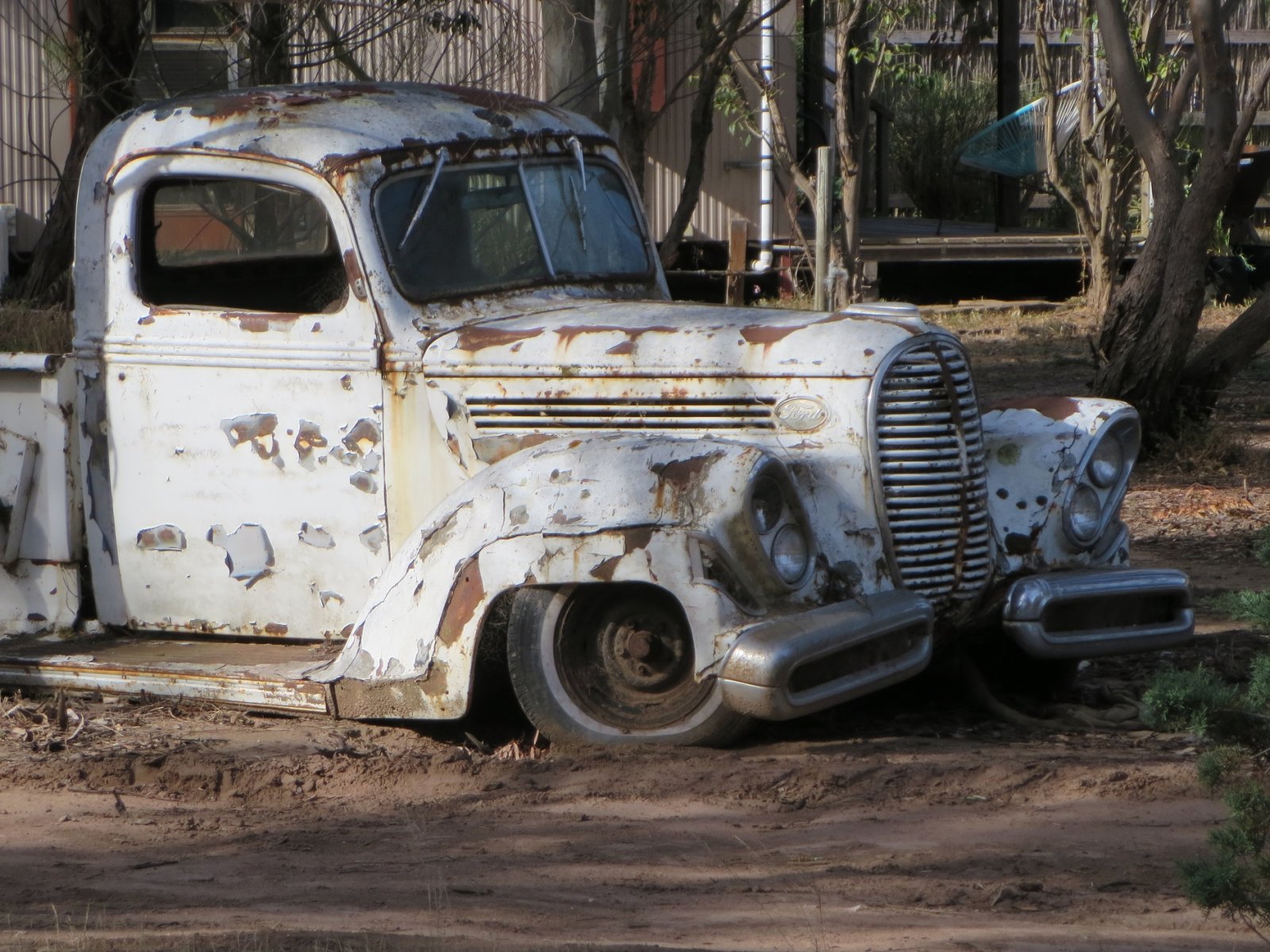

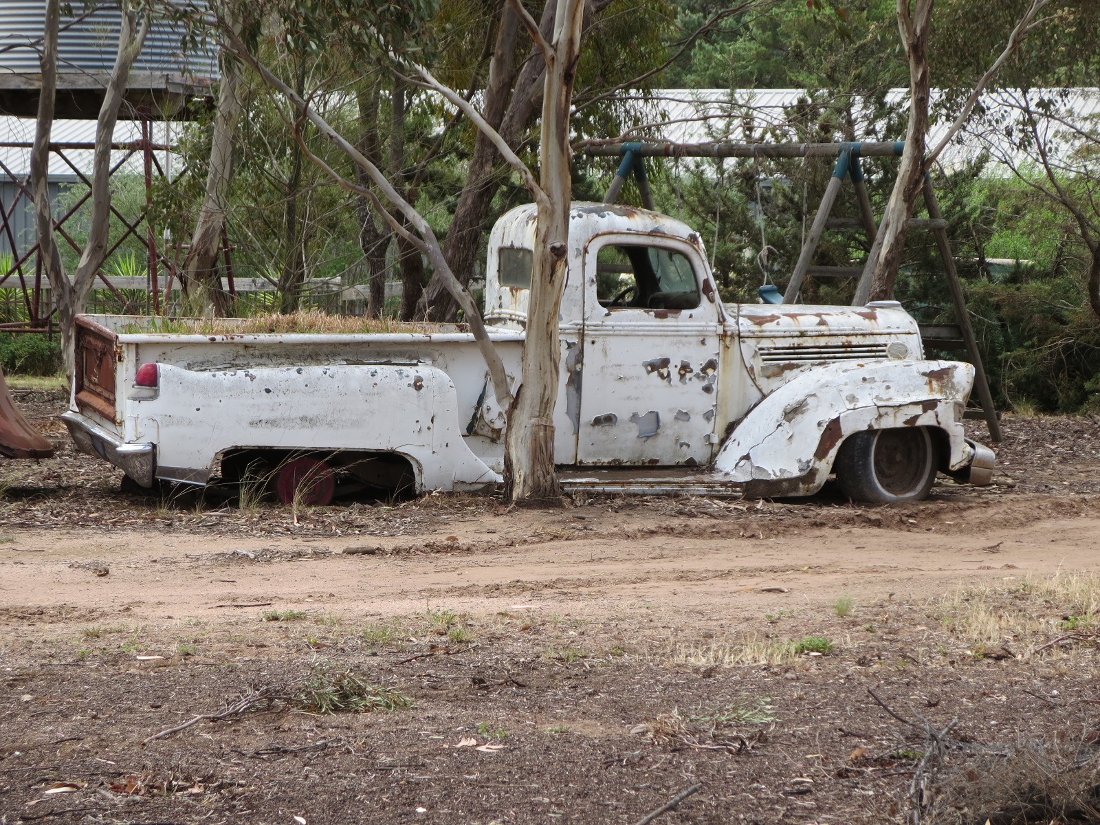

  21. Roadsterlines, is that yours? What's the history

    62pan: it's not mine and I know nothing about it; it's located not that far from Melbourne, Victoria, Oz, away from main roads. I saw it several weeks ago, took some pics showing the side profile and put them on the 'sitting and rotting' thread. Someone asked if it was possible to photograph the front and I went there again a couple of days ago and saw that I could do that. I guess it was imported from the US in this form some time ago.
    (I do realise that it's a bit cheeky putting these pics on this thread.)
