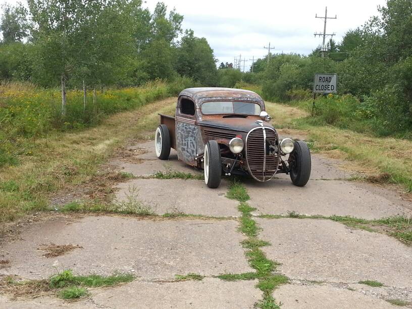

    Still new here, but I'm in! just picked up a 38-39 farm truck in rough shape but i love it! Will need parts for sure, and to pick a few brains! I just revived a 39 Oldsmobile, so time to move onto my dream car. Here it is.
      246.7 KB
      1,237
  3. Great project and welcome .
  4. It's a '39. Has a '39 grille and hood ornament. Being a '39 it should have: hydraulic brakes, no hole in middle of dash for ashtray, windshield regulator has a round knob up on top of upper dash panel, gauge faces are a chocolate milk color, and stamped steel inside door panels instead of laminated cardboard used on '38.
