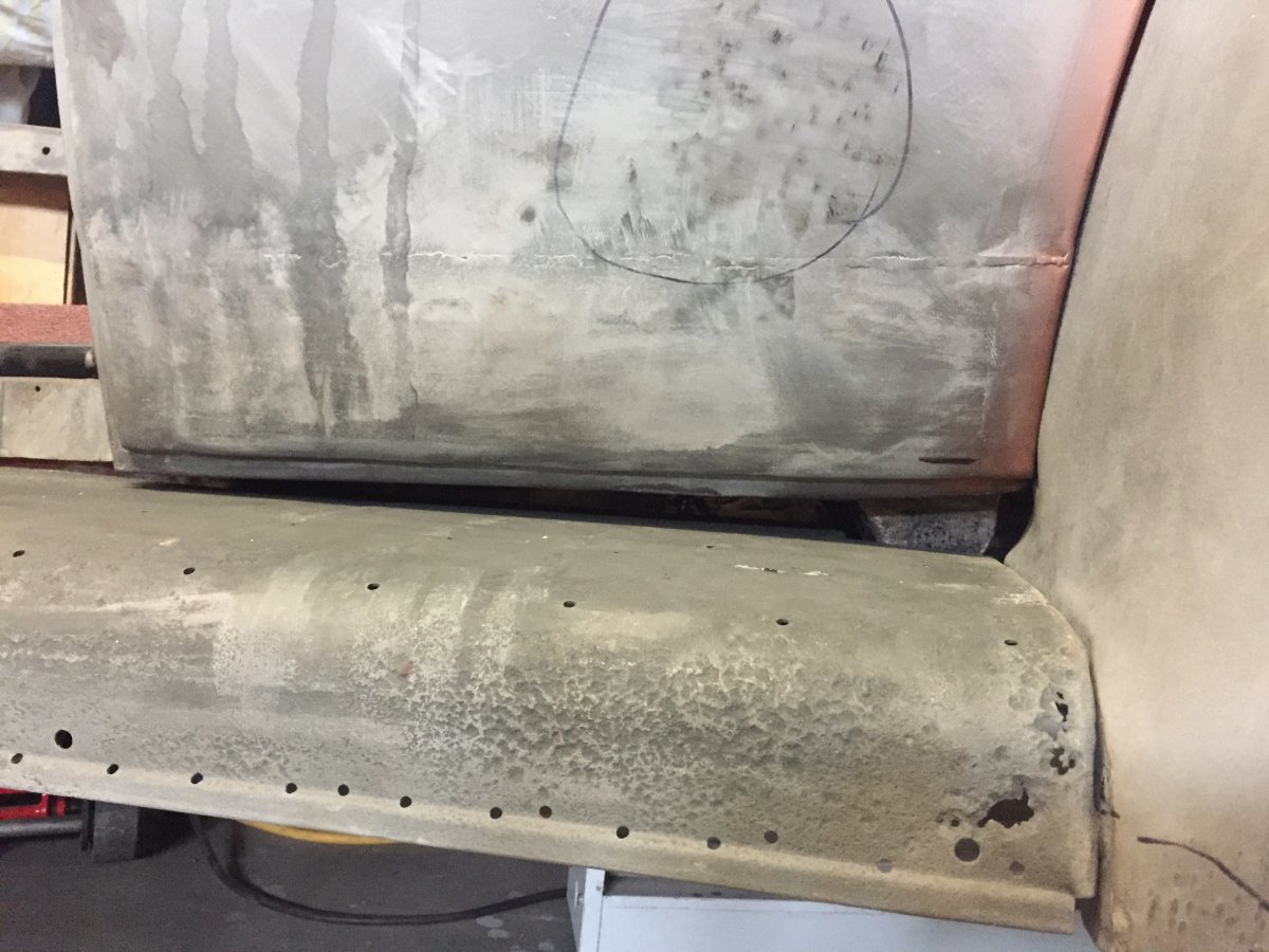

    Before I committed to molding the fenders etc. I thought it would be a good idea to fit the running boards. I had boxed the frame and welded pieces of 8mm bar inside the mounting holes, so all these had to be drilled and tapped for bolts. Which I did and that went well.
    On the other hand, the thing is, the boards are in pretty poor shape, especially the left side. Both were banana shape, but the left one had heavy rust outs as well.
    This edge is also critical for the fitment of stock running board covers.
    Although CadMad had a go at replicating it, the smallest he could go was just too big, so I elected to do my best to resuscitate the right board and use part of the board CadMad folded to repair the left one while retaining the original folded edge.
    It took a lot of tap tap tapping to get these boards in shape, not to mention welding and grinding on the left one, but eventually things started to come around.
    Test fit of covers (yes, wrinkly but not glued on)

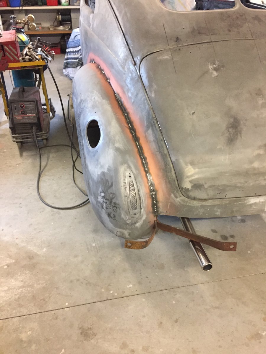

    Okay, after fixing the issue above, it was time to move on to things a little more custom, which ultimately is the whole point.
    And for this, you know it’s getting serious when…
    …the fenders get welded on!
    Progress so far. A lot of welding to go :eek:

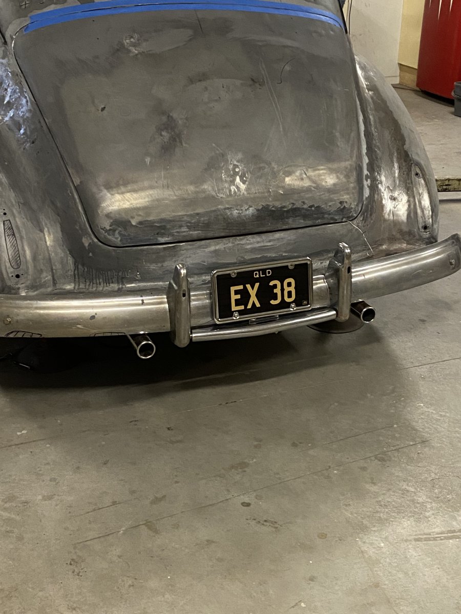

    Metal to replace paper.
    Weld and clean up...
    Try bumper...happiness. :)

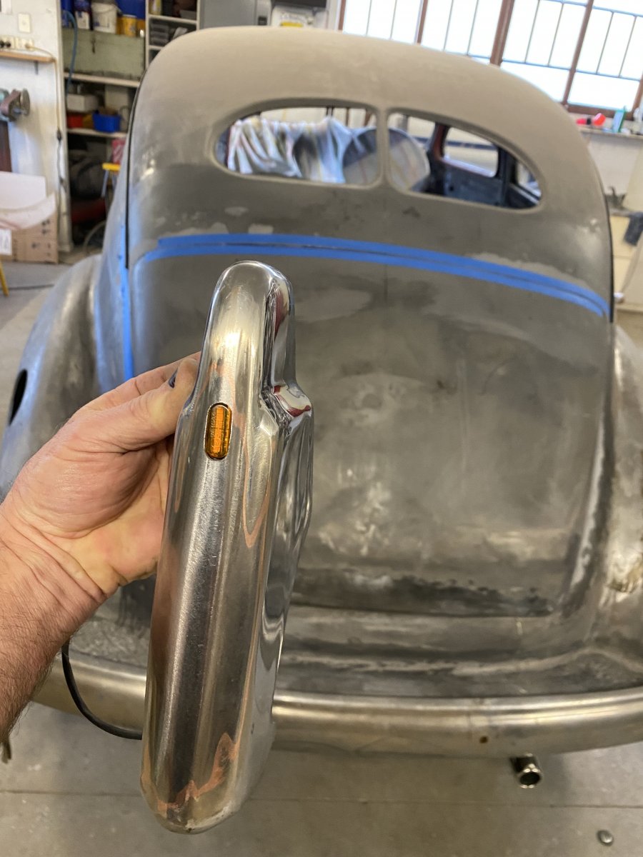

    Also as part of that I have been addressing the turn signal issue. We have to have amber turn signals. I did not want to clutter or take away from the 41 Stude lights so needed another solution. What about in the overriders? I consulted my build guidelines booklet and in the lighting section it told me that rear blinkers are to be a minimum of 300mm above the ground and minimum of 500mm apart. Measuring the C to C of the overriders was 5mm shy so I moved them out 3mm each side. For lights I found some small motorcycle pieces that are very bright, including side-on. You can see in the pic the holes for them. They will be flush. I have also made a new plate bracket. I am about to mount the license light inside the cross bar so that it shines up through a slot.
