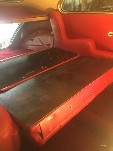

    Well actually, the rear seat back folds forward, making a flat surface from the trunk to the back of the front seat. There were no braces in the way and the spare was not stored vertically in the way either.
