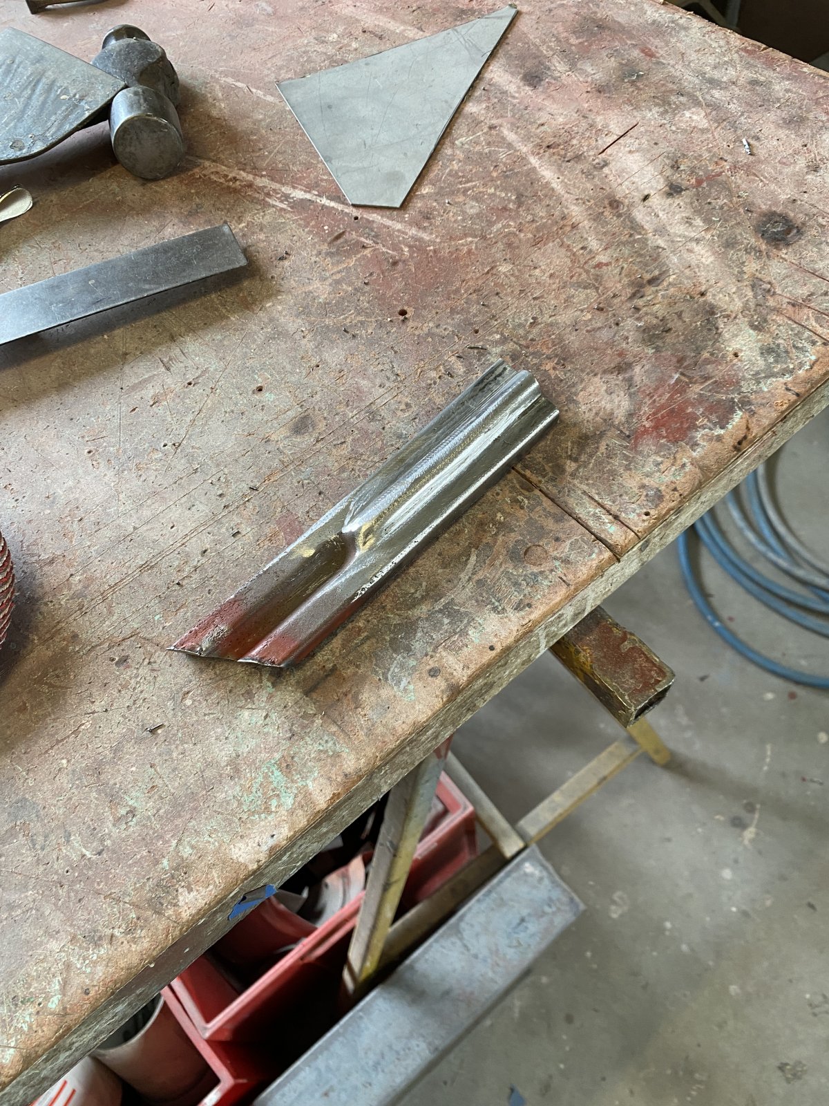

    Before I put the trunk lid back on for safe keeping a few more mundane things had to be taken care of. Such as the brace for the trunk prop. This had the bottom cut off at some point so was just swinging in the breeze...and this brace is important because, well, the trunk lid is heavy and can distort the trunk surround. So I took off what was there and lengthened it.
    Cleaned up:
    In place:
    Spoggie, brEad, hotrodjack33 and 8 others like this.

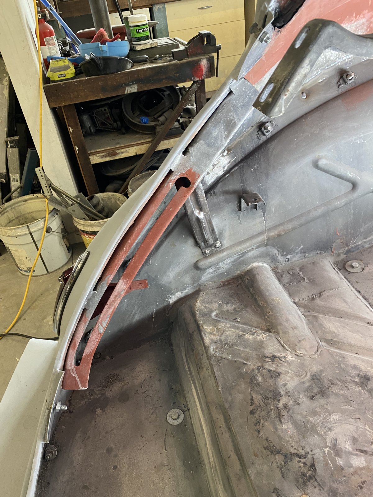

    Next bit was the bracing under the parcel shelf. Originally these cars didn't have any because the seat back could fold forward etc. to give a 6ft floor from the trunk to the front seats. I won't have that feature, but do want bracing.
    I folded up these hat sections.
    Fitted them like this and gave everything a coat of red oxide epoxy.
  26. The 39 guy
    Joined: Nov 5, 2010
    Posts: 3,777
    The 39 guy
    Nice job! Looks Factory!
    Outback, Stogy and chryslerfan55 like this.
