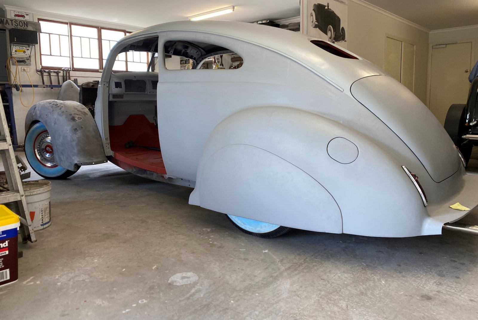

    Sorry for the delay guys, I've been side tracked, but I have done some work on the car. Picking up where I left off, I had to address the running board to fender meeting point, which had issues. I fixed that and bolted it all together and things were starting to look okay. Fender still needs wheel arch and straightening work, but it's within reach now.

  27. X38
    Joined: Feb 27, 2005
    Posts: 17,498
    X38

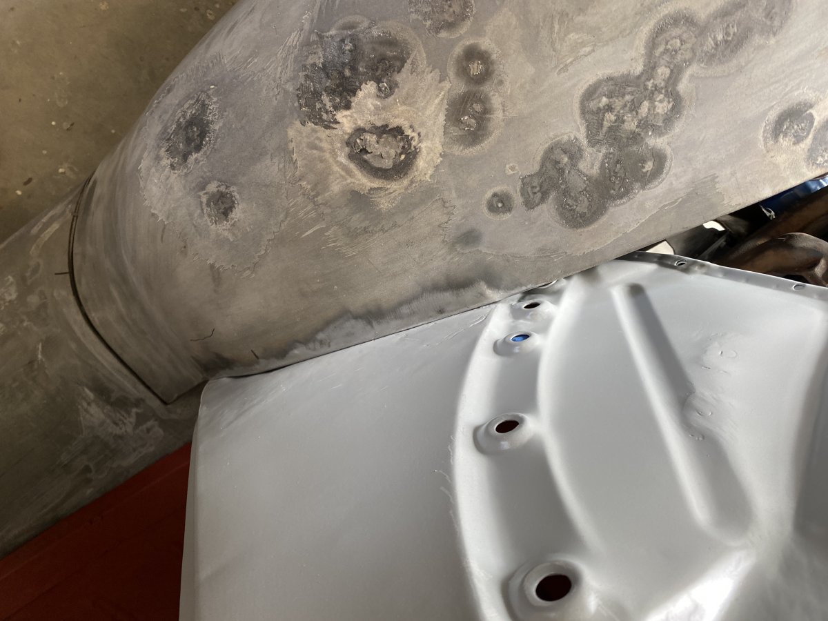

    The fender I've been working on was shaped pretty well, but the crown had pinholes like a stary night sky. This side, the metal is okay, but man, is it beat out of shape! After blasting (which also removed old filler) it's very obvious that it's had accident damage and repairs as well as splits welded up. Some examples:
    Yep, she's pretty rough.

    Follow along as I attempt to do something about the trail of misery using cardboard, some hammers and a welder.
    First up, the shape at the rear was way out of whack. In fact, the line of the fender at the cowl side was way below the bolt hole. I'll tackle that first.
