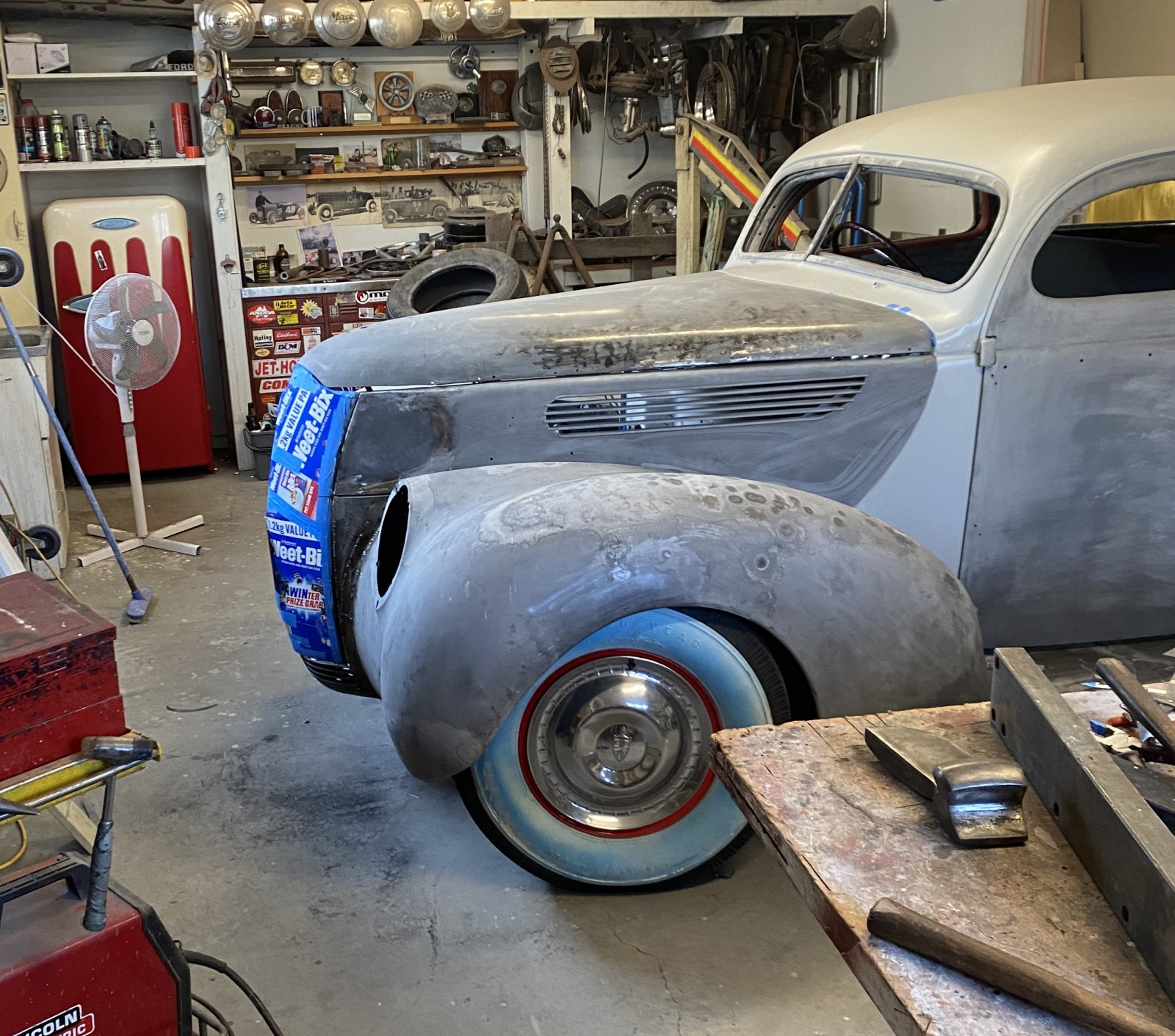

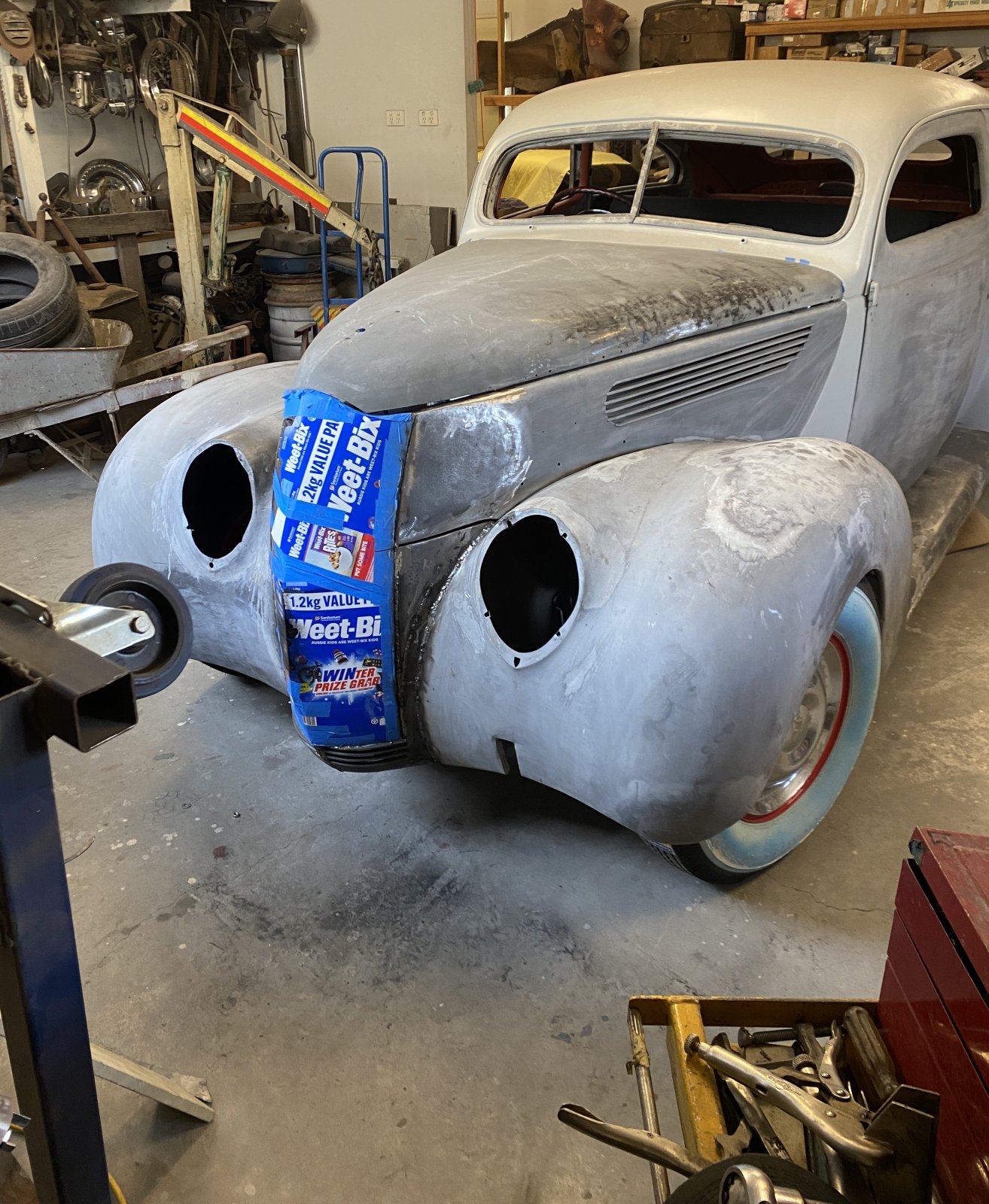

    Just to rewind a little.
    The hood had been roughly trimmed for the newgrille and here the lower stock grille is also cut away.
    Then attack the grille on the hood sides to make way. A nervous moment.
    I made a support pad and brackets to take the weight of the grille and locate the bottom.
    I also welded tabs to the back of the grille and fabbed brackets to locate it.
    This is the general idea.
    I covered the grille in cereal boxes for looks. A curved angle piece forms the front edge of the hood side and filled in lower grille. The whole lot is unified with the fender.
    Hood side in place and grille cut away. I plit and straightened the top edge to line up with the grille.
    And so we end up here. Now to do the other side, then make the section that blends the cut away hood to the grille and reshaped hood sides.
