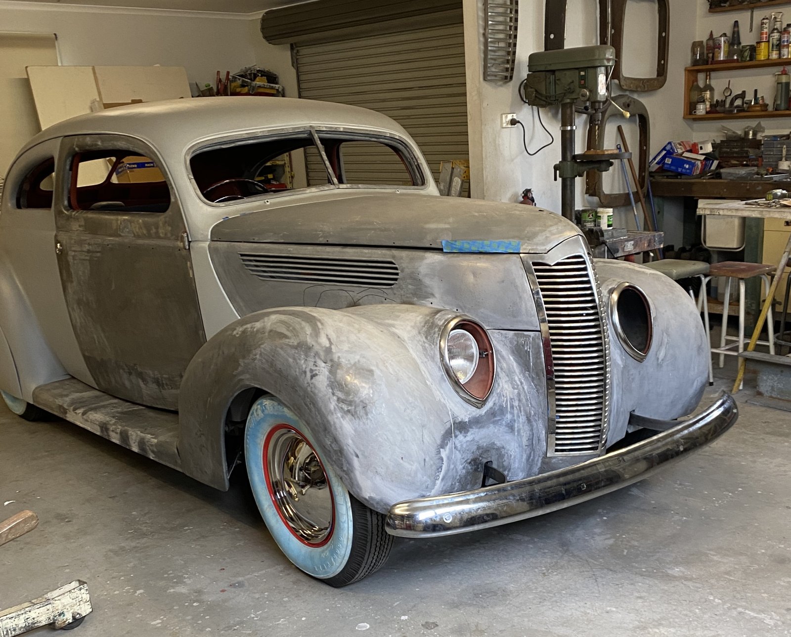

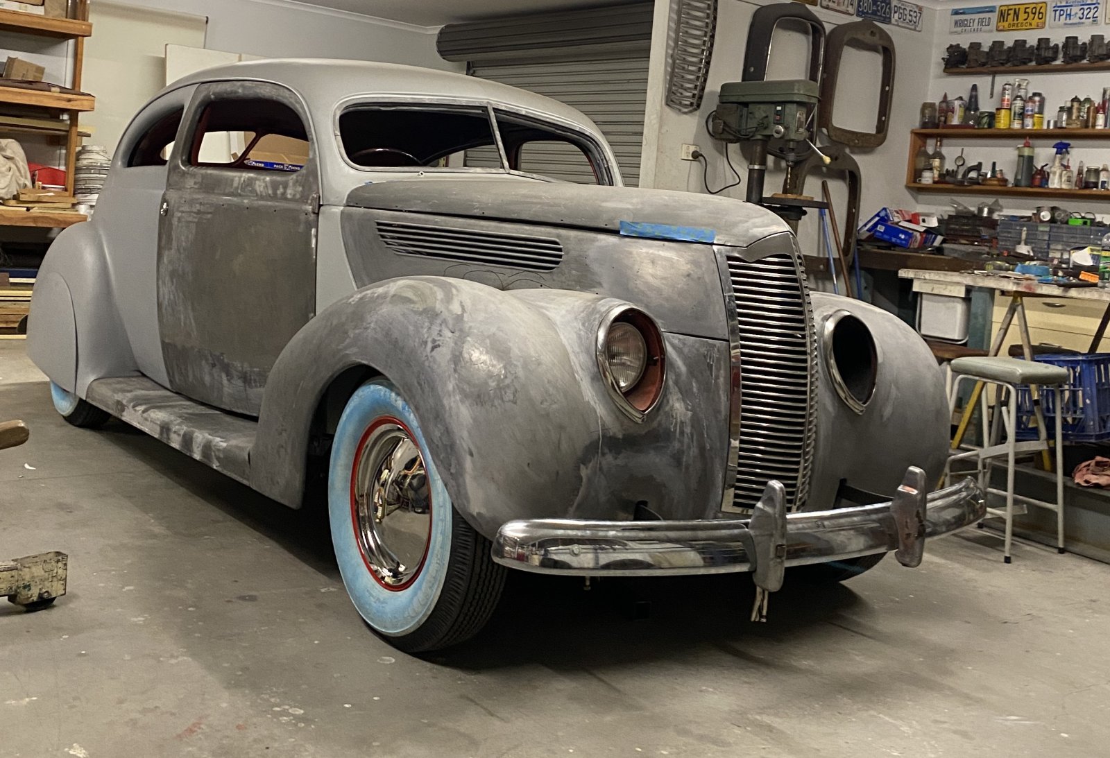

    One task was making and fitting the mountings for the seats. Form the cut-out for the bumper bracket in the repaired right fender. Then I thought I should make inner fenders. I’ve made all the brackets but the panels themselves are still cardboard.
    I have been playing with the front bumper also. I’ve pretty much decided that I’ll go with over riders. I tried without for a cleaner look but it was just too flat and horizontal. Now I need to make brackets to suit.

    Just for comparison. Without over riders:
    With:
    I know, I should have taken the pics from the same POV. :rolleyes:

    Just my opinion, but please ditch the overiders. Much cleaner look without them. As I said, just my opinion.

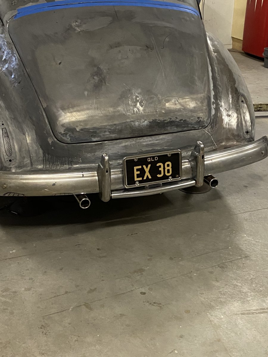

  15. lowrd
    Joined: Oct 9, 2007
    Posts: 418
    lowrd
    Are you going to balance this with a pair on the rear bumper? Does leave a place for turn signals on both ends

    I like the overriders although from a 3/4 view they look to protrude too much. I'd want to "relieve" them such that they'd nest back into the bumper by an inch or more.

    Yes, if you use them they need "relieved". I could go either way, but if they are on the front they also need to be on the rear. How would they look back there?

    Plenty of rear shots back in the thread.;) They look alright.

    The rear of the car is low and the overriders make sense, plus the license plate…the front, are you going to run a front license plate?

    Just my opinion.....I would not use the overrides on the front.

  24. I agree, they do help 'break up' that long bumper. But I also like @wstory idea of moving them in some. I'd also section them vertically; this would make them less prominent.

    I thought about things, sat and pondered a while looking at the patient and took on board a suggestion from @wstory. I trimmed 15 mm, about 1/2" from the back of my ****tiest overrider to snug it to the bumper more. Tried on it looks like this:
    I also thought about t******* the back edge above the bumper. You can see the line, but I decided against that.
    Here you can see the comparison with a stock one:
    After some more pondering over a few days to let the look soak in I felt good about it and trimmed another one and this is the result. I'm happy.
    In the mean time I also finished the bumper brackets and mocked up the license plate in a couple of places and am happy with that too. Next will be to deal with the hood to hood sides gap.
