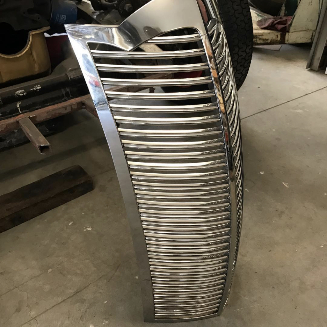

    Come on mate. Show us ya grille.

    440CBD6C-E4F4-46AD-98A6-CE7309058458.jpeg 5A6A77A3-2C5F-400B-AB74-0249DB422B59.jpeg Spoiler alert....
    I found these pics from back in the late 40s.
  8. @X38 didn't you fabricate the grille out of Stainless?
    Sandgroper and kidcampbell71 like this.
  9. CadMad
    Joined: Oct 20, 2012
    Posts: 886
    CadMad
    He must be at his kid’s sport carnival. Yes he did fabricate that grille.

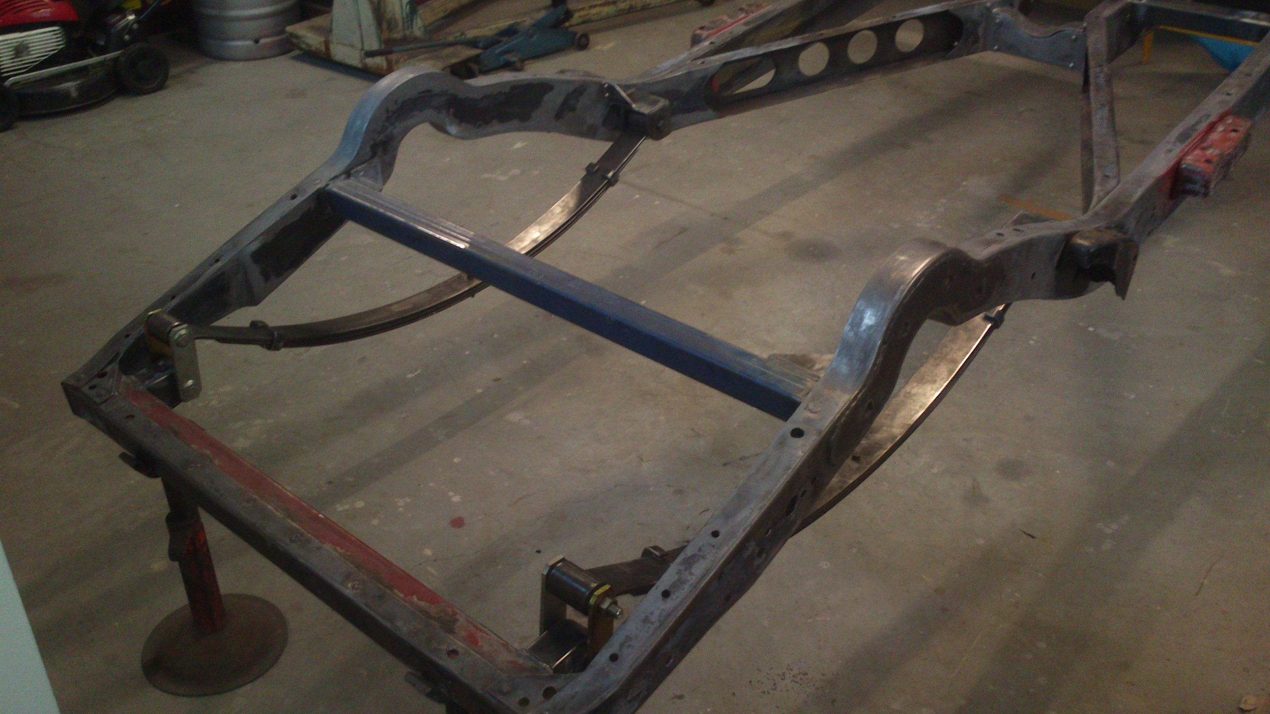

    First up was to lift the body off and attack the frame. It was pretty grungy after the years had p***ed, but cleaned up okay for now. I rigged up a basic jig to make sure everything is as it should be, plus the frame will be boxed front to rear so the jig should help with that too.
    The plan is for a tail dragger stance, so low in the back, but I still want travel. That meant a C notch was in order.
    I didn't want to loose any more floor area than necessary so worked out a notch that would allow decent travel with minimum floor intrusion. Also, by tail dragger I'm talking 40's/early 50's, not belly on the ground low.;)
    I made good use of cardboard then started with the cutting.
    Next to come will be fishplates of the outside of the notch, as is required here by the powers that be. (This whole rolling ch***is will be inspected in the raw with no welds dressed.)

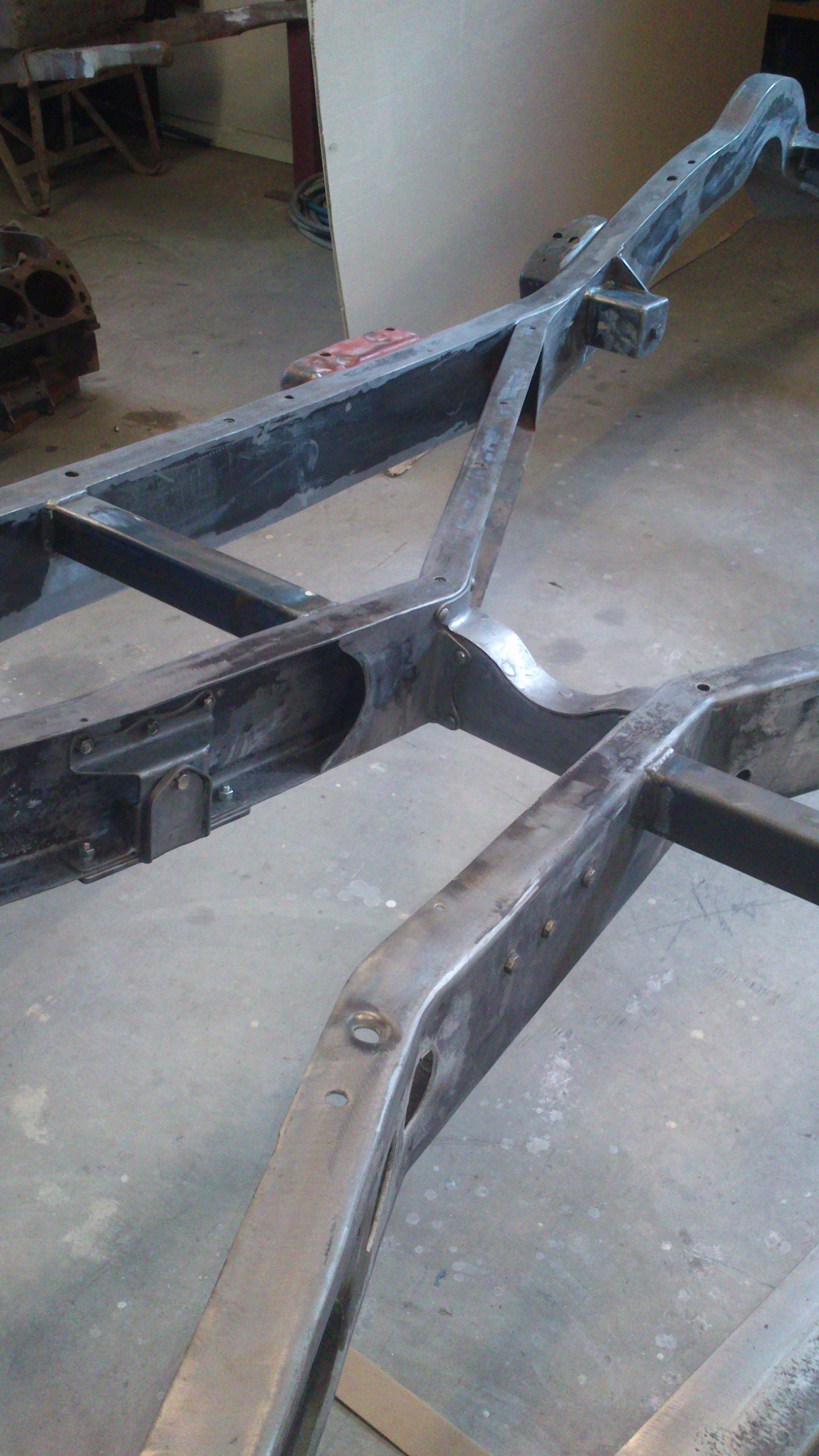

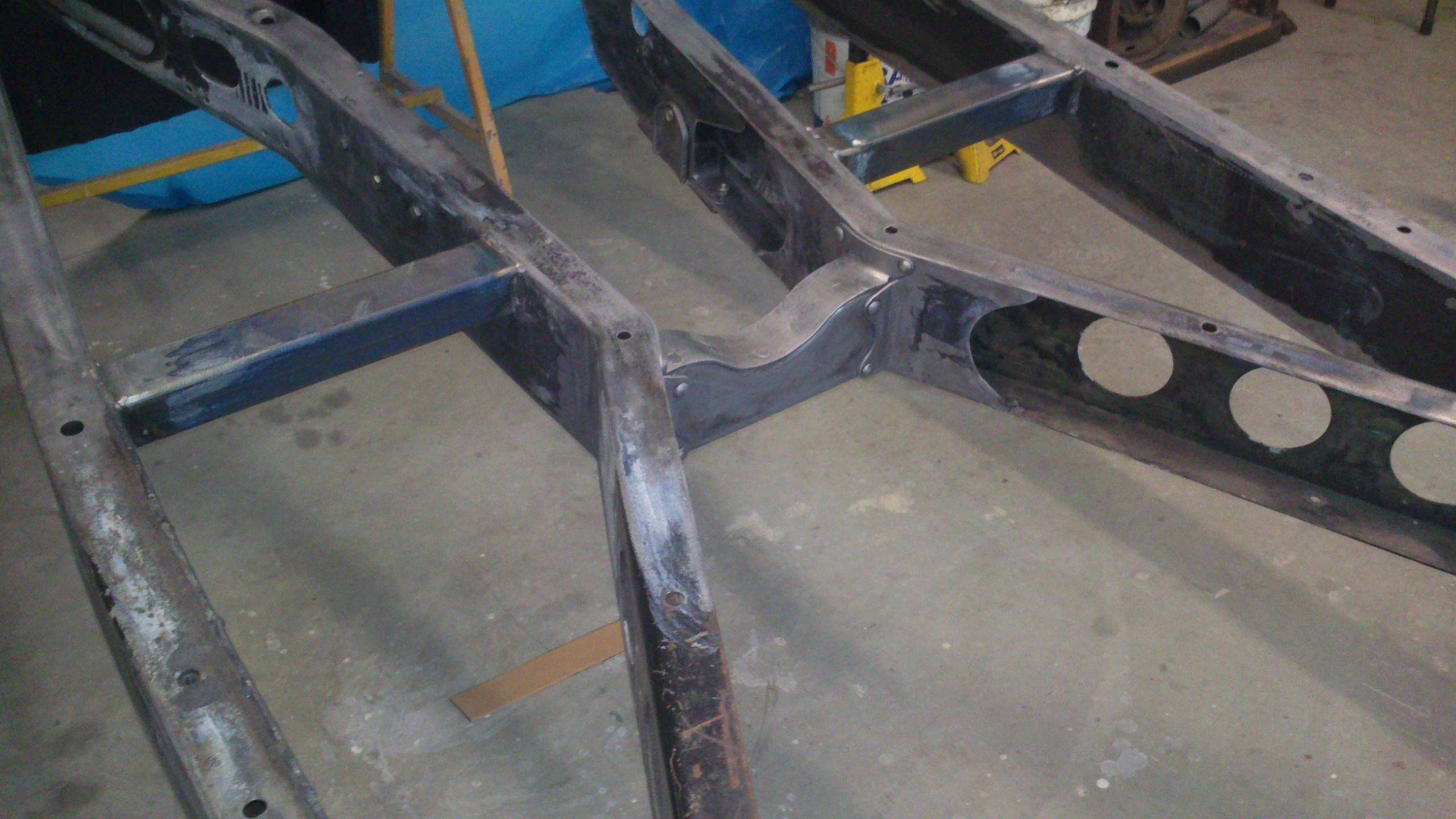

    Here is the c-notch with the fish plate welded on.
    The springs are Holden Rodeo (Isuzu) pickup and I fabbed the mounts to be inboard of the frame for low factor without excessive lowering blocks.
    Rear x-member the hangers attach to is 100x50mm box, which fits perfectly inside the original member. Then full welded at the ends plus a few rosettes as well for good measure. ;)
    You can see how I modified the centre of the X member for the transmission. Transmission crossmember is still in the process of being made in this pic.
    Trans x-member in
