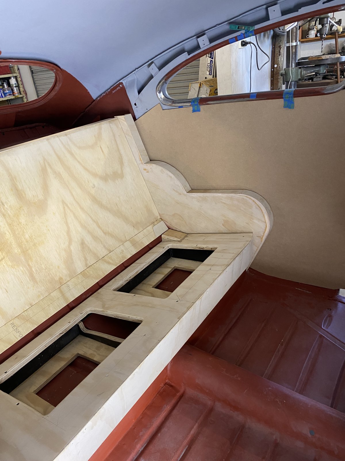

    This is the current state of affairs until I figure out the seatbelts. Which I have to do. Webbing will go over the holes in the base.

    Rear seat in an outhouse?

    Hopefully that wouldn't require a seatbelt :eek:

    Gives a new meaning to "side by side".
  6. Jaguar used a rubber diaphragm for the lower seat cushion on a lot of their cars, I'd think those would work great there....
  7. Luxury " thunderbox " :oops:

    At least you know where you are going ….. :eek:
