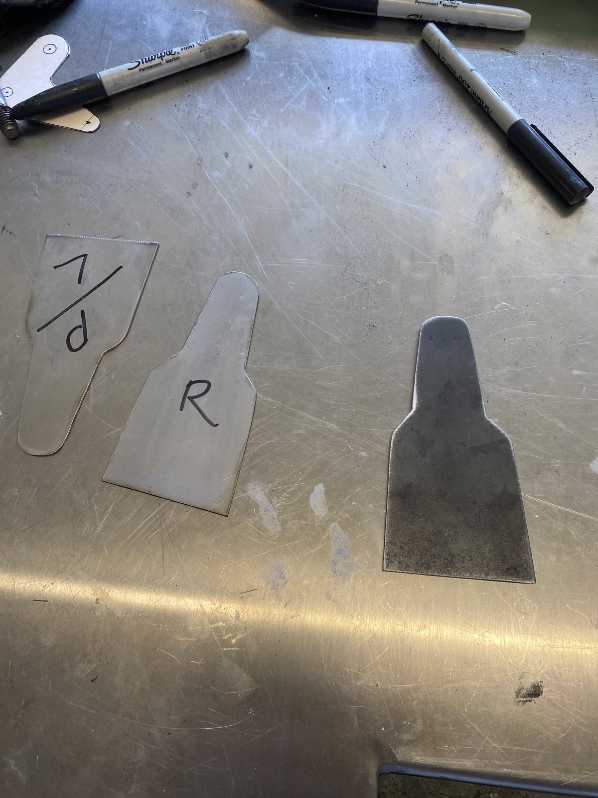

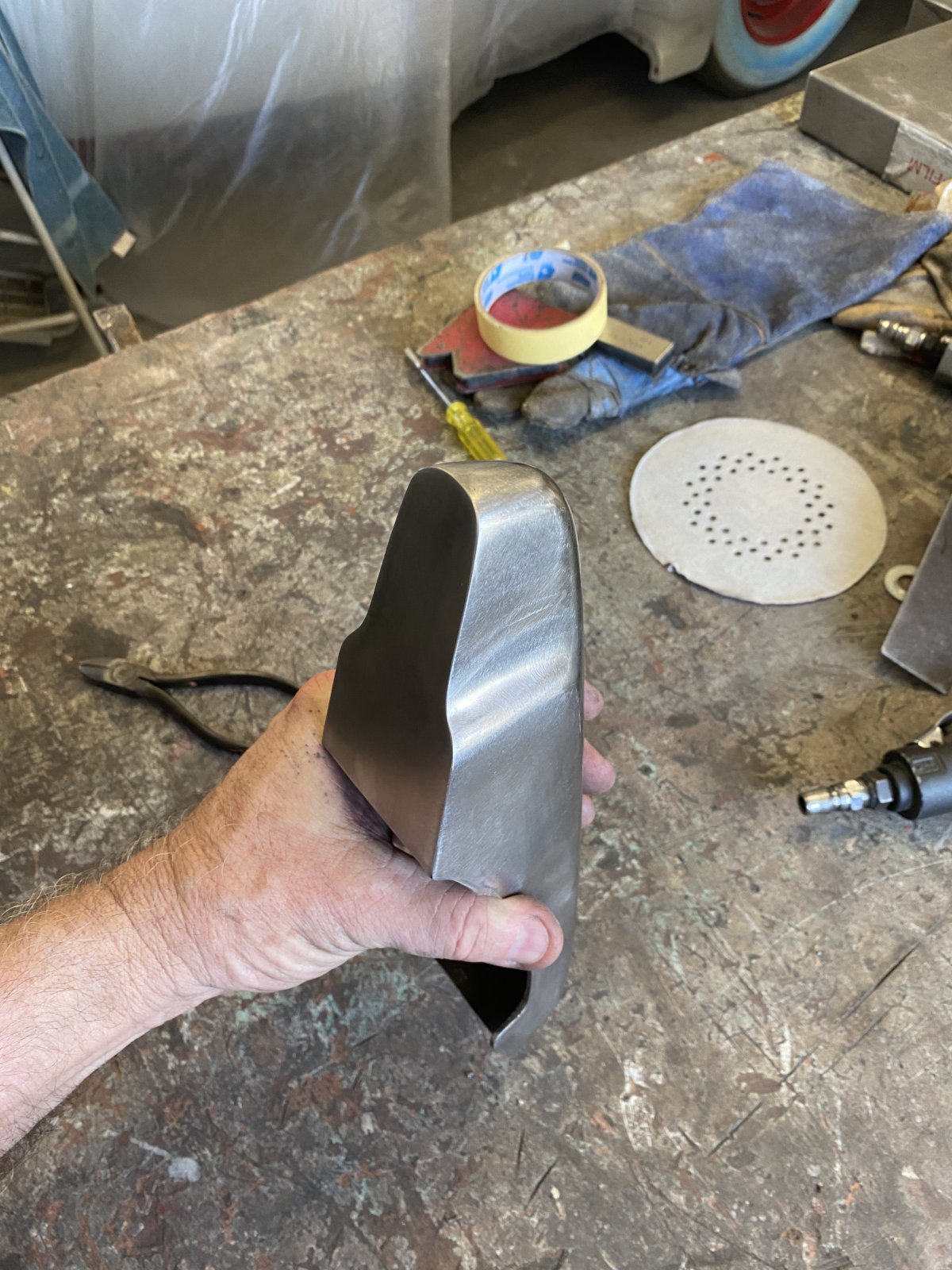

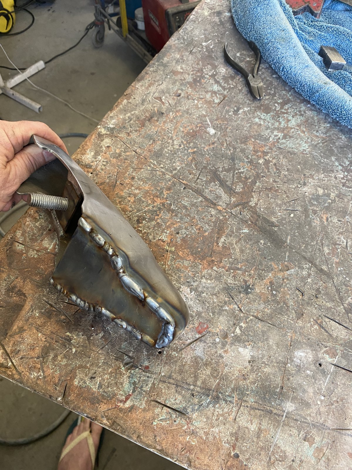

    Okay, the engine goes, now onto something different. Filling bumpers. It's an old thing and people have said I should do it...and I agree.
    Cut out some shapes. The rear will get removable polished stainless ones because I have blinkers in there that will need to be accessible. Front are thicker material to be welded.
    It does look better. Now to the other one...
  4. Bandit Billy
    Joined: Sep 16, 2014
    Posts: 16,147
    Bandit Billy
    Oh man! I already had mine plated! Great idea and execution.
    Outback, X38 and lowrd like this.

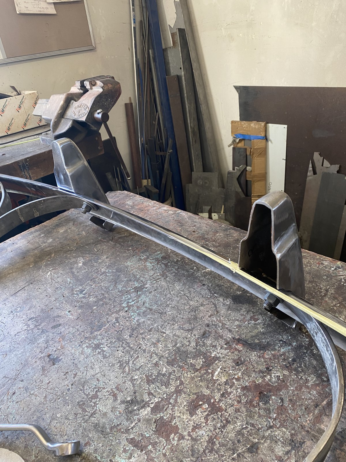

  5. X38
    Joined: Feb 27, 2005
    Posts: 17,498
    X38
    The rears will be like this, removeable for access to blinkers. They are stainless and will be polished. I'll tweak the gappage when I do the prep prior to plating.
    SS327, 1pickup, ronzmtrwrx and 15 others like this.

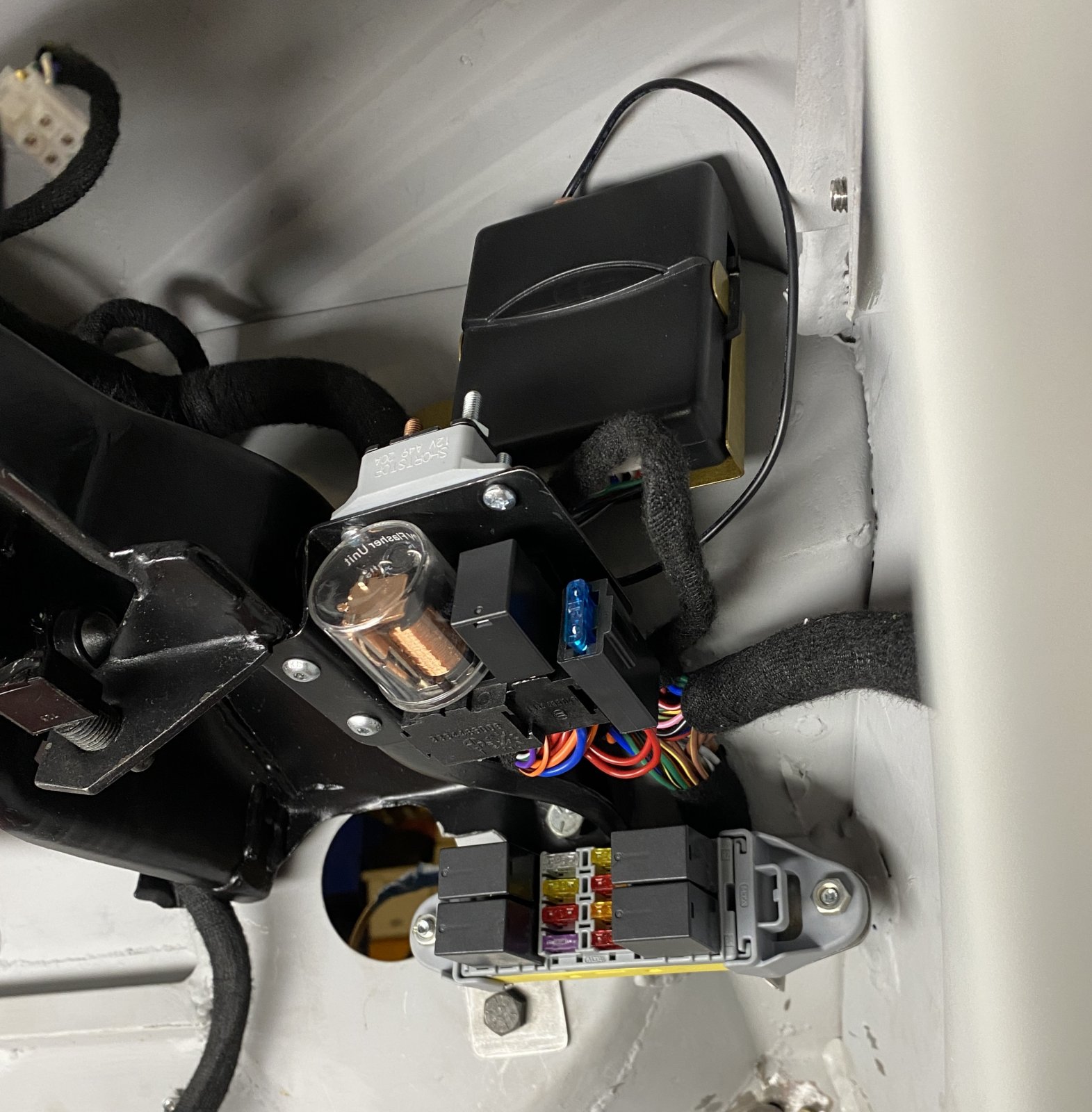

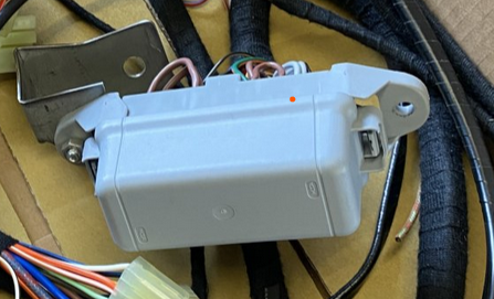

    Collected this work from my electrician mate up the road this morning. To be continued...
  8. The 39 guy
    Joined: Nov 5, 2010
    Posts: 3,778
    The 39 guy
    What does that gray thing do?
  9. X38
    Posts: 17,498
    X38
    They grey thing is the fusebox/relays. It's nice, compact and uses mini fuses. There's a flasher can and relay + circuit breaker on the black thing above it.

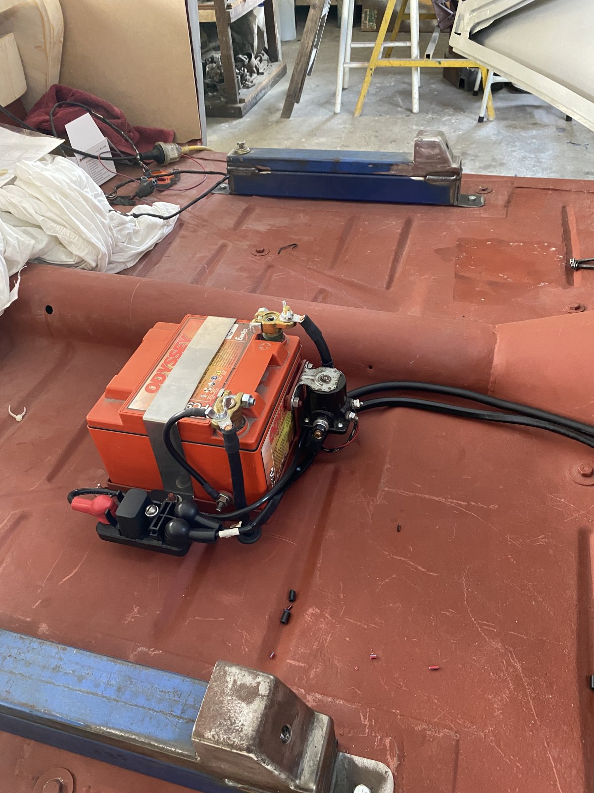

    Here's some excitement.
  11. The 39 guy
    Joined: Nov 5, 2010
    Posts: 3,778
    The 39 guy
    That is a pretty cool idea! Does that battery extend below the floor a little?
    Fuse Box eh, so how many fuses does it hold?
    I really like your nice and tidy wiring job behind that dashboard!
    Outback and hotrodjack33 like this.
  12. X38
    Posts: 17,498
    X38
    No, I made a frame from light angle iron and welded that to the floor. The battery clears under the seat easily. I investigated recessing the box, but there is a leg of the X member below.
    It has eight fuses and four relays. The auxiliary panel has the flasher/relay, a circuit breaker and another fuse.
    I don't have much in the way of accessories, so there are plenty.

  14. neilswheels
    Joined: Aug 26, 2006
    Posts: 1,343
    neilswheels
    from England
  15. X38
    Posts: 17,498
    X38
    @neilswheels
    Battery spec from on line. The equivalent Full River battery is the same.
    • Model 925 PHCA
    • 380 CCA
    • 500 MCA
    • RC Min. 52
    • L-6.64 in.
    • W-7.05 in.
    • H-5.04 in.
    • Cold Crank Amps: 330 Amperes
    • Internal Threaded Br*** Receptacles w/M6 Stainless Steel Bolts
    The curly thing is the temp probe for the a/c. You straighten it and poke it into the a/c unit once everything is in position.
    Outback likes this.
