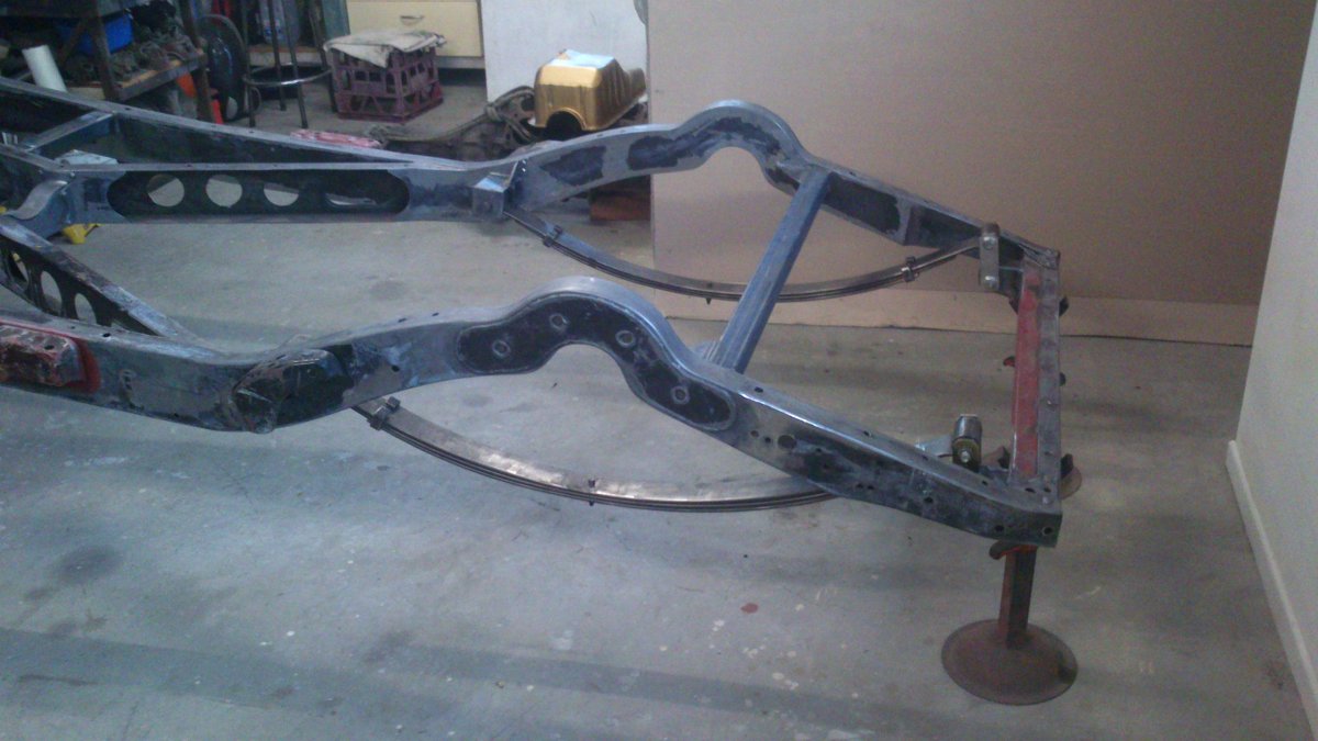

    I mounted the shackles pointing up. Don't fear, with weight on them they lean the right way!
    Diff mocked in place to figure out the saddles I'll make. Wheels are another story.;)

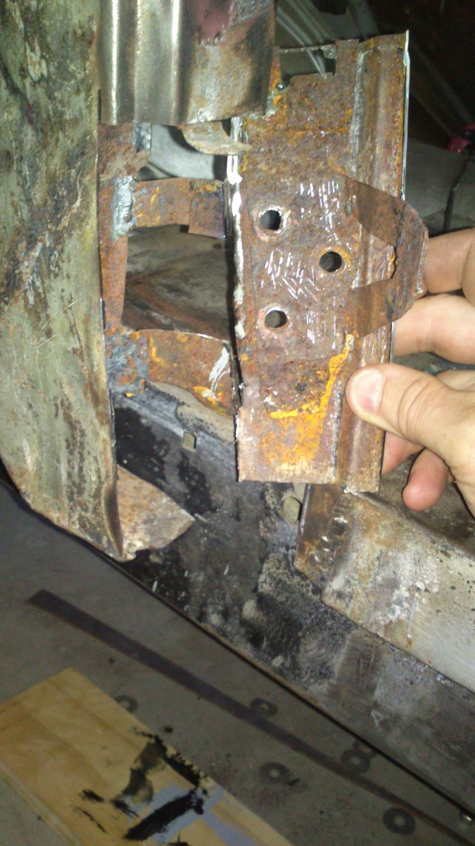

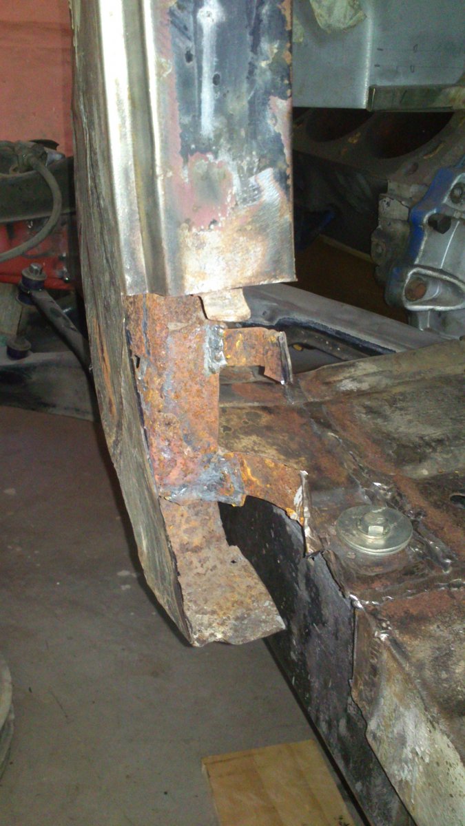

    Time to attack this body again. Mostly fixing **** unfortunately. First off was making a new rear floor to go over the C-notch. (I’ll have to take a pic of that) Then I thought I’d hang the p***enger door (driver to most of you.) The 'good' door. That’s when the problems began…again.
    As mentioned, this body is a Frankenstein that someone had done ‘work’ on before. The body is 39, and has had a cut and shut of the cowl (through the A pillars and floor) with a 38 deluxe cowl etc. added on. The doors I got with it are 40. Would it all fit together? Mmm, with top taken off the door, kinda but not really, so more surgery. Now I’m no genius metal man, so I make it up as I go along.
    From the get go, probably via the cowl cut and shut, things were off at the A pillar so I had to do some remedial work there:
    You can see where the floor had been cut and some gas welding in the pillar.

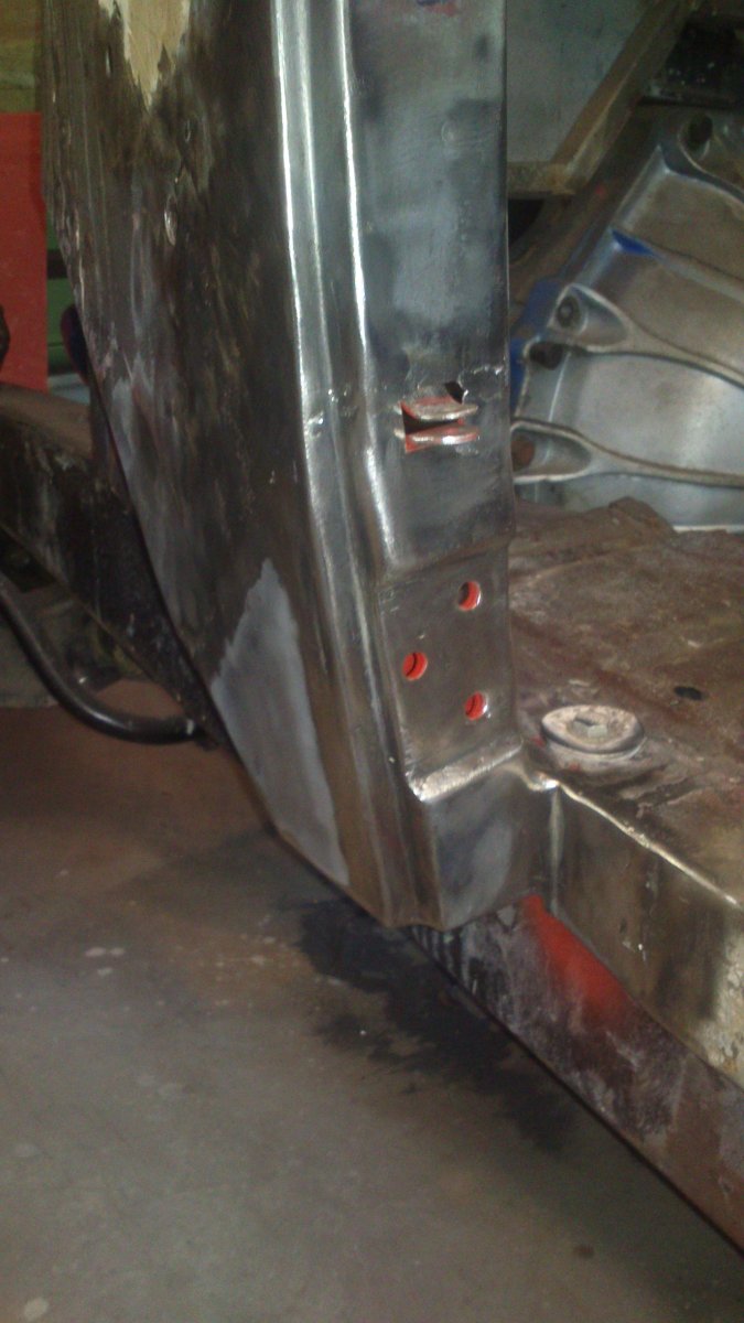

    I got rid of all the rust, fabbed some new bracing etc. and put it back together.

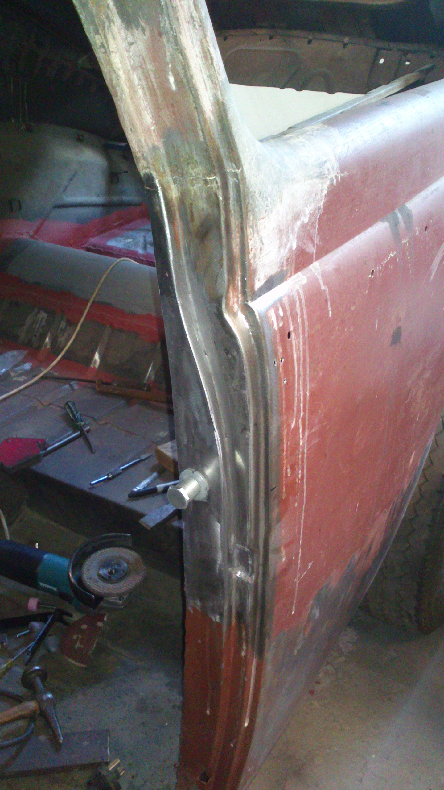

    Okay, so the good door is hung, chopped and it latches. But it's not that good...
    So I made a repair for the B pillar end, to keep things in shape. I'll make a new bottom and end for the brace later.
