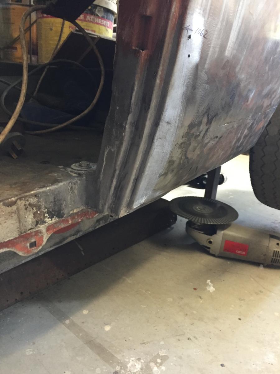

    With the doors sorted out for the time being, I got back onto the jambs. Both were bad at the bottom so I made some new pieces.
    On this side you can see an old bag of walnuts repair from the past. It was gas welded and rather than cut the whole lot out I decided to work with it. In fact it had not even been fully welded. It's not rusty inside.
    It will be okay I think.

  28. 1-SHOT
    Joined: Sep 23, 2014
    Posts: 2,946
    1-SHOT
    from Denton
    Is that a shrinking disc on your grinder 924FEF96-673B-4433-9E99-8DDA483758A9.jpeg

  30. X38
    Joined: Feb 27, 2005
    Posts: 17,498
    X38
    Why yes it is.
