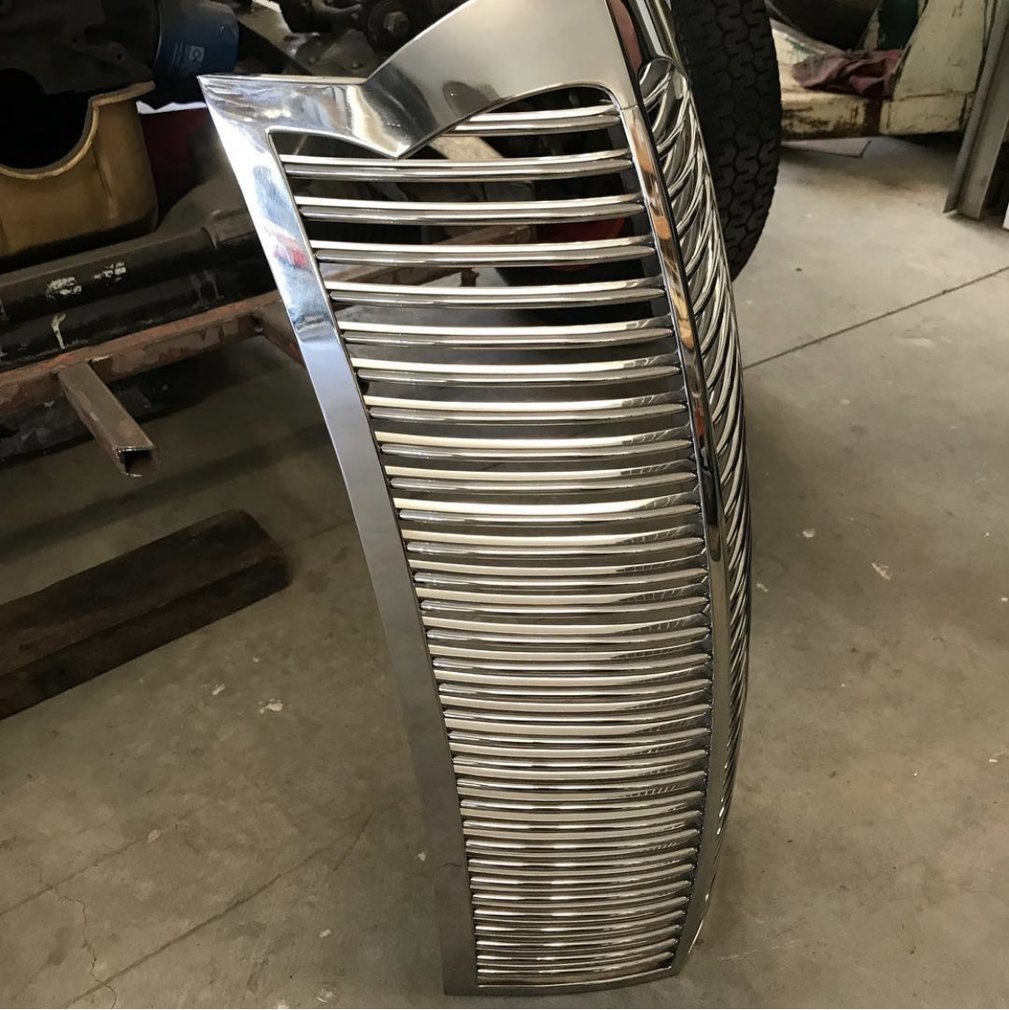

    You need a dedicated page to the fabrication of that incredible grille.... just sayin’.

    It's an idea, but I can't even recall taking pictures of that. I'll do an archeological dig and see what I can find.

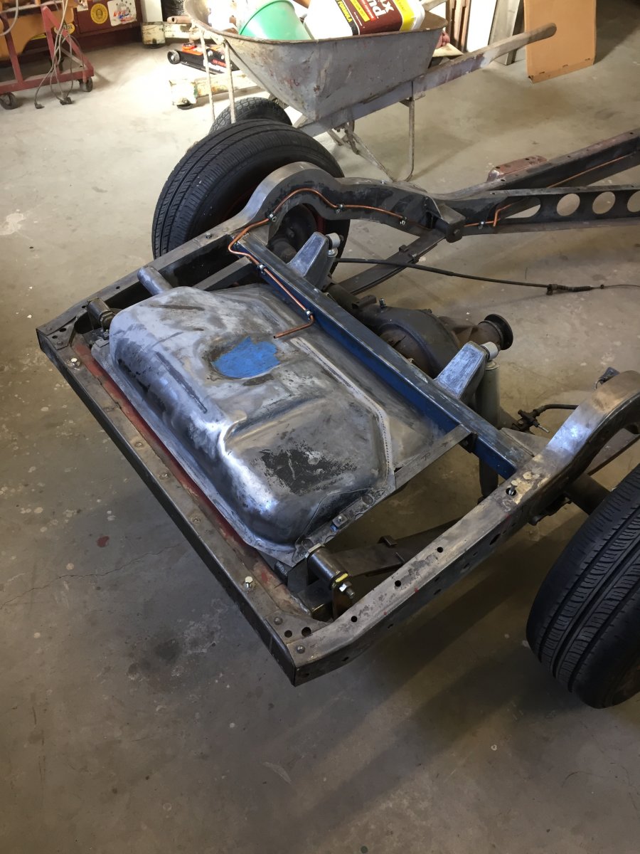

    Once I got to this point I figured it was time to pull the body off again and finish up ch***is things.
    First up, the tank. This had to be done before I could run the exhaust.
    Two things:
    1. I wanted to use a stock tank.
    2. With inboard leaves, it was too wide!
    As a result, I had to narrow it 300mm (basically a foot) and of course lost a lot of capacity. My solution was to make a new tank bottom and extend it forward and regain what I lost. This was fun with all the angles an curves, not to mention internal baffling.
    Anyway, cut and tacked for fit…
    You can see I made some inboard supports for the mounting flanges. Bolt in.
    Making a new, larger (front to back) tank bottom:
    So far so good, At this stage I was beginning to **** bricks about how it was going to come together.
    Done, internal baffles included.
    Sitting in position. I made a couple of forward mounts to help support the tank.
    In this pic the fuel line was also underway.

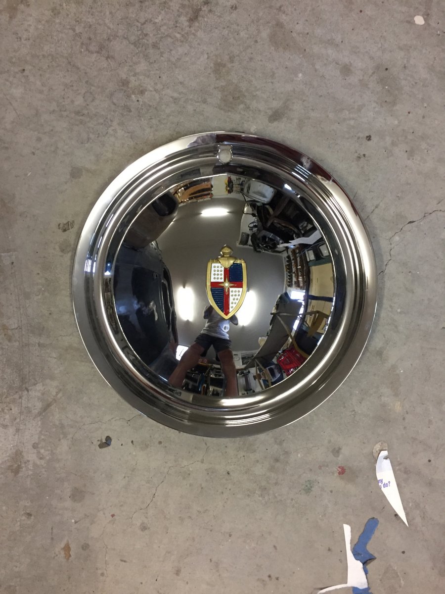

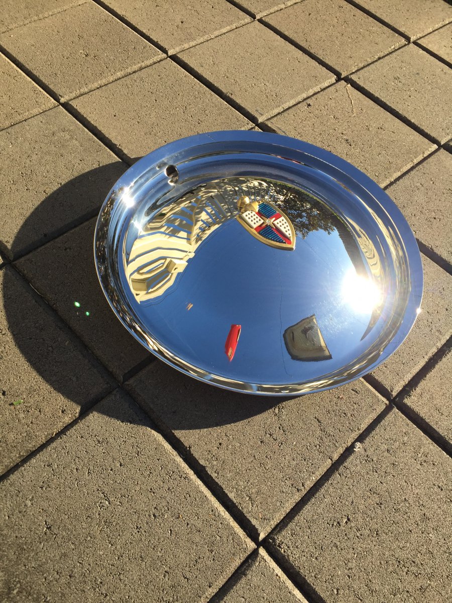

    Thinking of using these wheel covers I restored.
    Better pic:

    ronzmtrwrx
    Those caps are beautiful. Just curious about your rear spring hanger. Will it unbolt from the frame and drop down below the gas tank in case you needed to remove the shackle?
    Big mike 1968 and chryslerfan55 like this.
  21. X38
    Joined: Feb 27, 2005
    Posts: 17,498
    X38
    Good question.
    The hanger is welded to the rear crossmember, but I can remove the shackle without disturbing the tank.

    from England
    More great work, that gas tank, very nice! So it looks like you are running your fuel line to the sender hole, are you using an in tank pump?

    I see. That’s good. It just looked like from the angle of the pic that you didn’t have enough room to slide the shackle all the way out. I have painted myself in the corner a few times, lol. Nice solution to the tank with the parallel springs. Nicely packaged.

    The tank is getting a threaded bung welded in near the sender hole and I'm putting a 90* fitting with a pickup tube into that. I'll see if I have a pic. Fuel pump is mechanical.
    Ha ha, I know what you mean. Generally when I do things, part of the 'design process' if I could call it that, is to ask myself "what if I need to service this? Can I remove it once everything else is in place?" That's also why the fuel line is getting a joiner, so the fuel line can be split allowing it to be wrangled out once the body goes back on.

    50Fraud
    The wheel covers are amazing! That surface is uninterrupted and would show any flaw; they look like they are absolutely mint and have never had a blemish!

    X38
    Thanks Tony! I can ***ure you they did not look like that when I got them. In some ways such a simple shape is relatively easy to work with, but the other side of the sword is yes, any blemish shows. I spent a lot of time getting teeny weeny things out that only showed after polishing.
    Just saw your grille pic, this is a friends 40 sedan, finished last year .
  29. X38
    Posts: 17,498
    X38
    Thanks for posting that, I'm always interested in seeing people's approaches to incorporating different grille treatments.
