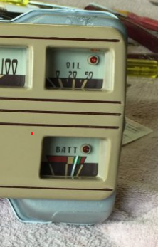

    So for a change of pace, I thought I'd have a go at resurrecting the instrument cluster. The original with my 1940 dash had suffered the ravages of time and weather so the old warped plastic facia looked more like dried out bone than plastic.
    And the back looked like the pic in my previous post, rusty and crusty.
    Time to get inside...
    Lots of little pieces, but interesting to see how it works
    De-rusted and cleaned up all the housing parts and painted them.

    Inner workings cleaned up and re***embled.
    Back side looking a lot better.

  19. Wow...that looks fantastic. How did you renew and clean the odometer number drums?
    chryslerfan55 and kidcampbell71 like this.
  20. X38
    Joined: Feb 27, 2005
    Posts: 17,498
    X38
    The numbers are new strip decals. I applied them after cleaning with acetone and fine Scotchbrite.
    The gauge faces were also renewed with decals.
    Finished job, including new gl***.
    I elected to use idiot lights for oil pressure and charging so installed some small LED lights in the gauge faces.

    Looks great! Whats with these little red lights in the corner of the oil and battery gauges? I don't remember having those on my 40's.
    Outback and chryslerfan55 like this.
  22. X38
    Posts: 17,498
    X38
    See post above, below the pic.;)
  23. The 39 guy
    Joined: Nov 5, 2010
    Posts: 3,777
    The 39 guy
    Dang, I thought I read the whole post....... My senior itis must be in overdrive this week. Anyway, nice work as usual!
