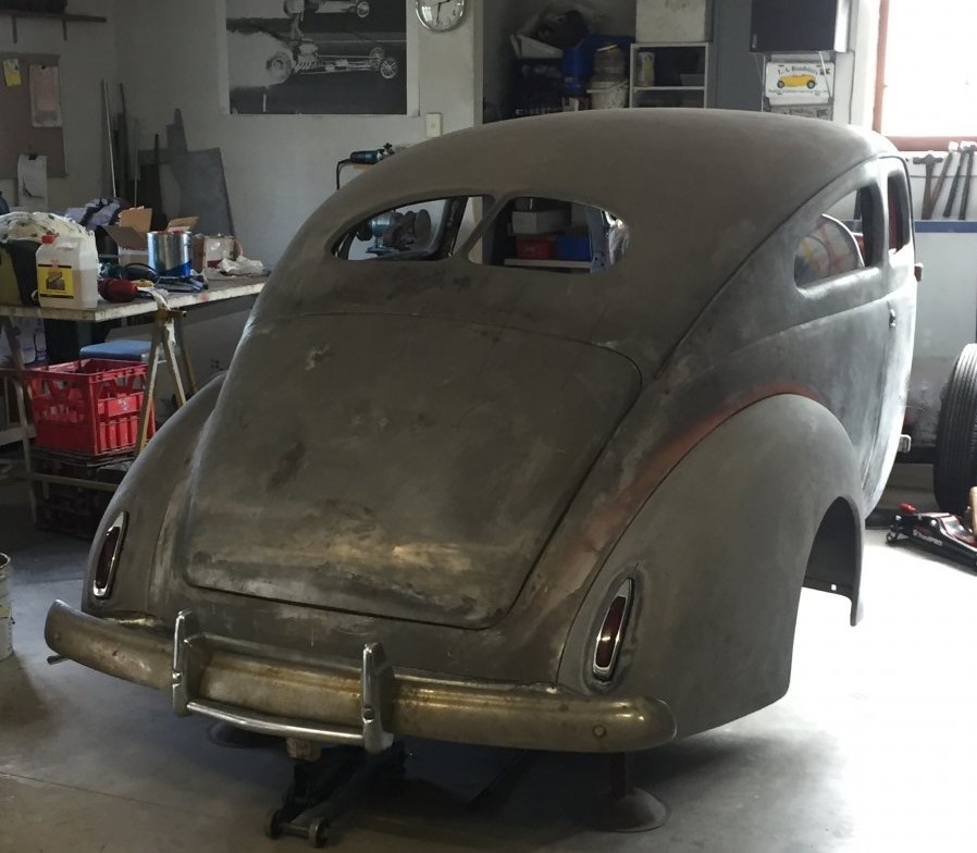

    So here we are with rear fenders, a bumper, somewhere for a plate and a problem.
    This gap:
    But the solution is at hand! BTC...
  3. X38
    Joined: Feb 27, 2005
    Posts: 17,498
    X38
    So the plan is to make a pan that rolls out to the bumper, with a nice radius where it blends to the body and fenders.
    In this whole deal everything is going to be molded: the fenders, pan etc.
    First up, as is often the case, cardboard, to establish the gap to be filled.
    I then transferred this pattern to some MDF, cut the shape and gave the edge a 15mm radius (a bit under 3/4".)
    I cut some material and proceeded to bash the metal over the form. To do this it was sandwiched with more thick MDF and lots of clamps.
    After some time and hammer driven persuasion I ended up with this:
    Trial fit:
    Looks like it's going to work.
    With a bit of t******* it was sitting in place okay. This is as far as I'm going to finesse the pan until I get all the panels to the weld together stage and while it needs a little more t******* and so on, I'm happy with how it's just sitting there for now. At the ends I'm going to add a 90 degree turn down.

    Tail lights mounted.
    Now that the rear bumper location is locked in I can also finish the exhaust. After contemplating various ideas, I think it's going to come out something like this:
