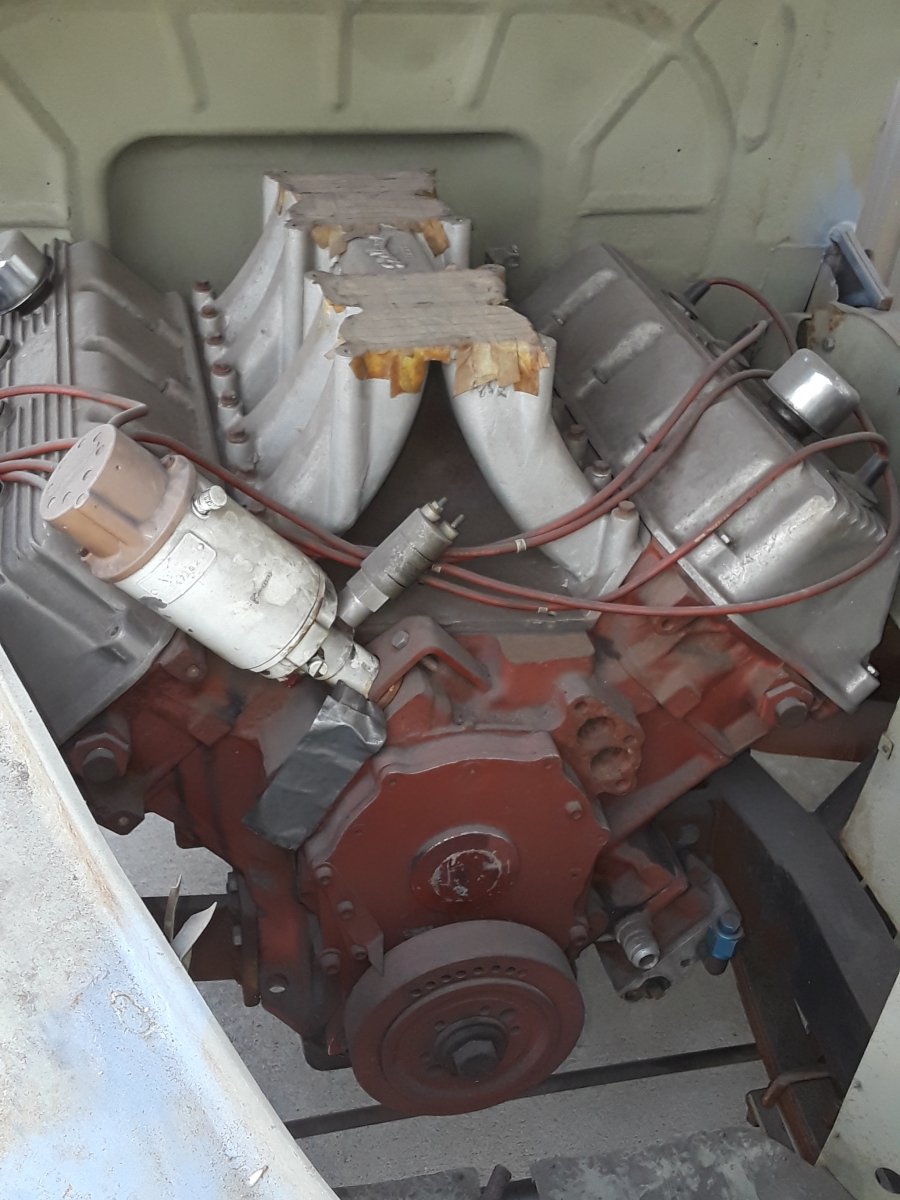

  24. My friends 41. It's a all steel car. 20190330_084103.jpg 20190330_084334.jpg
  25. Mick Coyne
    Joined: Aug 12, 2008
    Posts: 1,257
    Mick Coyne
    426 Hemi in a steel Willys coupe, what's not to like?
    I noticed the wiper location is above the windshield so is that a 40 with a 41 front clip?
    Not criticizing by any means, just curious.
    In fact mine is a 38 with a 41 front clip and dash.
    Could you send more shots as he makes more and more progress?
    Ultimate hot rod G***er, thanks,

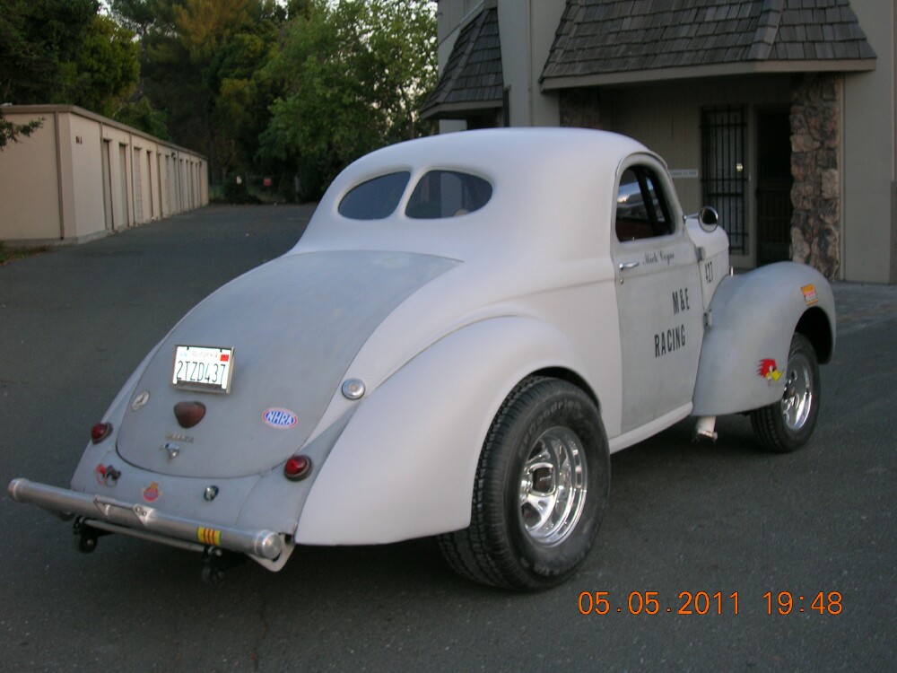

    Rear fender: I had merely cut the opening with a cut off wheel [first shot].
    The body shop later welded in a piece of steel tubing making a nicer radius

    Speaking of license plates, we trailered the car to the races in Bakersfield, Ca.
    and noticed the plate was tearing off at the mount because of the mounting angle.
    Almost lost the plate. It's not flush with the deck lid.
    Not the greatest aerodynamics.
    I also found that I was not alone, Scott H. sent me a photo of his cure.
    Might save somebody from losing a plate,
