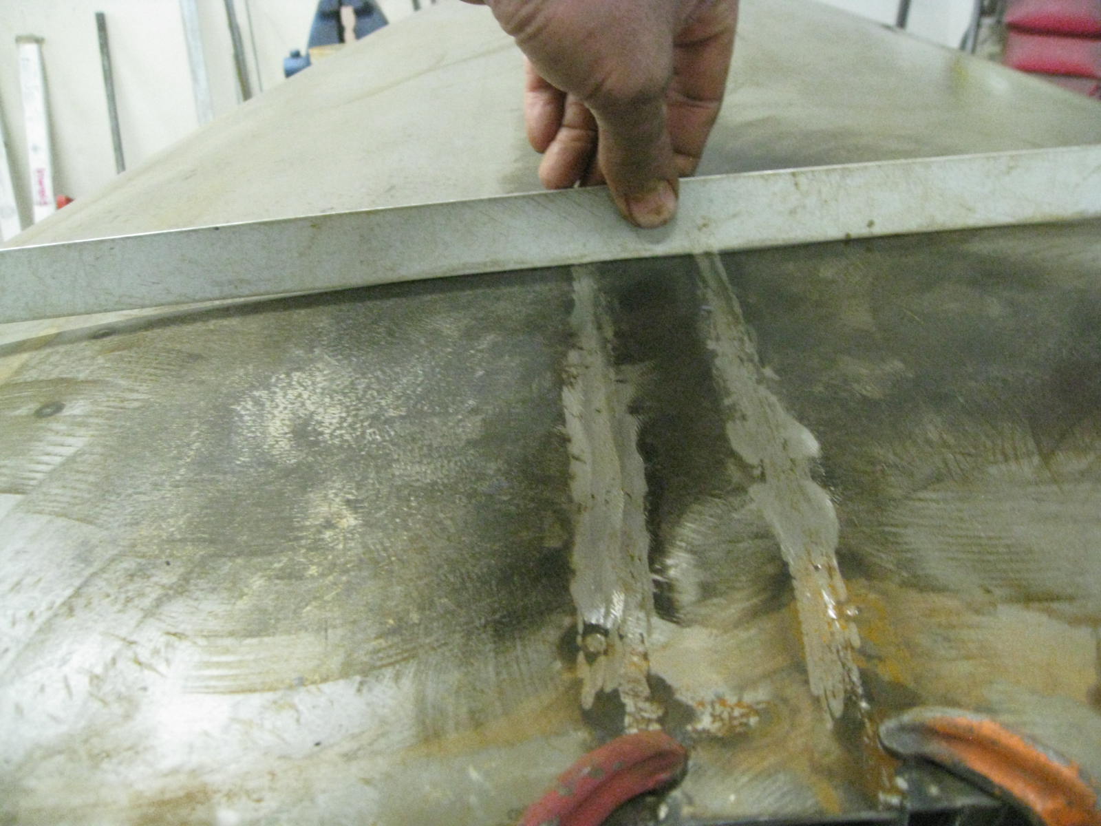

    Do you achieve this by shrinking and stretching?
  12. the metalsurgeon
    Joined: Apr 19, 2009
    Posts: 1,237
    the metalsurgeon
    from Denver
    Yes ,spoon /various dollies/hand weights and the shrinking disc as well as moving the metal around with a planishing hammer whilst maintaining correct shape.

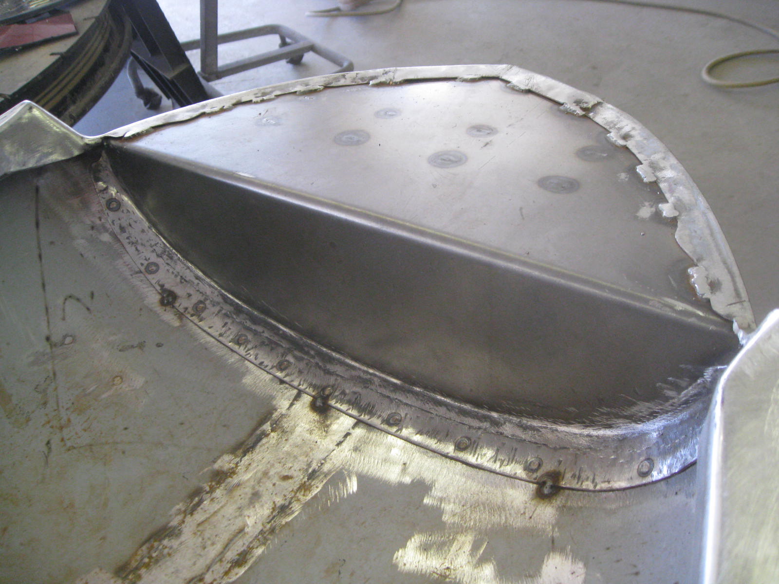

    Spot welding inner hood structure.Note copper used on panel face to avoid crater.You have to do a couple of test pieces first with the copper backing set up to ensure the root of the weld is pulled out.Result ,damage limitation on show face.
