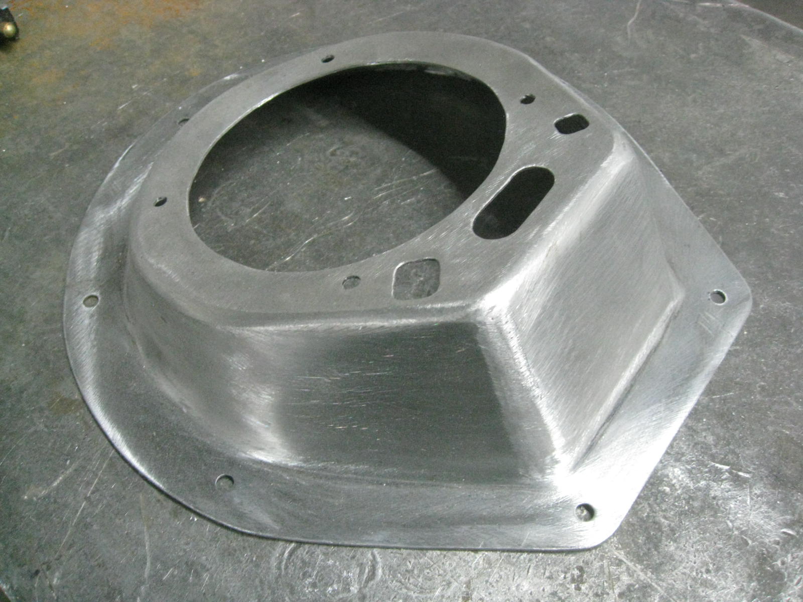

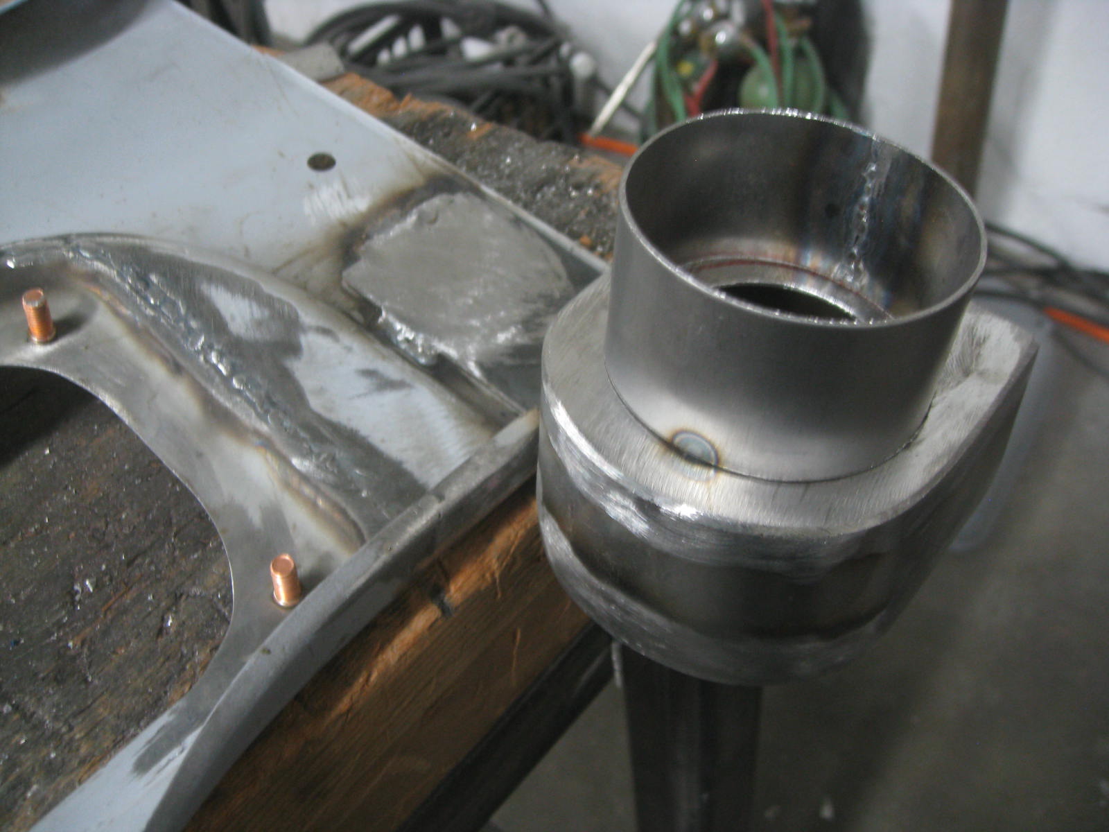

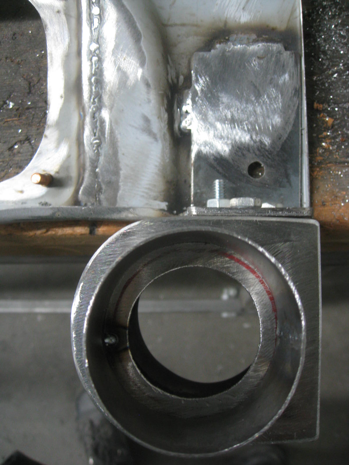

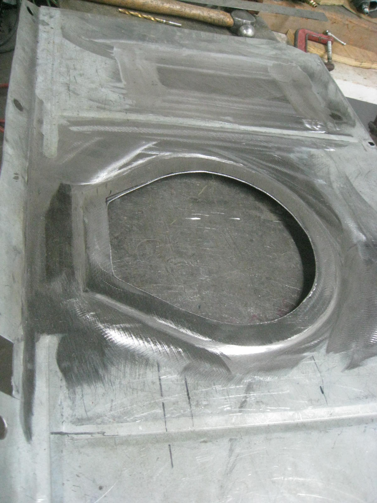

    Cab floor panel.The original one is weak and pitted in areas,along with hacked out holes.So we're going to using the new one,although ill fitting and in need of modification to get what we need in this panel,its new steel and great to work.
    So after welding up the cut outs,we move onto building the shifter housing.The housing has to bolt to the floor panel,so we have to make a recessed flange for added strength.We use simple tooling again,hardboard.
    my weekly metal work blog wwww.themetalsurgeon.com

    Designing and making a shifter housing to take the shifter plate and boot.

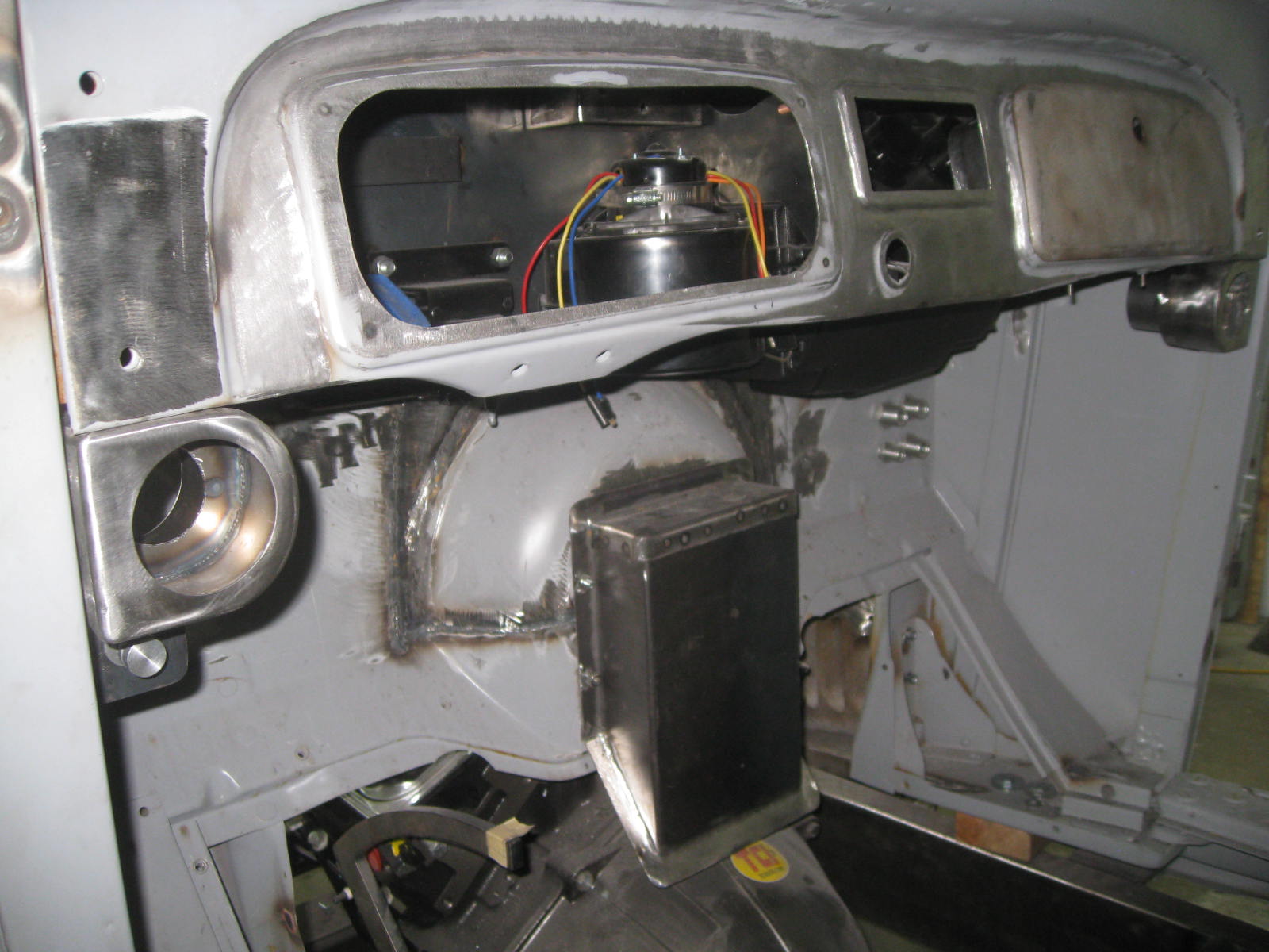

    dashboard...

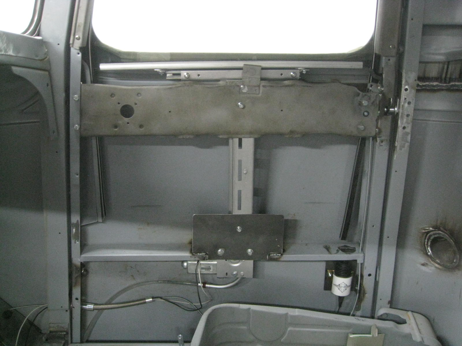

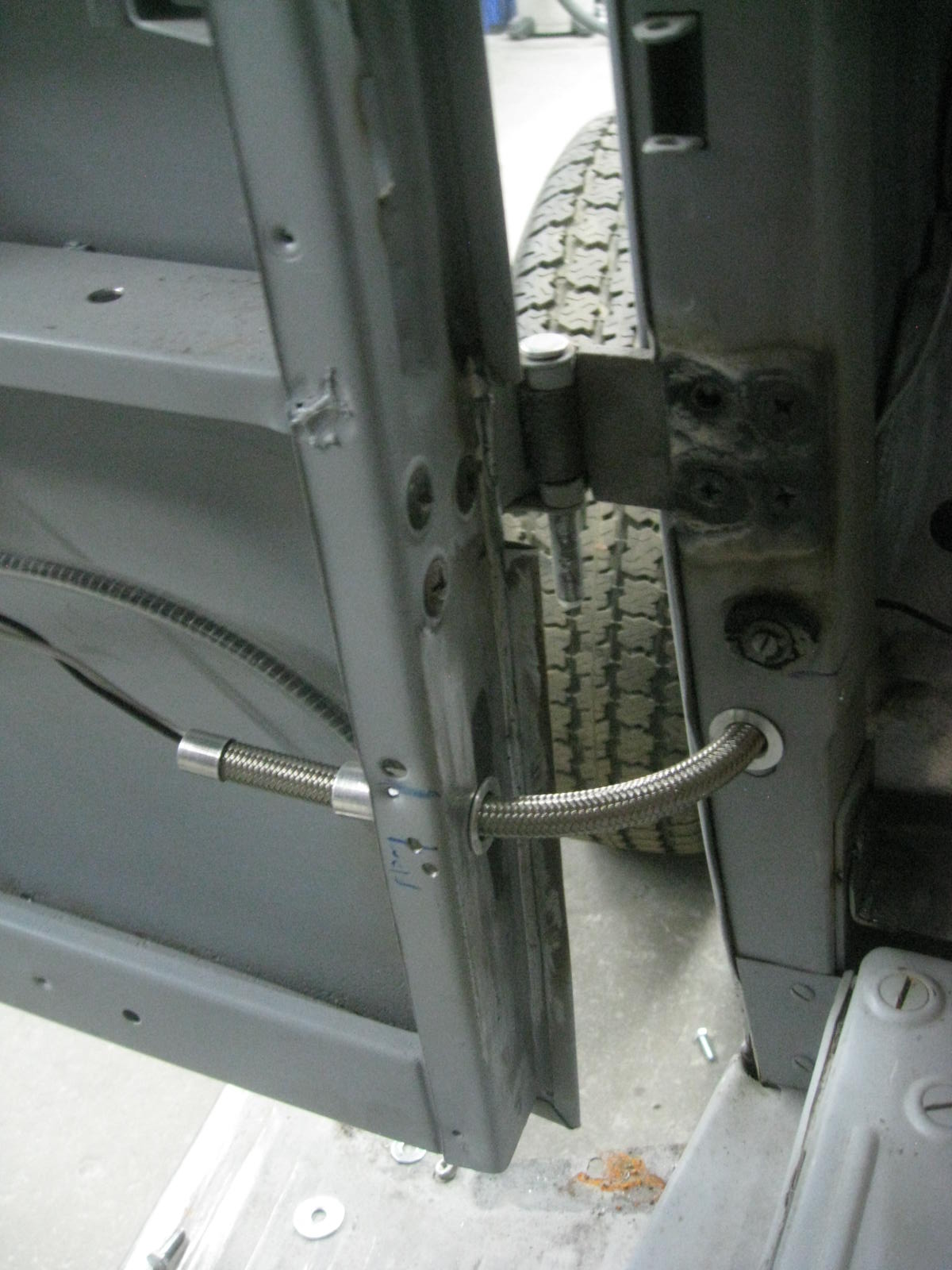

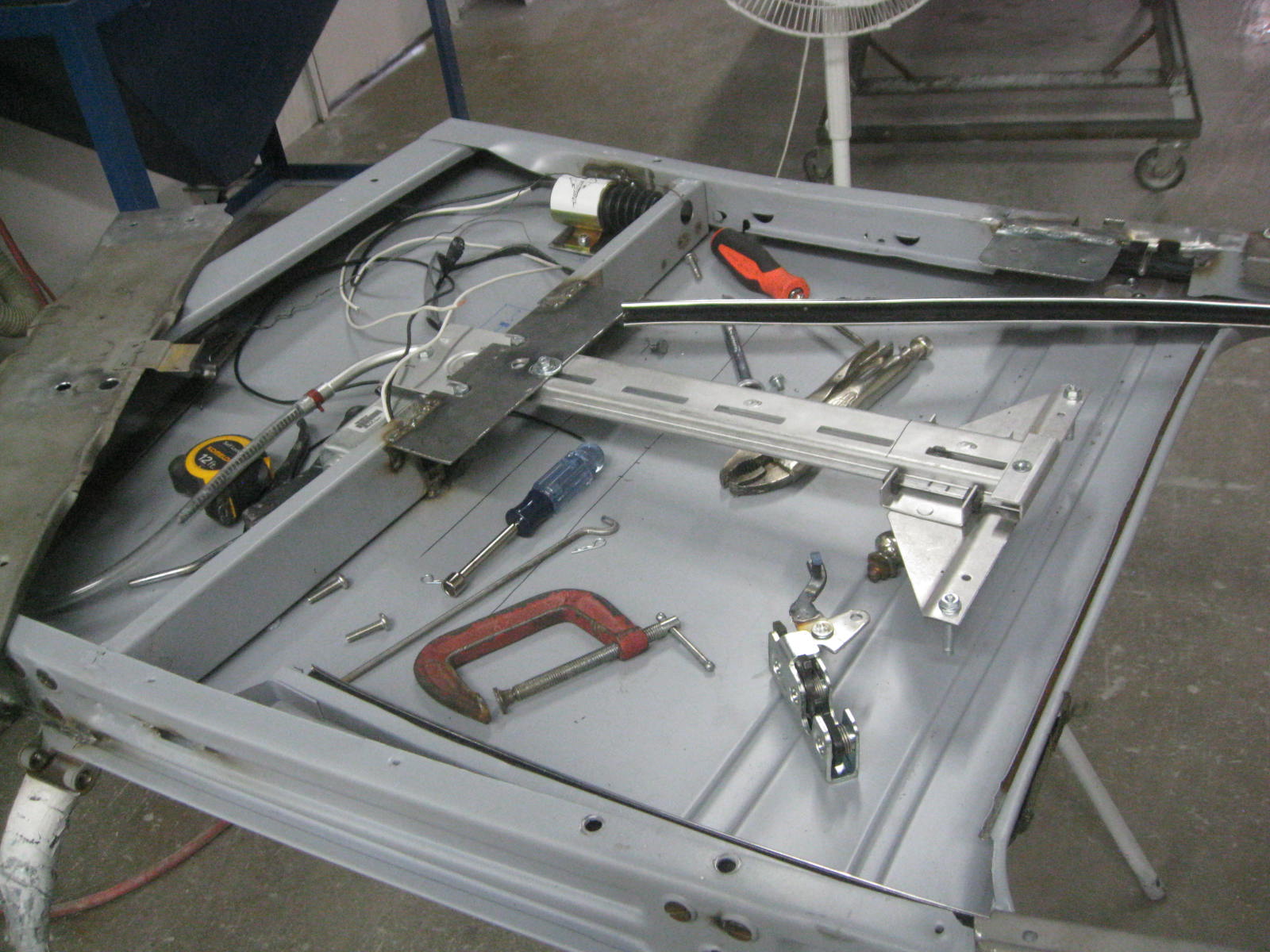

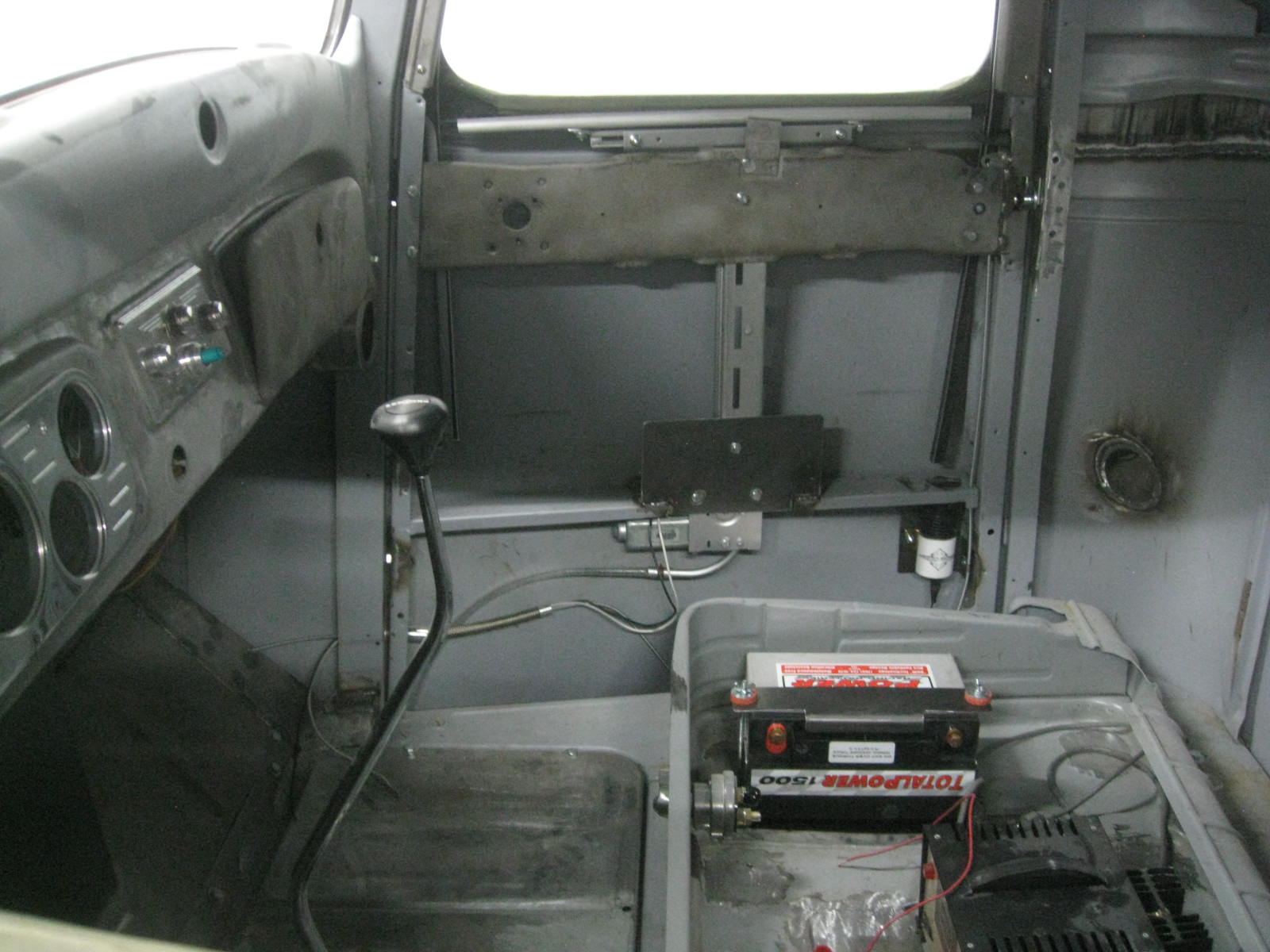

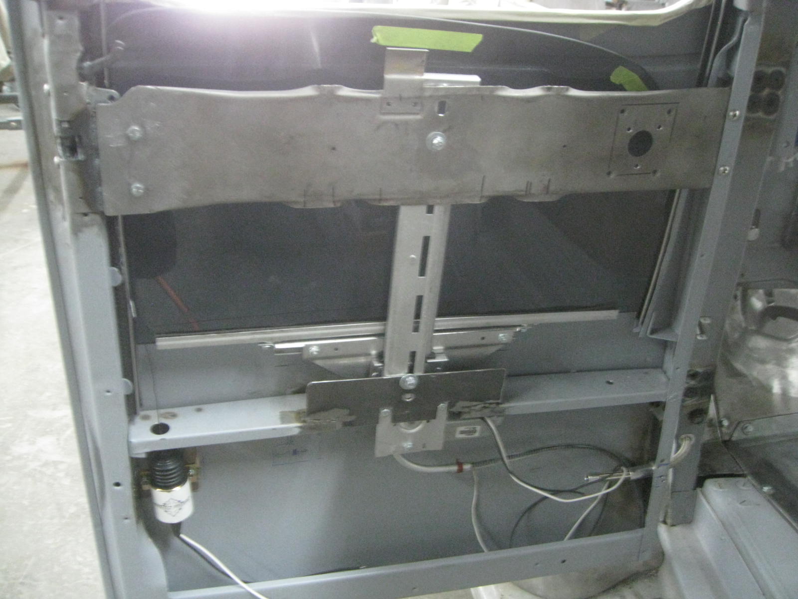

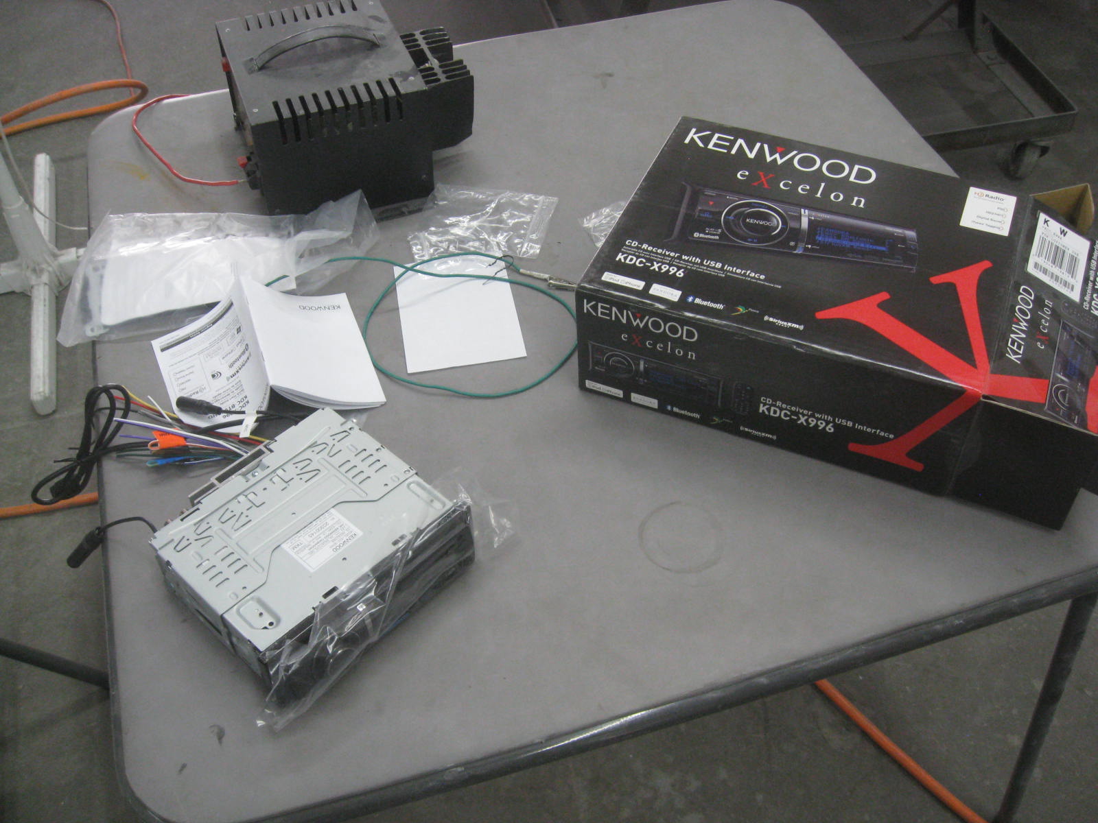

    Electric window build.Last pic shows radio.Body of the radio will be housed in the seat riser and CD access will be at front face of the riser.The radio face will be seated above the rear view mirror.
    my weekly metal work blog www.themetalsurgeon.com
    ......know whats under you paint......

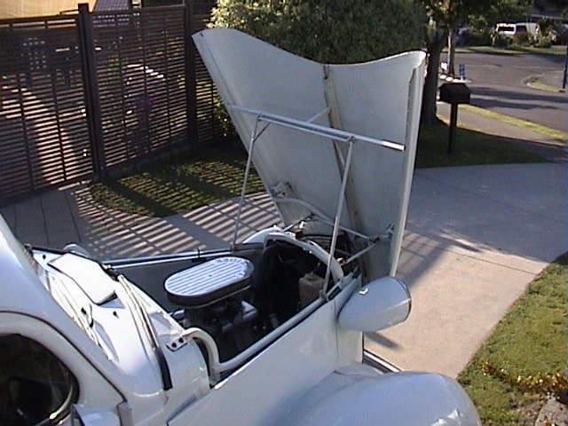

    I made my 37 Nash bonnet lift the same way, works and looks totally different from everyone elses.. Dare to be different..
