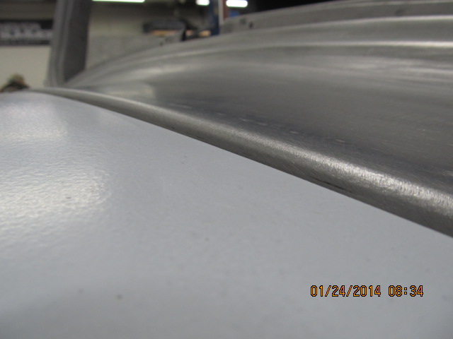

  5. the metalsurgeon
    Joined: Apr 19, 2009
    Posts: 1,237
    the metalsurgeon
    from Denver

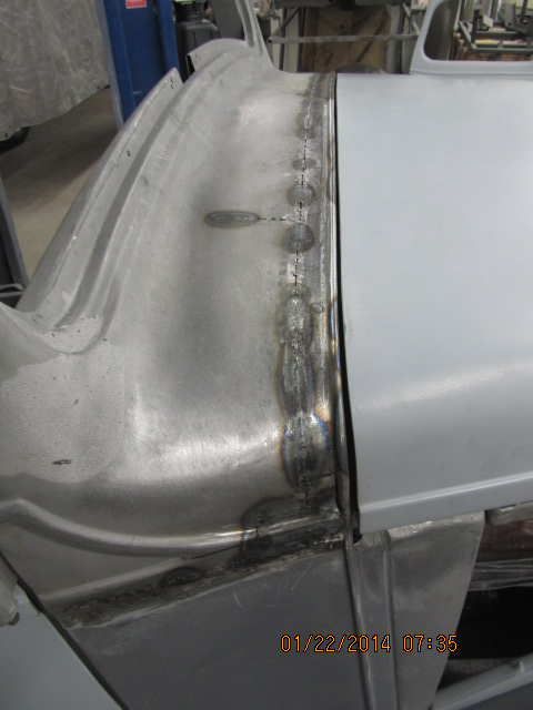

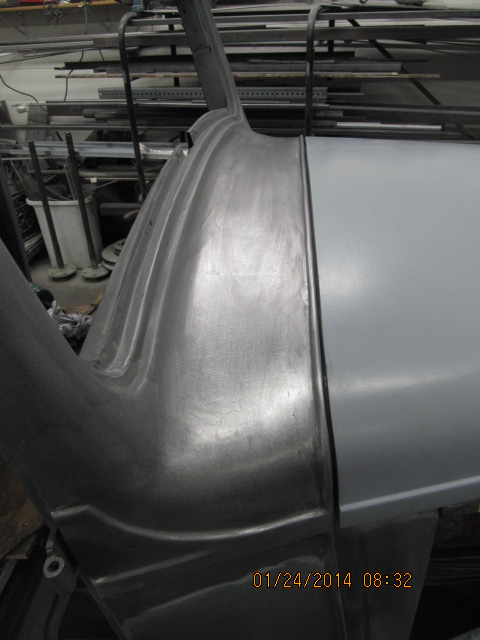

    cab to hood style line build....

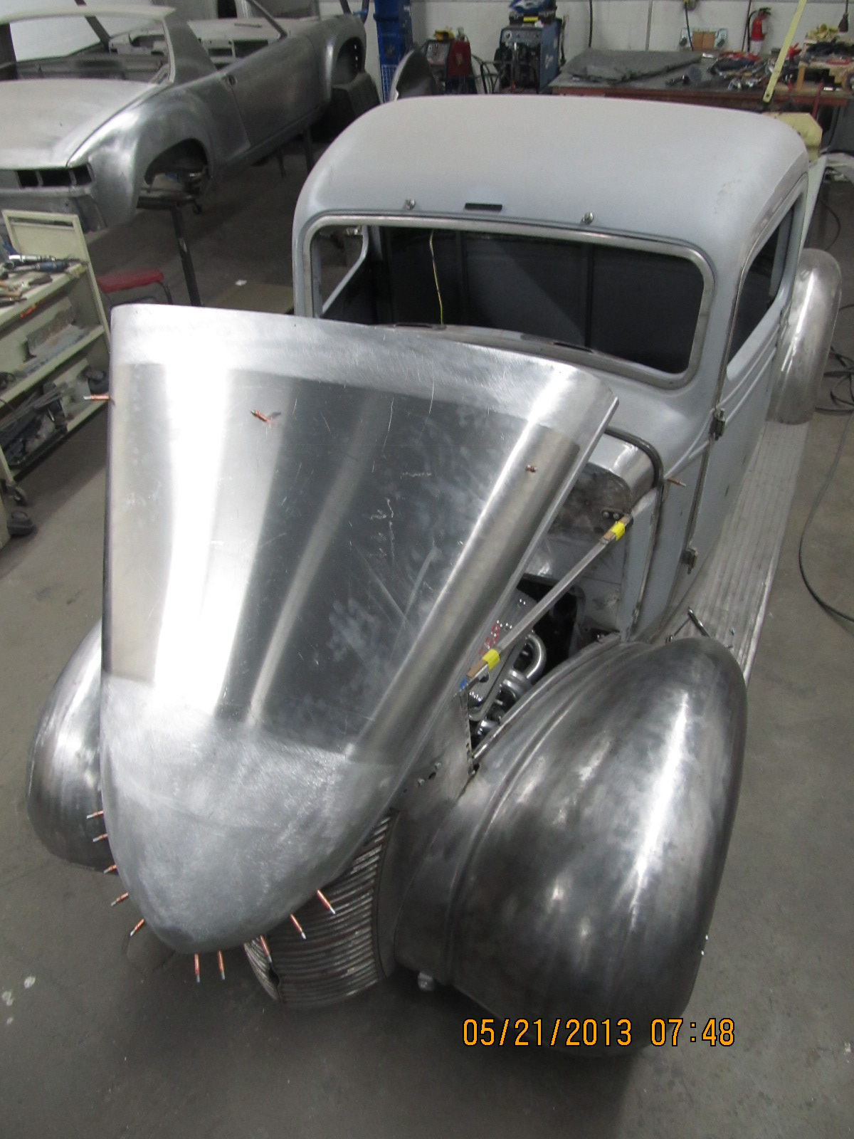

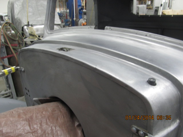

    Hi Jon
    Nice work on the hood. I have a similar opening (w/one piece hood) to yours. Would you be able to take some pics on the workings of it? I need to make some adjustments to make it work easier

  11. the metalsurgeon
    Posts: 1,237
    the metalsurgeon
    from Denver
    sure of course i can.Do you have the same deal where the end of the hood style line meets the back of the grille and so has to lift over before moving forward? to stop the hood tips clashing with the back of the grille i had to make a 'spring plate' to push the hood up before going forward and acts the same in reverse.
    Thats why you see most forward moving hoods totally flat at the base,so much easier,i wish i had talked the owners into this look!
    we are putting it back together real soon and ill post you as many angles as possible.
    thanks all for viewing and comments.

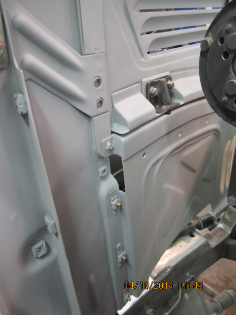

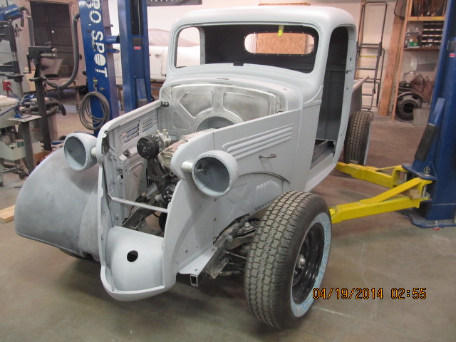

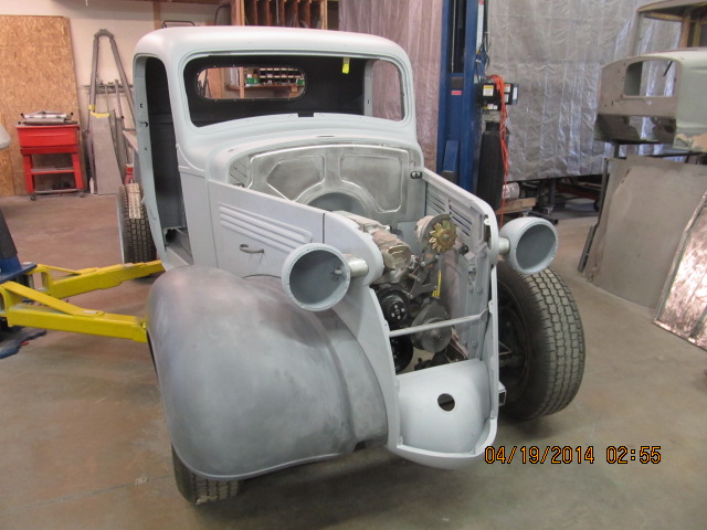

  19. the metalsurgeon
    Posts: 1,237
    the metalsurgeon
    from Denver
    and installed...

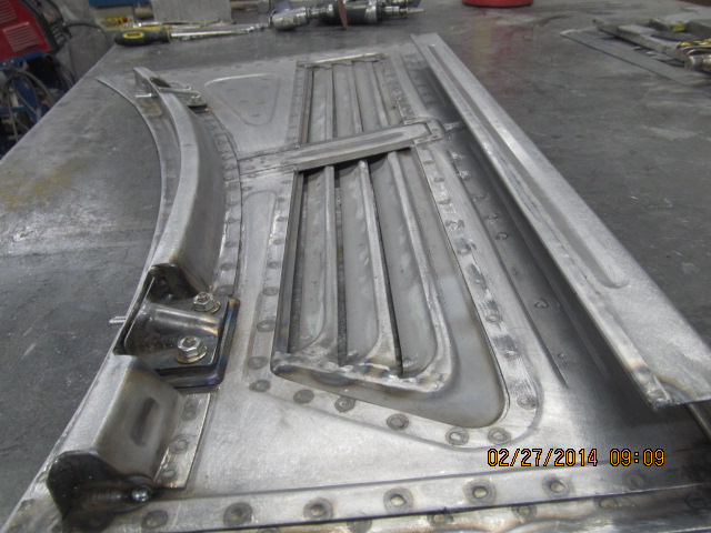

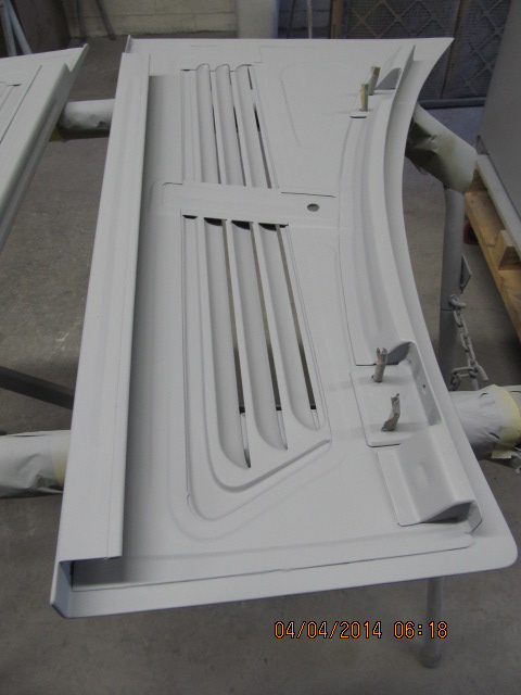

  20. the metalsurgeon
    Posts: 1,237
    the metalsurgeon
    from Denver
    Firewall close out panel.

  25. 49ratfink
    Joined: Feb 8, 2004
    Posts: 20,517
    49ratfink
    great work.
    the problem with threads like these is people see everything all smooth with no evidence of the weld seam and want their project to look the same even though their welds and fitment do not match what is going on here. then they grind the weld area paper thin in an effort to fool people into thinking their work is this good. working on a car right now where every patch installed by the other guy is ground all to hell with tiny pinholes and paper thin metal which was warped by the heat generated with their aggressive grinding...
