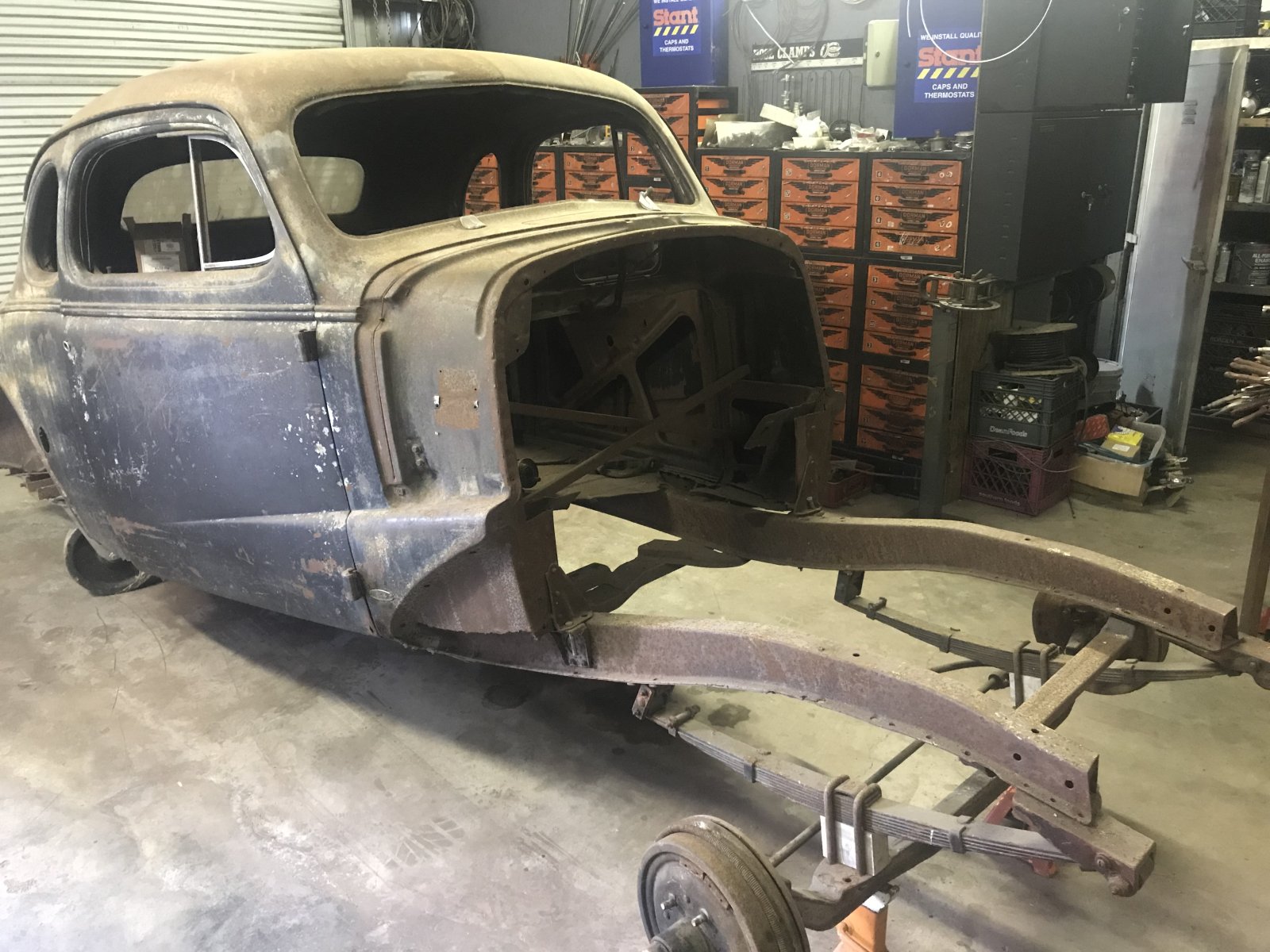

    This is the beginning photos of my 38 chevy coupe g***er build, have had this car many years in storage. This build will not be a street car, this will be for race only. 305CE9A5-930F-4FE5-9716-24A8C828B592.jpeg

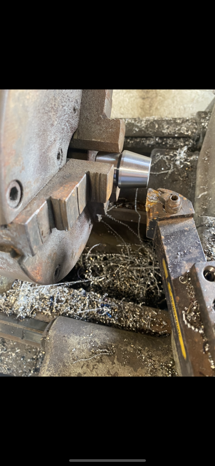

    Oldskooloval
    Going with a 9 inch rear,old style tube brace, 35 spline strange axles and center section. Built the housing from a old Edsel rear center and some new 3 inch axle tubing. 8EE87F06-F5AB-4B84-8484-C567A9798C81.png 535FCF4F-BE87-420B-9373-F34997E3492F.png 49AAAEE6-72DD-4823-A86B-E5E163146D21.png

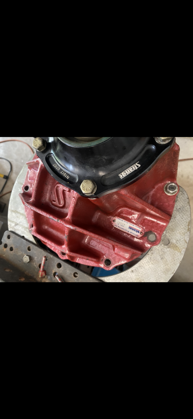

    26E9482B-B838-4F1B-AA8F-33D2D035B5E4.png 21B10A36-C1C4-462A-A377-AB39A9617286.png Center section with a 35 spline spool and strange axles

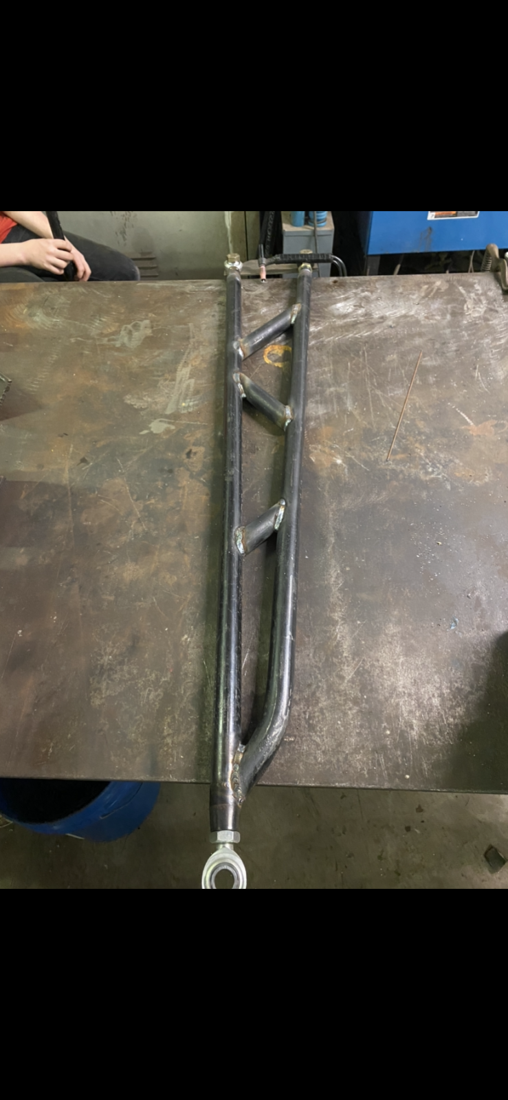

    Started making the ladder bars
    saltflats, pila38, swade41 and 2 others like this.

    Cut and threaded all the ladder bar ends and tig welded them into the bar ends

    Ladder bars fully welded

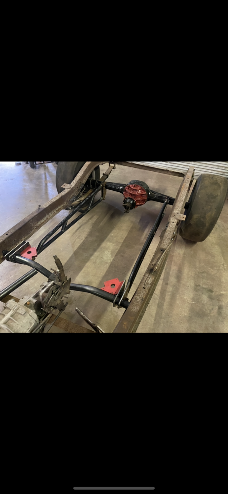

    Oldskooloval
    Frame supports and rear transmission crossmember tacked into place. The frame will be put on a frame jig for final welding
