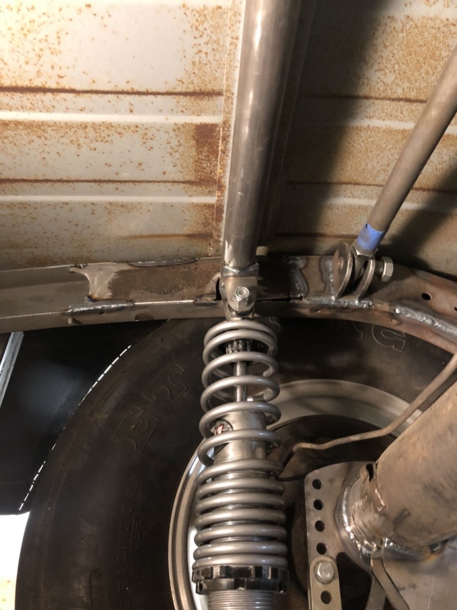

  4. flyin flattie
    Joined: Oct 13, 2005
    Posts: 602
    flyin flattie
    from Redmond OR
    After getting the front of the frame welded and most of the boxing finished up I re installed the front suspension. We came to the conclusion that if we came this far we might as well weld up all the holes in the frame and then I finished the shock mounts as well.

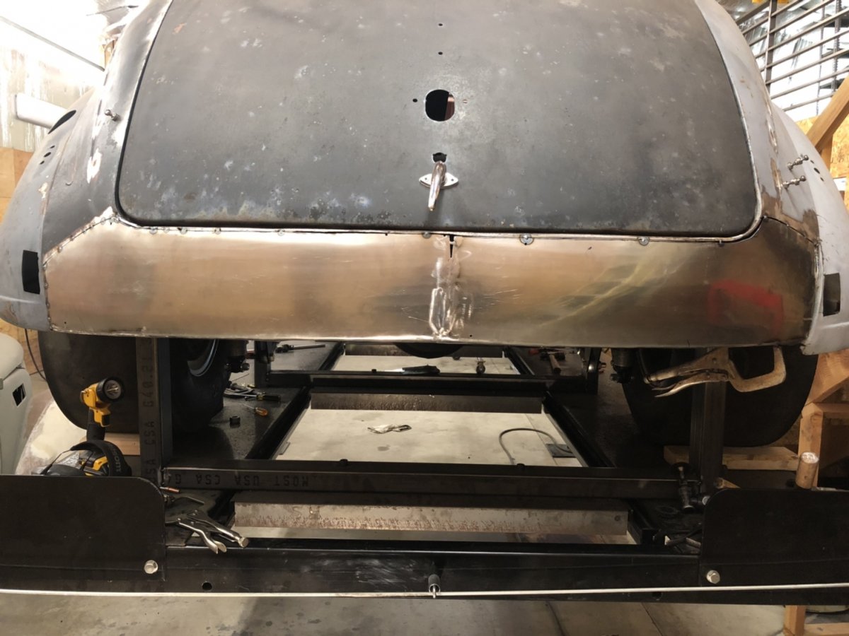

  6. flyin flattie
    Posts: 602
    flyin flattie
    from Redmond OR
    IMG_1608.JPG IMG_1615.JPG IMG_1605.JPG IMG_1625.JPG IMG_1648.JPG IMG_1660.JPG IMG_1650.JPG
    And in between sanding the frame I took a break and fixed the rear lower valance and inner part as well. It was really rough but I got it bubbly and smooth again.

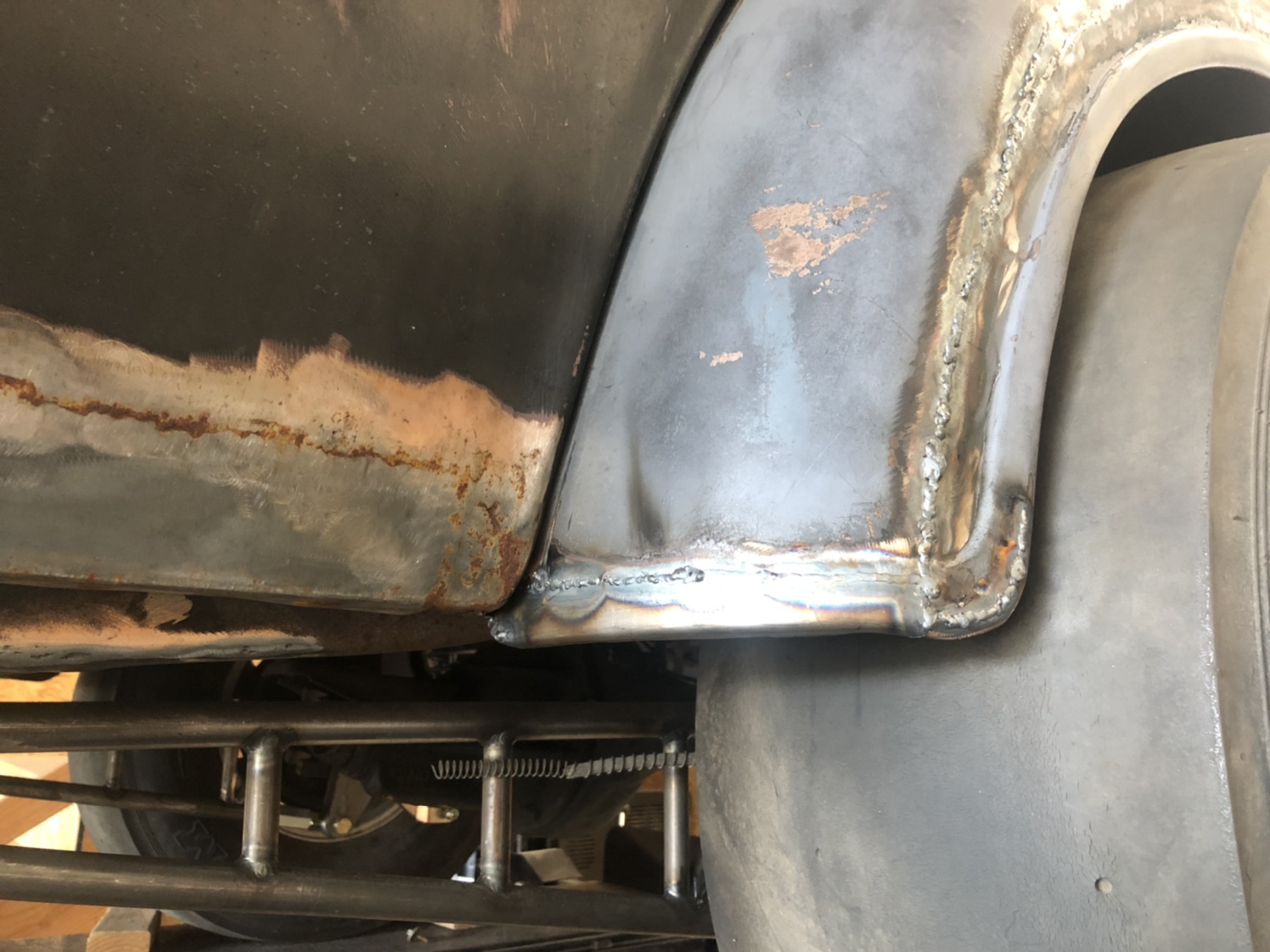

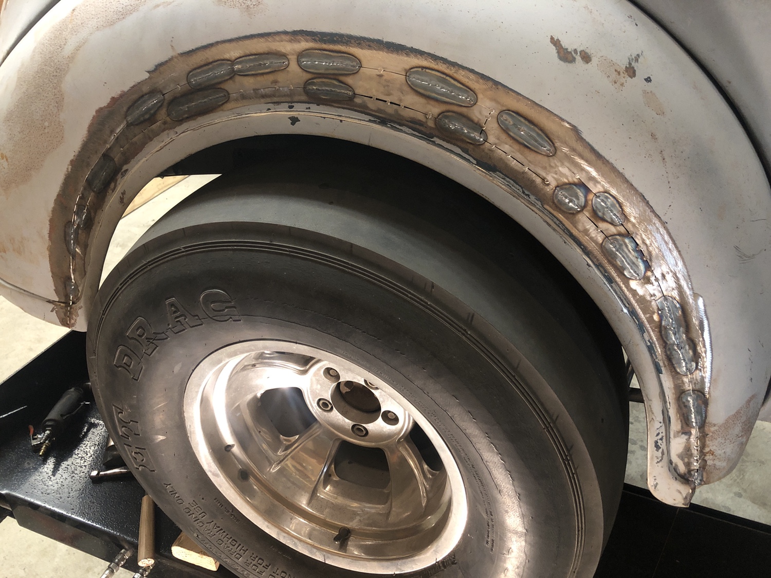

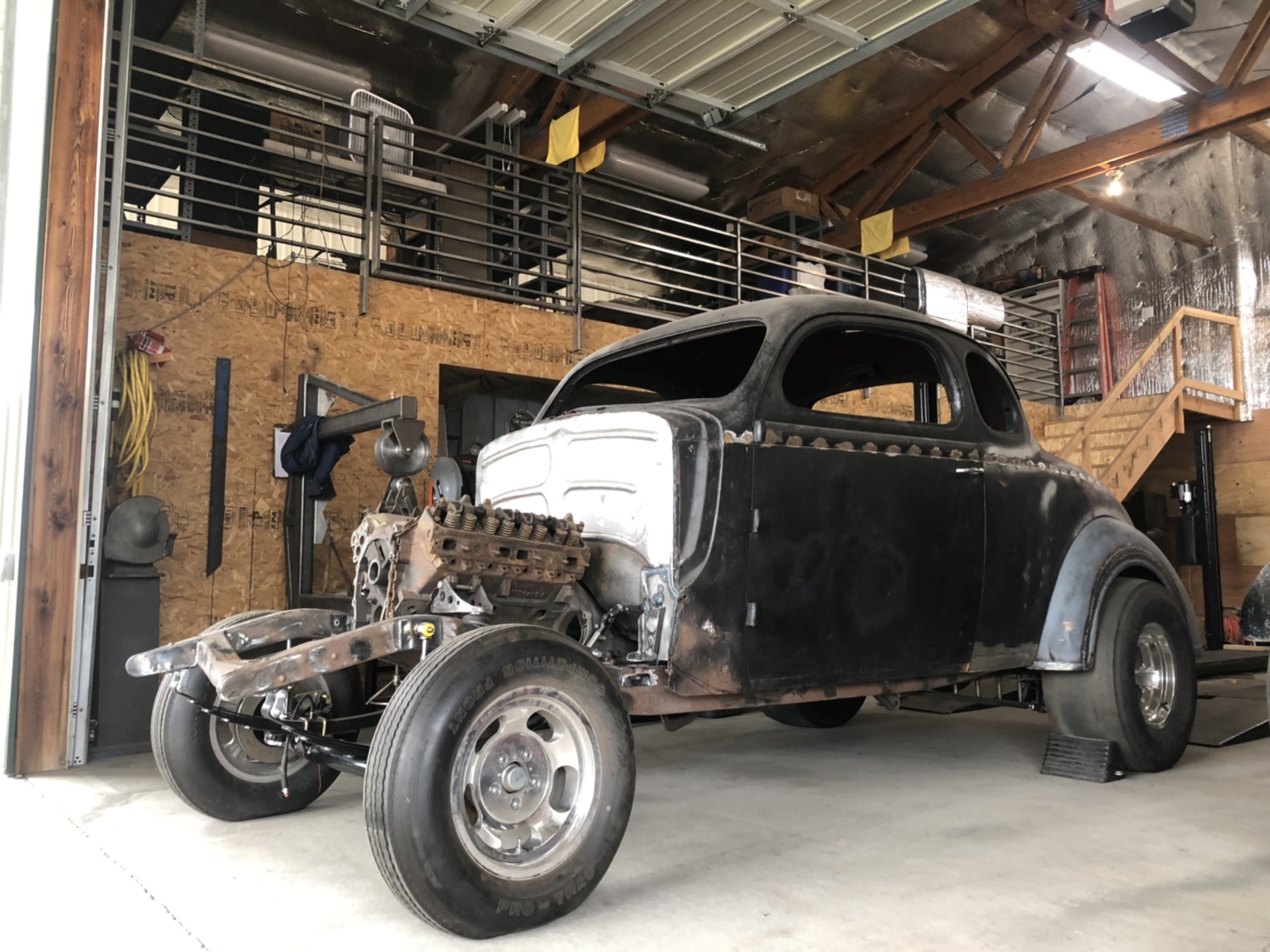

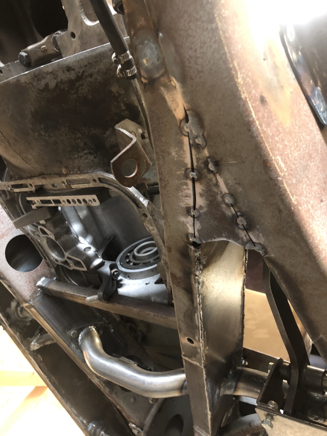

    from Redmond OR

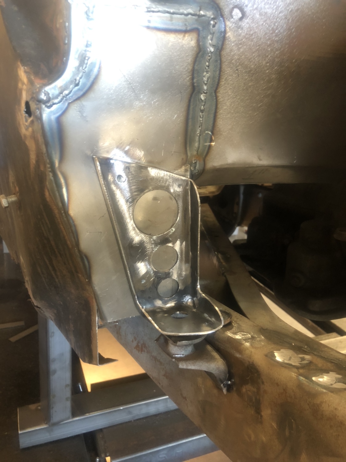

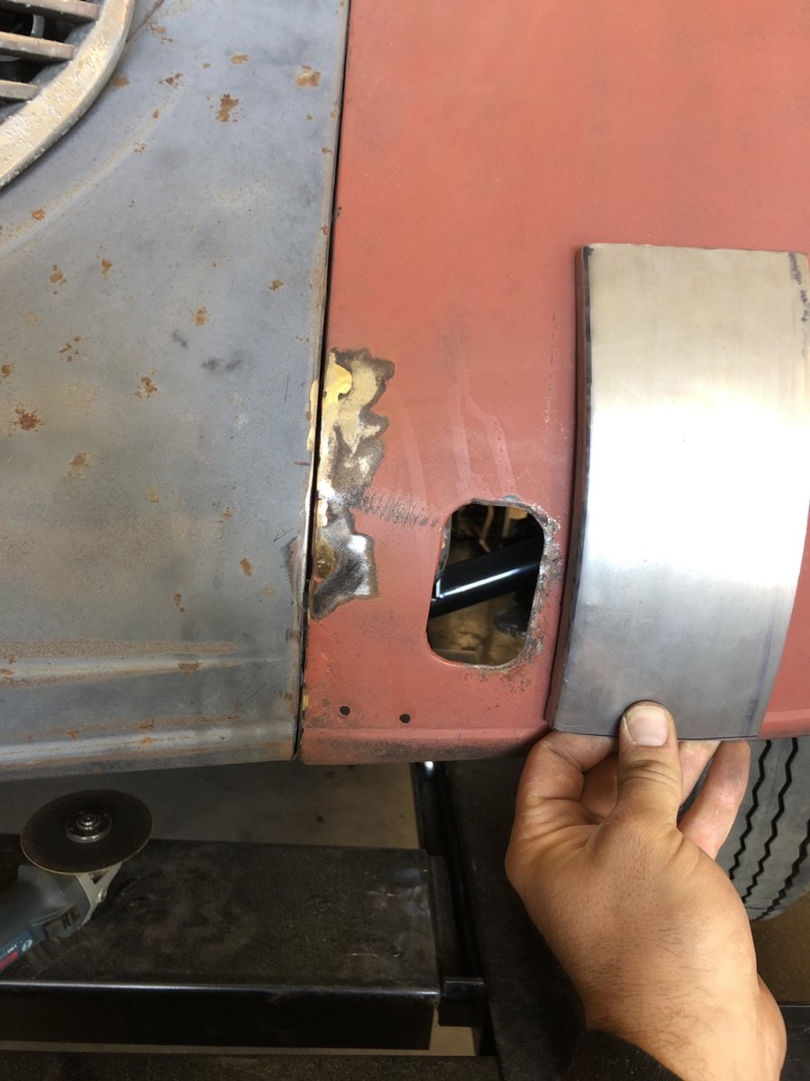

    Last update! I got the steering arranged and figured out. As far as the column when it gets a cage put in it the drop down bars to hold the column will attach to the cage.
    I made new body mounts for the front of the fire wall and finished up the fire wall inside and out. Once the motor and trans get put back in I’ll probably have to make a trans tunnel but for now this is the floor set up.
    [​IMG][​IMG]some triangles for the front of the frame to fill in the big void that would more than likely twist under tension.
    I made a removable front pan hard bar as well. Removable because honestly I don’t think this front end will need it but if I’m building might as well check all the boxes. Especially since the front end has a spot for it.
    Finished up welding the rear fenders and made a delete for where the running board went as well
    Finally here it is rolling out of the shop off the jig lift and ready to head to the body shop for some more patches and body and paint
