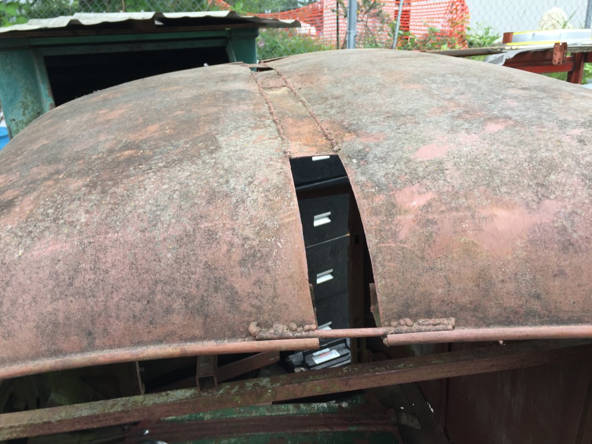

    3DCFD935-46D9-45DE-8CB9-8C4698DDFB03.jpeg A5BFB309-4CCA-47D0-8FE3-EB58B0A183F1.jpeg 41BE9426-D36C-403D-A597-5340C68F0E59.jpeg So I have the stock front end which is a “spring over “ configuration. Tell me what you need. If I have it I may be willing to split some of the parts up so someone can get benefit from it. As I remember the wishbone socket ***y has been incorporated into the reconfigured frame.
    The screwball that previously owned the truck had preformed a hideous chop. He was sooooo proud of his welding expertise...
    It looked like he “hot dribbled” the roof skin back together. I’ll try to find the cab pics

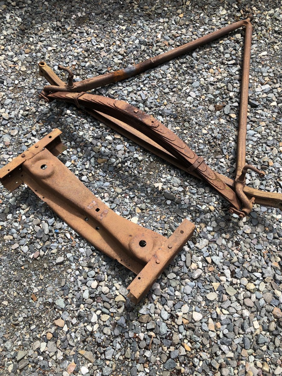

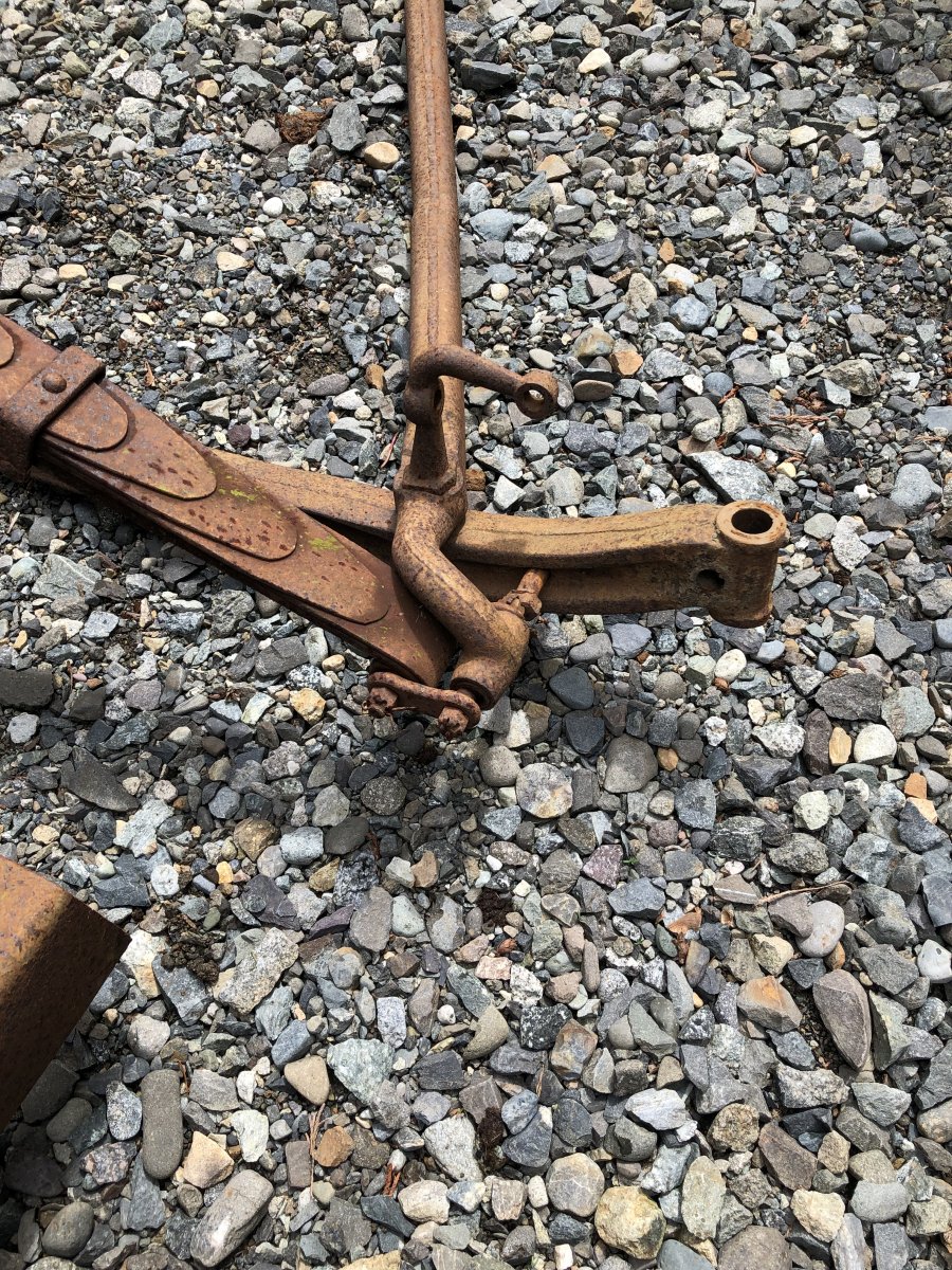

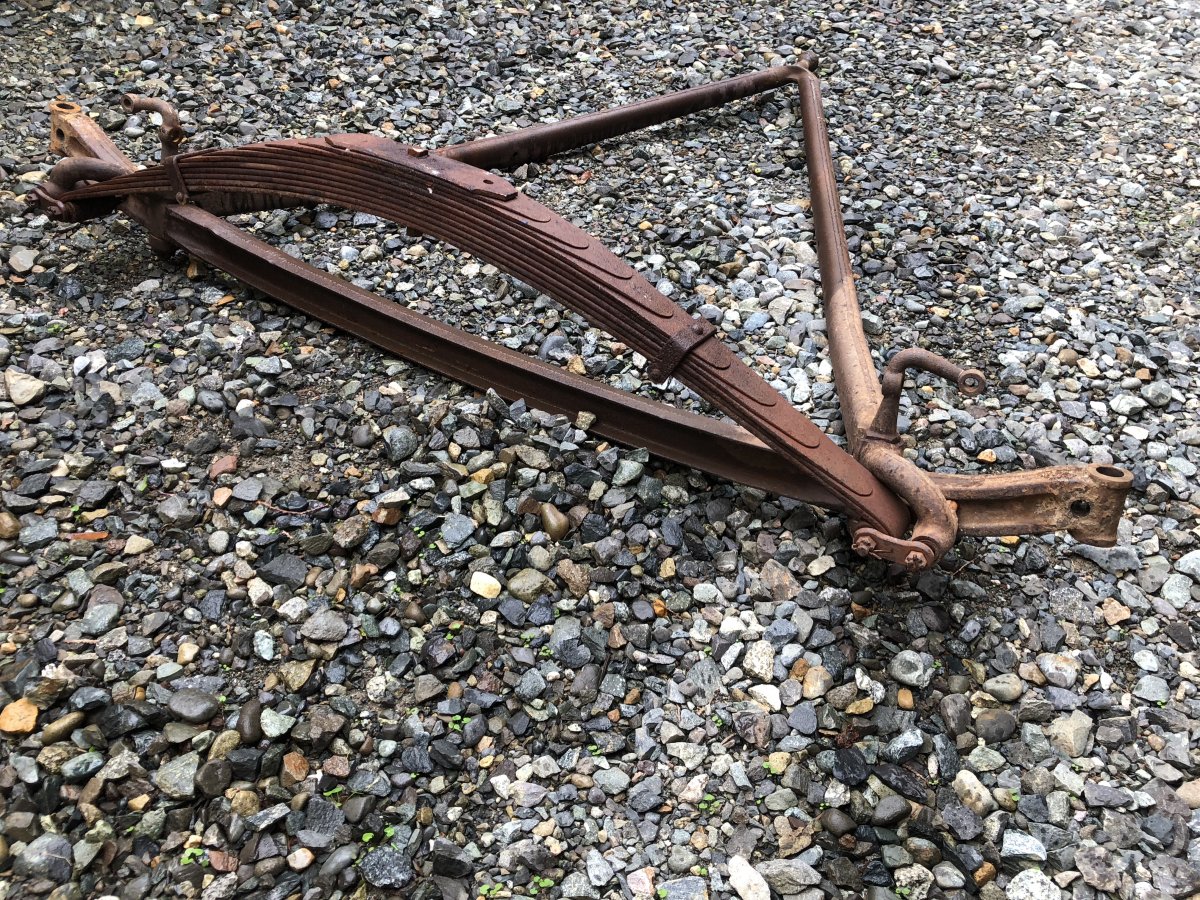

    nobby
    I think that is a 35 36 front wish bone and cross member
    I think you can use that wishbone in its stock central configuration with say a so-cal axle, and bolt it in a 35-40 frame
    the wishbone on a 37 38 39 is wider at the perch

    [QUOTE : I am having trouble finding a 35-40 front shackle.... think I need a stock one
    am also having trouble reaming my king pin bushes... bought an adjustable reamer that was too big, bought one that was too small and broke it.[/QUOTE]
    I (as you’ve seen in the pics) have the main spring and all of the leaves along with the shackle brackets. Do you only need the shackle brackets? Is your main spring in good shape?
    Once again, if there are some parts that would help you maybe we can work out a deal to get them cut apart, boxed up and shipped in your direction.
    I’ve built a number of cars and trucks. As a suggestion be cautious how much you cleanup/remove material when you ream out your king pin bores. It doesn’t take very much to go too far. Usually the bores and upper and lower faces has surface rust on them. Often I’ve found that a flat file for the upper and lower surface is enough combined with scotch brite in the bore will get you started. Be careful that your reamer is true to the axis of the king pin bore and that you’re flushing the rust and small chips out as you are “lightly” reaming the bores out. It’s easy to mess it up. Many cars with “death wobble” woes can be traced back to loose king pins and too loose perch pin bores.
