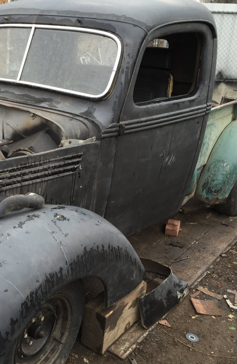

    The big truck front fenders are huge and do not work for 1/2 ton. I think the running boards are 38/9 only
  5. If you’re cheap and desperate enough - you can do like I did. Rework the big truck fenders.. But, if you have the funds you’re way better off to find fenders for a proper 1/2 ton pickup.
  6. Here’s a shot mid surgery and a far away, extra blurry pic of it “finished”. Looked best from 50 yards or above 60 mph but I didn’t have luck finding fenders I felt like buying
  7. manyolcars
    Joined: Mar 30, 2001
    Posts: 9,608
    manyolcars
    looks ok from here. where did you cut? any place other than the bottom?
  8. Basically a section job. The bottom with the running board mating surface was brought up a bit. 4 or 5 inches was removed in between.
