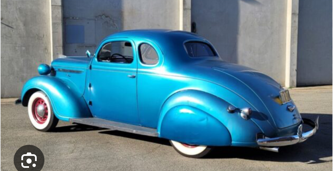

Projects 1938 plymouth coupe project
Discussion in 'The Hokey Ass Message Board' started by gas man, May 7, 2025.

    Great looking car! Rebuild the brakes and with a stockish engine you will be fine in todays traffic-as long as you drive within the car's rated specs. I have become a much better driver due to me driving my Model A with stock brakes. I make sure I know what other drivers are going to do before they do. Obviously, disks are better though and if you can I would.

    ‘38 Plymouth brakes are fine. My old ‘36 Ply sedan had them and stopped great.

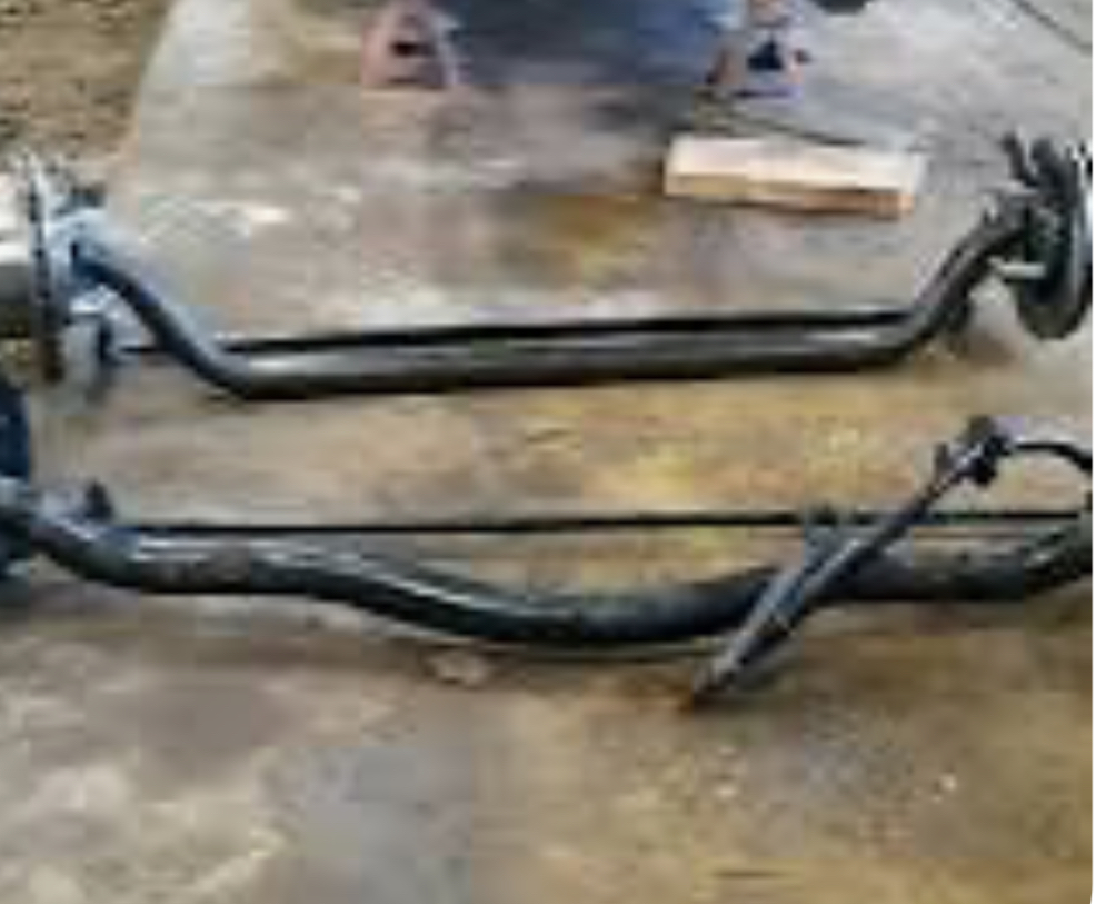

    I think im going to go with bags in the rear. Lower the front to driving height and tail drag the rear when I want. Now the question is call nostalgia sid to lower my plymouth axle or go with a chevy drop axle.
  21. Sid stopped doing drops full time
    The Plymouth is a hollow tube
    Might have to try the forged Chevy
  22. choptop40
    Joined: Dec 23, 2009
    Posts: 5,739
    choptop40
    Can you relocate perches , flip ontop of springs , fab up shorter bump stops . Might work !
  23. gas man
    Joined: Dec 3, 2014
    Posts: 144
    gas man
    from socal
    Bummer. I really want to keep my front end plymouth. Id like to lower it 4 to 6 inches in the front. Got any ideas ? Chevy axle ends reamed to fit the plymouth king pin and spindle ?
  24. gas man
    Joined: Dec 3, 2014
    Posts: 144
    gas man
    from socal
    Axle can't go on top of springs. Tube axle will hit the oil pan
  25. Well, a friend of mine claims he used mopar spindles on a ford axle.
    Those are transverse spring
    I have seen a mopar with a ford style x-member and axle set up. But would probably need a front style spring to clear the engine. Just spitballing
    Those can be bought reasonable and stretched
    There’s other folks that drop axles besides SID
  26. But then ya got this
    screen shot from a video of a guy building a 38 Plymouth
    Looks like a regular aftermarket tube axle. Those can be found with either ford or gm king pin options
