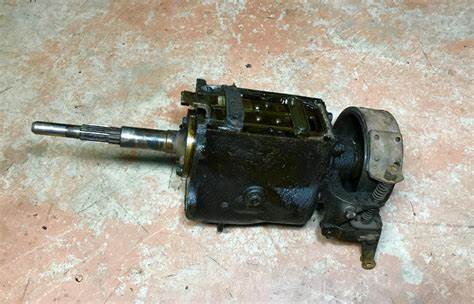

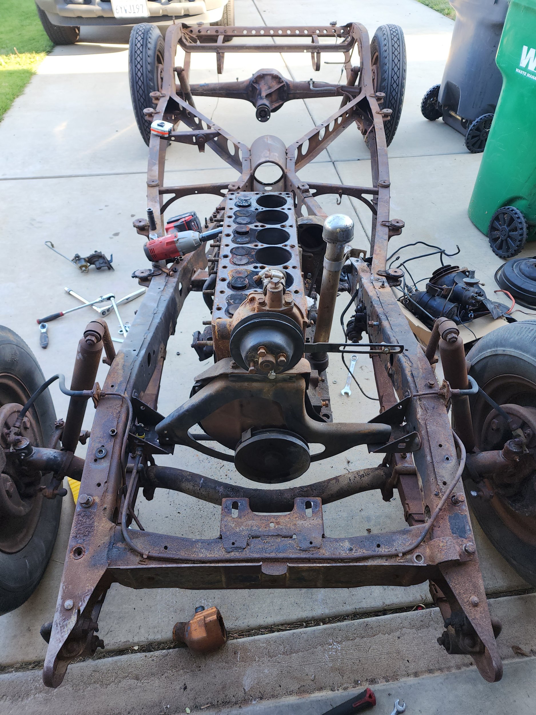

    Got the motor in from the 59 pickup and sticking with the trend I took it apart. Cylinders look decent. The pickup bellhousing didn't work so I got a 39 bellhousing off ebay. The pressure plate hits so im gonna need the correct one. I also need to find a transmission, that may slow me down. 20250524_181649.jpg

  8. RodStRace
    Joined: Dec 7, 2007
    Posts: 9,023
    RodStRace
    Those are good engines, but they are torque biased, not RPM. A step up from the stock 3 speed is going to make it much more modern road friendly. They also had the e brake on the back of the stock one.
    You may end up swapping rear axle, too. More modern self energizing brakes, one piece axles, the e brake function, plus more gear ratio selection and easier to find parts.
    I grabbed an 8.75 from a 68 Coronet, which are not as easy to find now, but didn't need to be shortened, just spring pads welded on. Those rear springs will work, but are narrower than later stuff.
    lemondana, Okie Pete and gas man like this.
  9. RodStRace
    Joined: Dec 7, 2007
    Posts: 9,023
    RodStRace
    As for the trans, stock was what would be called a mid mount, with the trans hanging off the back. I swapped to a V8 auto and had to fab a mount. It's pretty simple, the cross member that was from the trans, cut to fit between the X member with a plate welded to each side. Those bolt to the member.
    This is a 40, so it does vary some.
    Deutscher, Okie Pete and gas man like this.

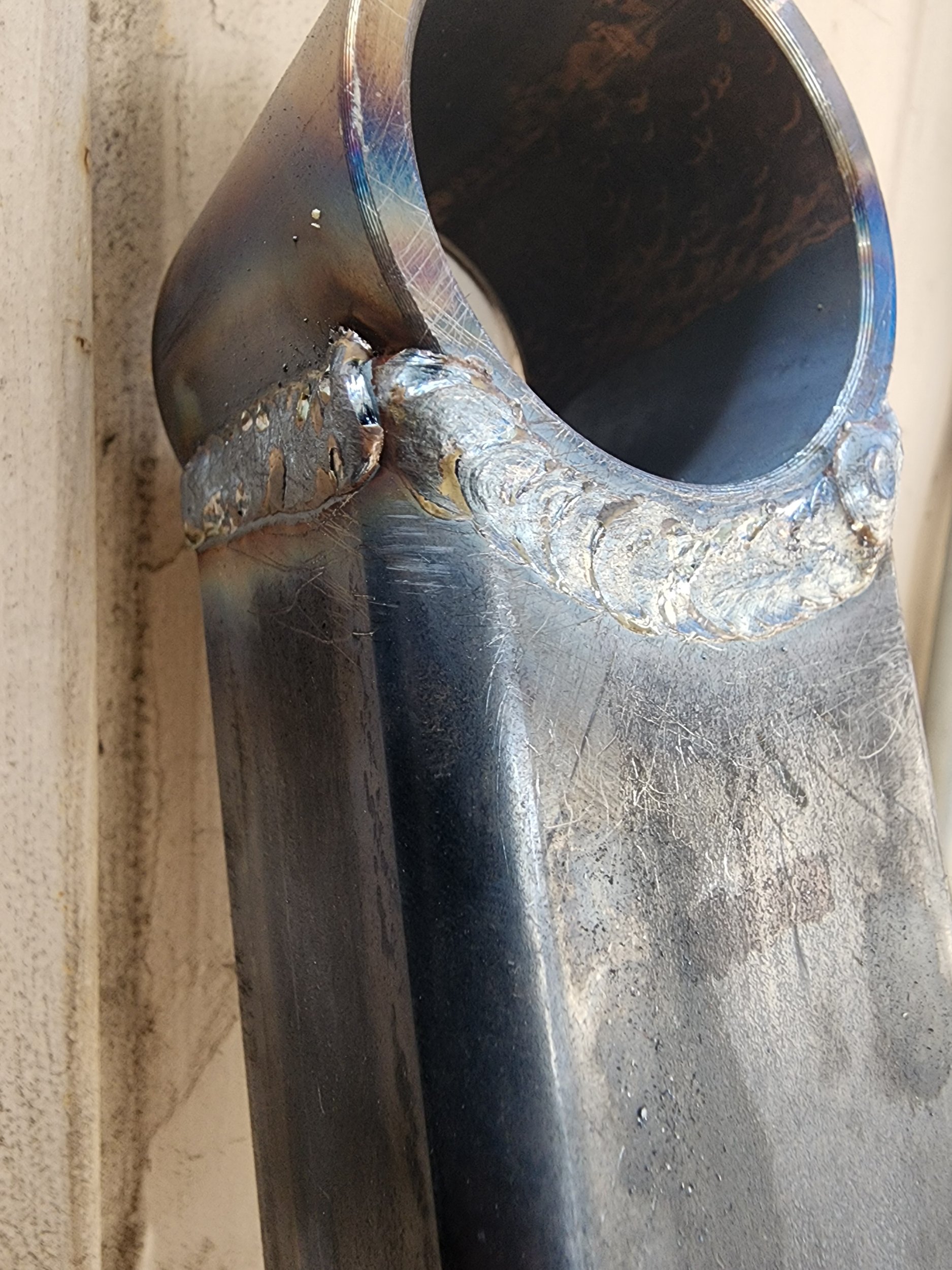

    The local metal supply didnt have the size I wanted for my crossmember, so I made my own. Arc welded it with a root p*** first. 20250603_111454.jpg 20250603_114952.jpg 20250603_121122.jpg 20250603_135048.jpg
    Tried mig welding for the first time on my trailing arms

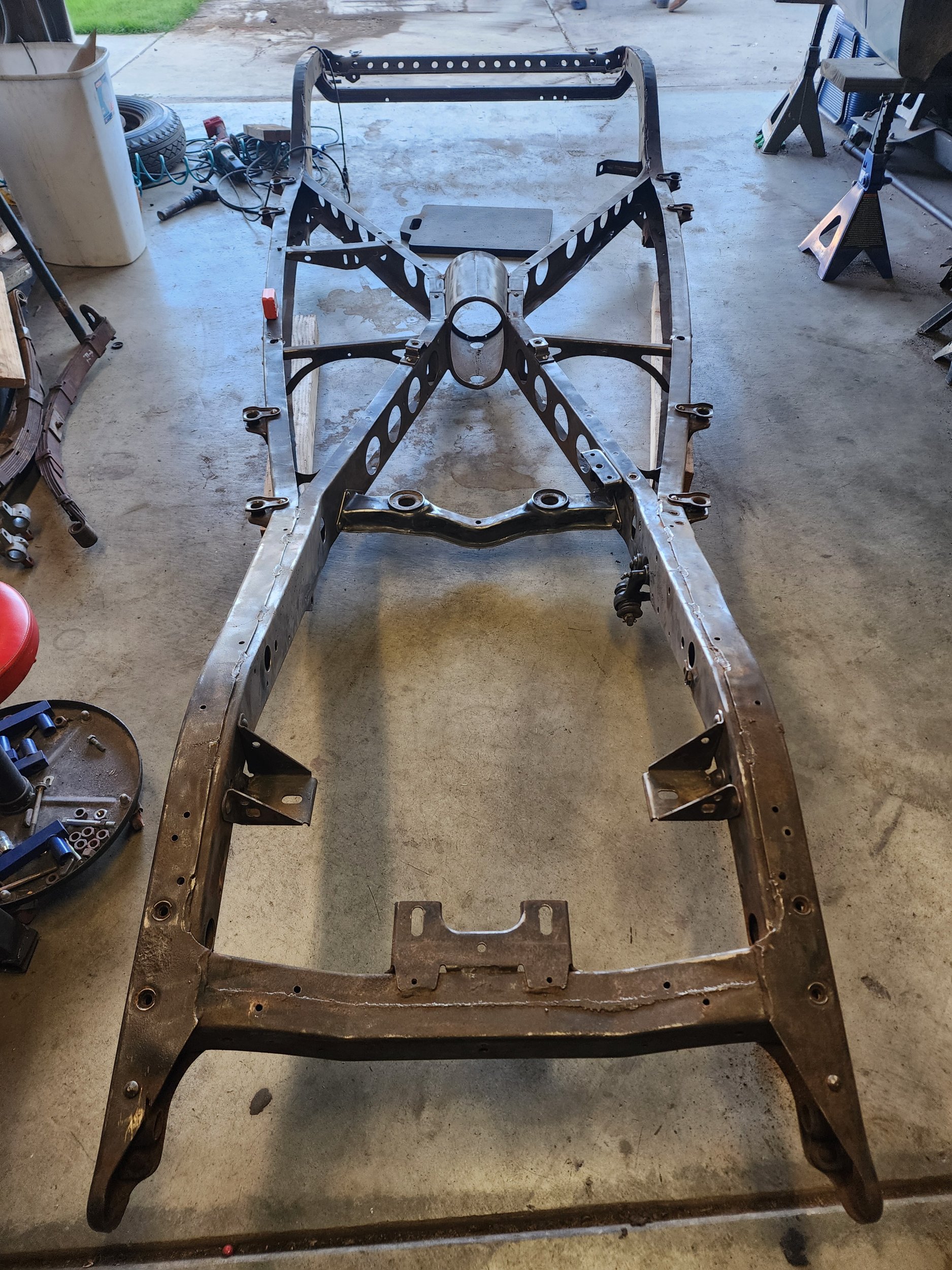

    Anyone see anything wrong with this notch design? It will be made from 3 inch wide 3/16 flat stock. It will give me about a half of an inch clearance between the axle and notch if the frame was on the floor. The axle is 3 inches wide and the notch is 4 at the top. 110 degree angle.

    from socal
    Wire wheeled the frame. Going to paint it semi gloss black with rustoleum
  14. If you add some radiuses you can save some welds
    the rear of the frame will try to sag or pull when the inside plate is welded
    Be careful how ya weld it
    Save some welding for the top maybe for the last bit of welding

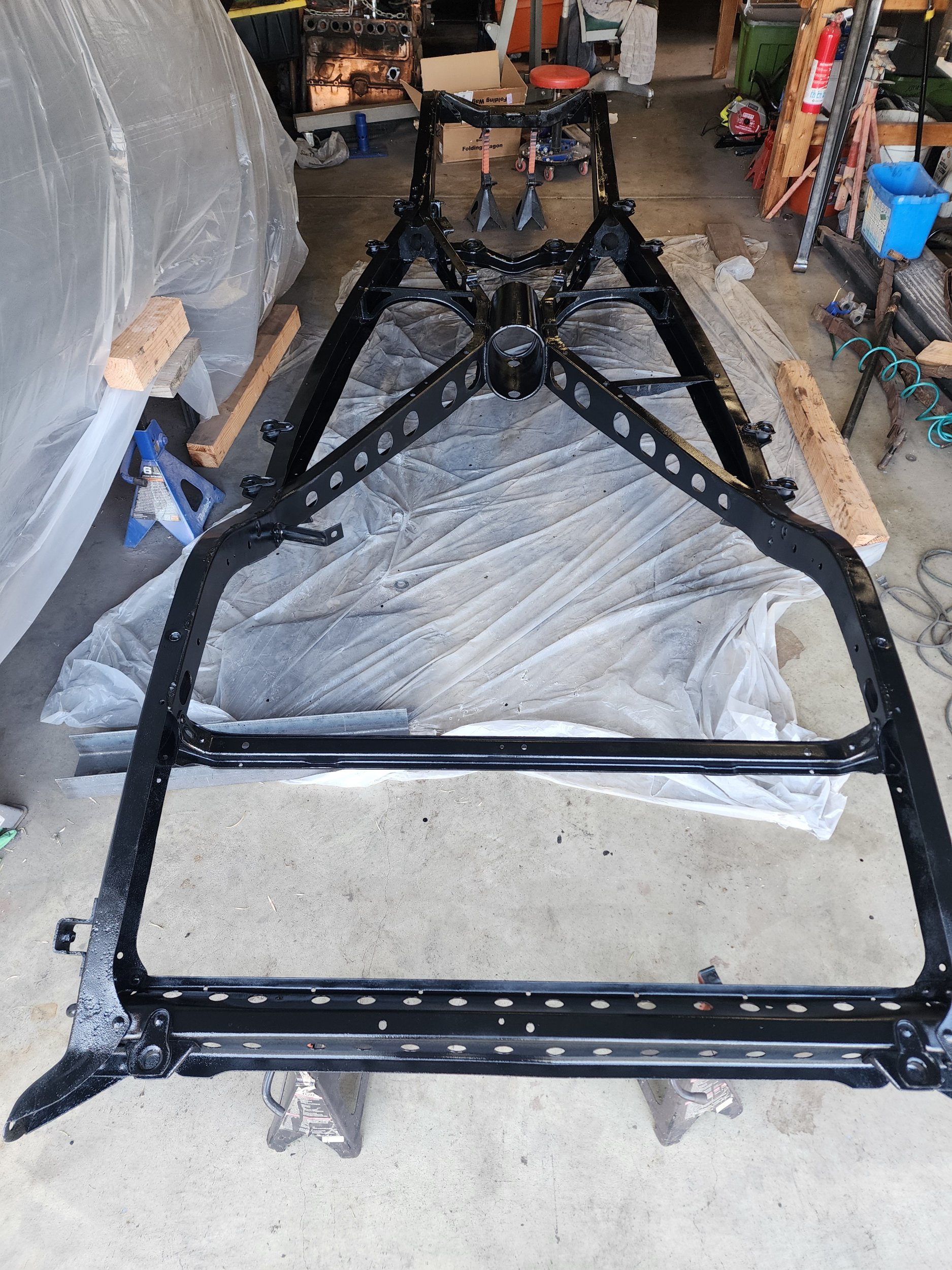

  18. gas man
    Joined: Dec 3, 2014
    Posts: 147
    gas man
    from socal
    20250622_174323.jpg Primed and painted the frame. Upol brand.
    Now comes the fun part of putting it back together.
    Deutscher, mvee33, Okie Pete and 3 others like this.

  20. gas man
    Joined: Dec 3, 2014
    Posts: 147
    gas man
    from socal
    Should I put the body on the frame to do the c-notch ? Im thinking it will hold the frame in place and I will see exactly where to cut floor . Or am I worrying to much ?
  21. Heat moves metal. It’s just fact.
    We had ch***is clamped to very heavy benches.
    Still moved.
    Won’t make a difference.
    How you weld it does
    Welding the inner c-notch last yields the most movement in my experience. Welding long continuous welds seems to move more.
    The more experience ch***is guys can chime in
    I’ve had the best luck doing like 1 inch welds and moving around
    Deutscher, Okie Pete and tr_rodder like this.

  26. gene-koning
    Joined: Oct 28, 2016
    Posts: 5,864
    gene-koning
    The painted frame looks great.
    If you knew you were going to modify the frame, why did you paint it before you did the modifying?
    Now you will need to grind off the new paint before you can weld to it, and then you will need to paint part of it again.
    May I suggest that maybe you hold off repainting the frame until you are completely done with the modifications? That would include the modification for the front suspension, any motor mounts, a possible transmission mount or crossmember installation, possible brake & master cylinder mounting stuff, and the "C" notch.
