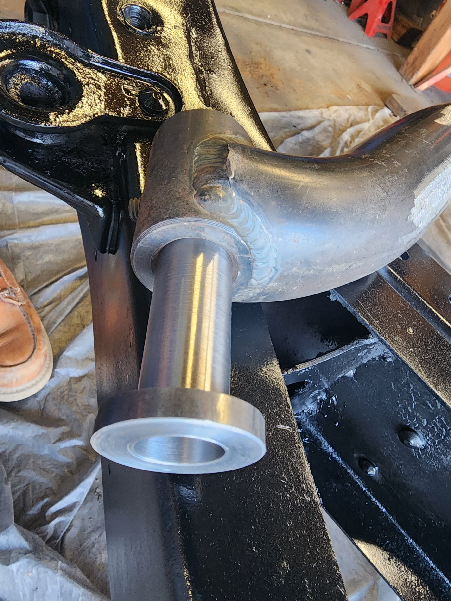

    So what does everyone think about this idea? I have a chevy 6 inch drop axle. I got a sleeve and spacer made so the axle end is the same size as my plymouth end. Any reason I shouldn't install my plymouth spindle on this ? 20250624_171827.jpg

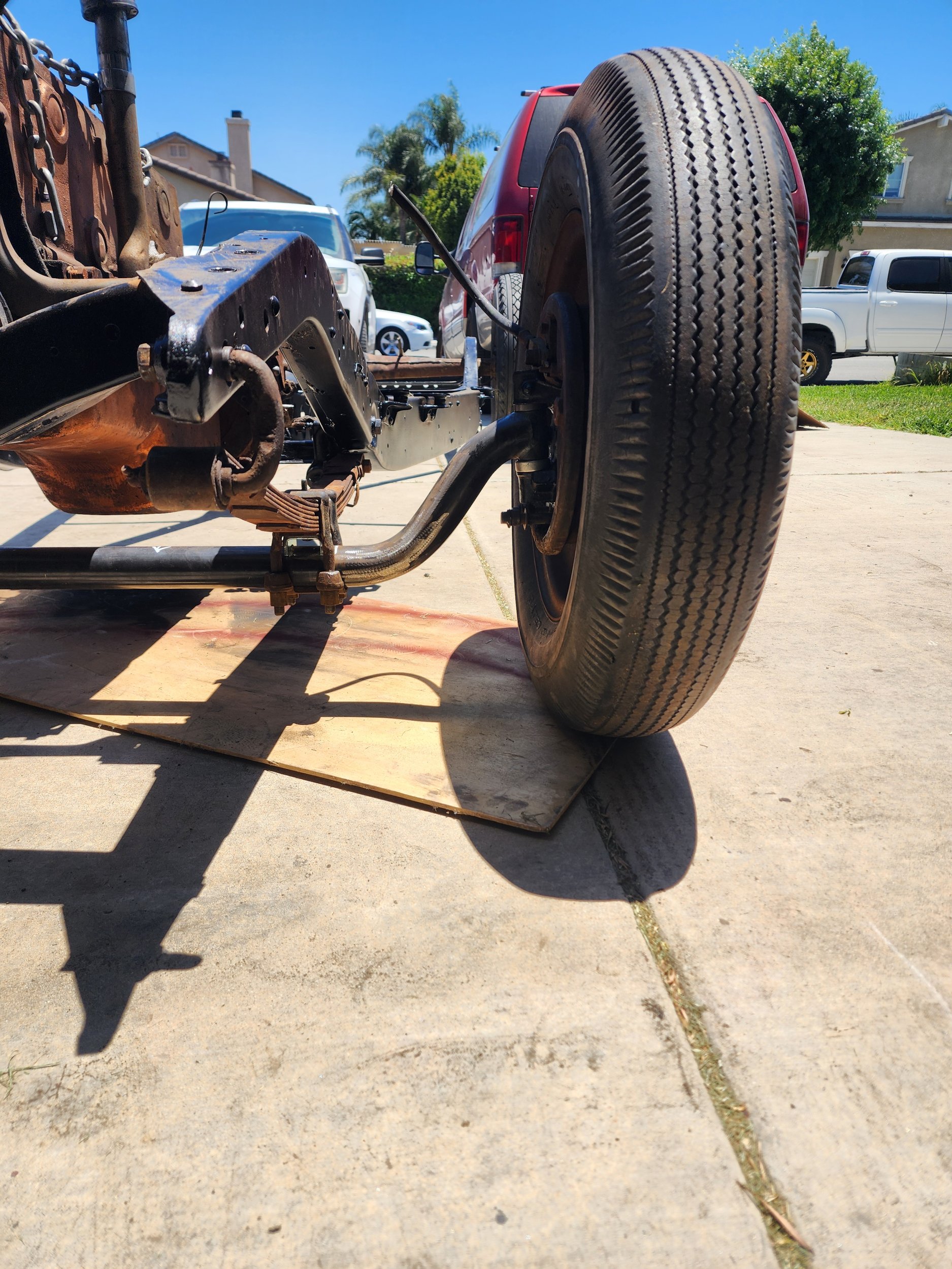

    I got my front end mocked up. I need to weld the leaf spring pads to the axle still. My king pins fit great. I pulled the 2nd and 4th leaf from the bottom and dropped the motor in to get an idea of ride height. Chevy 6 inch drop axle sleeved for plymouth spindle.

    It looks like it's camera angle, but that looks like the top of the tire is kicked out. Of course, the top of the engine looks kicked out the other way, so that's why I started with that.

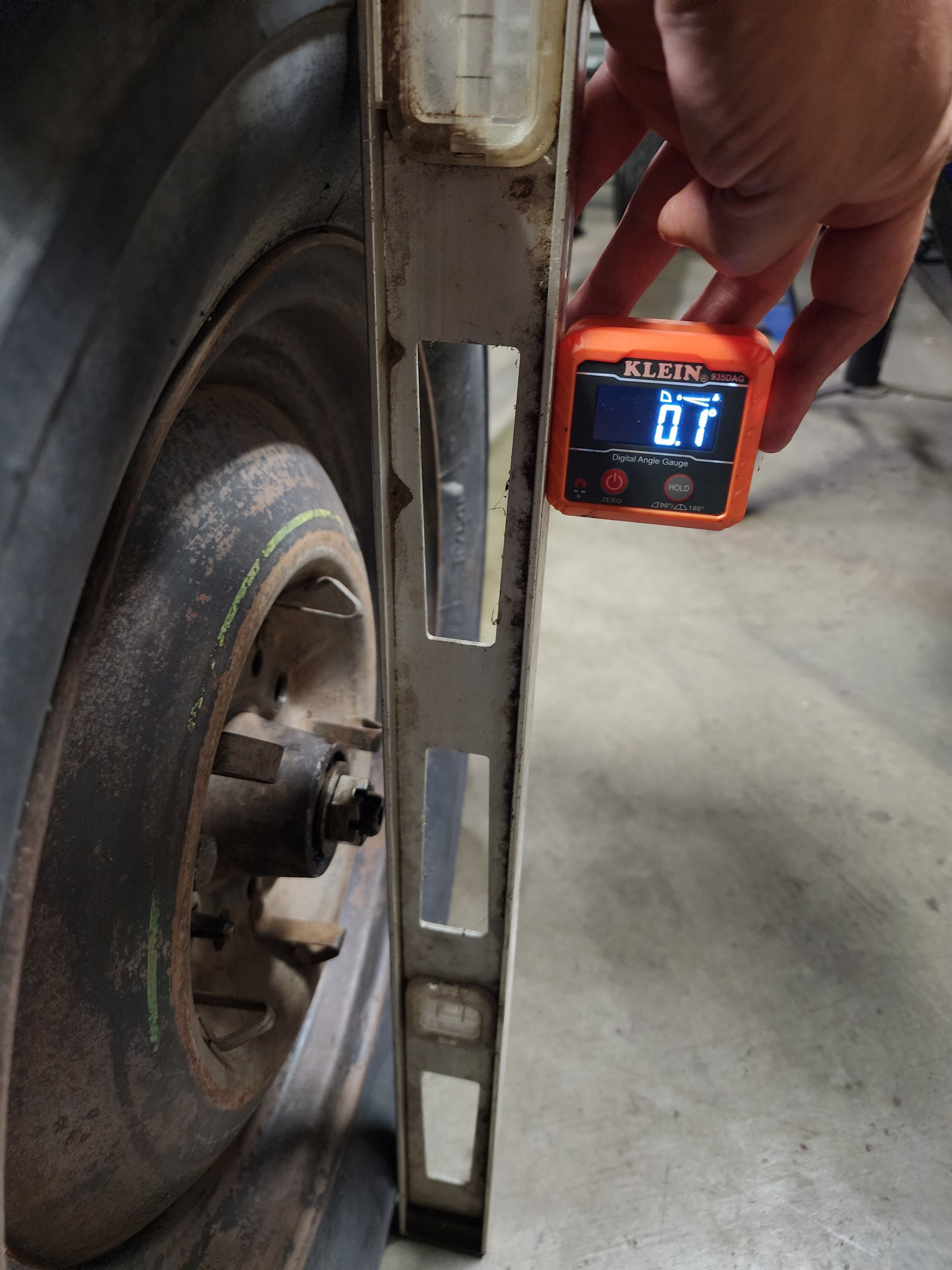

    I just went and checked with my super sophisticated method. Is this good enough? I would ***ume it is but then again im learning as i go from all of you. 20250629_191820.jpg

    Good enough for a roller! :p
    I kind of figured it was close, but the pic didn't help.
    If anyone is annoyed by a tenth of a degree, they can chip in for the axle bend at the alignment shop! :D
  9. They will kick out some without all the weight.

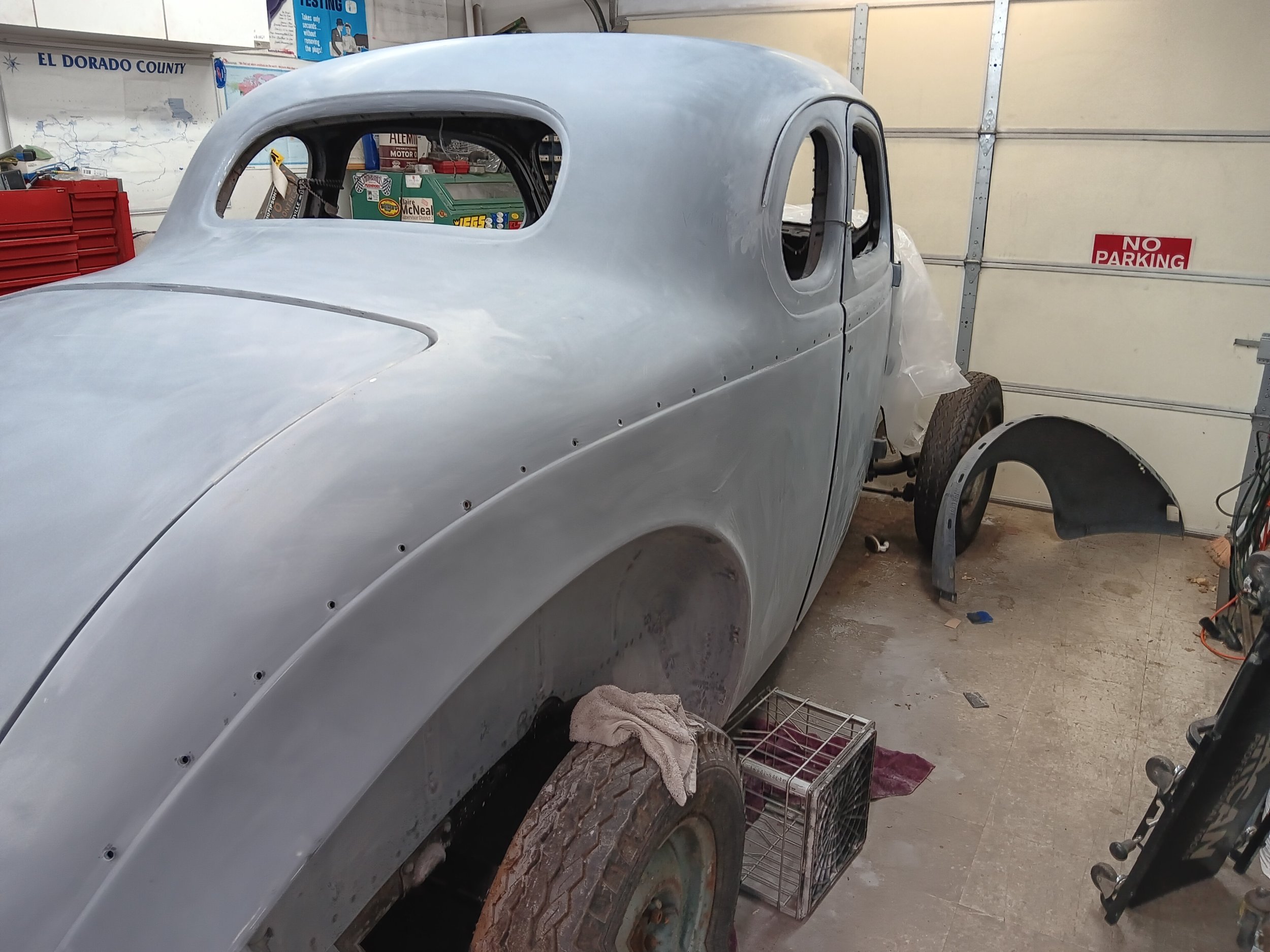

    20250627_082404.jpg 20250627_082404.jpg 20241212_134737.jpg making skirts for mine right now. Don't know if I'll use them, but make them before paint.

    Alright, I finally see light at the end of the tunnel on the rear trailing arms. I decided to go with c10 arms and make new holes for the u bolt. I cut a tube in half so the arms are still like the original. Doing this has really slowed me down and taken more time then it should have. I installed a crossmember with some reinforcement pads at the ends. I didnt go all the way across the frame but if I should, just let me know. Next is airbag mounts and the tabs for the front of the truck arms. I should pick up speed after that. 20250731_172131.jpg

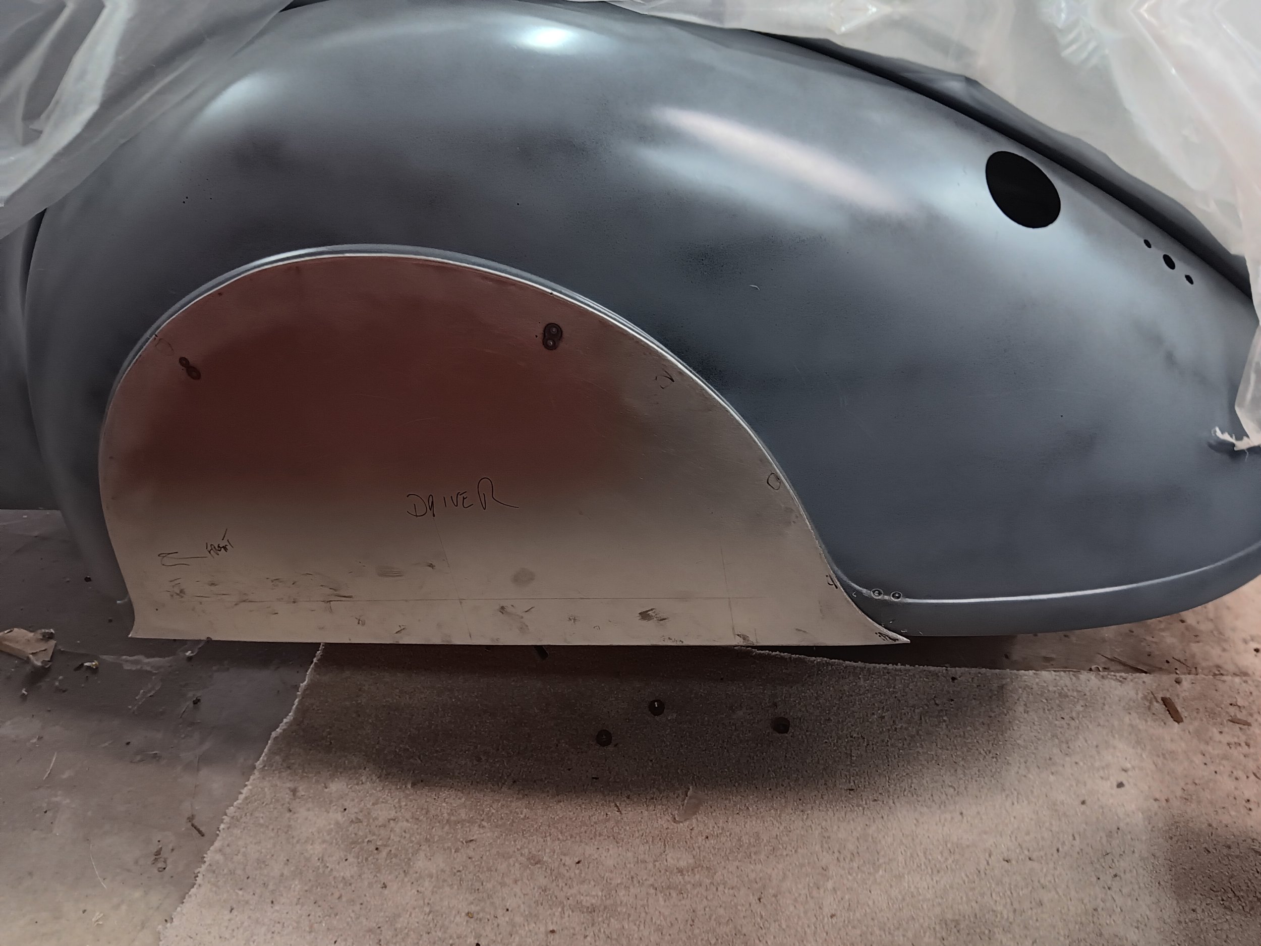

    Still plugging away. Made an attempt at single stage black from eastwood on all the fenders. The pics are pretty much fully aired out. 20251230_190802.jpg 20251230_190713.jpg
