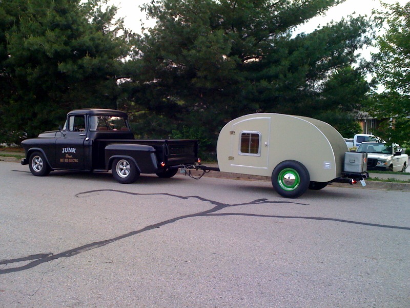

    Ken(Slick 50) how have you been? I haven't seen you in forever. Sam Kimbrough Here's a picture of my home-built teardrop. I used a pop-up camper trailer, ***le and all. It's ***led as an 85 Jayco. Neglected pop-ups are plentiful around here. I got mine for towing it off. I shortened and narrowed the frame to a 4x8 base. It has 5x4 1/2 hubs with steelies and I fabricated fenders from a 35 Ford spare tire cover(after this picture). I used 32 Ford rear frame horns and an old luggage rack mounted to the spreader bar. I really like it. The crank out windows were salvaged from a 1930's house trailer. I elected not to have a rear hatch and to avoid the sealing/leaking issues. All of my camping gear is in totes anyway and I do my cooking on a roll-up table. S shelf inside keeps everything out of the way while sleeping. Good luck with your build and be creative. I laid out my own profile on a sheet of masonite. I used a piece of screen molding to get the contour/curve I wanted. Mine is covered with military canvas. I wanted it to look like a 40's build similar to those in the Poplar Mechanics magazines of that era.

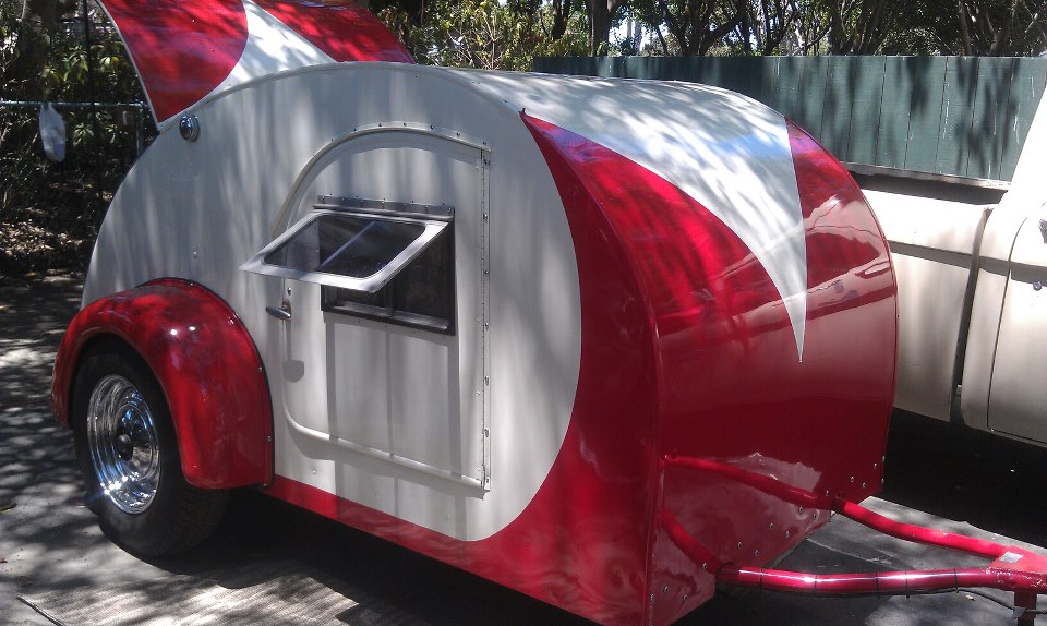

    A friend of mine tows his to all the shows... he also uses it for camping. Has a full kitchen in the back hatch... fully functioning with vintage equipment... this pic was taken on Old 66 in Midway... the halfway point of the highway in the state of New Mexico.

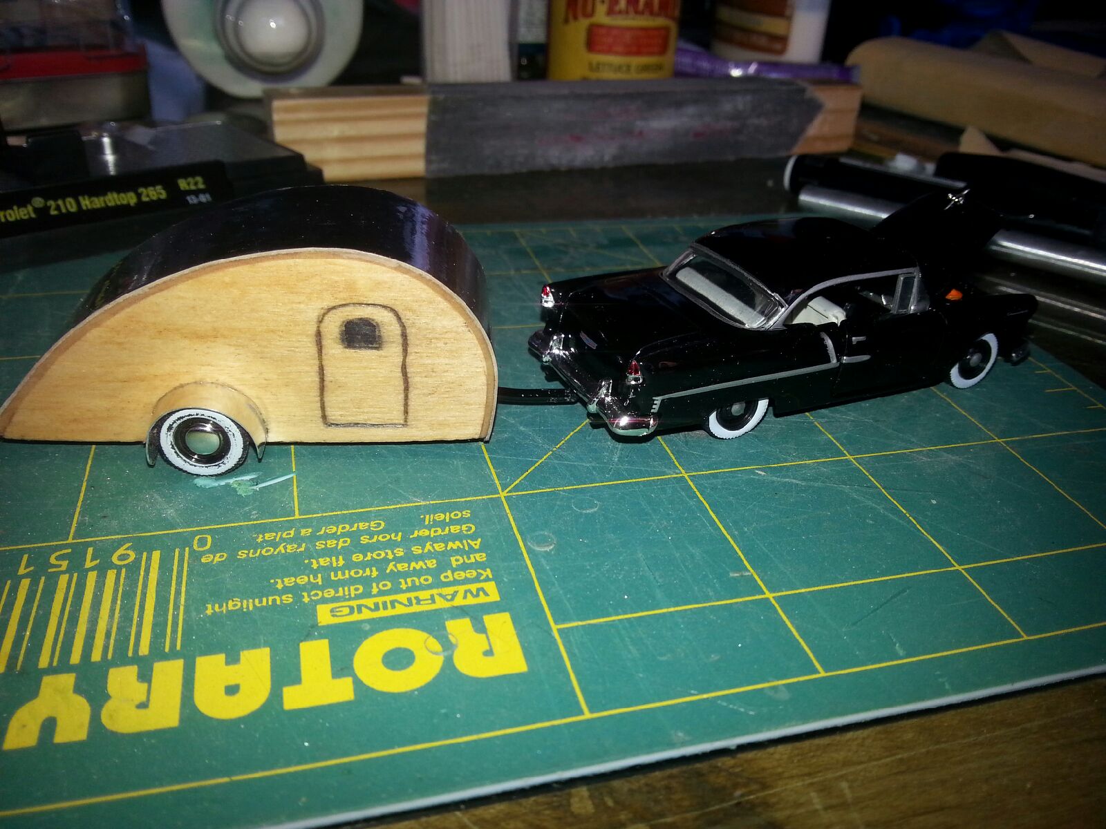

    He also makes mini's...
