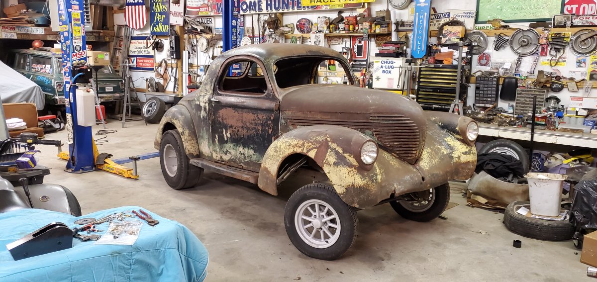

    Staying with the 38 nose, will be posting some pics later today, impala buckets installed, steering all done, shifter and mount in, battery box and fuel cell installed, today plan is to fill rear end, fit windshield, and some toe board work, and brake lines.

    Windshield in, rear end done, finished welding off the front end, gauges installed, installed a org red white blue Don Garlits tach and the electric fan installed and laying out the wiring now.....

    I am surprised that those Impala bucket seats fit in there. I would have guessed that they would be too wide for a Willys...
  5. Fatkidscars
    Joined: Nov 27, 2011
    Posts: 564
    Fatkidscars
    Seats are as wide as u can go in a willys...lol tight fit....

    Hope you don't mind me asking -- I recently picked up some "fair" steel front fenders for my '38 sedan. The headlight pods do not have any flanges for attachment of light buckets; did Willys make them that way, or did somebody trim them off? Looks like you have adapted Ford headlight rims? And buckets? Have you any detail pics, or description, of your arrangement?

    My headlight areas were already trimmed out on the fenders when i picked up the old junker, the ford headlights was something i had laying around and fit okish, and lots cheaper than trying to fix the fenders, if you like i can get you some pics of how mine were done.

    Well the willys coupe is all done to my standards, finished up all the smaller things and drove it down the road today....
