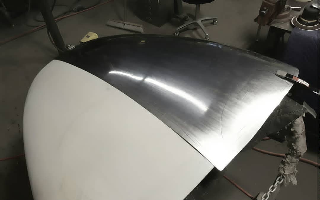

    20180129_213946.png 20171215_170057.jpg 20171215_183209.jpg 20171220_183247.jpg 20171220_190046.jpg Made a flexable shape pattern off the decklid so i can start shaping the trunk skins, im doing the decklid skins in 2 pieces. i also made a paper pattern so i know where/ how much to shrink and it also tells me what size panel i need to start out with. these pics are from start to current progress

    Got all the shape needed in the panel and at this point its clean up work and fine tuning before the panel is ready for installation. this is my current progress on the decklid, i need to make a hammer form to fold the lip over in the correct place along with making a wood buck and decklid inner structure. As i start doing those things ill post up more on that progress. 20180129_214058.png 20180129_214115.png 20180129_214130.png 20180129_214145.png

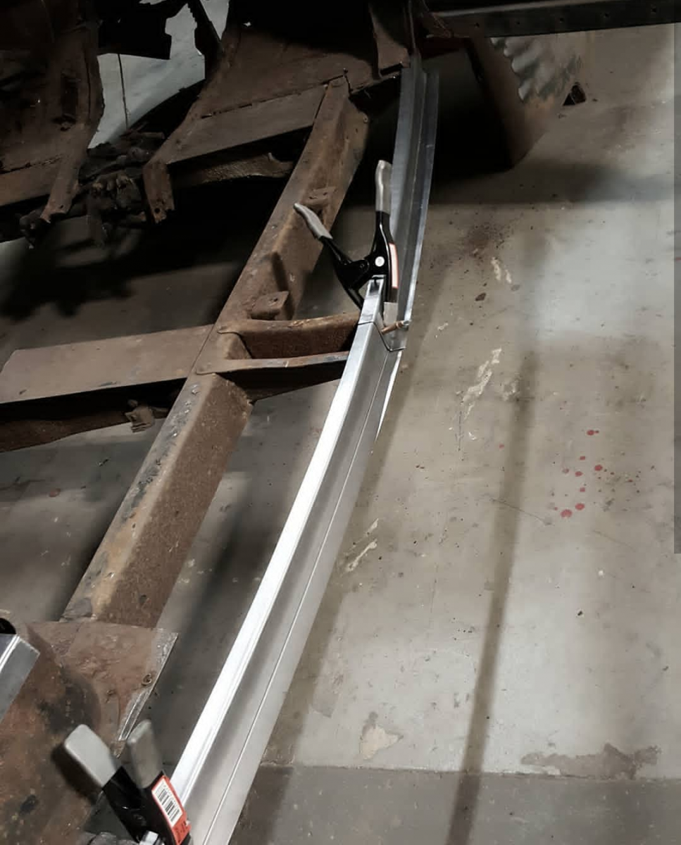

    Rocker panel structure was smoked on this car so i need to make all of it, this is just the start of the progress and will be alot more to this piece then what im showing at this time. 20180129_214020.png 20180129_214037.png

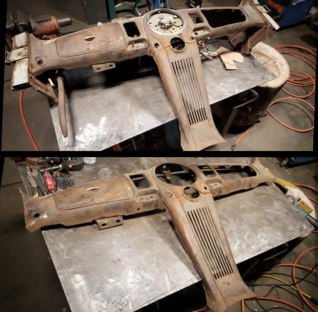

    The dash on my car was cut out and sold previous to me getting it and these dashs are fairly hard to find. luckily a few friends tagged me on a post on instagram and i found my dash but it 39. i really like the 39 gauge cluster and i think it will look nice when done. I got it all cut down and ready for media blasting and recently found a cherry original 39 cluster but did not come cheap. well worth it though 20180129_214227.png Screenshot_20171224-145130-01.jpeg

    Yeah he has the skills to completely fabricate custom coach work if he so chose!Will you chrome plate any parts of that cool dash?
    SKOTY CHOPS KUSTOMS likes this.
